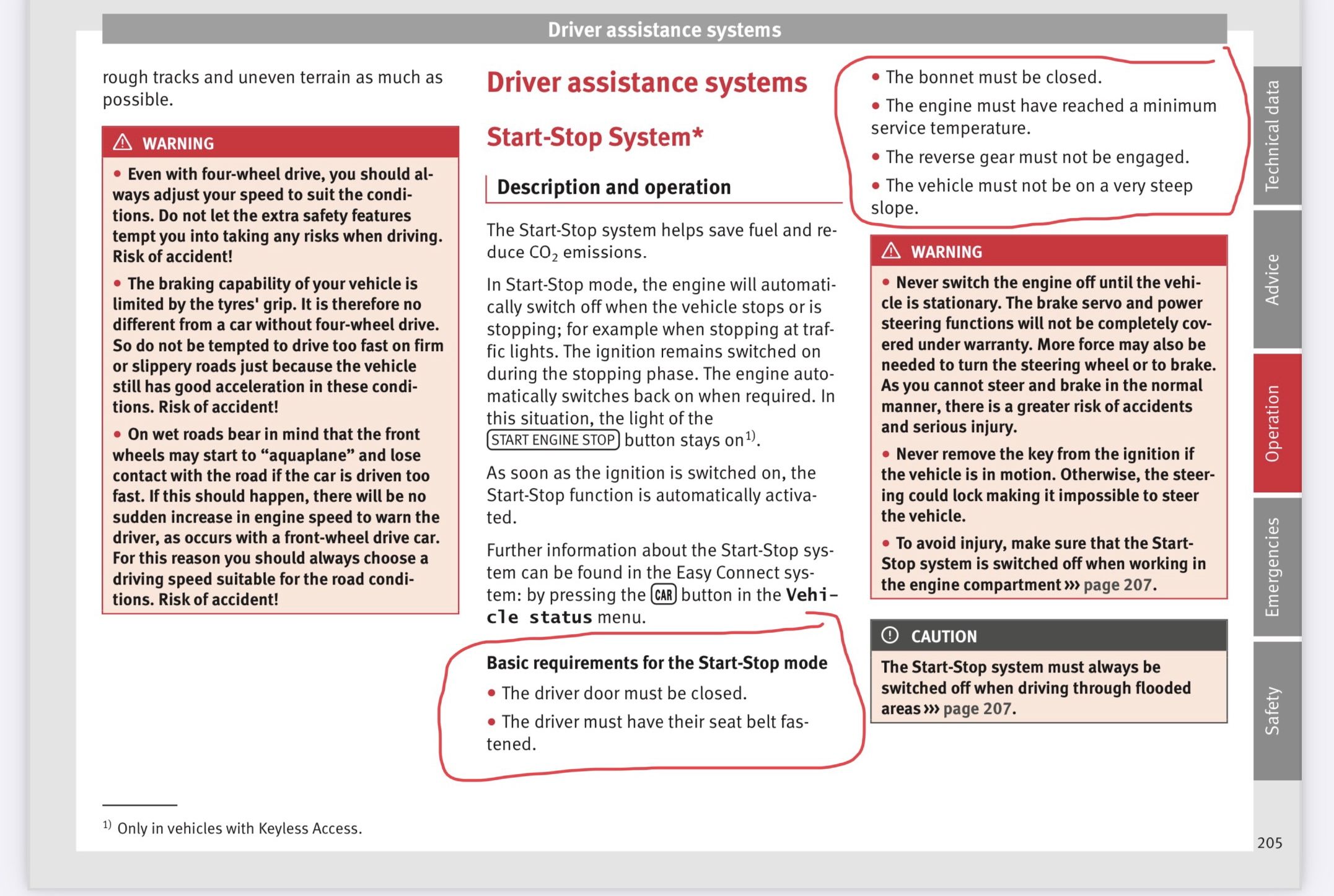

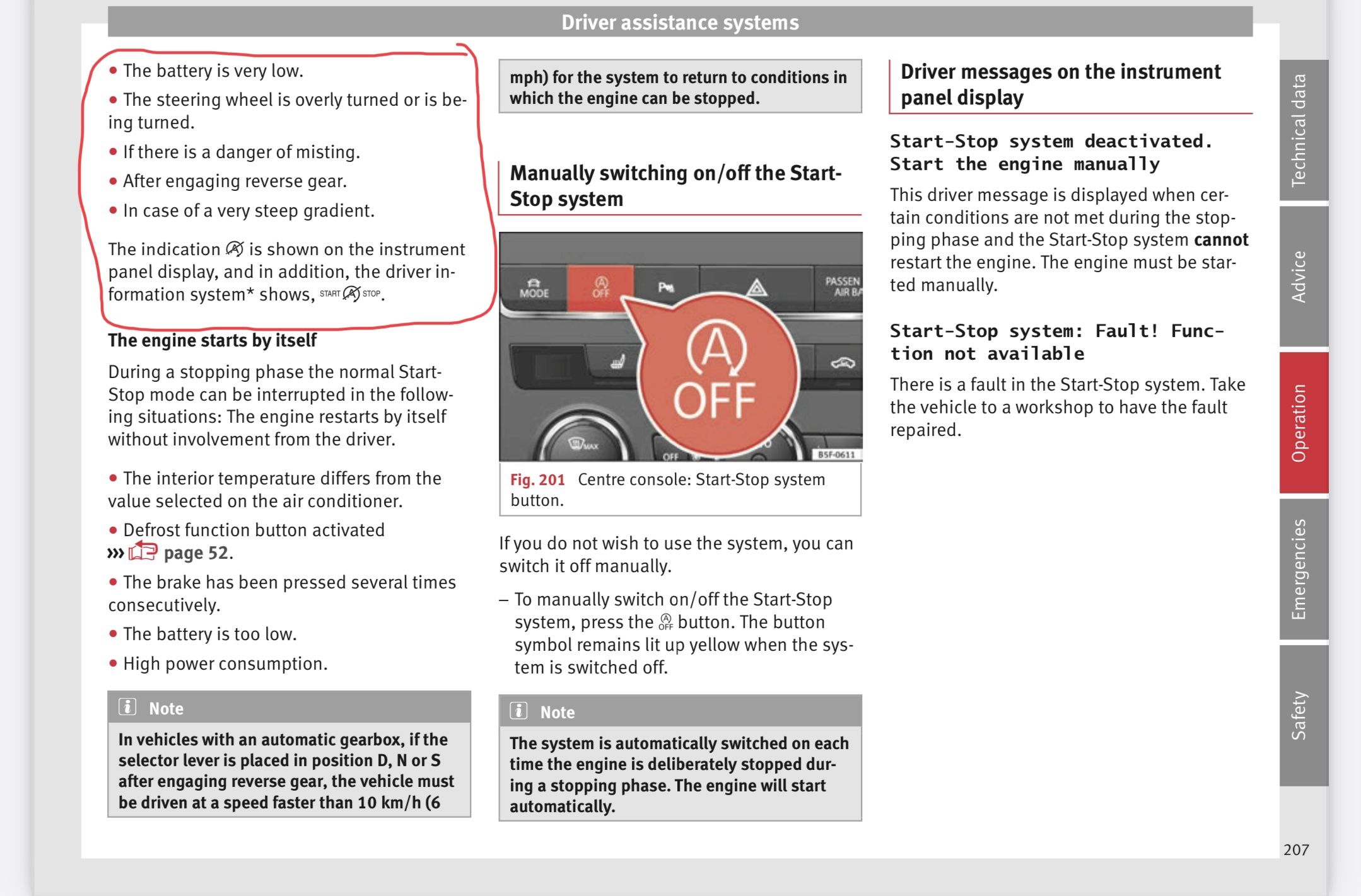

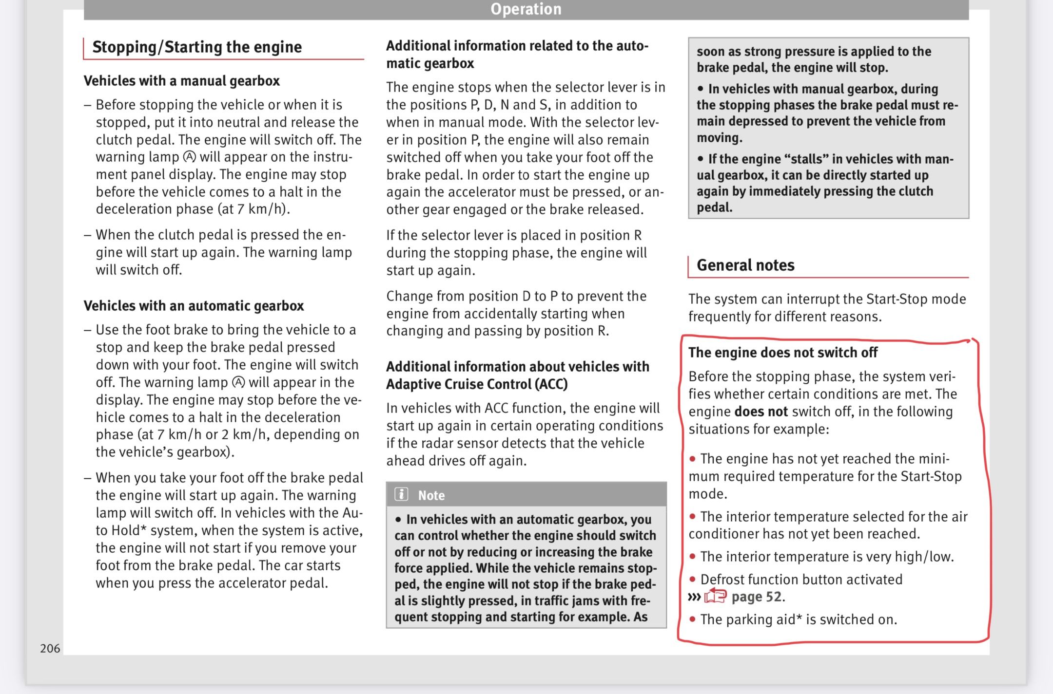

The screenshots below listing the conditions affecting stop start functioning are from the Nov 2017 edition of the owners manual for the mk3.5 Leon;
Reactions: SuperV8
