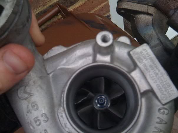

Well karl got a call from the garage who had removed the turbo so we went down to collect it and suspect the damage, the mechanic said there was no oil in any of the pipes, but the pictures will reveal the damage, a piece of turbine blade has broke off, and the play in the shaft is, well to say the least it feels like it will just fall out, its that loose, anyone got a idea where this piece of blade has gone as the mechanic couldnt find it :shrug:
I'd had a fair bit of stick though - look how black it is! That side of the turbo shouldn't be as black as that....exhaust side - yes, not that side!
Dunno where the vein has gone....that's engine side too isnt it?
Is not hardly black, its probably my phone as i was trying to get the light shining into it to get a good picture etc and i think its just the way it came out lol. Turbo failure it shows
I doubt that the piece that had broke off has got into the engine as it prob wont pass through the intercooler.
