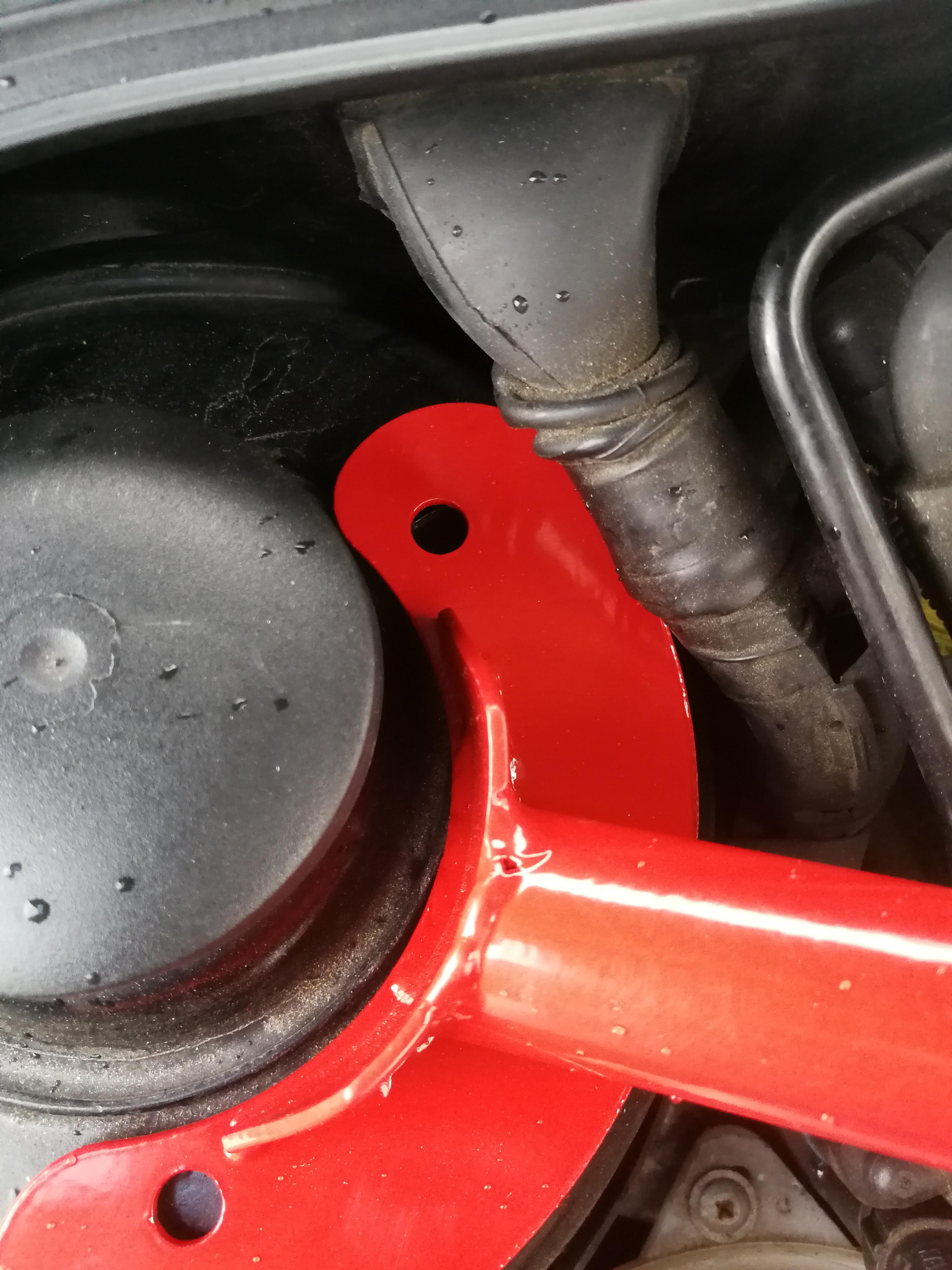

Well thats another ebay disaster (I should have learnt by now !!), I can honestly say what a pile of **** !!, the front top one does not fit , it fouls on just about everything !!!. Not even going to bother to try the others.
Be warned TA-Technix = Pile of **** , would NOT buy and sure as hell cannot recommend them.
Pissed off ain't the word.
So some pictures to help see the issues

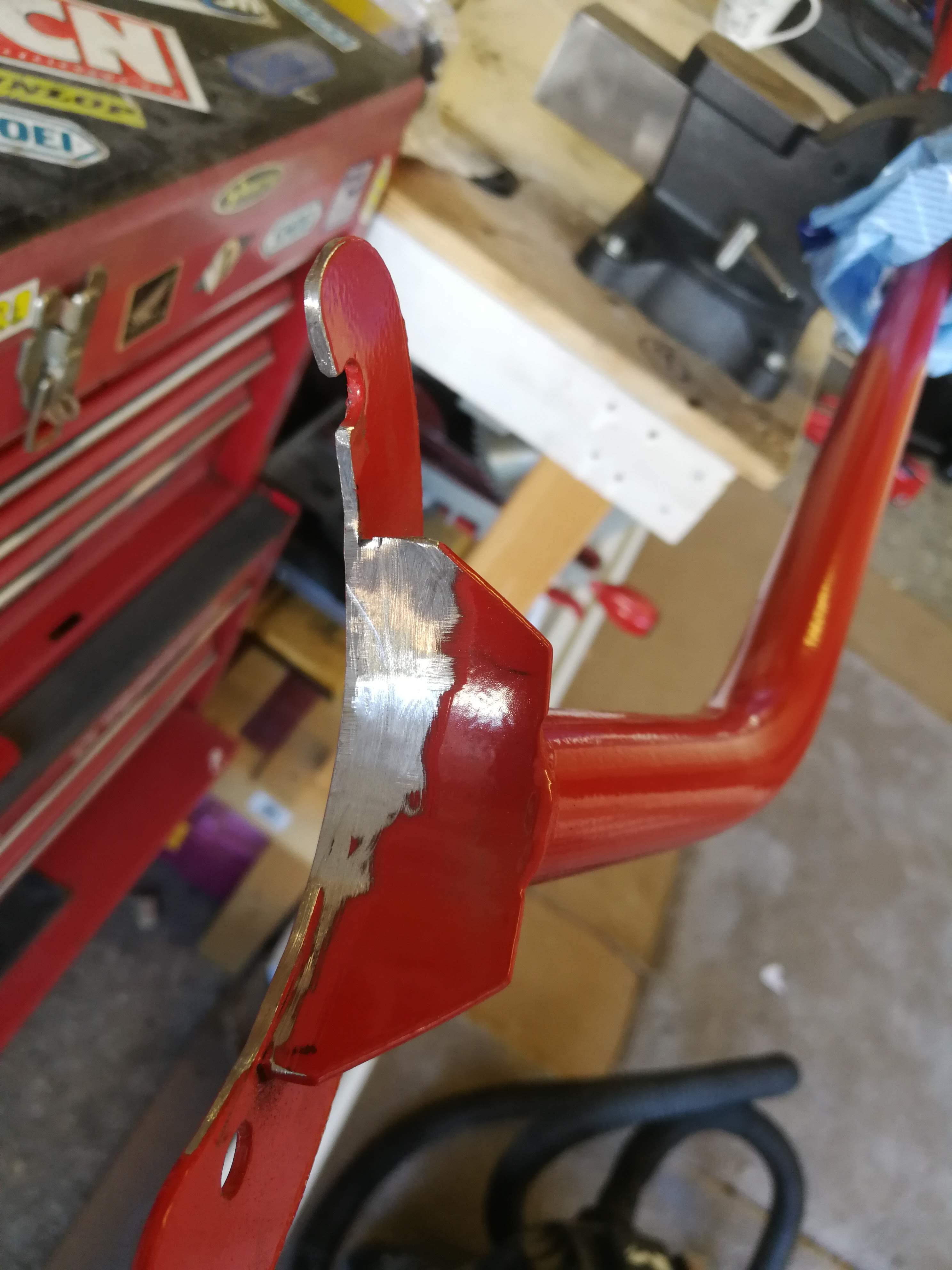

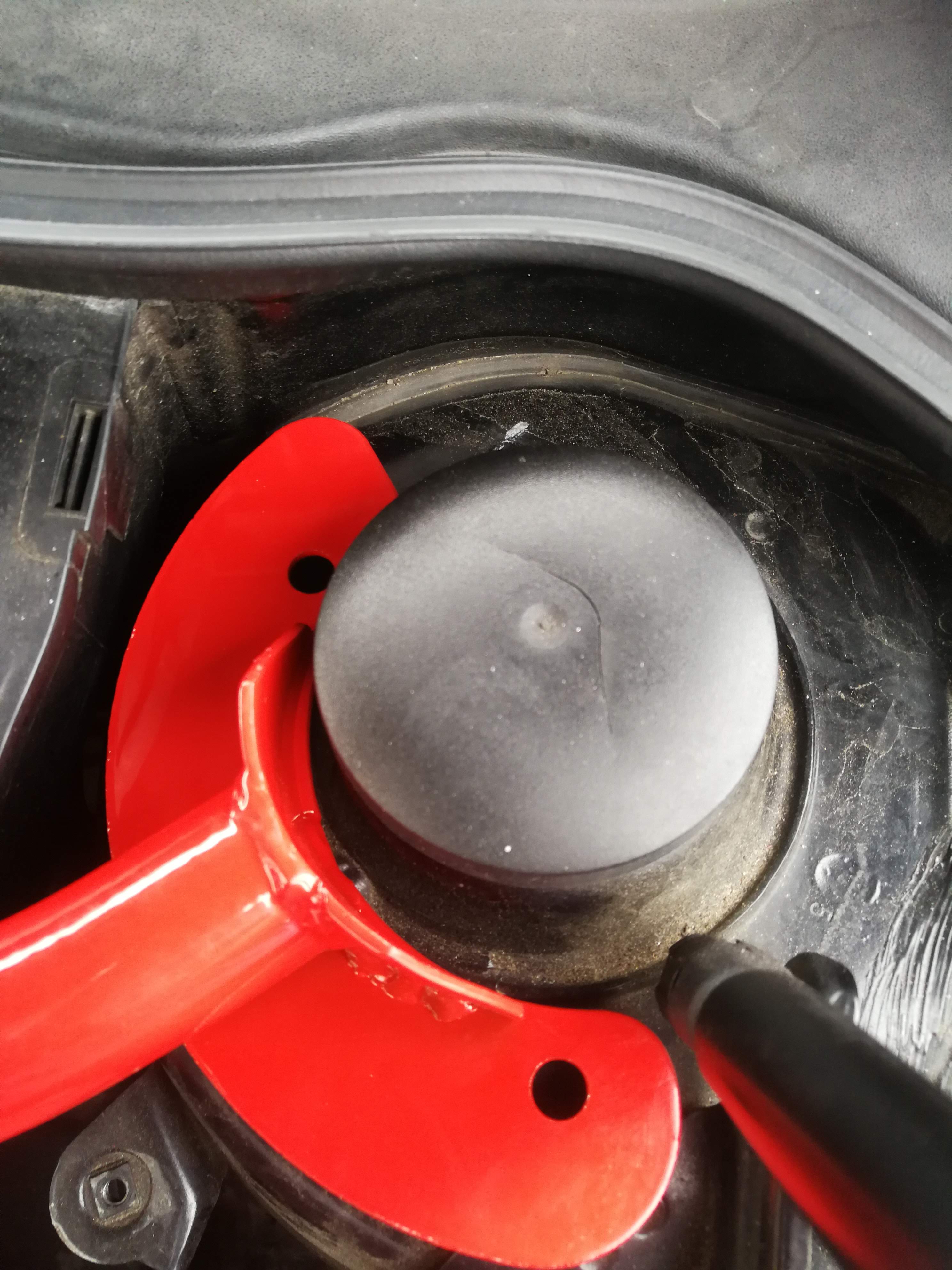

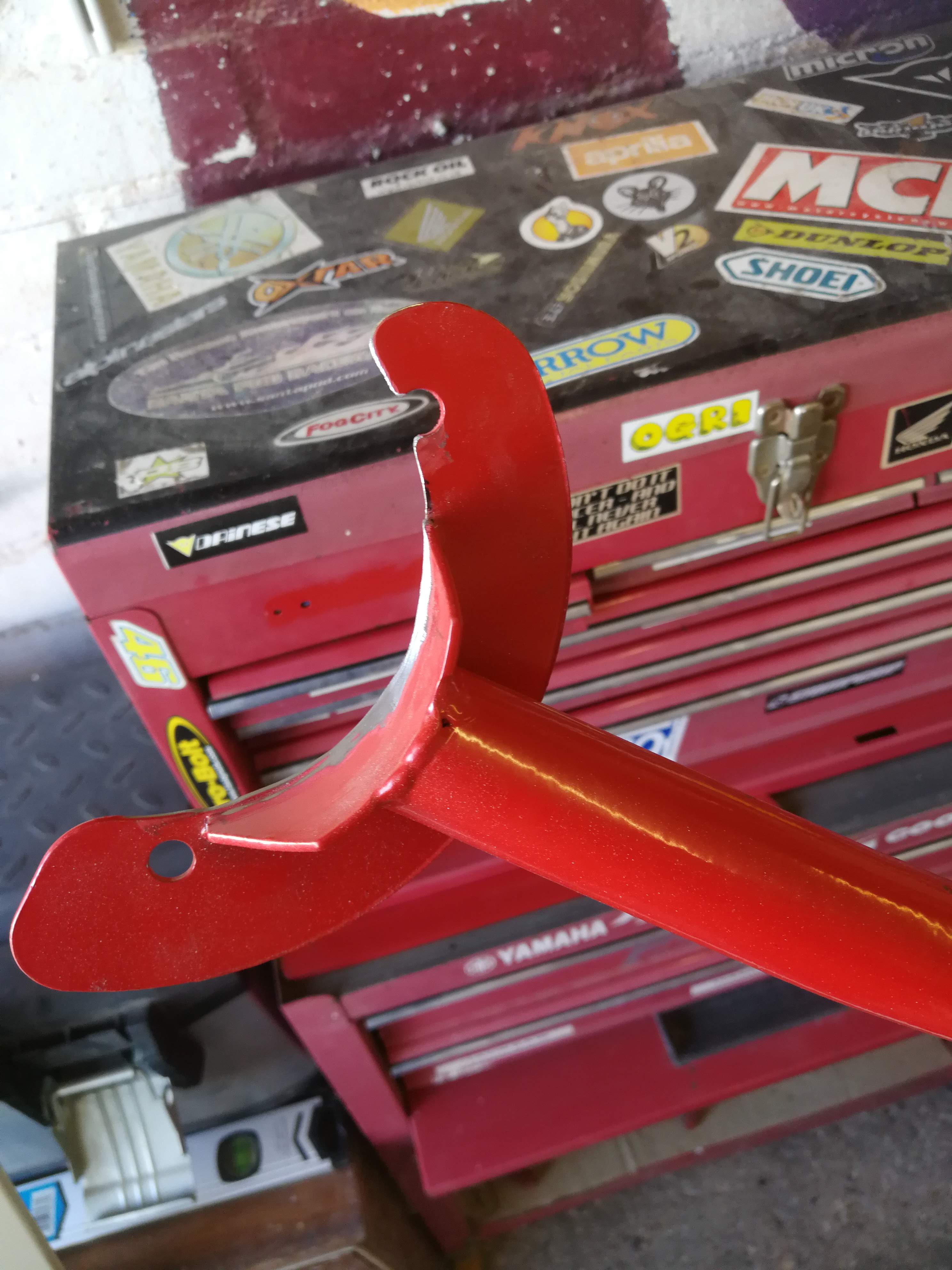

You need to cut so much of the mounting plate to get it to fit that the top hole needs to be re-drilled

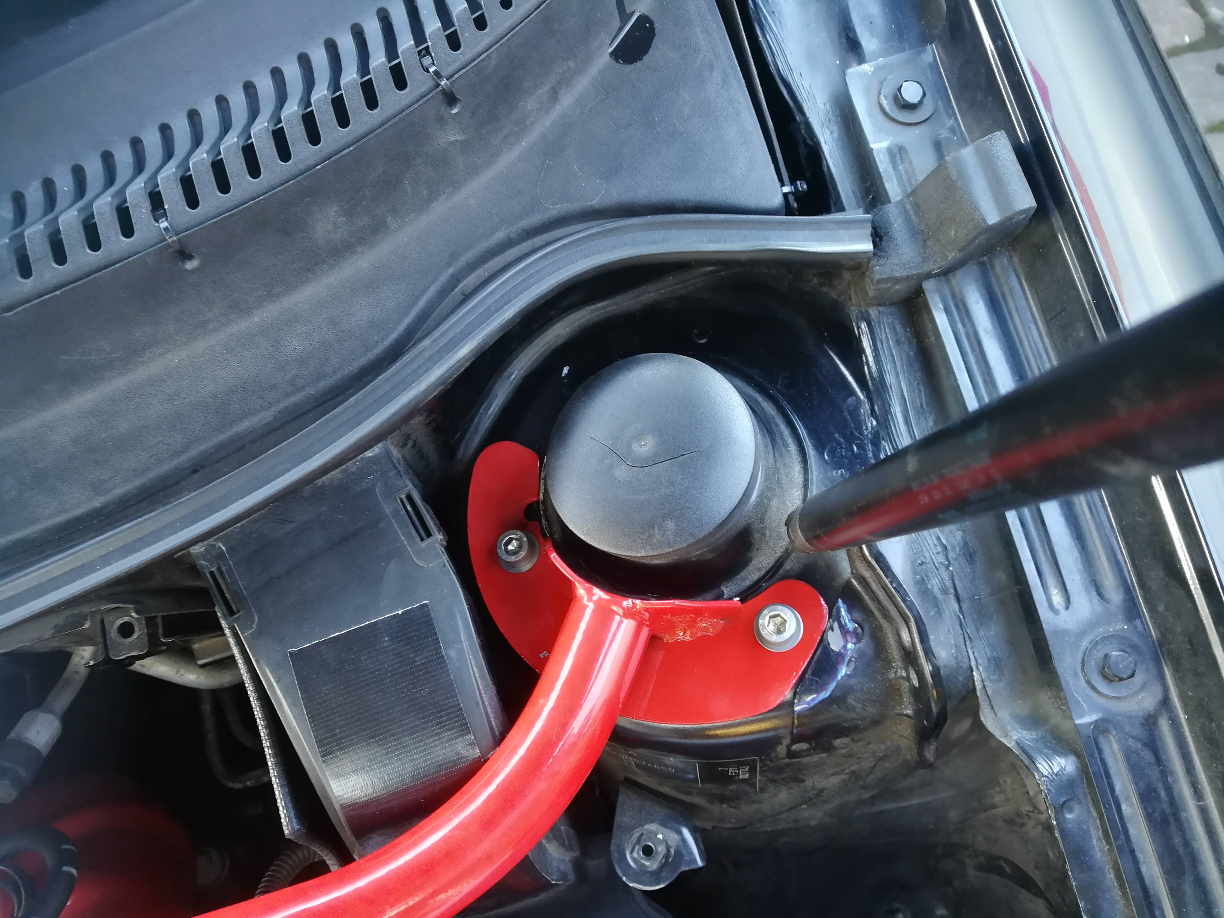

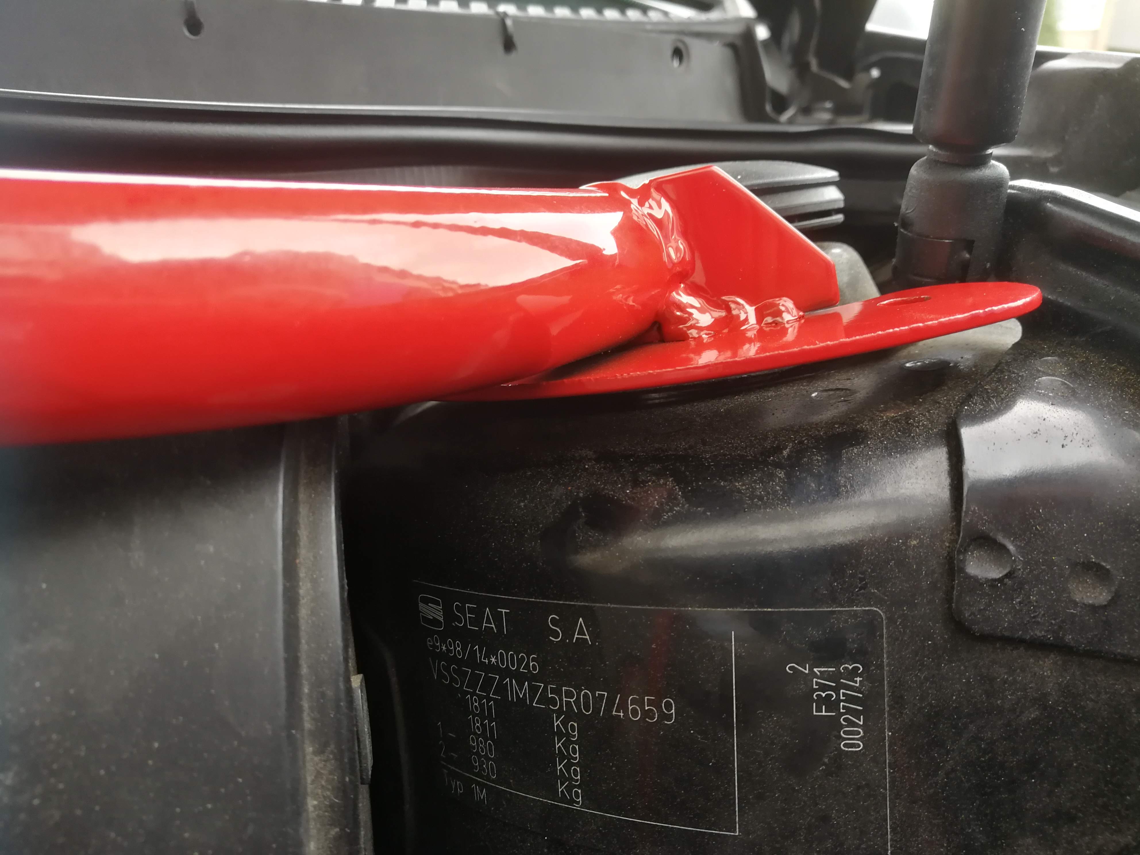

Doesn't even sit flat on the top of the tower as it doesn't clear the electrical box

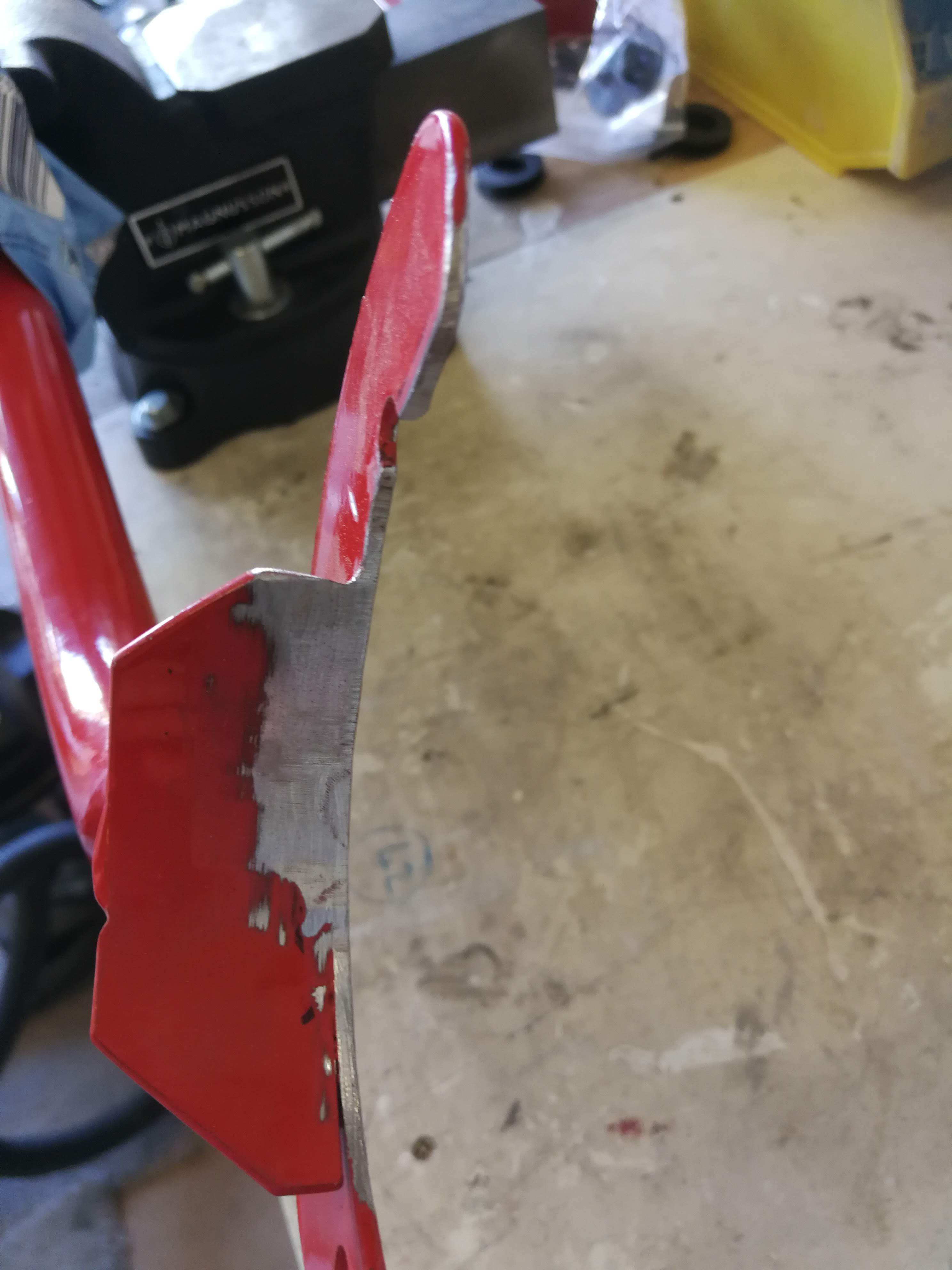

Fit is so bad you need to cut the mounting plate off and relocate to allow for the raised lip on the tower
And i should mention thats with the adjuster set all the way in ie: shortest setting

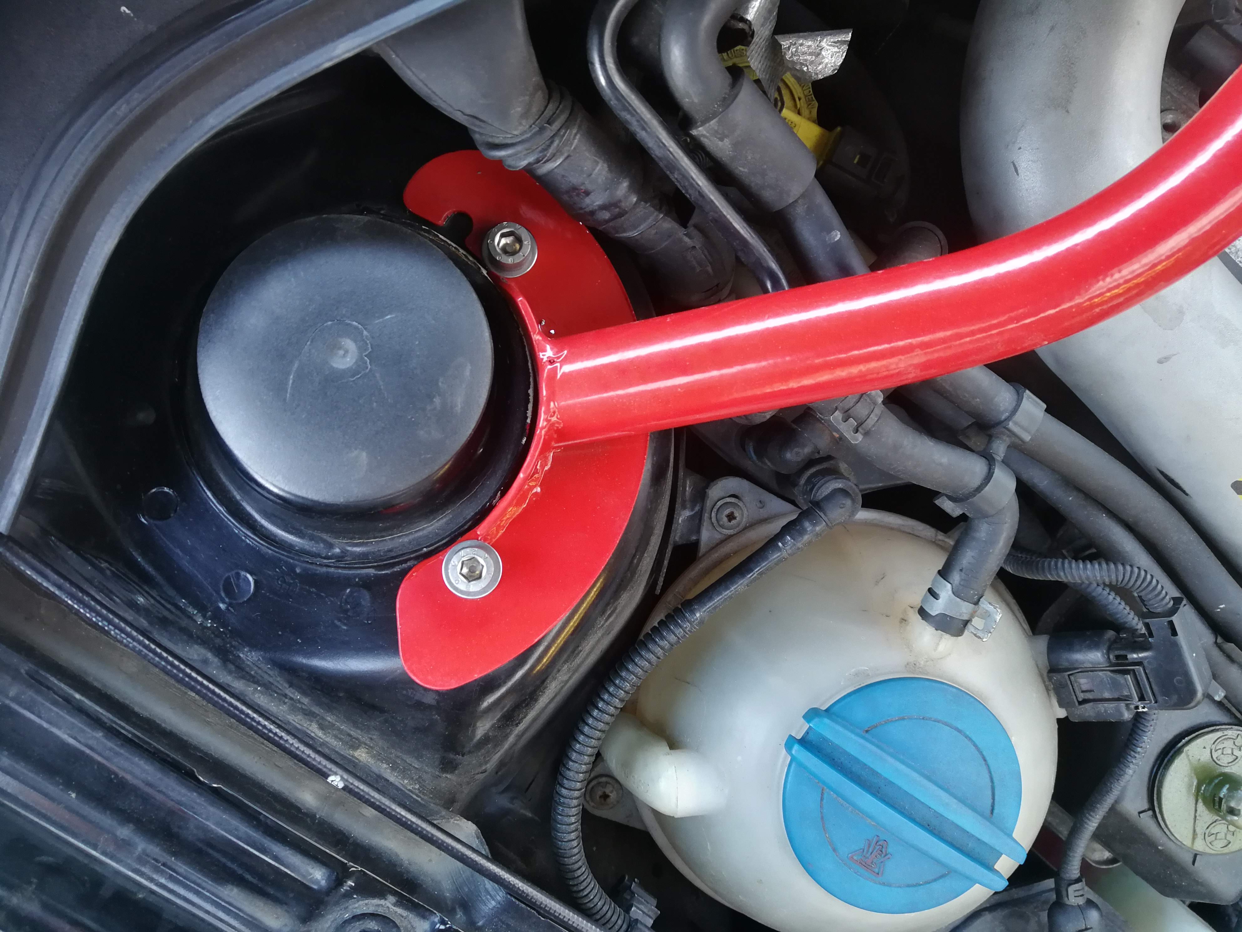

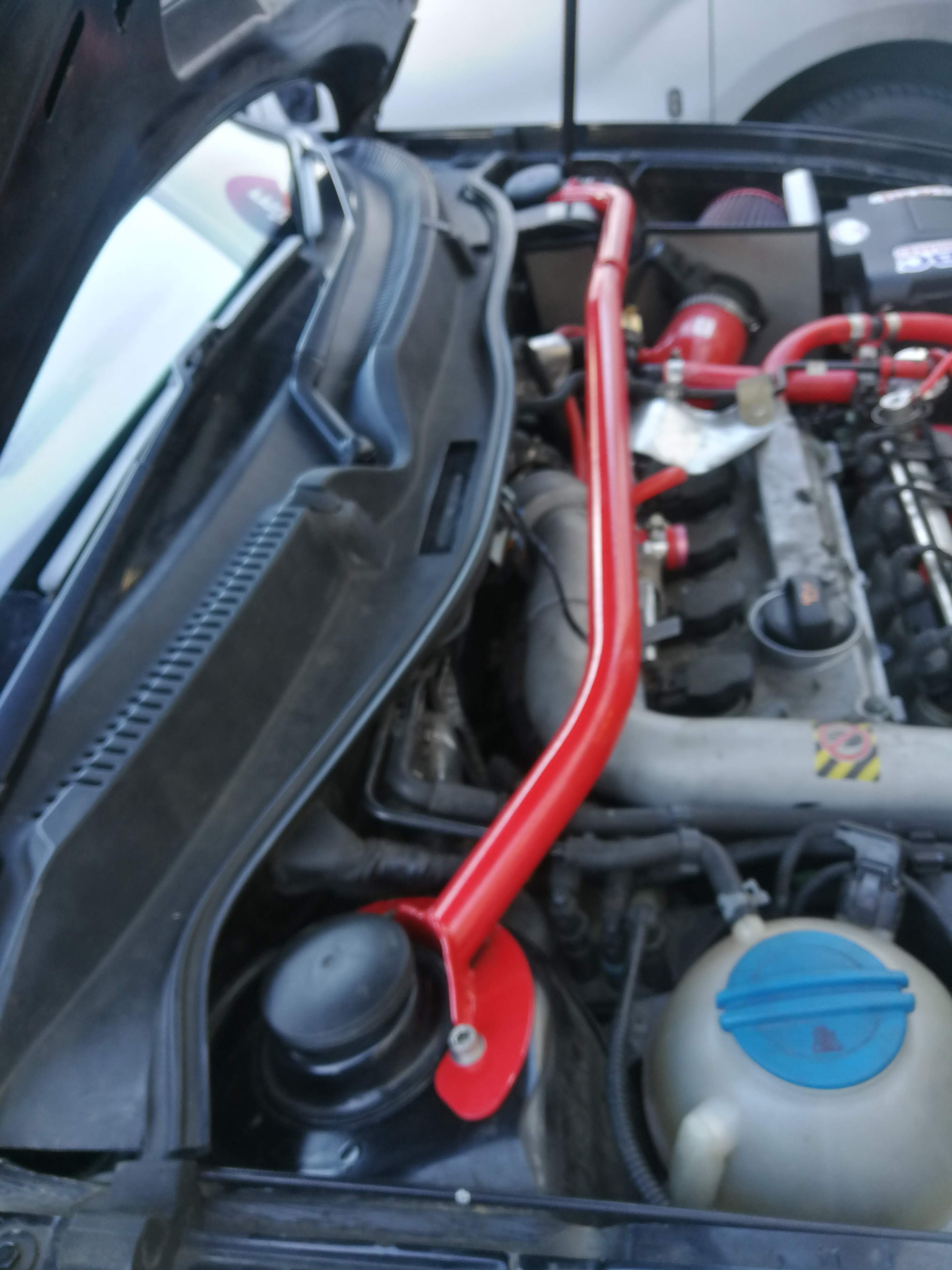

It will fit pretty well but both ends need tweaking.
Left side I removed just a few mm
You can see where rust has started on bottom right side of the left plate. . . ( another job)
On the right you need to remove more of the plate. As there’s a raised seam or such like.
They will sit flat once chopped and bolted down.

Also if you still have your soundproofing in the bonnet it’s going to be a problem closing the bonnet.
Mine is tight without and has even scraped paint on the brace.
Only saving grace for this brace is the knowledge that even the Audi s3 brace usually needs a small bit removed as well to sit flat properly.

Yuk, looks like cheap and nasty Chinese junk to me.
Audi S3 8L strut brace is the way to go on these cars.
Decent fit and OEM quality, just a tiny shave with a grinder on the nearside mounting plate to clear the bonnet strut.
And yes I always fit them with rivnuts/ nutserts as it not only makes installation easier it makes it a hell of a lot quicker and easier to remove when doing other under bonnet work and you need it out of the way.

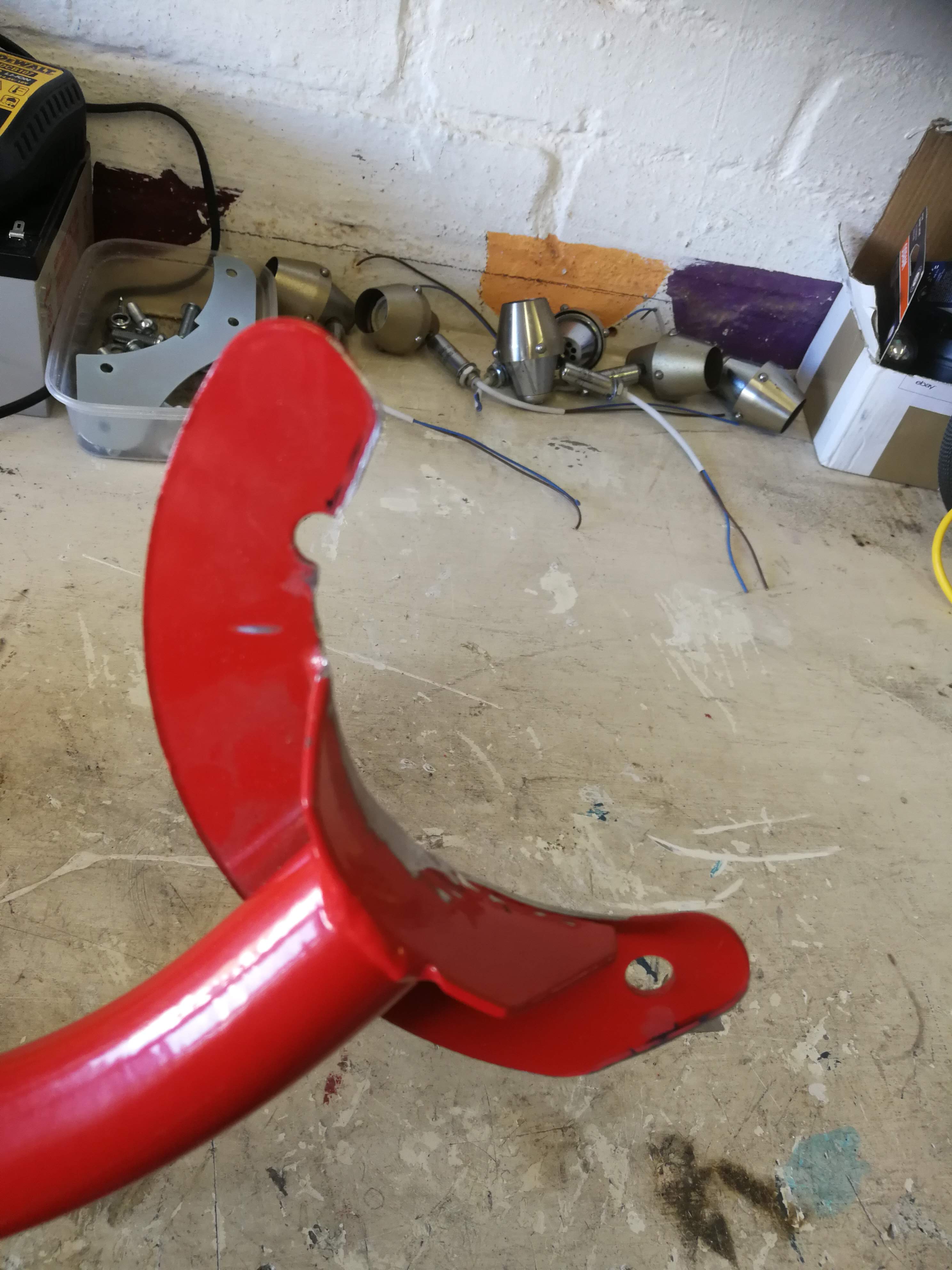

2 hours with the dremel, anglegrinder and cursing and it still doesn't fit . Wev'e cut so much out we have lost the top mounting holes and now need to re drill them plus cutting a help out of the supporting bracket.
At this point its probably worth throwing it in the bin and just taking the £100 loss on the nose.

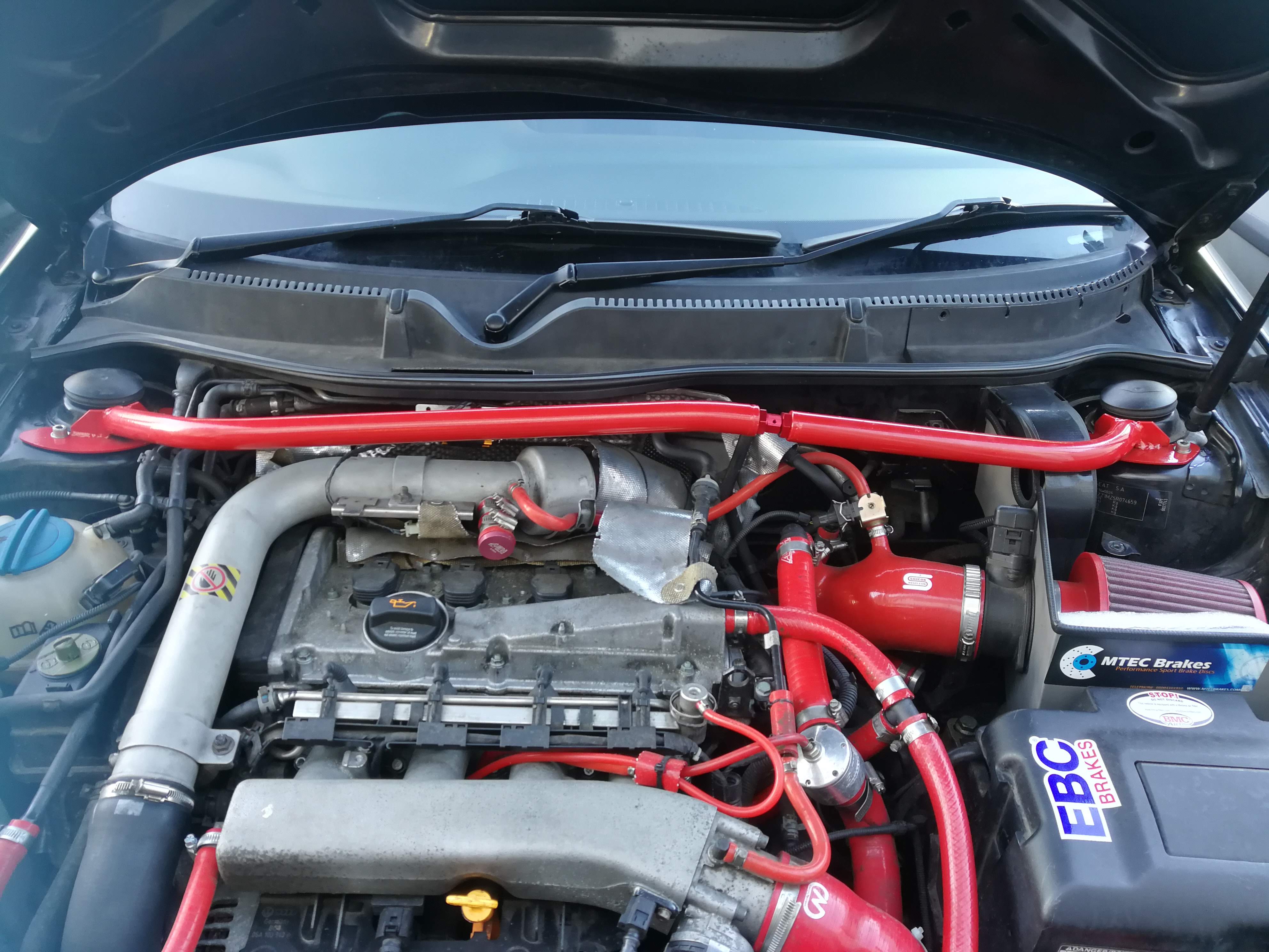

I may well have been lucky. Sounds like a mare.
Badger5 Custom Map + TIP,
Thinking back I may have drilled a new hole too!
Wrong way round though. .
Good job, its just a pity that they manufacture stuff that does not fit and required your intervention.
If they said that up front then at least you would know and be ready for this.
At least its fitted now, are you going to go on with the other bits or just ignore them.
Reactions: cuprak04
Yes I will fit the rear and front lower but will be a lot more circumspect about it , for direct fit I will take it might fit with modifications :)
