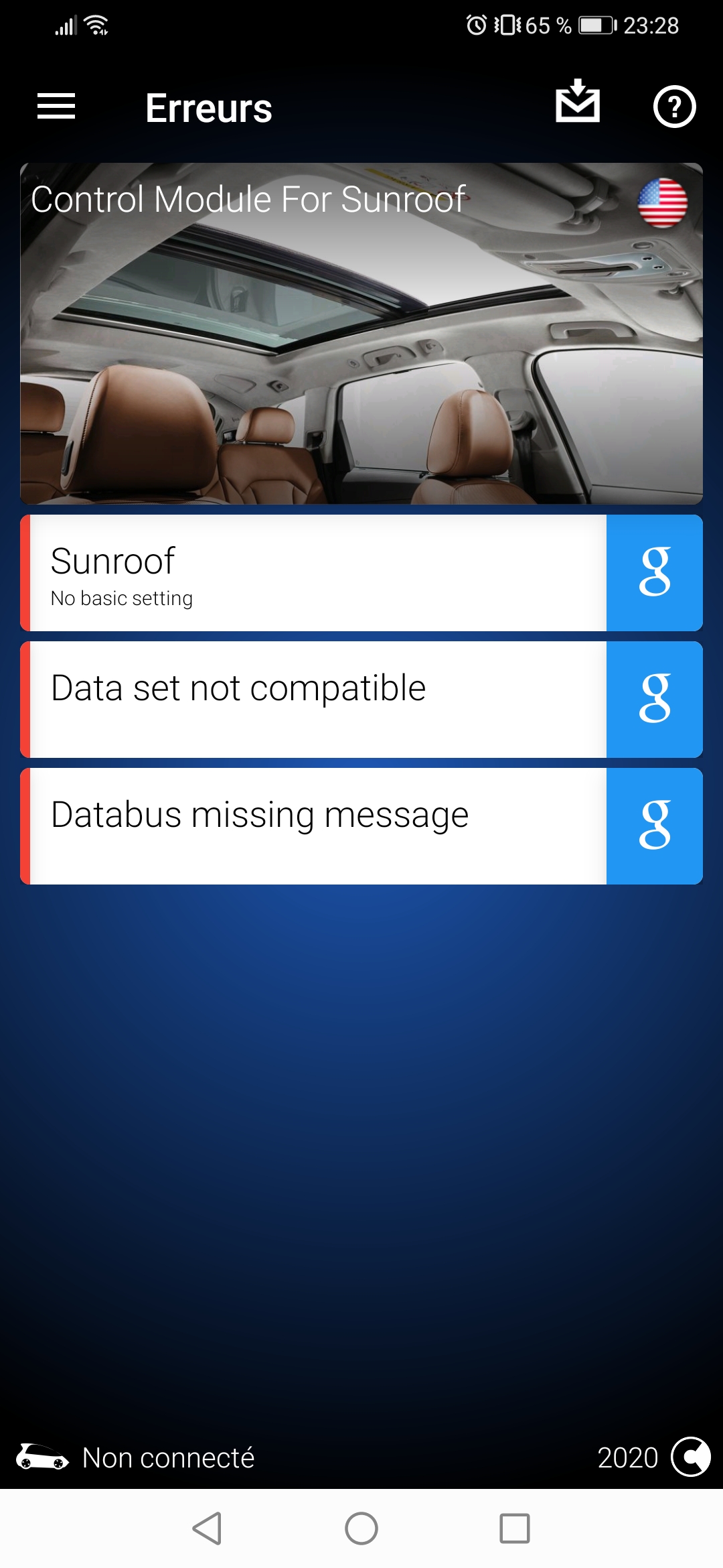

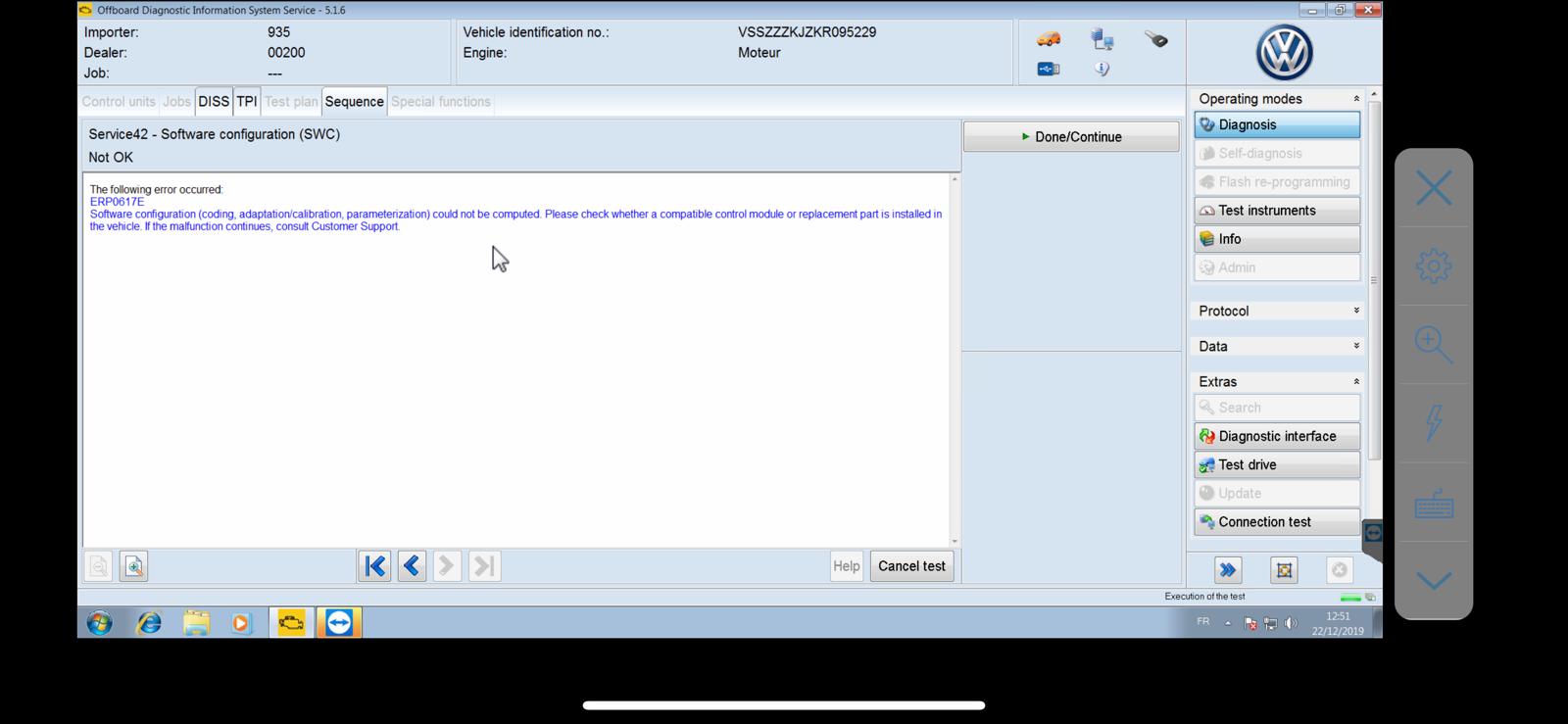

Hello friends, I have a little problem, my wife's seat Ibiza had the battery which died, we decided 4 days later when we had time to change the battery we bought the same one, there was errors on the dashboard that are all gone, I also cleared with OBD11 next generation, but the one error will not disappear that of the Sunroof I show you what the errors say, a friend has a Seat Online account we we tried with Odis but we even have an error we don't know what to do.
Can you help me?

I think error code ERP0617E is a connection error problem, looks like your comfort/convenience control module can't see/detect your sunroof.
Your comfort/convenience control module possibly needs a reset or needs to be recalibrated ?
This possibly is a pure coincidence or could have been caused when your original battery died.

Like I say error code ERP0617E is I think a connection error, could be a problem fault with your comfort/convenience control module, which is normally inside car under dashboard I believe.
