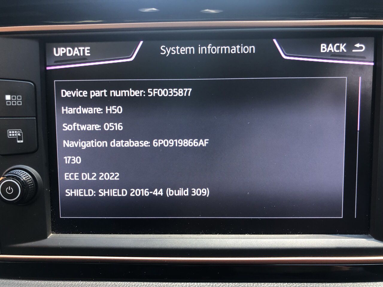

Have you tried a different sdcard ?
Did the download complete properly ? Were all files copied across to the sdcard ?
Did you copy all the folders to the root of the sdcard ?
Are you updating from the correct menu ?
(U need to press and hold the top button to bring up the hidden software update menu)
Id try all these things first.
Ive had no issues updating 514>515>516
