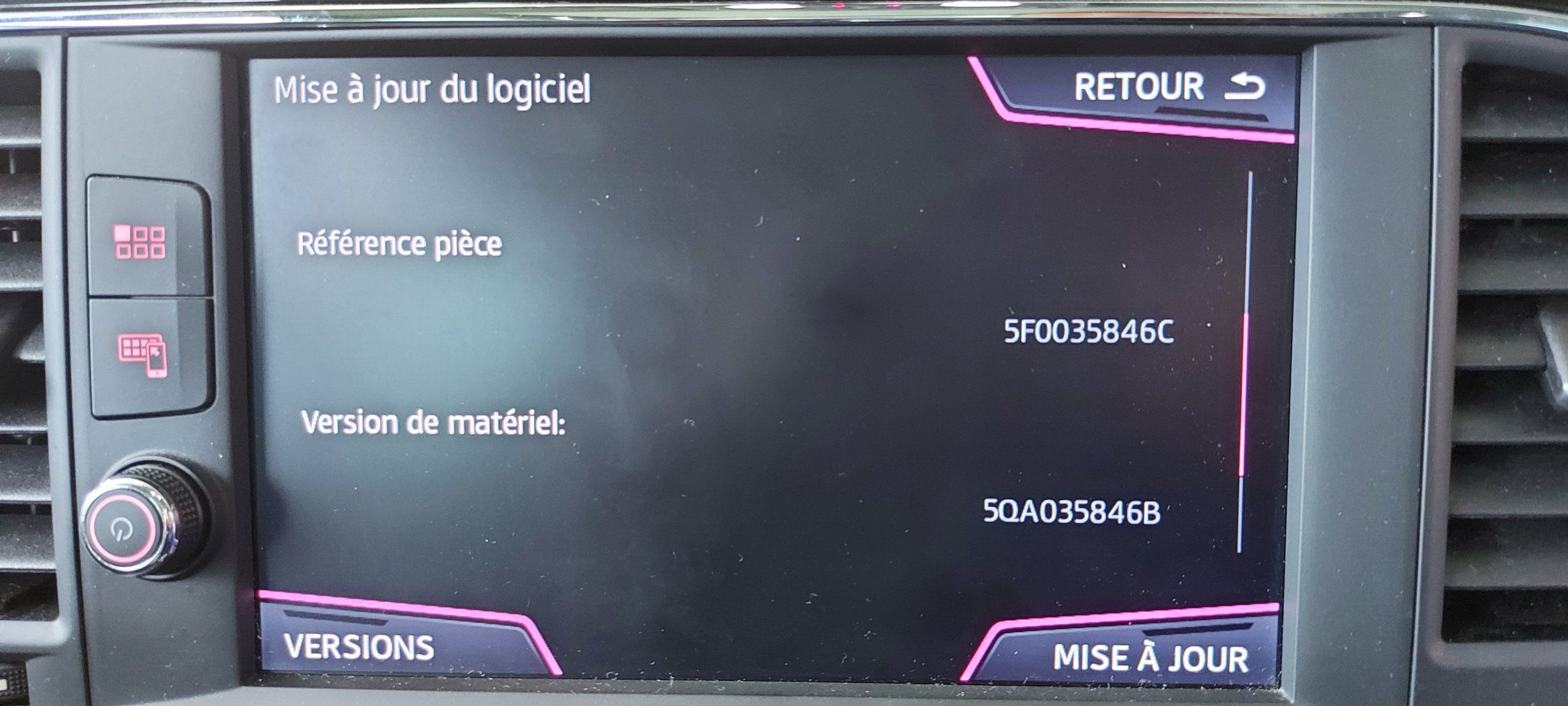

hello , i have a Léon st 2015 and i have This Mib i want to upgrade the system it's possible ? thanks

If it's the latest maps you are after for your 6P (November 2021) see here:
You must follow the workaround instructions... don't just delete what is on the card.

You can safely upgrade from 0241 to 0253. You will have to go back a few pages and look for a post with a link to downloading firmware. I've done this and it's nice and easy. I'd also update your navigation as it's several years out of date! Follow post #1033 for instructions.

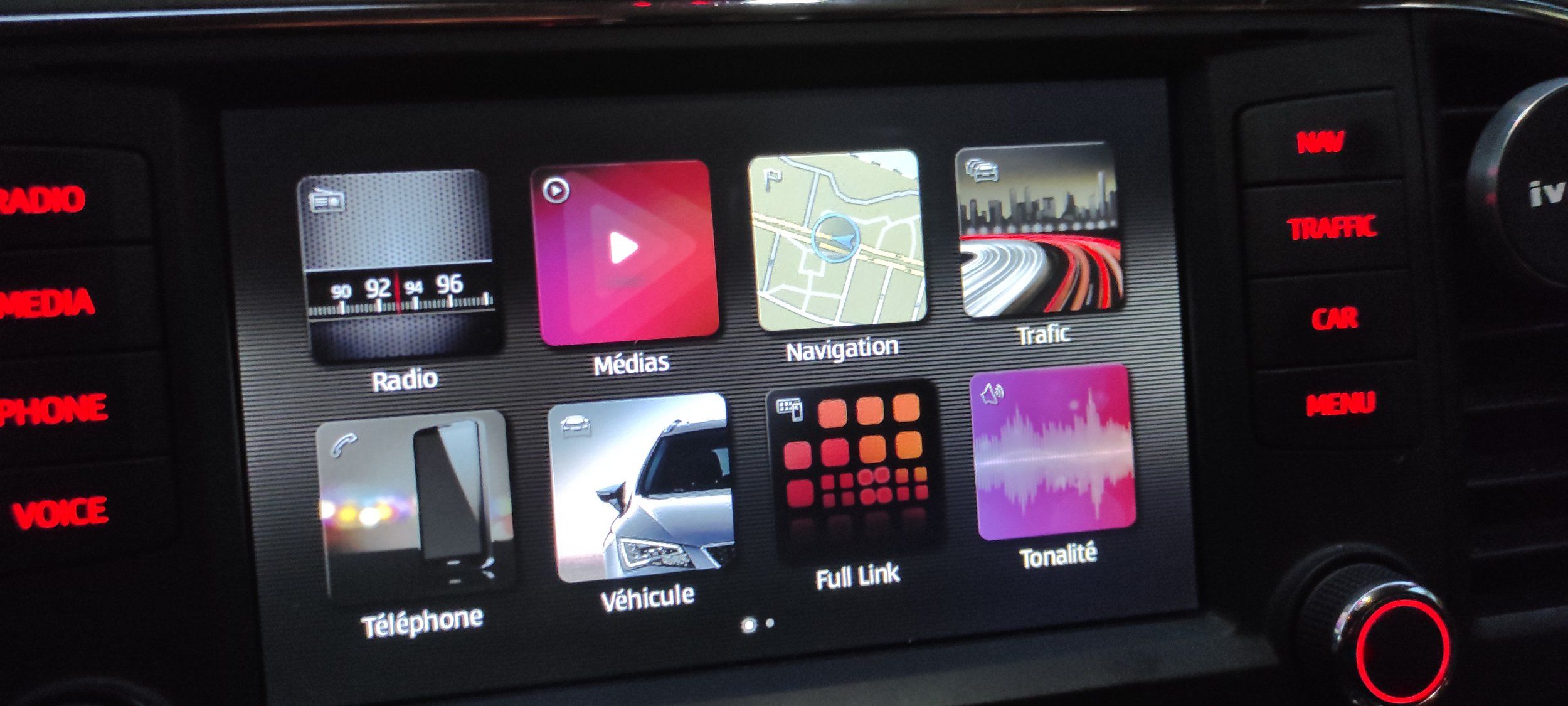

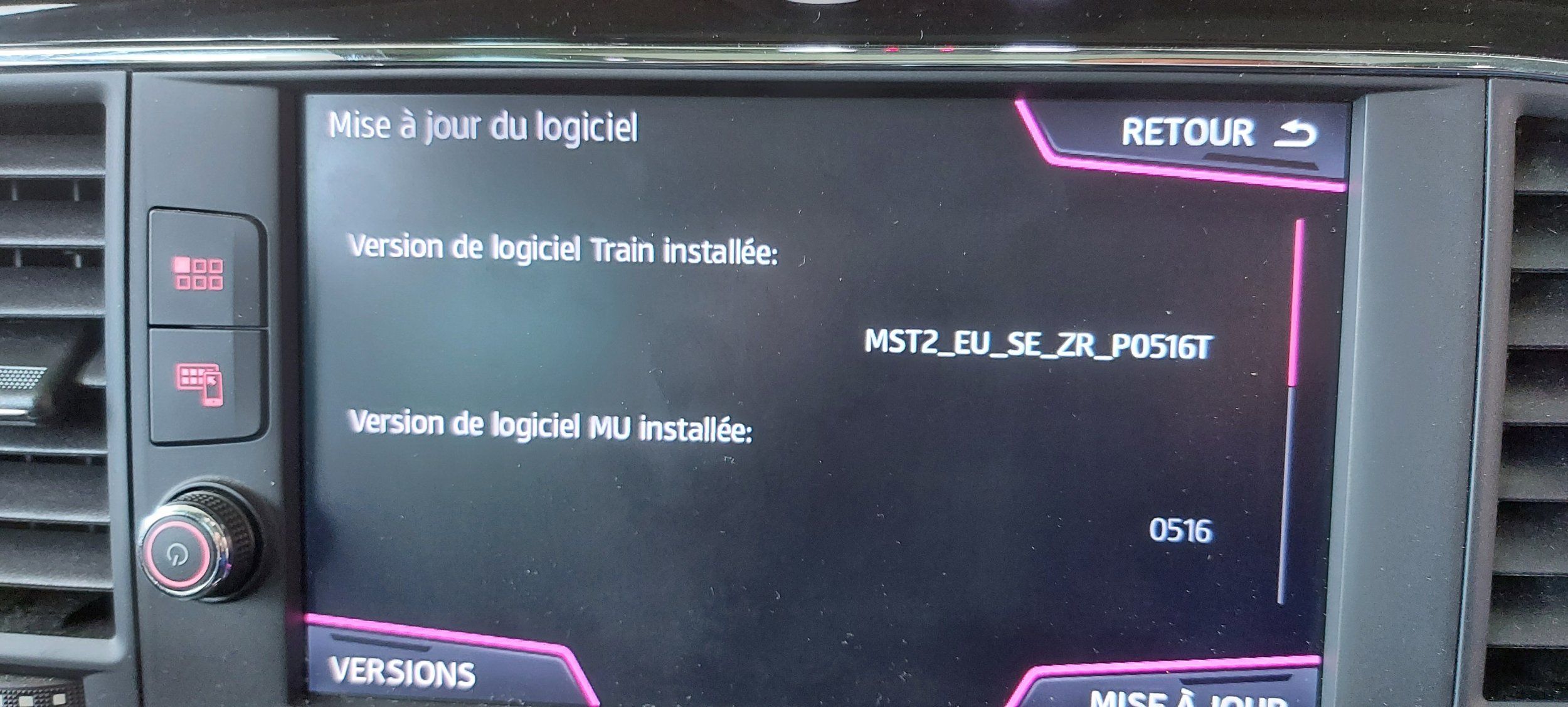

i find this too , in my menu
with the spanish forum i find uptade 241=>330=>346
