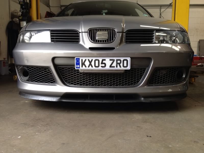

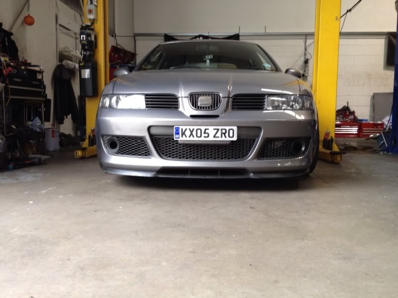

Stealth..
Looking good :p , stealth ftw :D
Haha, it's personal preference dude. Leave them in if you want to, don't have to commit like me lol.
I don't run a cold air feed, but I may do in the near future. Run it down to the fog from the groove in the front of the Jabba heatshield. 80mm should do the trick. But I'm not expecting it to make much difference if any tbh..
