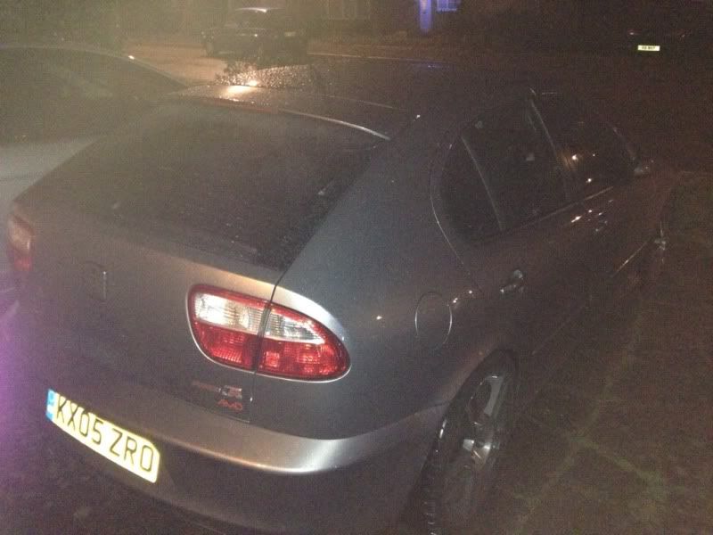

She's home!!! :D
I've driven it literally 2 miles home so far and was getting a feel for the new clutch so no Wavetrac testing has been done as yet!
Clutch feels like OEM, light and has a lovely bite too. Very pleased!
The gear linkage bushes seem to really have brought the changes all together. Seems very precise selecting gears now. The Forge short shifter is still on there. 3rd into 4th is a dream now, very very race feel about it. Love it.
The gearbox oil was all fully flushed and no corners have been cut which I'm always going to receive when it's with my mate Martin at his garage (Chelsfield Motor Works). Big thanks to them all there for looking after it and doing a cracking job. They treat the car like their own pride and joy.
Miles need to be covered now just to bed this clutch in nicely and make sure all is well ready for some proper driving! :D
