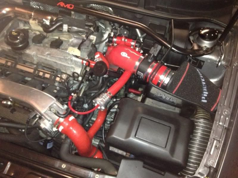

Your bay looks really good!

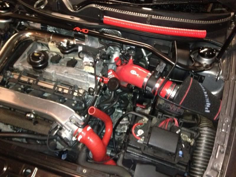

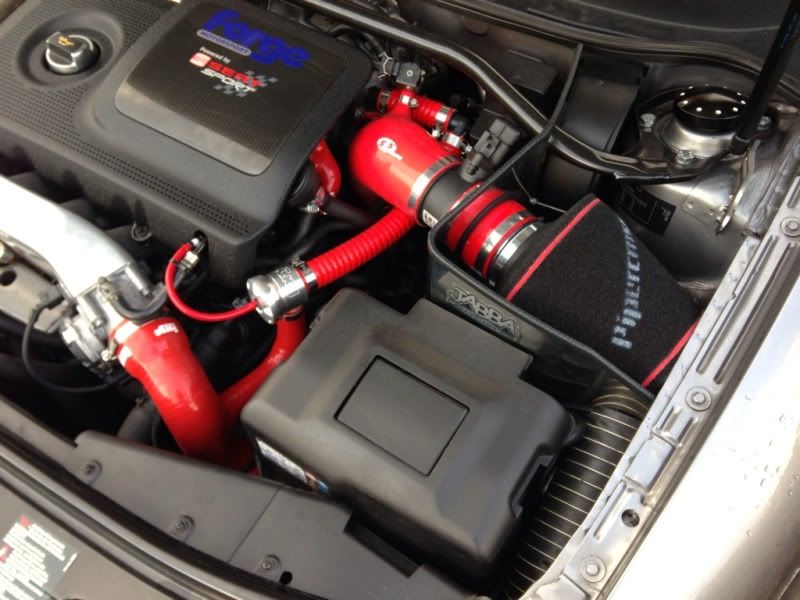

Stuck my middle finger up at the constant rain and sh!t weather and shoved the car in the garage for some engine bay upgrades.

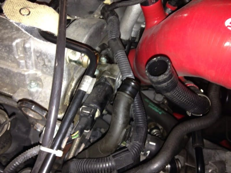

Started with the Forge silicone cam cover hose, nice 5 min job, 3 of those crappy oem clips prized off and new hose on with proper jubilee's.
Old out
New one in

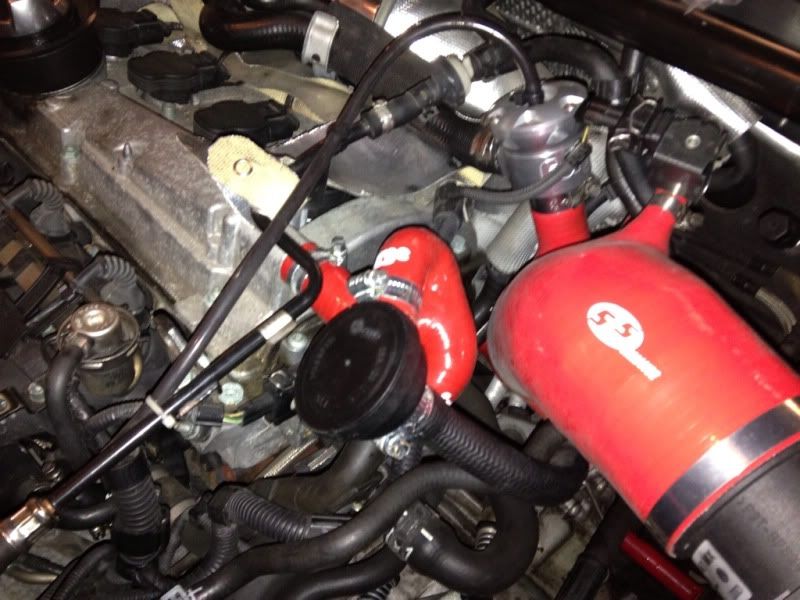

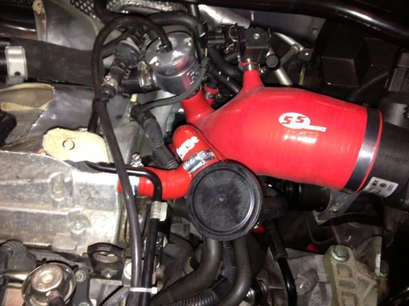

Then attacked the Forge DV re-location which was an ok job, bit of cutting here and there but happy with the end result. Got quite a surprise :D
What's missing, lol
In progress
Getting there
Done

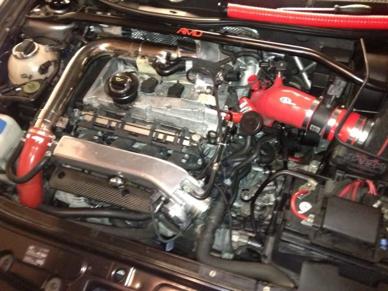

Now, I was dubious about how different the boost may feel with the DV re-located, but all I can say is what a difference. I must have either had a boost leak in my original cam cover hose, or a DV hose wasn't done right up tight or something, because it feels like I have gained 0.5 bar of boost or something!!! Feels outrageously quick . The wheels spin so early in 2nd the diff working very hard to keep it down. :-o So happy with the difference. Going to take it out tonight as I only took it round the block earlier.
Bad news is the ECS Carbon fibre engine cover is not lining up like sam bryant's one. When the oil cap is central the bottom to screw holes do not line up I'd say almost an inch off of being true to the holes. Shame really. I'm not gutting the middle around the oil cap so will be asking Awesome to send it back for a refund. Going to take the FORGE sticker off my engine cover and keep that one going instead sod it. Was worth a punt but I was aware they have had a few issues in the past. More gutting as I tried it at the other night but rushed it and didn't check how the oil cap surround was lining up. Never rush things!
Anyway, much happier with the boost and cannot wait to take it out tonight and see how much more there is on tap now :D

Air to the tubby will be cooler and denser but I'm struggling to believe it could make this much difference!? Would be keen to hear from other people who have had a fully setup stage 2 lcr and then changed the DV setup to this and seen what their findings were?
I need to have a good look at the oem cam cover hose that came off and see if there was a split in that or something, as it's a real jump in performance.
I noticed a huge difference in mine after I fitted a catch can. The boost was unreal after and like you said struggles for traction in 2nd and 3rd but I did have a boost leak on the pcv system. Yeah it would be interesting to hear of other people's experiences with it.
From hot side to cold side. Even on an OEM map with FMIC etc I noticed a difference. Definitely worth it IMO. Sorry to hear about the ECS cover Tom. You could have the battery and engine covers professionally painted (2k paint) to freshen it up a bit. I liked mine in matt black with lacquer finish. £130 of pennies to go on something else now... :)

I don't have a catch can, but have replaced the breather hoses under the manifold with the Forge one's just to future proof it.
Good to hear mate. I didn't expect such a difference, but my feeling is something wasn't right before I started yesterday. Boost is in earlier and much harder now.

So the short drive after the work on the bay yesterday wasn't a fluke with how the car went as I took the car out last night for a country pub run over towards Chelsfield not far from me then right over to Westerham and back through Sevenoaks on some big open country roads with no traffic, the car went like an absolute bullet train, so much torque pinning me in the seat. It tried to pull all over the road but the diff was earning it's £££ in the wet last night. Awesome drive and makes it all worth it!!!
Very very happy :D
