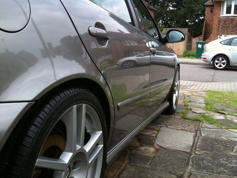

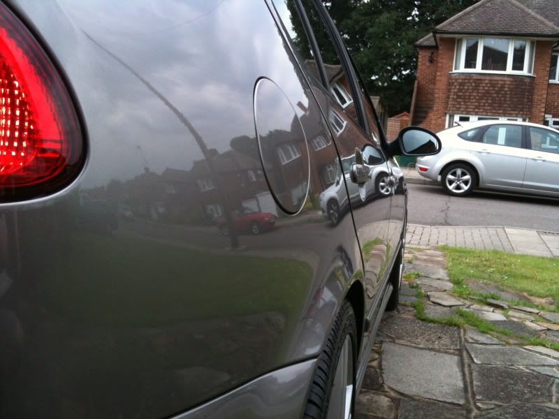

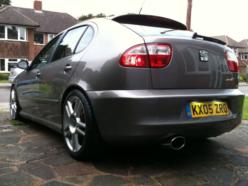

Gave the car a quick clean tonight as it got covered in bird poo while I was down Newquay this weekend. So I got to work not long after getting in.
What initially was a quick wash turned into a bit of a good cleaning session.
I have now started using Megs NXT Speed Detailer to aid my wash & wax products and I really do think it's great. I apply it as the car is beading before drying.
Also got the Autosol out and had a quick go at the Milltek exhaust tip. Came up well, but I will do it again next time and spend more time on it.
Anyway here's some pics. I got carried away by the way...
I love when a quick wash turns into a mini detail!
Great reflection shots mate, car is looking so so good there man, makes me wish I had looked for a Plat one!
Haha, you know it.. Always seems to happen with this car I can't just give it a quick wash it has to be done properly.
Cheers mate :D
Platinum was the only colour I wanted 2nd time around after having an Ebony black LCR before.
Yours is mint though! You and DK make the silver LCR's look awesome with the work you put in.
Meguires is awesome stuff,I don't bother anything else. Looking good fella,once I get my wheels refurb'd,I'm gonna get it detailed. Love your car,I've got the sake colour,looks brilliant when its clean.
It certainly is good stuff. I love this NXT speed detailer though. It smells nice too :redface:
Thanks mate, appreciate the comments :D
