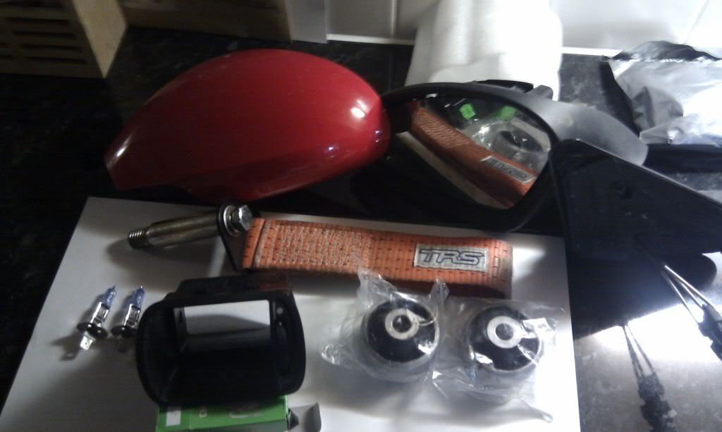

tear drop mirrors (manual but going to see if im able to convert to elec some how), 100w H1 bulbs for my high beam, TT wish bone bushes, TRS tow strap AND going to make a gauge pod for the vent as i was given a spare.
iv done a little how to for the TRS tow strap - this can be found here - http://www.seatcupra.net/forums/showthread.php?t=306614

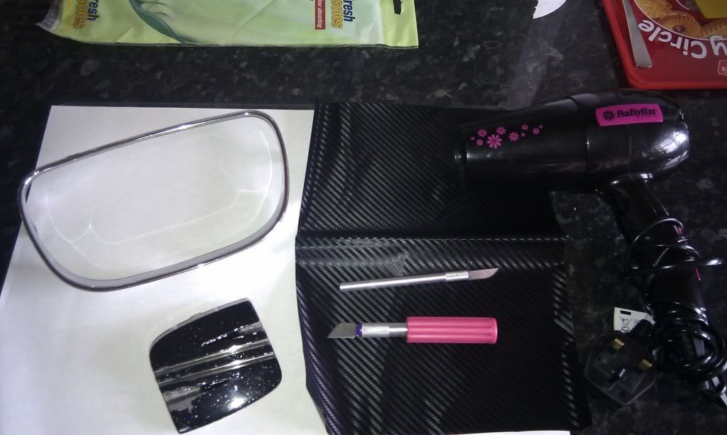

tools - heat gun / hair dryer, craft knife (SHARP), time - lots of it!! (yes my knife is pink!! so it stands out and can bee seen, and it was the only ones they had when i needed them lol)
other - carbon wrap - not cheap shat!

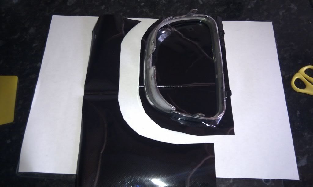

put the wrap face down and the grill also face down on top,
mark and cut round the grill leaving plenty of over lap for the edges and corners

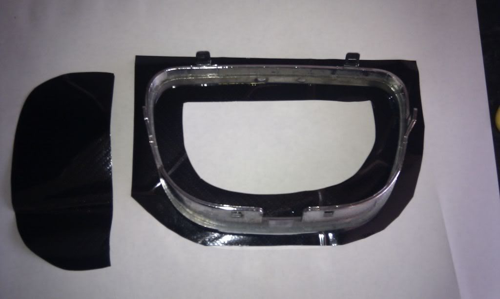

next mark and cut out the center of the surround make sure you leave plenty of over lap for the bottom of the grill, there is more surface there than it looks (where i went wrong first time round)
a point to make here - keep the off cut as the will also do the top and middle of the S badge too!!
now turn every thing the rite way up, lay the grill surround on the surface and peal the backing off the wrap, now place the wrap over the top of the grill surround making sure its square and in the rite position
gently heatthe wrap where ever you want to start, i started at the bottom and worked my way around, the corners are tricky, you will need to heat up the wrap so it goes soft and lightly strech it round and smothing it out as you go. (i found that when the corner is done make a little slit in the exess it stopped it getting pulled back off), i would say to make sure you go over the little ridges a bit so that when the grill goeas back together it will hold the wrap if for any reason it became un stuck
carry on like this untill completed

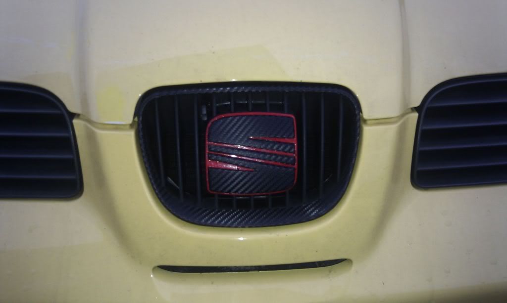

just noticed i didnt put a pic up of the improoooooved grill, wanted to do some thing a little diffrent this time though
h7 cya
Jun 3, 2009
453
That looks great matey although i think i would have done the red yellow on yours.
t32er
funny you said that mate, thats what im going to be doing next, im guna do the grill gloss black, it is black at the min but my gloss spray managed to dry sattin???? it lost me but i think it was just too cold out side when i did it really
nice work terry but sorry to give you the bad news, its not new or different :( mines been on over a year now :D
t32er
i was talking about the red mate, every lcr owner and its dog has done the S, im a sheep like every one else
good work on the surround though sam, sure it was silver at trax...

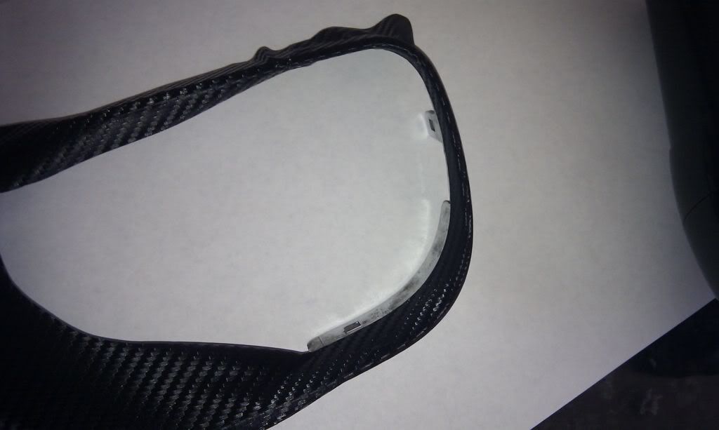

i see you broke the backing of the S too, mine was plastic welded in, took me ages then i broke it lol
