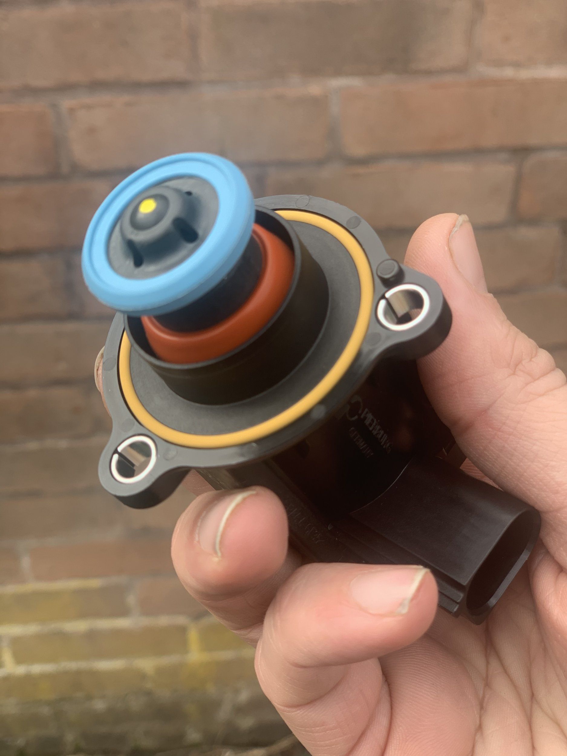

The diverter valve arrived last night so I fitted it first thing this morning, the difference was immediately noticeable - the boost seemed much better and smoother too but after warming up the revs are still fluctuating between 900 and 1500 so there’s still a problem to fix somewhere.

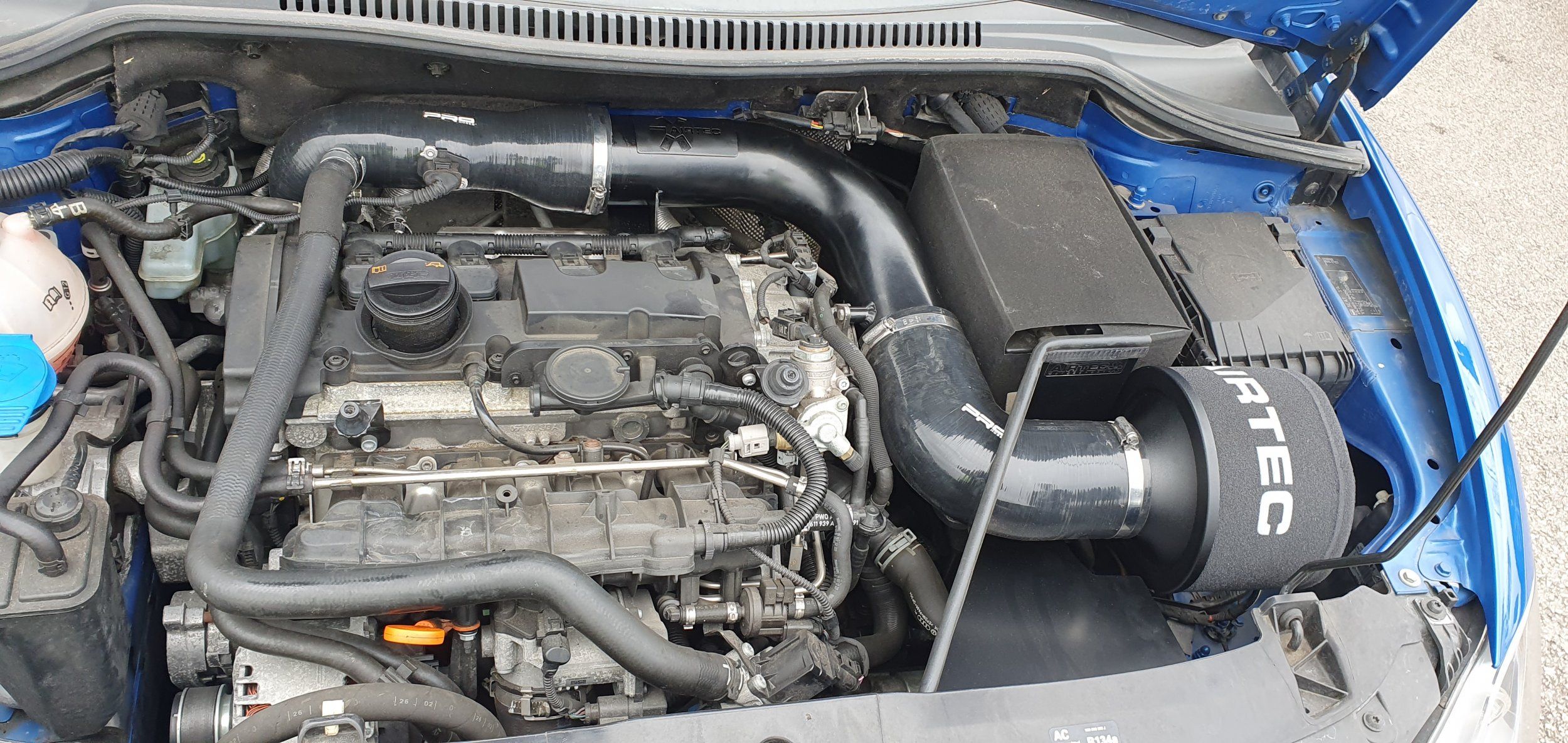

I've done airtec induction and Milltek cat back and will be doing stage 1 soon. I was wondering if it's worth doing PCV, cam follower, R8 coil packs and diverter valve (recirculation valve?) before remapping. Will these thing produce more power or is it just a preventative measure when going for mre power?
And is there any other low cost engine mods to aid a stage 1?
