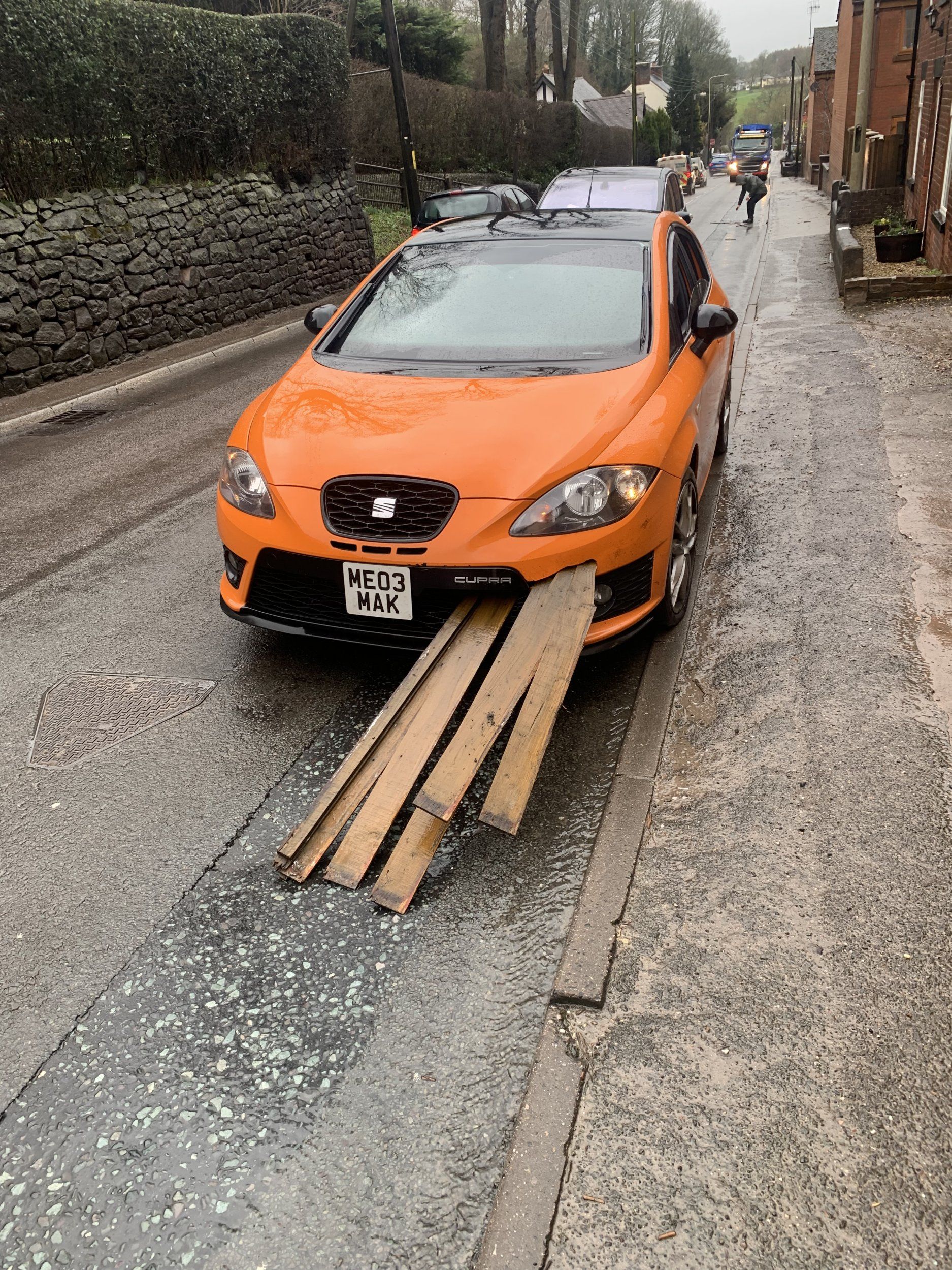

Unfortunately last week another problem has “cropped up” courtesy of storm Eunice, a man replacing his fence panels and some very bad timing.
A gust of wind blew one of the fence panels into the road directly in front of me and…
The damage is luckily only cosmetic but according to the insurance company is a complete write off, to make matters worse I’ve temporarily lost my no claims bonus while they wait to see if the fence panel owner makes a claim for his damaged fence!

Cheers! I hope so too! I’ve sent plenty of info over to my insurance company including the dash cam footage so I’m currently awaiting a reply, the last thing I want is for the car to be written off. I’m going to try and get some quotes from some local body shops this week.
That's really unlucky fella, I don't understand why the insurance would call it a write off if its cosmetic... From the pic it looks like might of got the intercooler, is this not the case? Also i heard if you've gone through the claims but not proceeded with the insurance claim you still get shafted with a claim on your file which is crap. I doubt the guy would claim for a fence panel cheaper to buy for for what 30 quid?
I was pretty lucky where it hit, It missed the inter cooler by a few inches, the only other damage was a punctured tyre and a small dent in the wheel arch. I tried to explain to my insurance company that I’d have just bought him another fence panel if that was a problem but it’s all about procedures unfortunately.

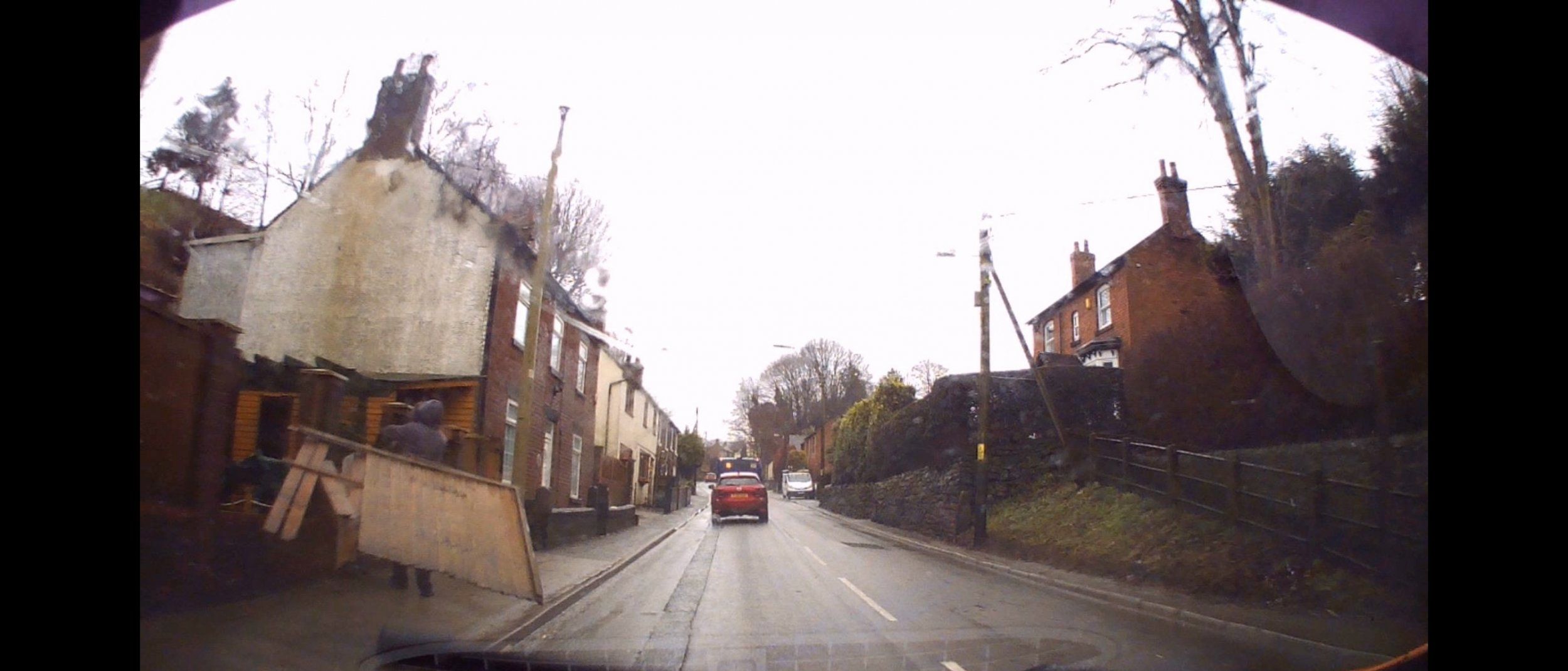

Luckily I’ve got a friend who owns an insurance brokers and he’s been able to give me a few pointers, because the dash cam footage captures the owner of the property working on the fence (he’s in the picture picking up the debris from the road) it shouldn’t be classed as “an act of god” and depending on whether he’s got house insurance it could be a straight forward claim from him. If not he could still be prosecuted but I’d still lose my no claims until all of the costs were retrieved. With regards to the fence panel claim, as it currently stands if he doesn’t make a claim in the next six months I’ll get them reinstated but hopefully once they’ve reviewed the footage I’ve sent them they’ll see that it was completely his fault.
This is a screenshot from the dash cam
If he doesn't have insurance or doesn't claim but says the wind damaged his fence and he was trying to secure it etc basically saying its not his fault, it would still affect your insurance as an "at fault" because they can't get him/his side to pay for your damage.

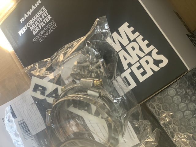

Finally last week I got round to ordering myself a Ramair oversized induction kit and as soon as it arrived set to work installing it.
After around 2 hours and several cups of coffee later the kit was bolted on and ready for a test drive. From all of the reviews I’ve read about the awesome sound the oversized induction kit produces I was expecting some good results, but nothing could have prepared me for the actual noise that this beast creates.
For anyone wondering whether to fit one my recommendation would be a definite yes, the throttle response seems to have improved and I’m hoping that I’ll have got some small power gains too although I’ll know more when I go for a remap.
