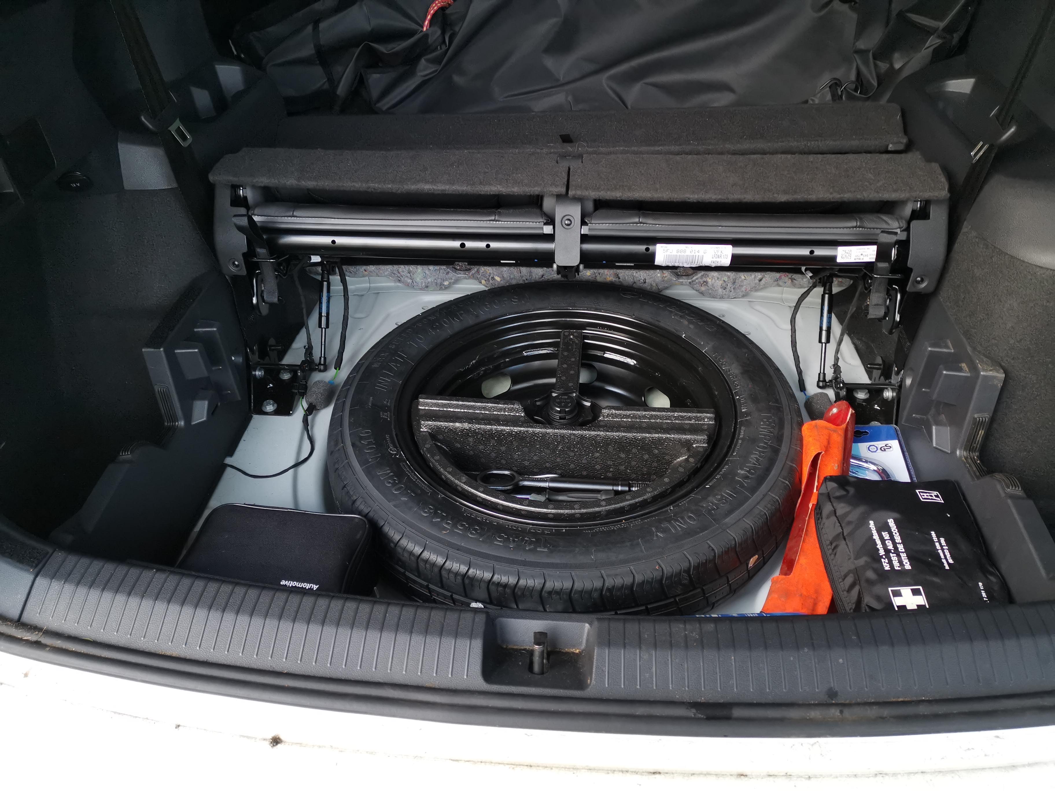

Hi
I just bought a spare wheel kit from the Wheel Shop £150 (meant to be genuine VW part).
I’m not clear if I have it fitted properly and have a bit I’m not sure where it goes.
Would appreciate if someone can post a couple of photos of the boot with the cover removed pls
Thanks from a newbie

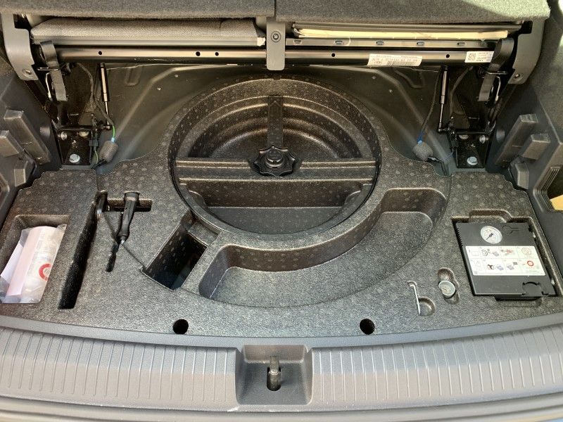

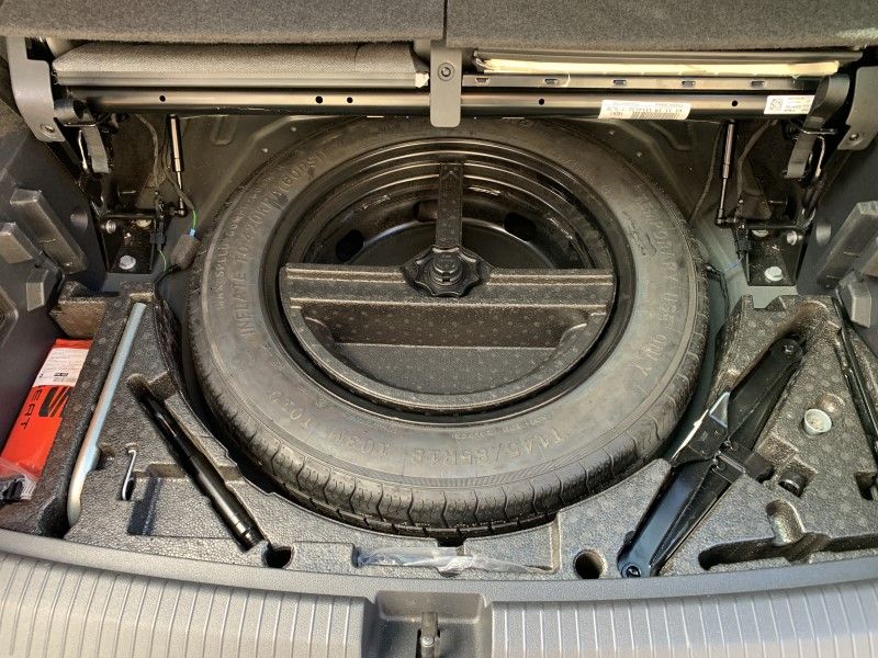

Old thread resurrection alert, the OEM SEAT Part is ZGBBOM180SE and is better than vanilla aftermarket as it contains a foam insert as a replacement for the tyre repair kit insert so everything is firmly into place (no rattles, noises etc).
Before
After
