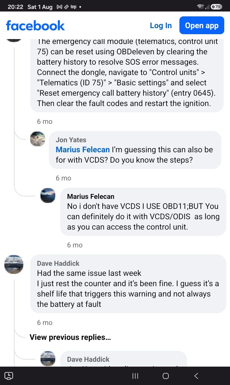

What i wanted to know whether it was an obd11 clear errors rather than ODIS.
I've only ever used ODIS to carry out the process. It basically tells the OCU that the internal battery has been replaced.
I would imagine that other systems are also capable of carrying out the reset.
OBD11 has some functions under Basic Settings for Telematics unit, only two of them look like they might be related to this reset action:
"Resetting of all adaptation values" (sounds a little scary)
"Resetting the history of the emergency call battery"
(Maybe this is the equivalent of the ODIS function?)

Yes, I would imagine that the second option would do the trick.

You'd think so. We want the first person doing it without. Might be on Vag boards. Did a Google. So yes its done like do.
Then checked the AI answer wasn't rubbish. Found that. In this post:

STG 75
BASIC Setting
Reset learned values
Batterie Error gone without Change

I have an OCU 3 on my desk. This device measures the state of health (SoH) of the backup battery. Above a certain value,(<52%) the error is triggered. Deleting all learned values resets the system to a new state and makes it think a new battery is installed. The system cannot distinguish between an old and a new battery.

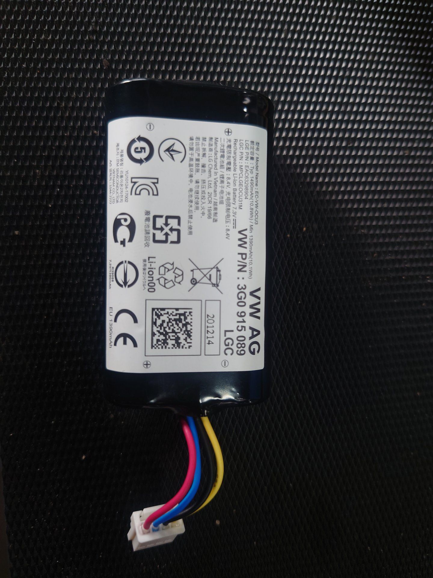

The Batterie from a Scala
Skoda 99€
After Sales 15-25€

Thought I'd better do a Google on the expected life cycle of that battery pack (lithium ion type).
5-8 years in a car. Suspect for VW they reckon its enough. The coding trick of resetting the deterioration measurement without changing the battery eeks out that period, but where the cells are blown that would be the time to stop doing that coding trick and change the battery pack. A dealer will just carry out the manufactures maintenance procedure. Think I'd only do the coding trick once myself without changing the battery.
