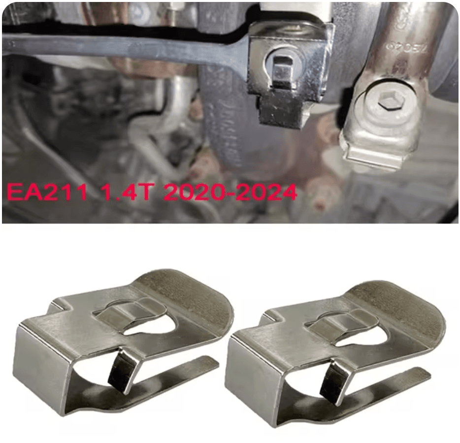

I have a 2019 FR ST in the 1.5 TSI 150ps variant and it seems to have the actuator rod rattle that the 1.4/1.5's experience. However all information on fixes are for either the 1.4 or the 2.0 engine and the rod looks different to those engines. Is the fix still the same? (High temp grease).
I see some people use this little clip on the 2.0 engines but wondered if it would work for the 1.5.
Any ideas from others?

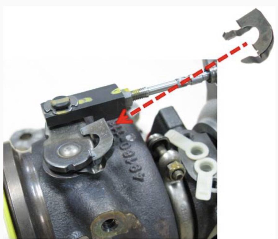

Part Number :05E198701A
I believe that this repair kit should be provided for free, and not sold for exorbitant money

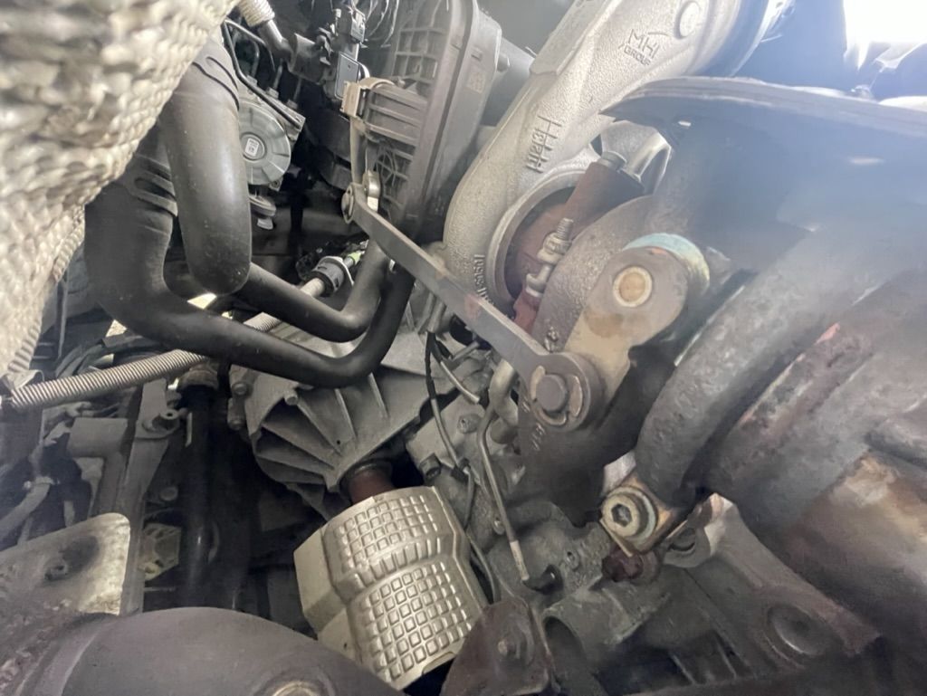

Thanks for your reply. Agree it's ridiculous they're charging for this! Spoke to the parts team who said the part without the 'A' on the end includes the actuator rod, would I need that too? Or just the washer and circlip?
pavel1771
Oct 20, 2014
12
no rod required. The factory must install this repair kit free of charge and apologize for its mistakes to the consumer. I accidentally found a new turbine and actuator on the market. Installed and there is no sound.
