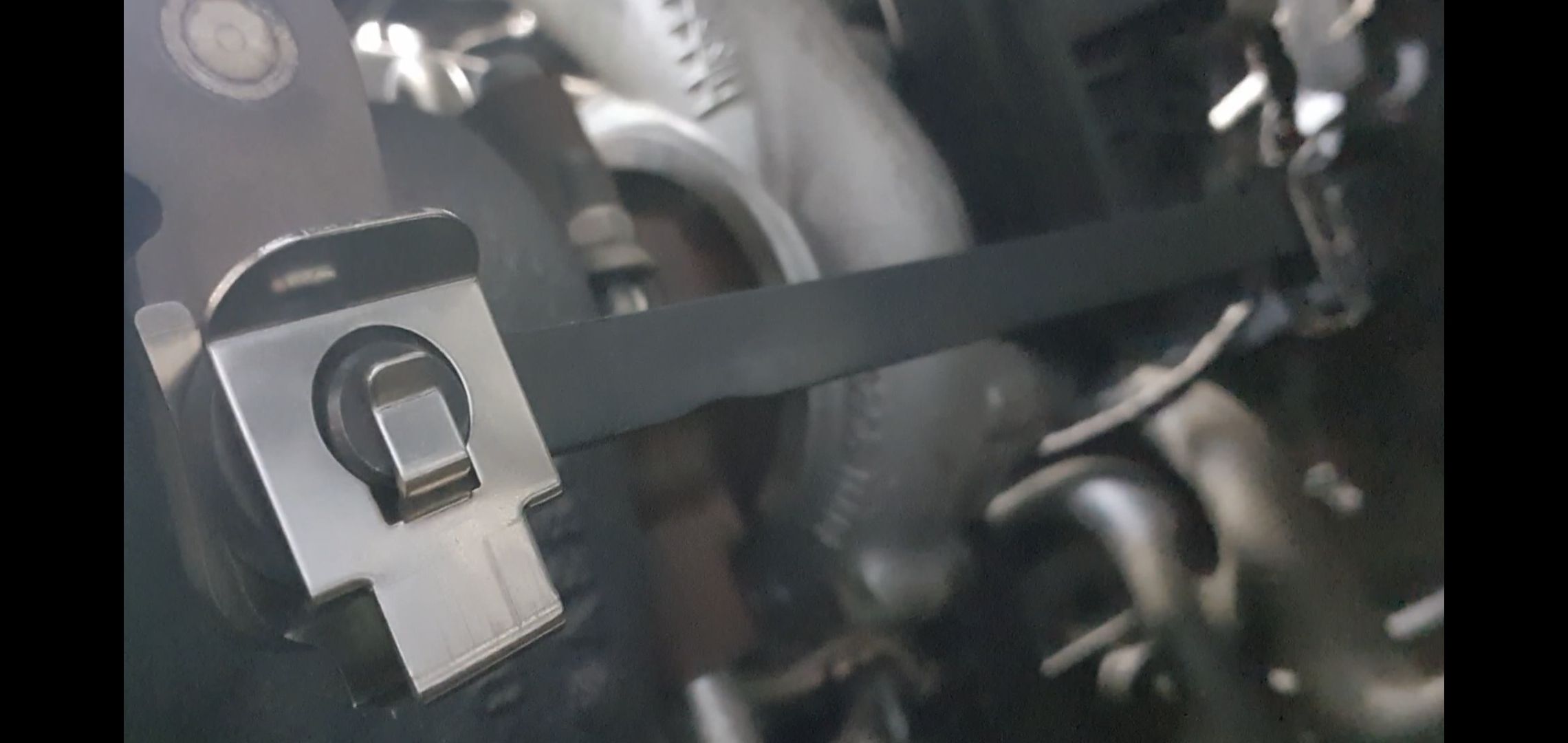

I ordered the clips for now, I can't wait to get rid of the noise!

It’s less than a 5 minute job to fit the anti rattle clips, I used a small mirror to help me see at the back of the turbo
I'll try that when they arr
Which Seat email address is best to contact? Thank you mate, I'll try a mirror when they arrive.

Clips fitted, no rattle on start is a good sign, I just need to check for a rattle during 2 cylinder mode. Thanks for the Info guys ?

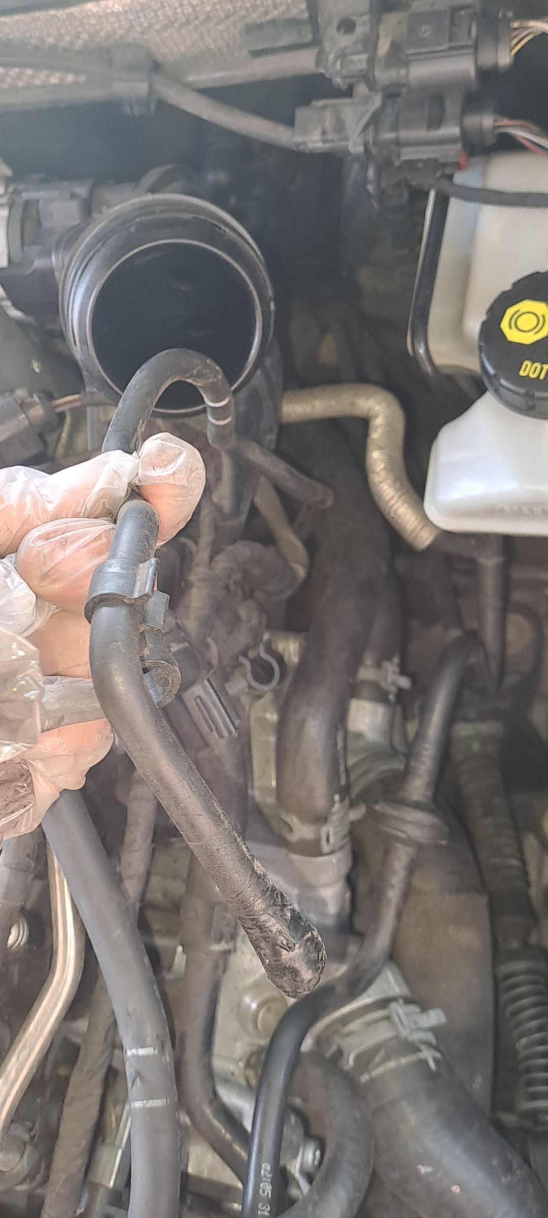

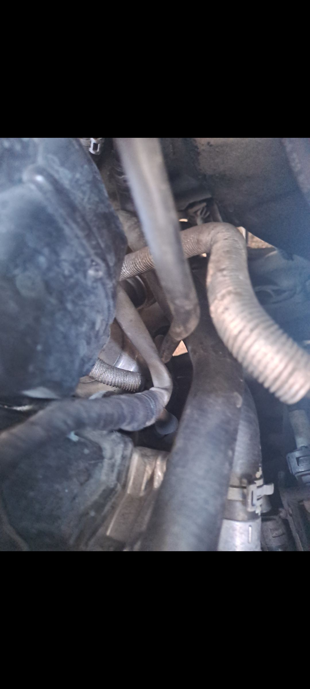

I had the same problem, I took it to the mechanics, etc. They found that the rattling was coming from a hose, maybe it's the same with you. They plugged the little one and the errors started, high rpm, high pressure, and the check engine light came on, but the rattling was gone. However, I tried to unclog the hose and the car cleared the errors but it started knocking again. So really, if anyone knows where this hose is and what it's for, I'd be grateful. Here are some pictures of the hose in question that goes down to the turbo somewhere
