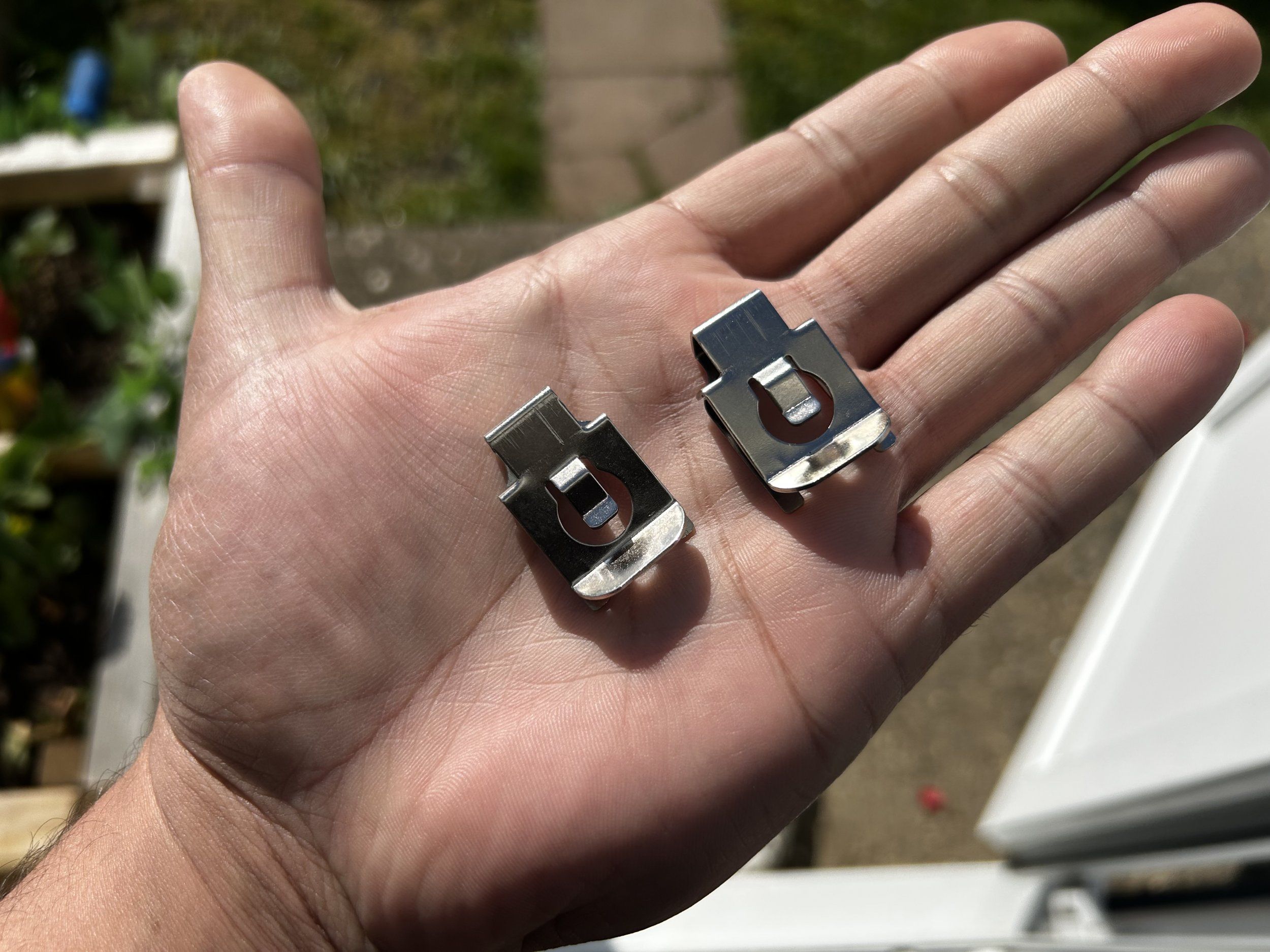

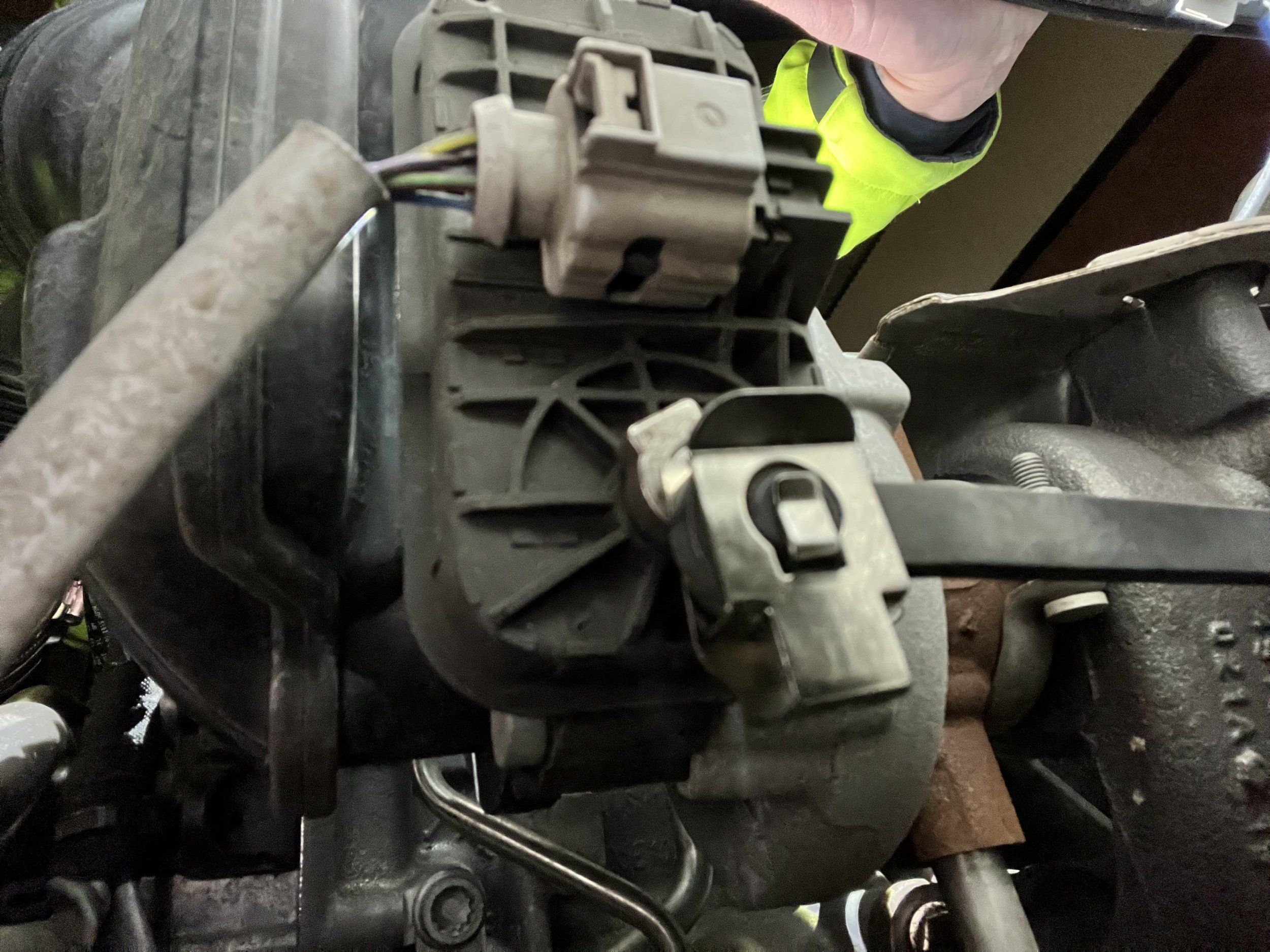

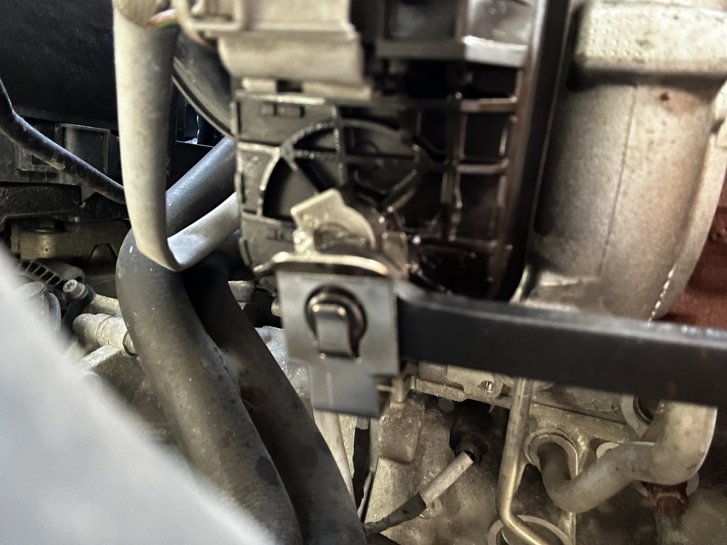

Hi is there a way you can show how you have installed this? Also how long have you had the clips in? Iv heard in a lot of forums that they tend to fall off very easily. The sound is driving me crazy. Can hear it whilst travelling at low rpm
I’ll try and post a pic, had them installed for a week now and they’ve not moved at all, maybe others have used a different clip hence why they’ve fell off. The ones i got still allow free movement of the rod but just take up the slack enough to stop the rattle. I was also wondering about them falling off but after a week they’re still in place
Reactions: Walone
Sorry for the delay, forgot all about the photos, but here you go

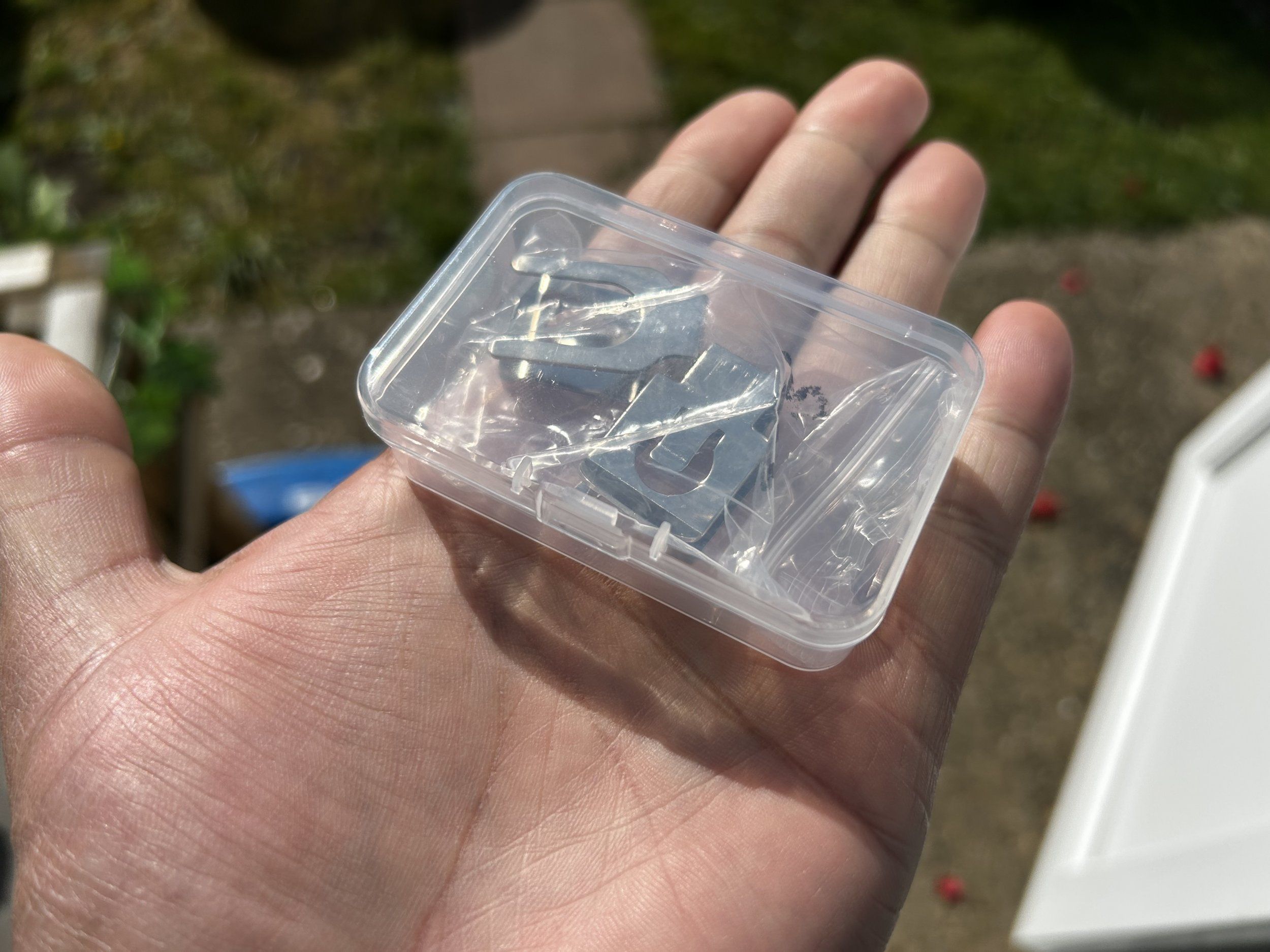

Hi everyone. I dont have a Seat but i do have 1.5TSI Golf Estate which has the DADA engine.
I have only owned the car for a few weeks and noticed recently the rod rattle primarily on start up and occasionally when the car enters 2 cylinder mode so was on the hunt for a fix.
The excess vibration is what leads me to believe the reason for the rod rattle as it doesn't happen when the car is idling or driving normally.

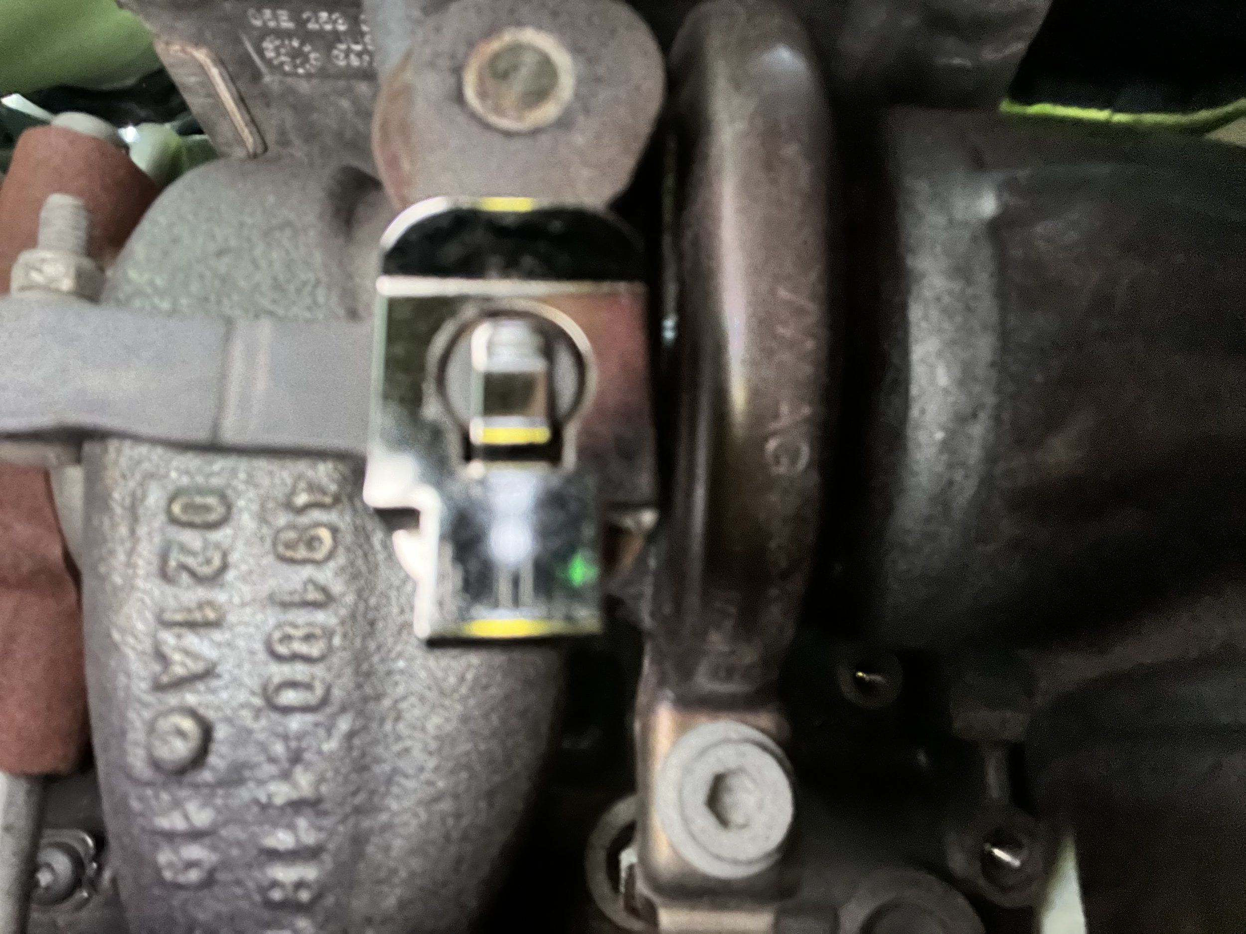

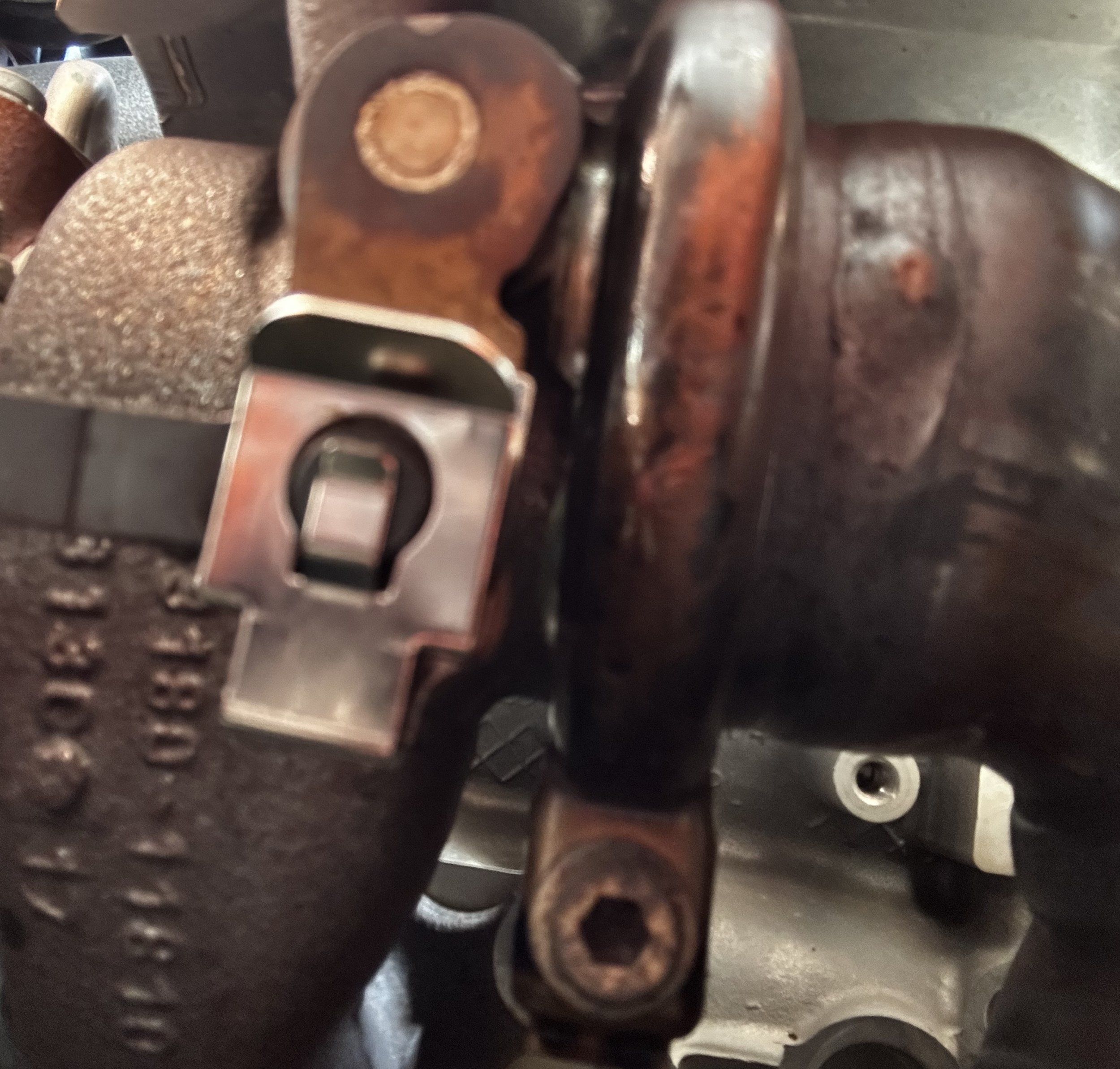

I joined the forum to pass on my experience with the mentioned above clips (9mm)
Just fitted these from aliexpress:
These are the 9mm versions as mentioned above: https://es.aliexpress.com/item/1005007389376633.html
They even come in a nice little box
Can confirm these are a perfect fit and slot into place nicely and snug but still allow adequate movement and can be rotated freely.
Started the car up and seems to be fine.
is this a long term fix? Probably not but for very little money its worth a try if anyone is dealing with the same issue.
Reactions: Walone and decker53
View attachment 48018View attachment 48019
View attachment 48022View attachment 48023

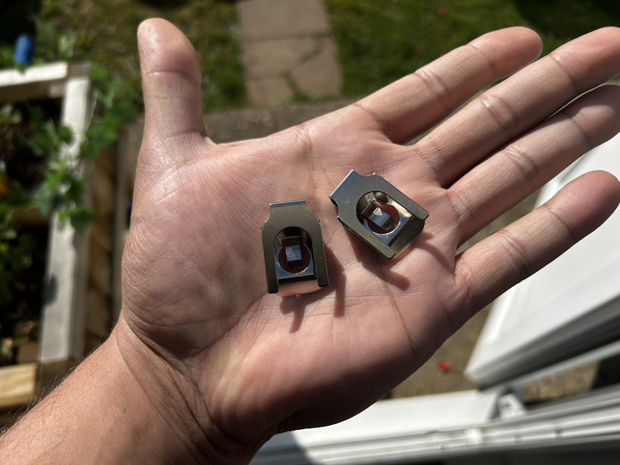

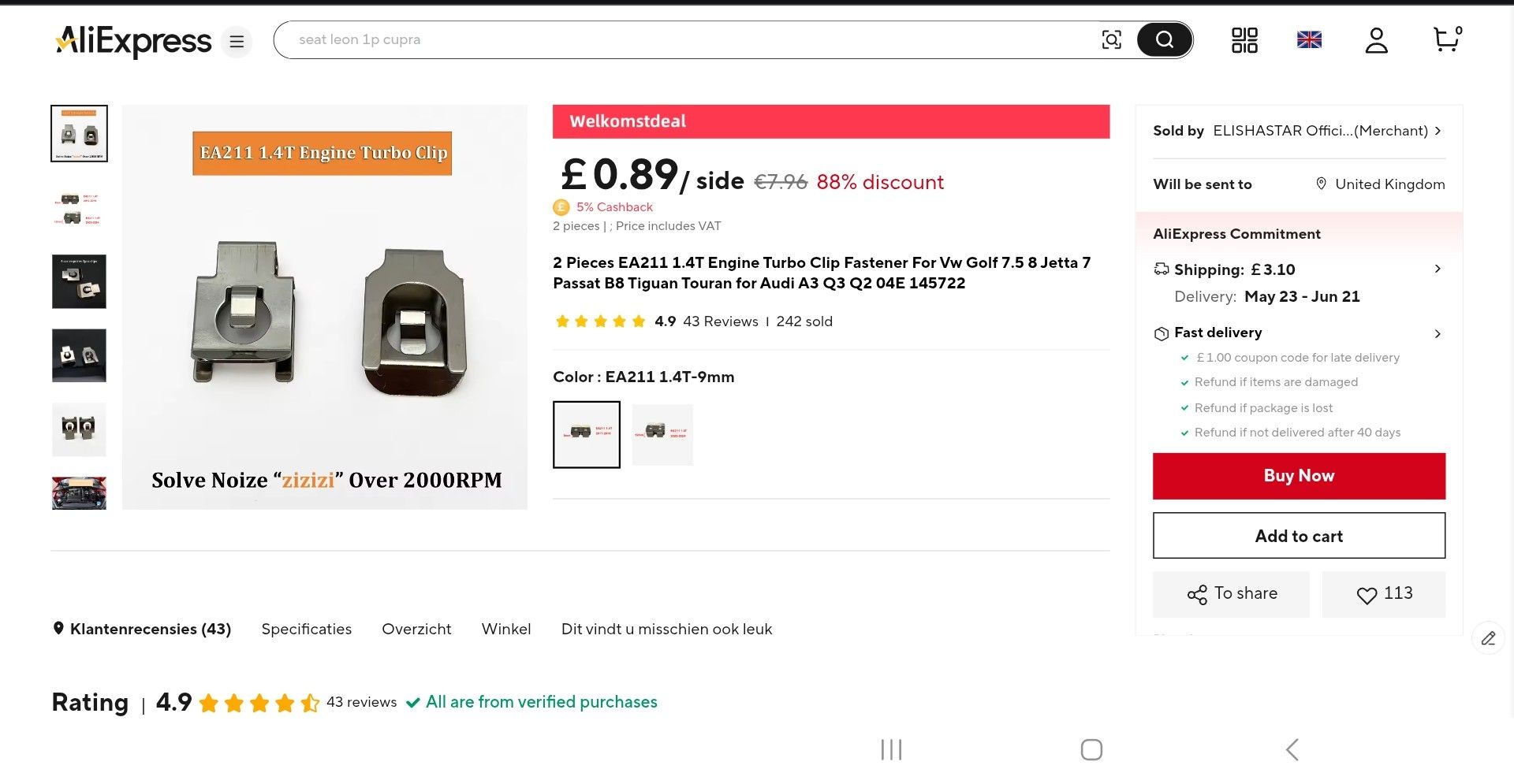

Update, the clips arrived, fitted in seconds and have stopped the wastegate actuator rod rattle. Very happy at a £10 fix compared to a couple of hundred quid at the main stealers ?
Which ones did you order please mate? The rattle on my 20 plate it wrecking me! My dealership told me it was a characteristic of the car when I had them look at this a year ago!
Hi mate, sorry for the late, I got these ones, fitted great

lol I got told the same “they’re all like that” there’s no fix.
Cant be bothered fighting with these idiots he clearly just couldn’t be bothered and didn’t even look at the issue.
