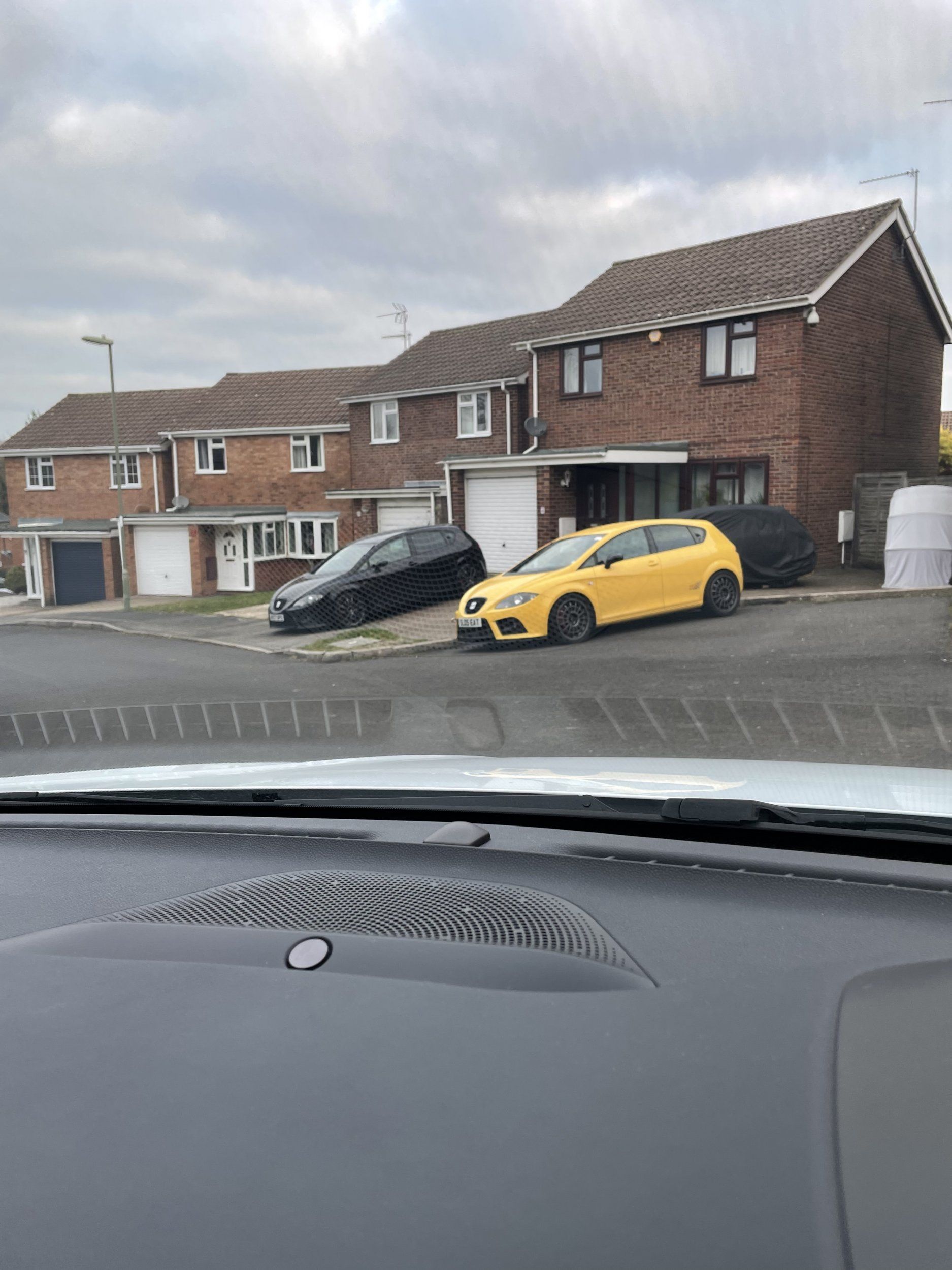

I still haven’t touched the new car I’m just trying to engine it for awhile before I ruin it with the parts off the yellow one. It is nice to finally get a black mk2 everytime I came home and see it I’m so happy it’s mine. So I know but was dreaming of one for so long now. I’m definitely not looking forwards to how much work it’s going to be to strip the yellow one to a shell and rebuild the black one with its parts.

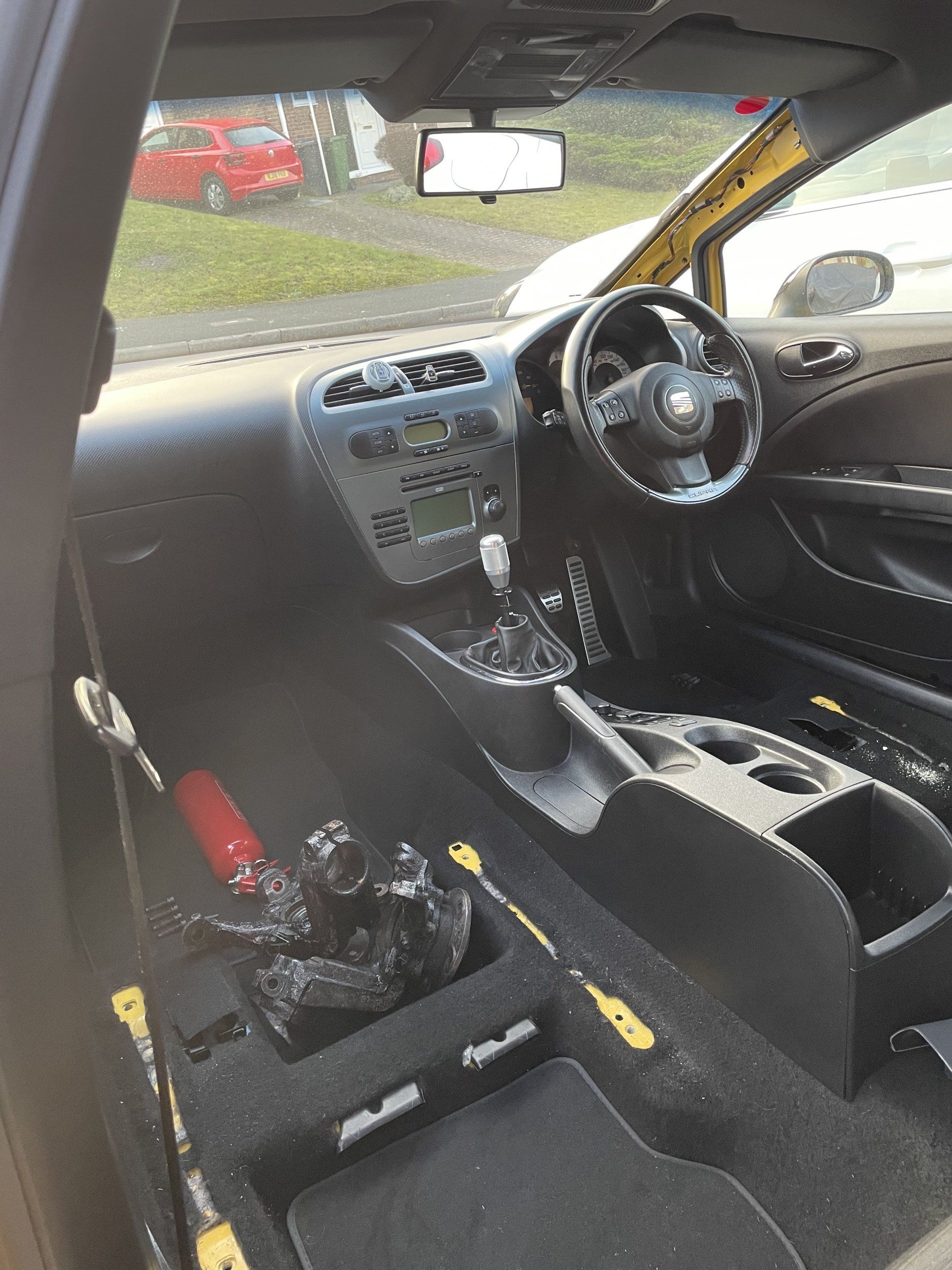

Just a small update I haven’t touched the cars at all I have afew new parts to fit to the black one in the new year and then start stripping the yellow one to finally swop the good parts over to the black one.

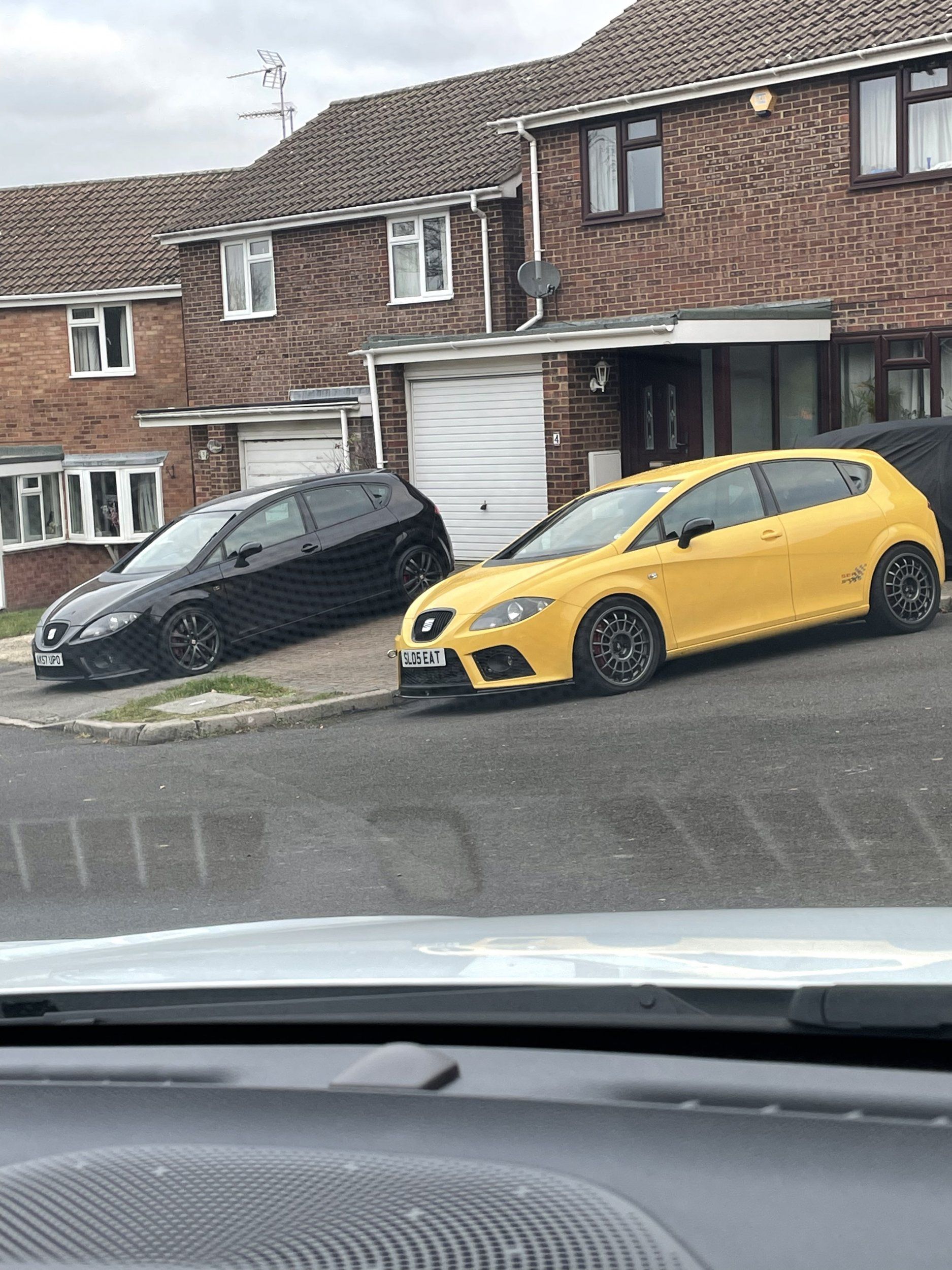

Hi mate yea the plan is fit my regal built gearbox with wavtrac my cooler workz shifter both anti roll bars and afew other bits from the yellow one into the black one I’ve got the brand new 18z and ebc blue stuff to swop over too. A lot work ahead but will be my ultimate track spec in my dream colour mk2 so all good. I’m breaking the yellow one for bits I’m not keeping. Can’t wait to fit the wavtrac and cooler worx shifter into the black one as it already drives really well. I took it on track for 20mins 2 days after I got it too I cooked the brakes the first lap lol but was pretty good Overall. And yea I’ll swop the wheels over when I do the brakes too.

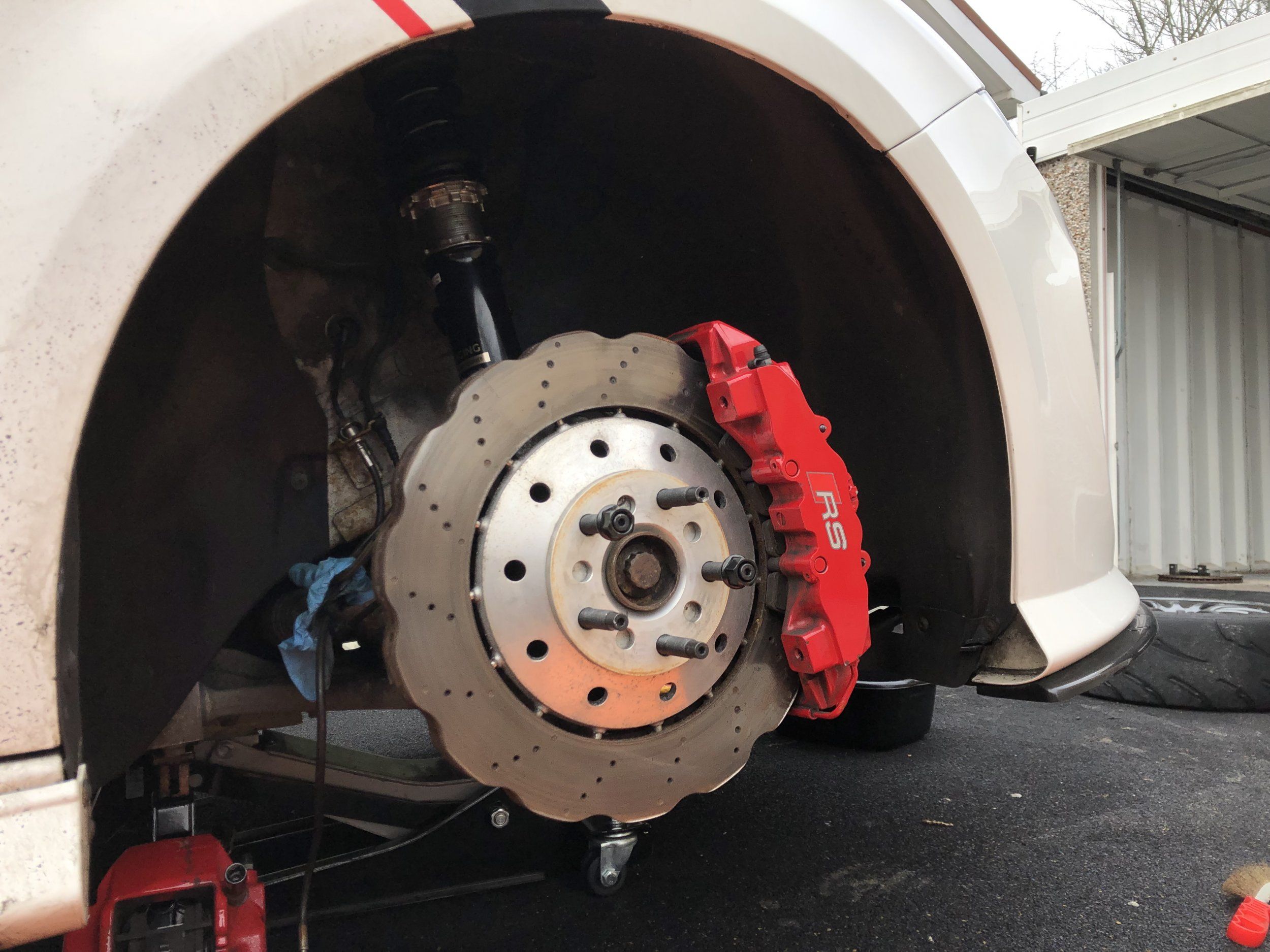

I have done a cheeky brake upgrade myself :p

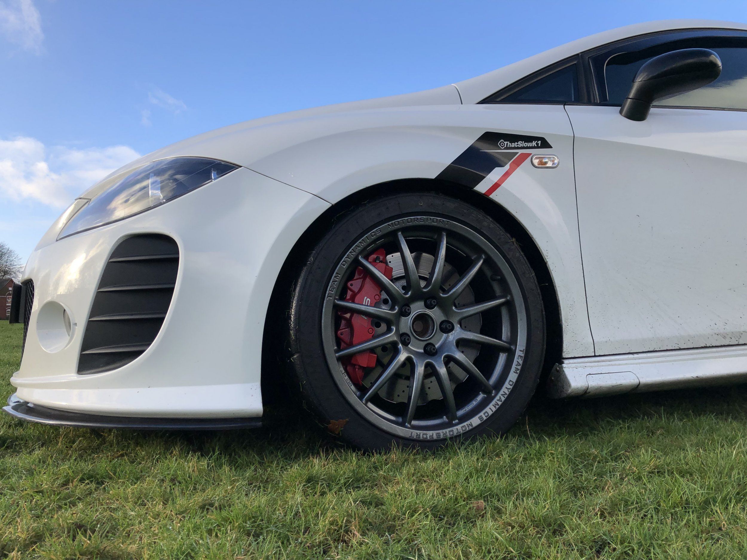

RSQ3 8 Pot caliipers with 365mm wavy discs.

Nice did they bolt up to the Leon alloy hubs ok or did you have to change them to tt mk2 like me?
The K1 has alloy hubs as standard mate so they bolt straight up.
Did you have to upgrade to go to cast hubs running the 18z callipers?
No mine has alloy hubs but the spacing was wrong I had to fit tt mk2 front hubs which have a better geo too and better placement on the ball joints but it caused me a head ache with the track rods to over come that I’m having compbrake make me some rose jointed race track rod ends to properly fit the hubs just awaiting for them to deliver them. If yours bolted straight up I’d say yours is a lot better setup and you’ve got 8 pots mines only 8. I could have just fitted the steel mk5 golf hubs and it would have been a straight fit but didn’t want to take alloy hubs off and fit steel.
Reactions: thatslowk1
Ahh yeah I have heard they are better for handling but never really looked into them though - deffo sounds like a cool upgrade!
The kit is a full RSQ3 setup and it bolted straight on basically - rather impressed tbh.

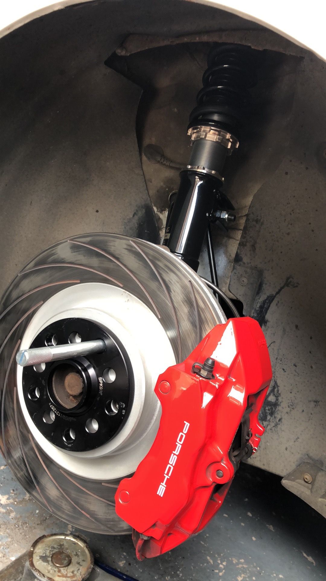

I will be honest with you I had a Porche 911 (996) 4 pot setup before this which come with brackets for only cast hubs. Luckily VagBremTechnic did adaptors to suit but I had to sack them off as they screeched a lot. I spoke to a load of people and they all had the same issue and the only fix is to run standard OEM pads.
Pic of the original Porche setup - sneaky pic of the BC's I have on it too which I have not put on my build thread yet.
