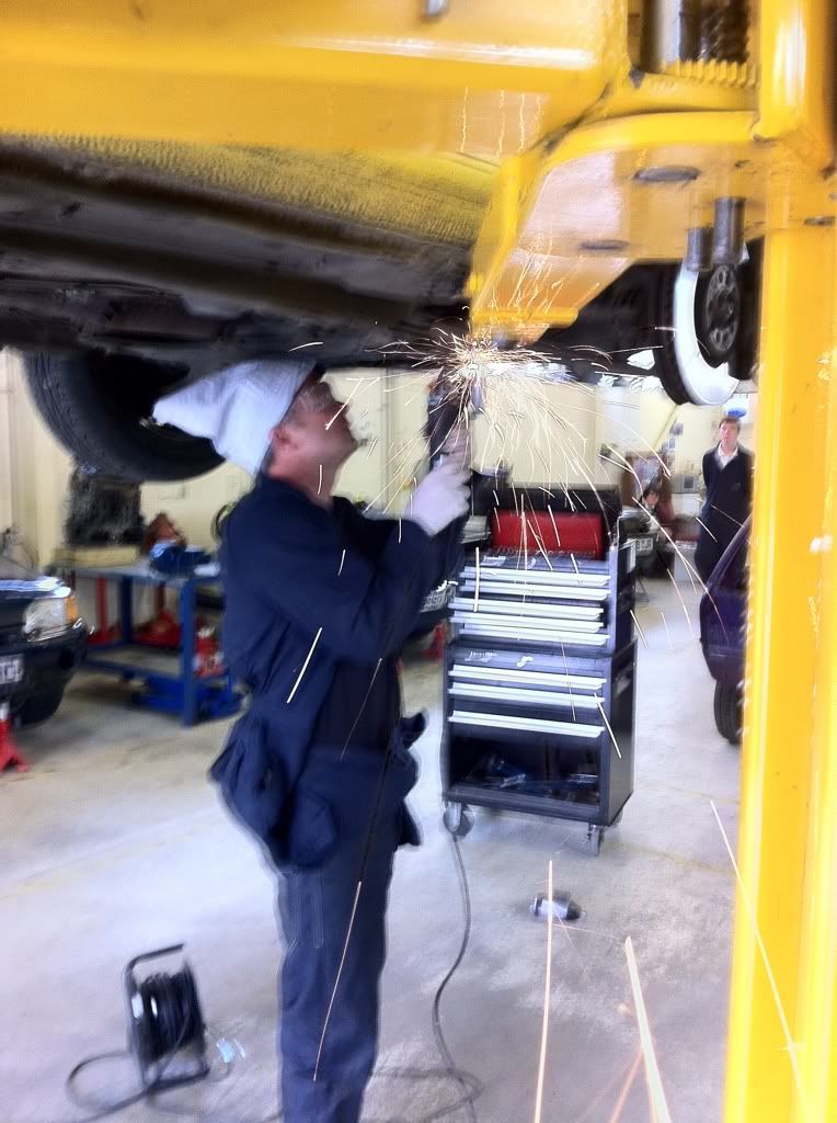

As above but be warned! Sometimes the nut inside the subframe comes off and then you have to cut a hole in you're subframe to weld it back on then repair the hole and fill and seal!
Check it out!
Cutting!
Then the nice hole!
So don't worry if it happens! You just weld the nut onto the inside again! I welded in a bit of metal after then filled and smoothed then sprayed it!
Ak
