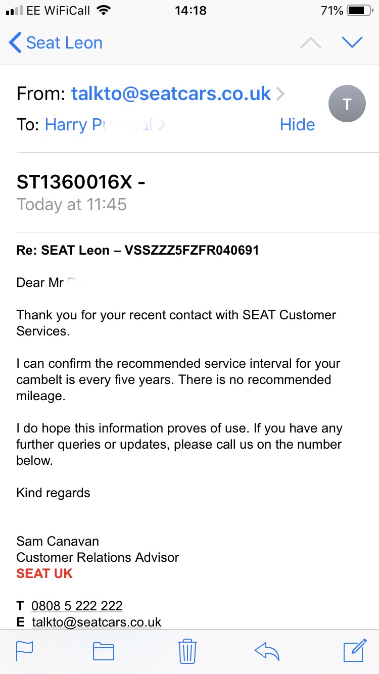

Email off to Martorell let's see what Seat's response is and put this to bed hopefully

See my previous reply have taken your advice and sent off an email to Martorell hopefully full clarification will be forthcoming!!

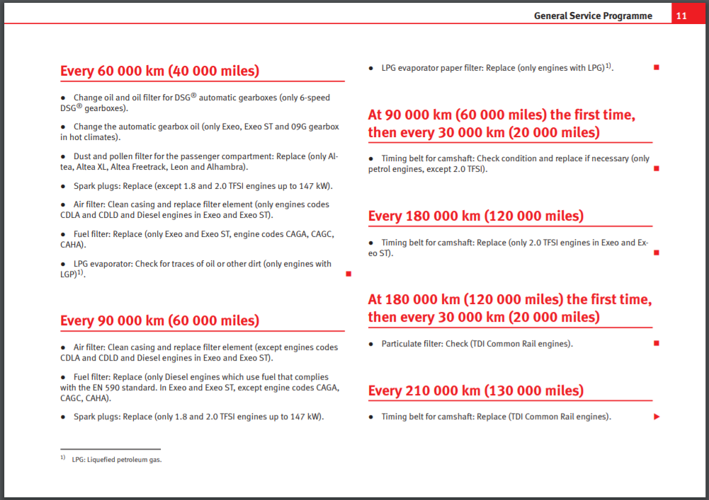

I'm pointing out that SEAT have actually handed over time and mileage recommendations over to dealerships, in essence they can make up any time period or mileage. This isn't winsical thinking on my behalf, their are numperous posts on this very subject on the Leon facebook group and multiple people have been emailed multiple different answers to this very issue from different SEAT dealerships. They told me over the phone there is no information on our car. This cannot be considered to be legitimate practice from a major car manufacturer.

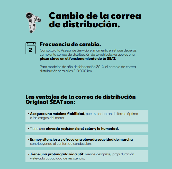

The maintenance manuals actually show them doing in insitu and how to check, I also read through the SEAT Espana maintenance page and after a little translation it stated timing belt to be changed after 210k kms (130k miles), no mention of time scale. After checking the older SEAT service book pdf's is says timing belt to be inspected at 60k miles and replaced at 120k (petrol) and 130k (diesel), again n mention of time period. This information is no longer available though in the UK as the info has been removed from just about everything from what I can see.

The maintenance manuals actually show them doing in insitu and how to check, I also read through the SEAT Espana maintenance page and after a little translation it stated timing belt to be changed after 210k kms (130k miles), no mention of time scale. After checking the older SEAT service book pdf's is says timing belt to be inspected at 60k miles and replaced at 120k (petrol) and 130k (diesel), again n mention of time period. This information is no longer available though in the UK as the info has been removed from just about everything from what I can see. View attachment 5533 View attachment 5534
TDI engines not petrol. Petrol 60k inspect and replace if necessary??

jimmy1751
Mar 10, 2019
11
12
Lots of interesting contributions and it does seem 5 years is the time to do cambelt change. However the recommended mileage seems the unknown here.
