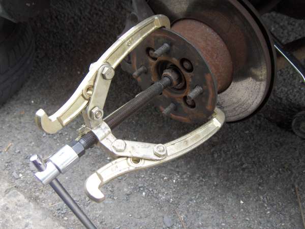

have taken the hub and shaft off as one then used a large hydrulic bearing press to press the shaft out. it is possible
Iv got a couple big pullers like that, the mechanic said hes sure its doable just wondering if theres any tips. Thanks for help/ pics!!
when i lowered my leon i had to use a puller set to get the driveshafts out the hub dont forget that when using a puller you dont just wind it in you have to wind it tight then hit it with a hammer and repeat the process
