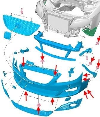

Hi Anybody know how to remove the top grill. Two pins at the top are obvious but what else is there. Used to have the manuals but won't run on present computer.
Jun 20, 2022
Doesn`t it just lift off when the two plugs are removet. Looks like there is nothing else to hold it in.
Derbian
Aug 12, 2013
92
Derby
Thanks. Tried it yesterday and it came out without too much bother Had to punch the top two pins out but after that it's just pull it forward at the top and push backwards at the bottom and eventually it lifts out
