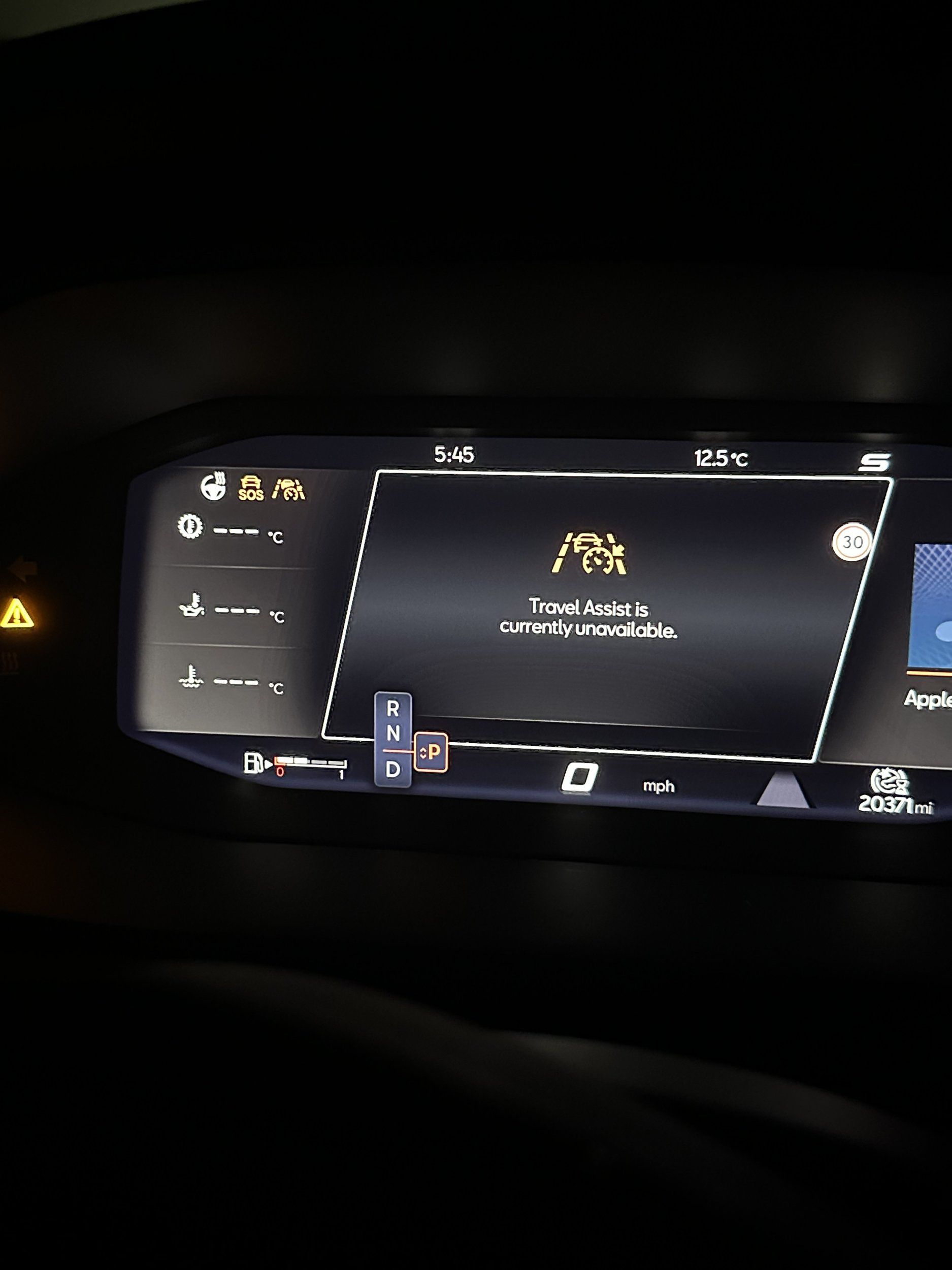

Has anyone ever had Travel Assist & Emergency Assist errors come on all the time, multiple times a journey?
Becoming really annoying now with all the beeps. Started a few days ago and won’t go away. Comes on when I turn on the car, then will disappear for 30 seconds before coming back on and beeping. This is a constant cycle ? Sensors are all clean, this comes after a gearbox fault last Friday too.
Cars booked in at the dealers for the 30th but is there a way to atleast turn it all off until then? Getting sick of it ?
Thanks in advance

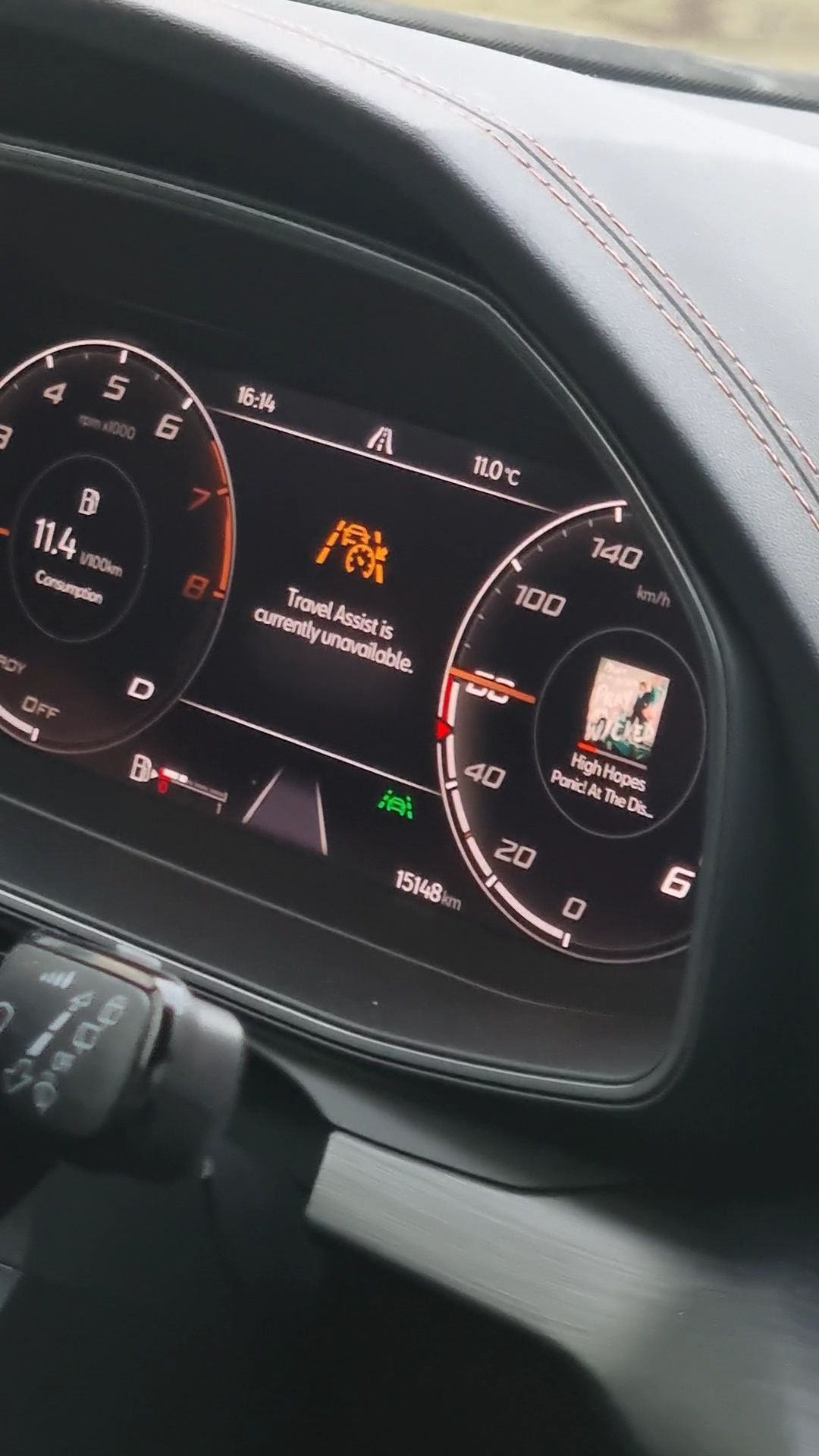

I have had the same issue with my Leon for the past few weeks. Not the classic SOS error, but constant warnings from front assist and lane assist, often also road sign recognition, side assist, exit assist and start/stop. I wonder if this could also be the telematics unit?
When I first took it to the dealer they concluded that it was related to my broken rear view camera, but I'm 99% sure that is not the issue.
I have the car booked in for the 10th, but the service rep seemed rather clueless, so it would be nice to have something specific to bring up.

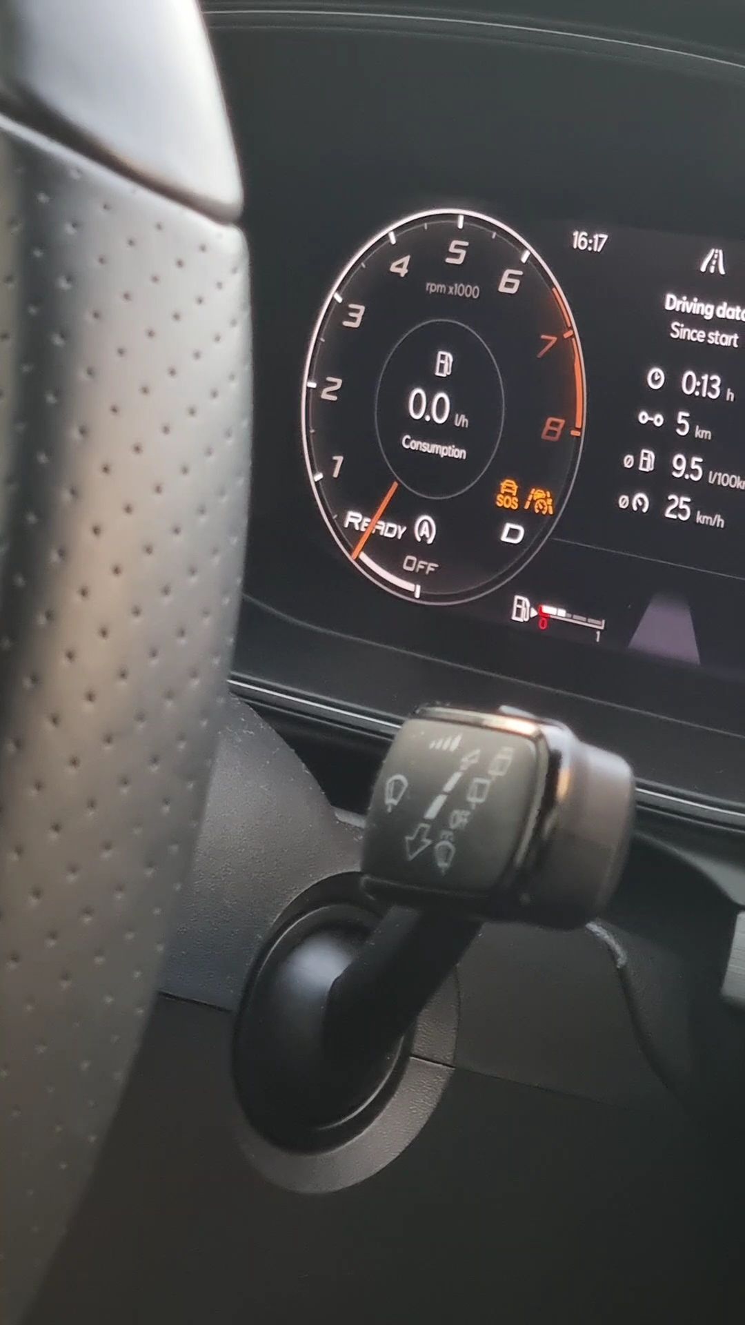

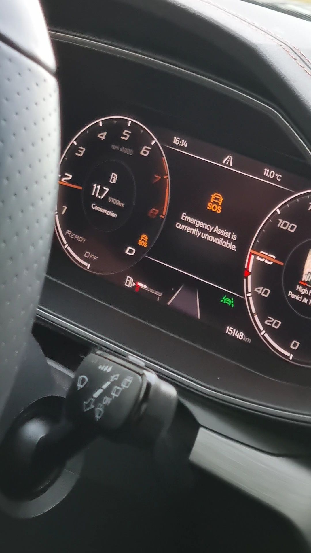

My car started from november to show the same errors. They appear and dissapear in seconds, being very dificult to concentrate on driving.
I can have days or weeks until they appear again. I initially thoght that maybe the windshield is not clean or other sensors but it hapenes also after a complete cleaning.
In my case they appear more while driving in cities or outside on roads with curves. In fact the errors seem to appear while rotating the steering wheel. On motorway it did not happened until now ( probably the moves are not so sudden like in cities). The errors dissapear while driving. If the error has appeared an i stop, they remain whyle stoped.
I saw on vw mk8 formum the same issue appeared and in the case of that person it was solved by changing the steering wheel.
How was it solved in your case?
