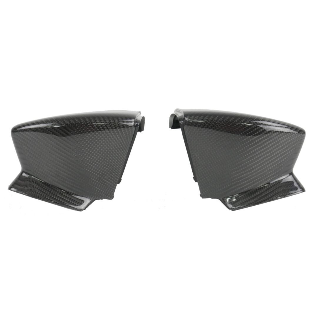

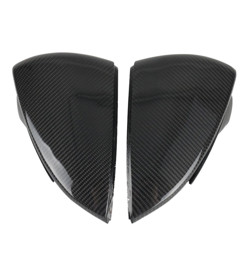

Even my car didn’t arrive yet, I ordered some little things...?
Carbon fiber mirror caps, think they will come great with graphene grey colour.

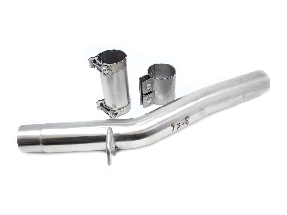

Also ordered resonator delete pipe kit from Progressive parts. They put some videos on facebook and think the sound with their kit is just perfect for me. Not too loud, just little bit sharper and more pops and bangs.

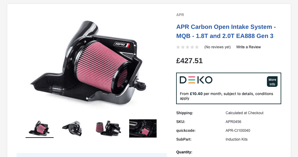

I'm in touch with APR waiting for confirmation if this intake will fit the Formentor.
Also the pipe, turbo inlet and the coolant hose. Same modifications you can fit any golf R or leon cupra with no sweat.
Hope to get an OK soon so I can buy and test it out.

Same did me with VWR and Revo. Just waiting to get mine just to pay a visit and check if turbo inlet and others fit. They believe just because is MQB platform will fit but they cannot ensure to me, they want a few hours just to test fit' some parts and... leave some installed in 'appreciation'.
Laughed and joked it about leaving a Stage 1 Revo tune (the chap near me is Revo and VWR dealer) along the programmer.
In my case, I don't have any garages here in Dublin AFAIK that could install, and the store I checked, they have a no return policy in case it doesn't fit.
Keep us posted if that works =D

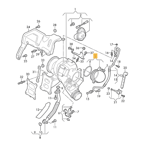

This is the turbo inlet in Cupra Formentor 2.0L:
Here's the inlet in the Golf R:
There's slightly difference, so the intake pipes won't match.
Racingline R600 airbox seems to be a safer bet at this stage, but I'm not convinced about the aesthetics and intake sound of it.
Hi ruivo!
Thanks for the diagrams, are very revealing (imagine new turbo p/n and ancillary elements) and seeing that turbo elbow and intake tube my gut feeling is they changed a lot on that ea888 gen3 (mind sharing engine code? last time I perused on erwin didn't managed nothing more than DNUE one and is the Ateca one). Need to check another time to see if I find some SSP's for it (geeky petrolhead junkie warning ahead).
I don't bother on airbox. Airbox is fine (I said airbox... ;)) for much more than the stock (or mildly modified ones). Despite the hype created by manufacturers is just a question of how much vacuum is created on the box to see if it really chokes the engine (or not). Snow grate removal and such is not measurable on stock power levels (it falls inside error margin) and can create big havoc if some water manages to get past...
Turbo elbow can make some difference and help to get on the nice area of turbine maps, that's why wanted to take an eye on it (and... maybe on the silencer too).
Really wanting to put my hands on it and start looking some VCDS engine logs...
I'm not sure on this, but the Formentor EA888 may be Gen 4, not Gen 3. This may be why the pipe sizes are different too.
AFAIK... And may be horribly wrong... the last one is the Gen3B with Budack cycle (2.0TSI Engine with 192HP)... Haven't heard anything about a Gen4 EA888 maybe some longitudinal engines on A4 and such?
