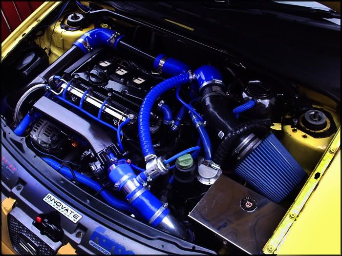

Far point will argue about doing a BT on a budget but its possible...
On my Ibiza i ran New tigart manifold,Vf23 And revo stage 3 with 550cc injectors and made my old lines,tip,gear linkage bracket ect
from memory i did the conversion complete with £1200... Everything was brand new bar the turbo (which is a error in most peoples views) turbo cost me £120 and was in mint conditon...of scoobynet.
I had it running for 5 weeks before the water pump failed and i rebuilt it...Shame really the Rest is Old news..:(
What it looked like when i completed it..
Offt how i miss that creation of a weapon:(
That looks an awesome car, what power was it running?
