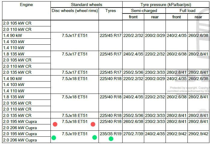

I've found and attached an image of OEM tyre pressures for the MK3 Leon for none UK versions, so will apply to models in Europe including Sweden.
Green dots show tyre pressures for tyre size 235/35R19
And red dots for tyre size 225/40R18
You stated your winter tyres are 225/40R19
As long as you use the OEM standard tyre pressure setting as a base line, as stated in your car manual or fuel flap label you'll be fine.
It all depends how cold it is in Sweden where you are, and how often the temperature fluctuates, if it's hardly anything and the temperature is never really going below zero C°, then you'll be fine with the winter tyres you have, set at OEM standard tyre pressure setting stated on your fuel flap label, or set 1 to 2 PSI above standard setting is fine if you feel you need to in the winter.
Hope this helps
Si
Hope this helps
Si
Many thanks for your extensive response Si, especially the table you attached. It was very helpful :) I do need to get myself an air compressor eventually to be more flexible with changing tyre pressure, but I'm not quite there yet xD
