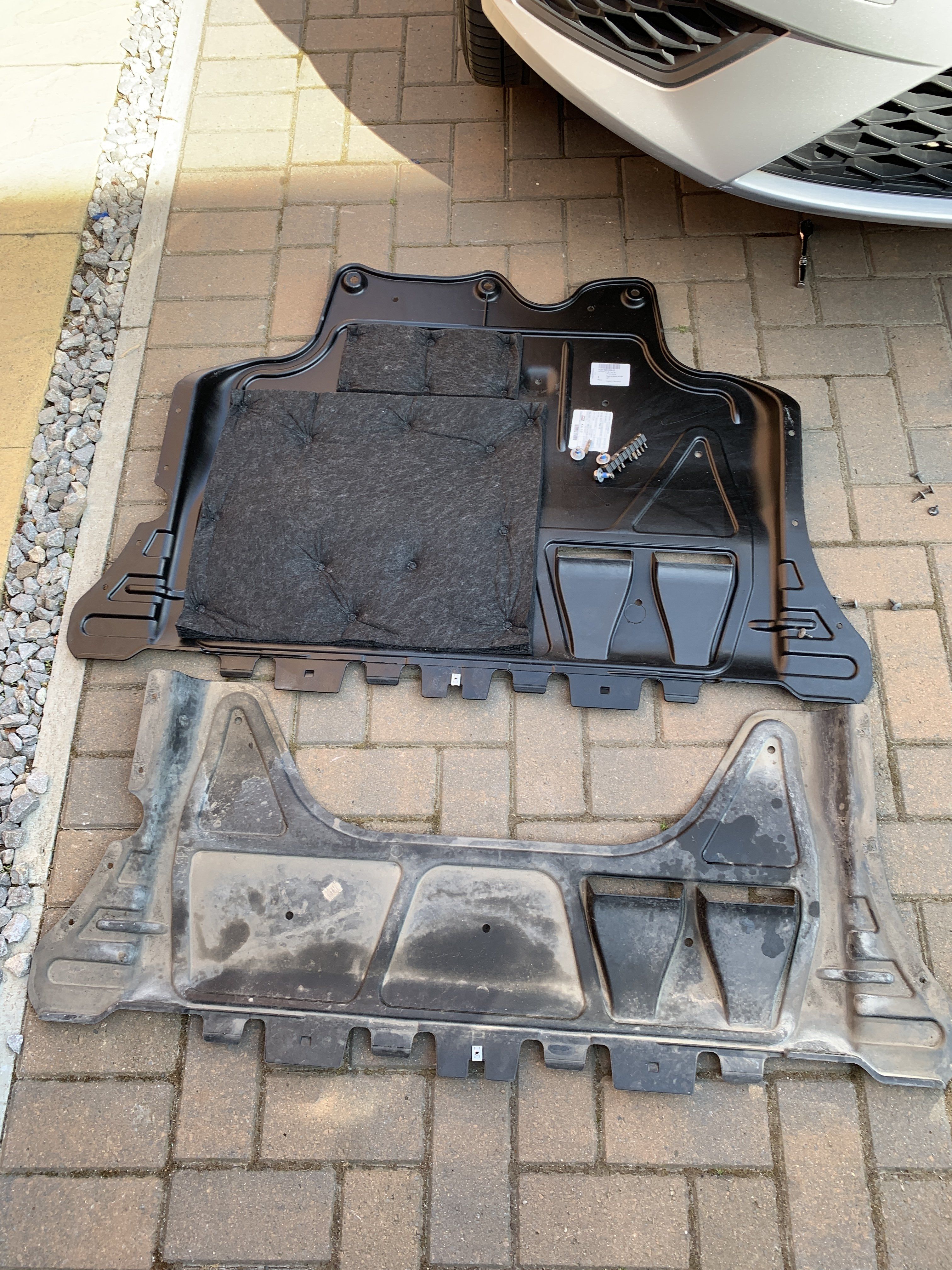

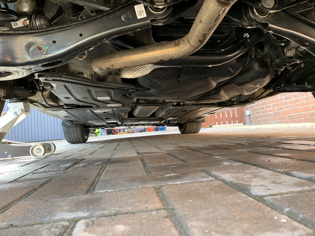

I have golf GTE engine undertray and front and rear exhaust tunnel panels on mine

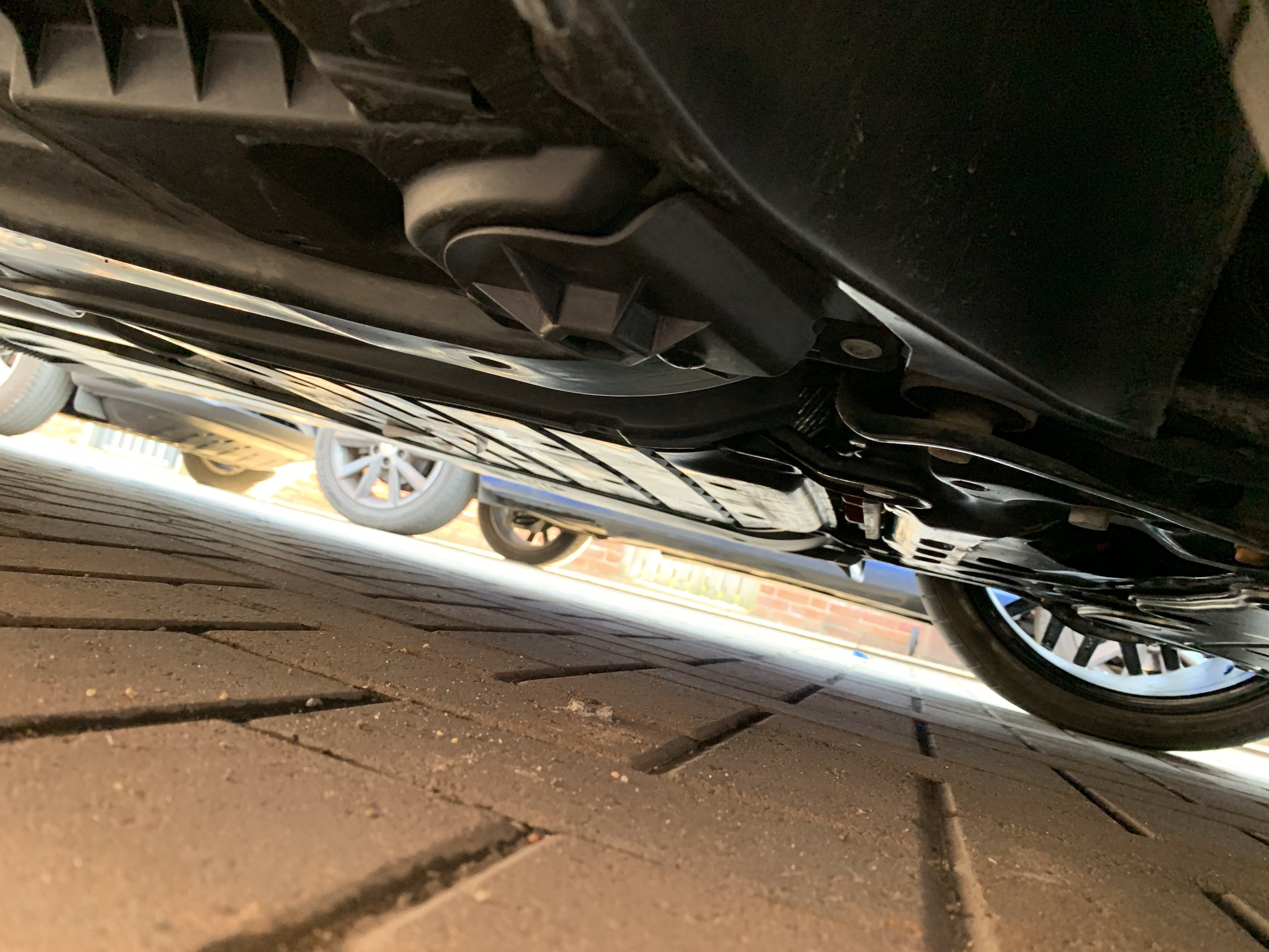

Also have the Audi jack pads on mine as well
Reactions: Compo1

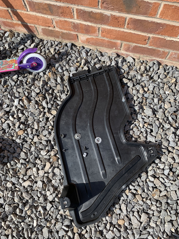

This if the front exhaust tunnel one

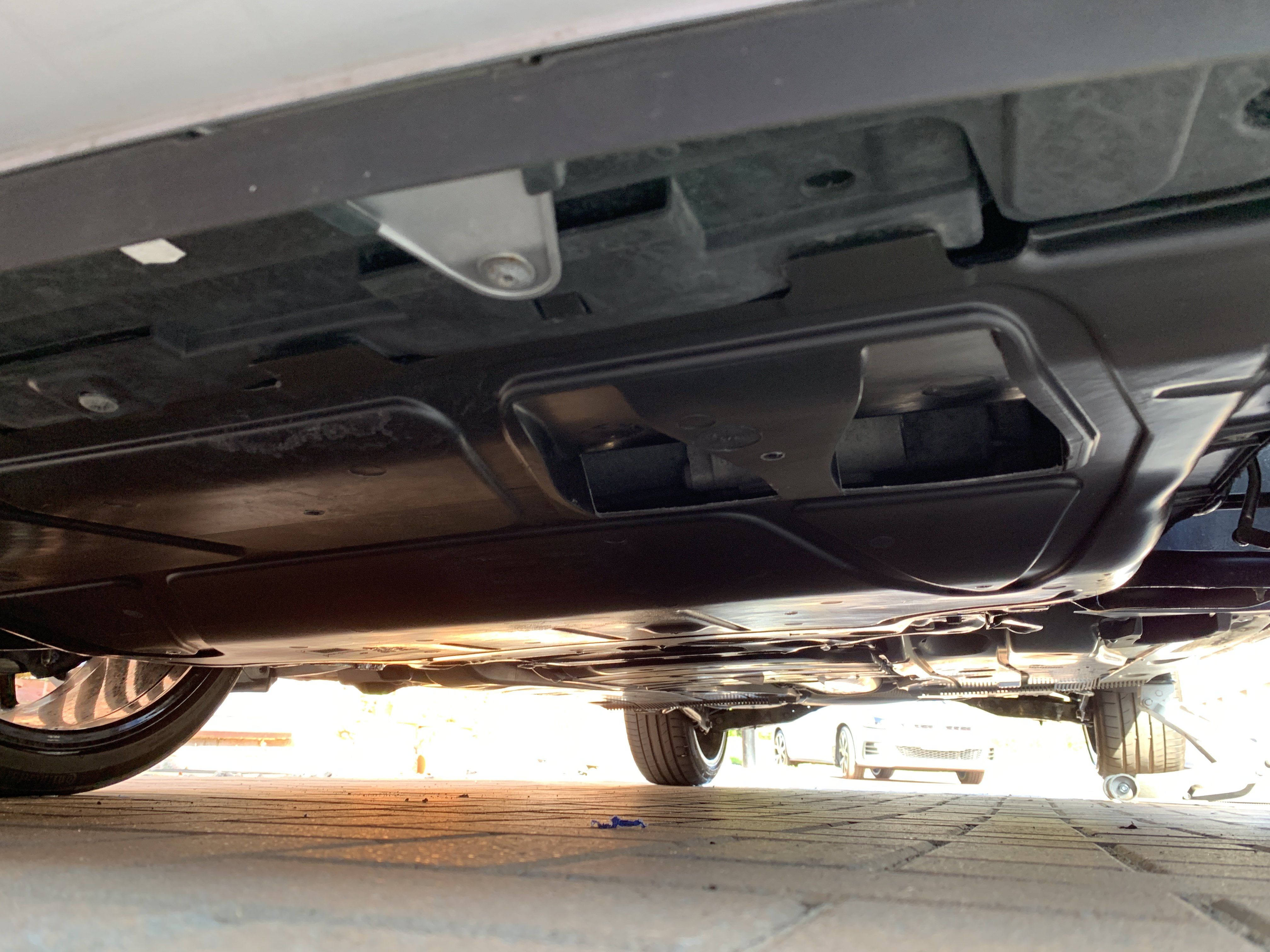

And rear exhaust tunnel

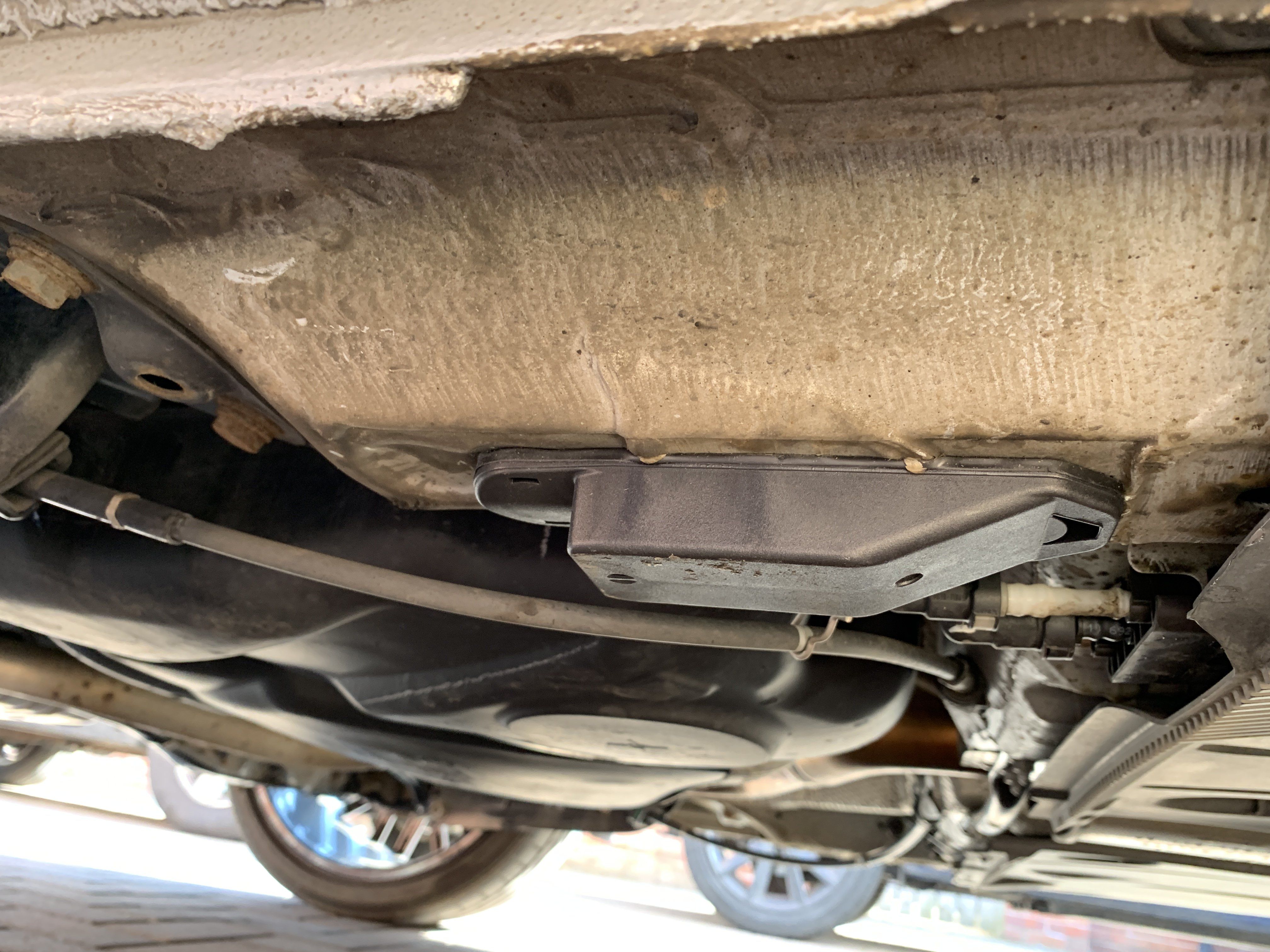

Your last picture mate i seem to be missing as we look at your picture the left hand side rear one, id a feeling it wasnt complete. Balls need one.
Not really the front is about £45 the middle and rear ones are about £15 each
You need 3x bolts for the front, 4x rivets for the middle exhaust tunnel and a screw, speed nut for the rear. It already comes with 2x speed washers and 1x screw and speed nut for the rear

What about the jack points please?
That is the one thanks mate ill dig out a part number and order it.
I take it you did a cleanup under there too then, half way thought it. Mine is a 2014 FR184 with only 19000 on it and its mint so want to keep it that way so im removing the splash guards cleaning and waxoiling it.
Where did you get the rear ones at £15 deffinatly going for the Golf Engine under tray seeing yours.
Mine only had 7800 and it was a really clean car on top but underside was filthy. I pressure washed under the car a few times and got under and physically cleaned it myself too before fitting these panels
