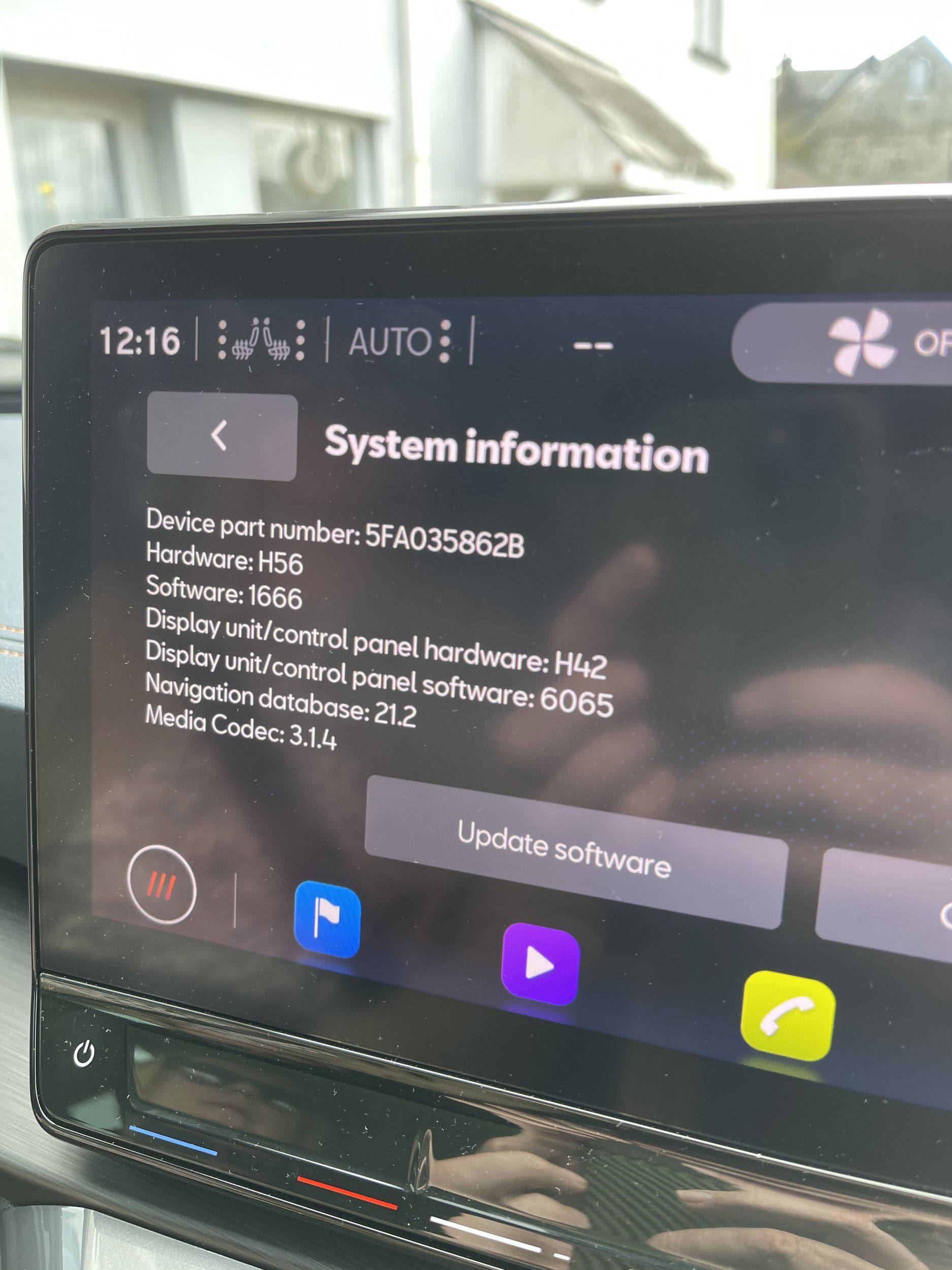

my screen after latest updates

my screen after latest updates View attachment 23141

Any way to force an update? Mine is on 1666 so sounds like it’s not the latest.
Every time I hit update software it whirls away and does nothing whilst searching.
