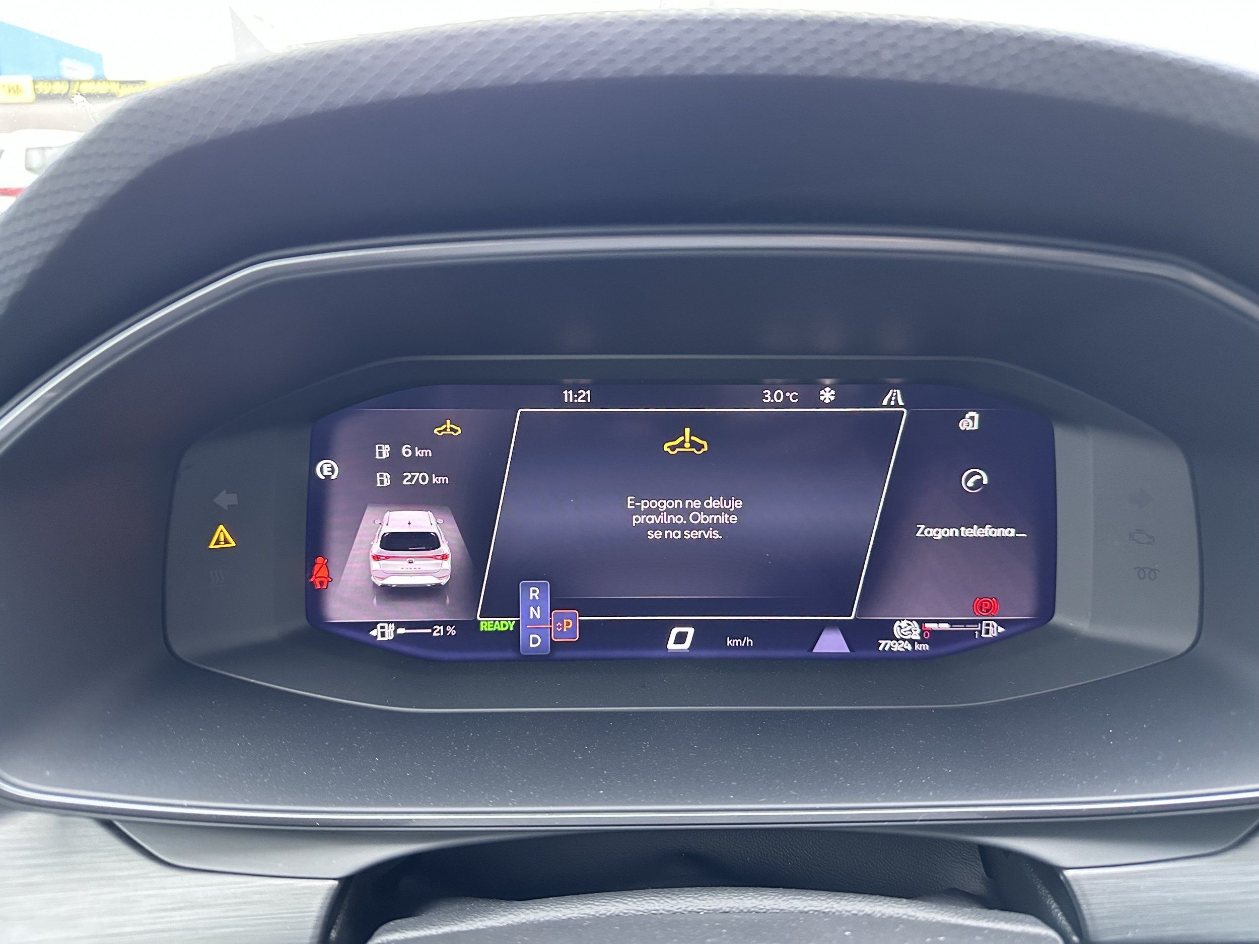

Hi everyone,
I’m looking for advice and feedback on a situation with my Cupra Leon eHybrid 245hp. About 2 weeks ago, I received a warning: “e-Drive is not working correctly, please visit service.” (Photo attached.)I took the car to the official Cupra service center, where they performed diagnostics and found a faulty coolant temperature sensor 1 (internal code 2070044/6). They explained that fixing it requires a lot of work because the high-voltage battery must be removed to access the sensor. The total repair cost is approximately 3000€, which seems very high for a sensor replacement. My Questions:
  1. Has anyone encountered this issue before? I’m curious to know if this is a common fault or if there’s a pattern with this sensor failing.
  2. What happens if I don’t repair it? The service center said there are no immediate limitations if I keep driving with the error. However, I’m concerned if this could cause long-term issues for the battery or drivetrain.
  3. Is this sensor only related to the high-voltage battery? I have insurance from the car dealer, but they refused to cover the repair, saying it’s a battery-related issue. Is this correct, or does the sensor impact other systems as well?
Any feedback or suggestions would be appreciated. I’m trying to understand if this repair is truly necessary or if I can delay it without damaging anything further. Thanks in advance!

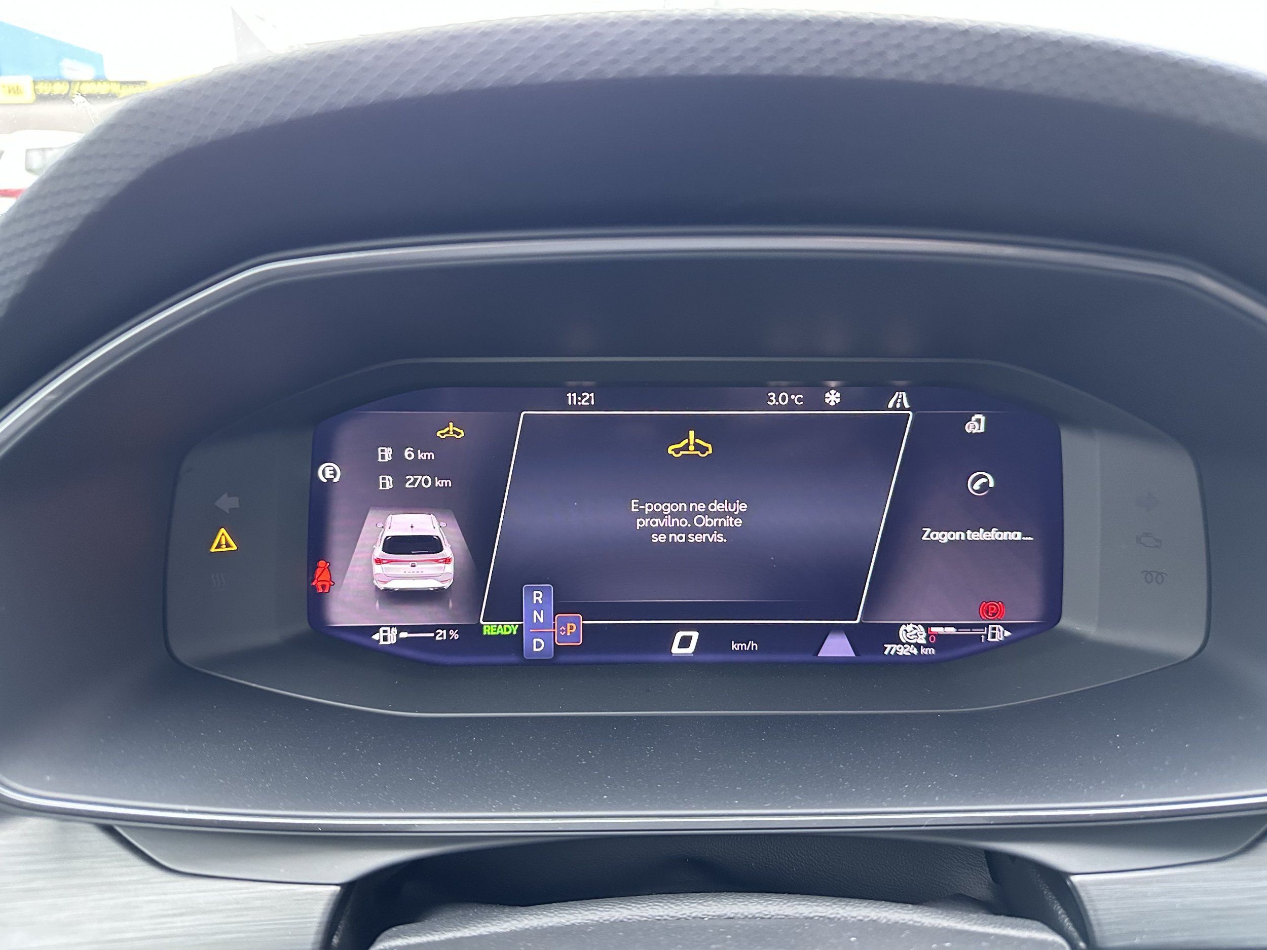

Hi everyone,
Have got this resolved? I have same problem on my formentor ehybrid 245
Resolved. Car is working normally after that I made 10000 km, no other problems. I paid at the end 1900,00 € to fix this problem. Very expensive this should be covered by battery warranty If they want to promote electrification in Europe. What is your estimation to fix this?
Thanks, I am so lucky to have a service contract for the car. The importer have just confirmed to repair for free, will be done mid december

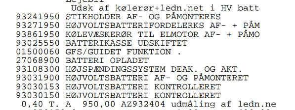

Hi, please, I have exactly the same problem in my formentor vz 245ch, I'm in a country without a dealership. What exactly has been replaced in you car to repair this fault. There is different repair garage but each one sais different story.
HI
I have copied from my invoice below, unfortunately in danish:(
cooling pipe plus wiring harness and battery box
Covered by guarantee and/or servicecontract.
