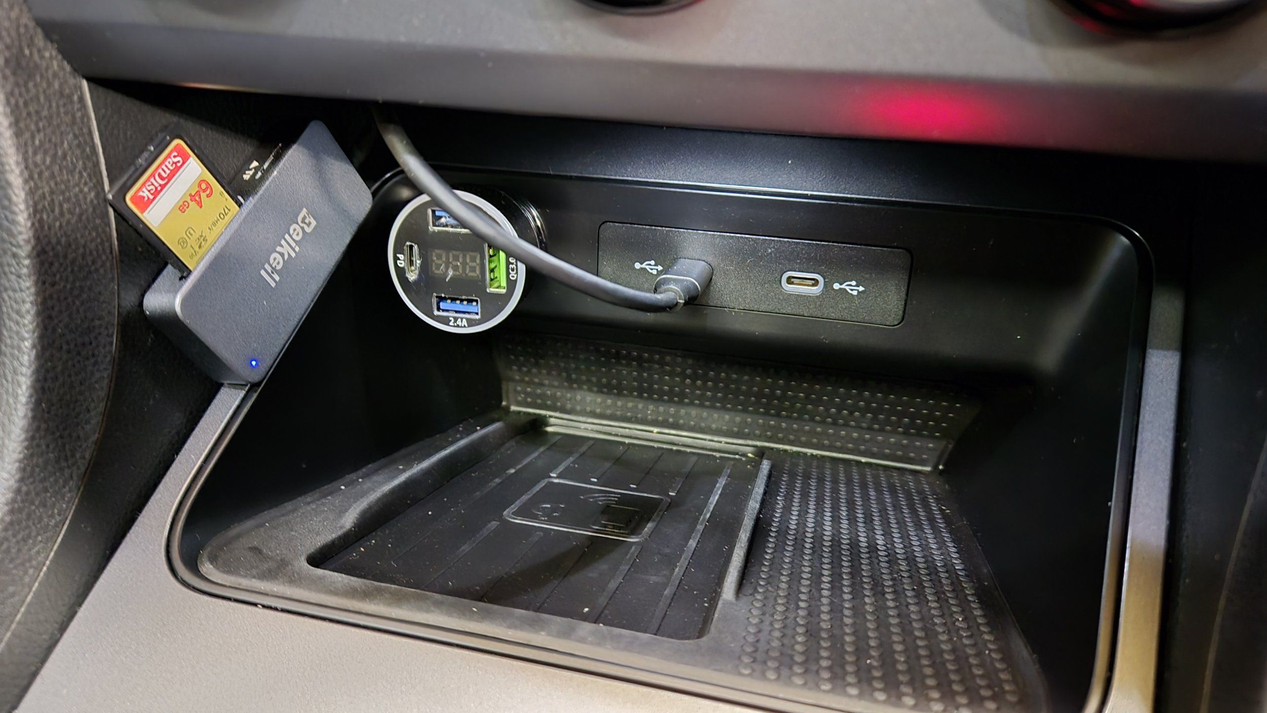

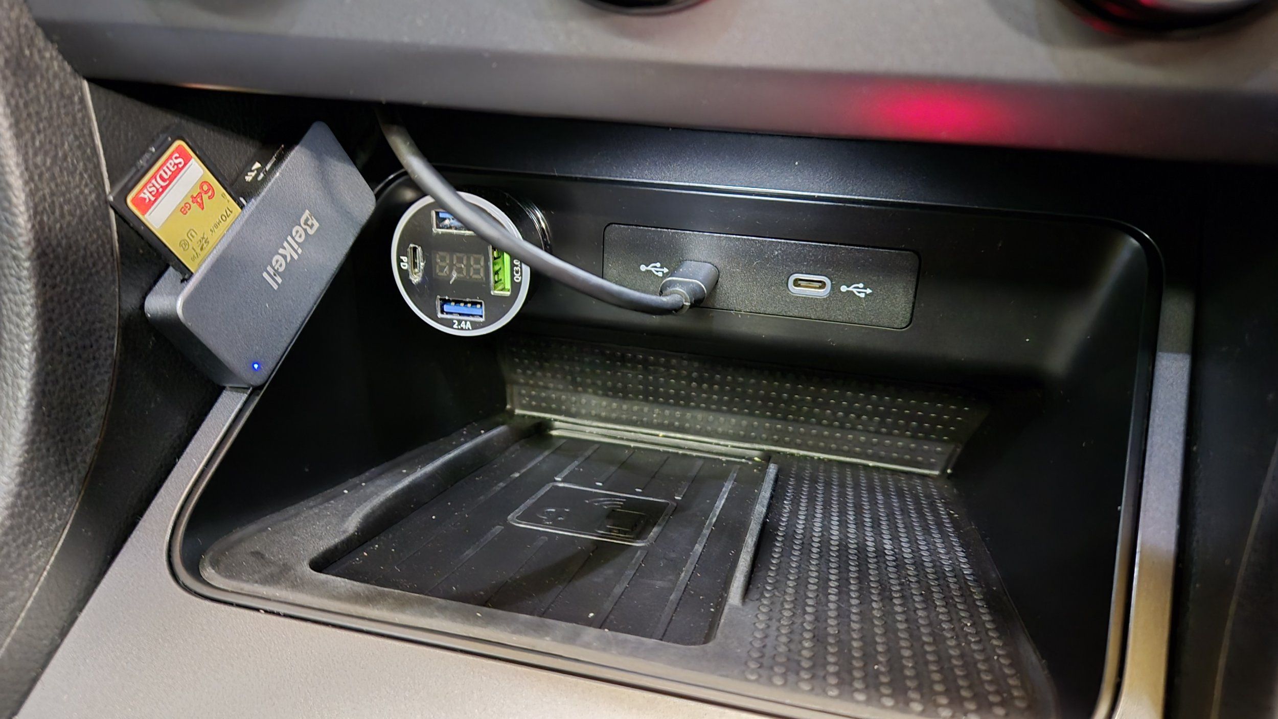

Cuprauser111 - the issue will be the USB C adapter and a conflict caused by an 'Endpoint', 99.9% of the time USB is truly plug and play however there is some interesting stuff going on in the background that one isn't aware of. If you had a USB device that connected directly to the USB port and there is no adapter you'd be fine.
I'm always concerned having USB sticks in USB ports where they might get accidently knocked with a worst case of snapped off so went about it slightly differently, using one of these. SD Card Reader, Beikell USB C SD/Micro SD Card Reader USB 3.0 Memory Card Adapter £6.99 is not exactly the end of the world.
I've attached it to the side of the cubby with double-sided tape - neat and out of the way, works perfectly. I'm also using Wireless Android Auto - mostly streaming from Amazon Music Unlimited.

I had a second assumption that it could be related to USB C adapter, guess it is :)
But with that SD card reader adapter, if you are listening music from SD card, I guess you have no issues with wireless AA using it the same time, as I had with USB ? If so - I guess that could be perfect solution for me !
No issues at all, works perfectly.
