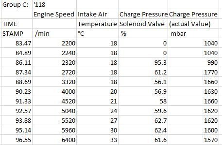

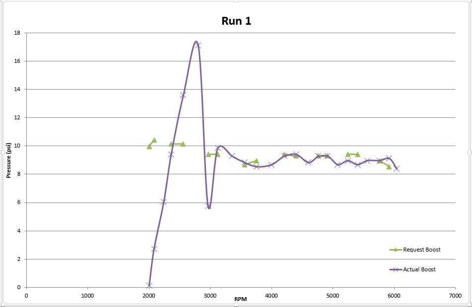

First Run, quite a large boost spike I thought but this was the first time on the run I had really planted the foot and it didn't spike nearly as high again. Holds a steady 8 - 9psi tailing off as it gets higher up which I believe is normal. Table below shows the N75 values, what do you think?

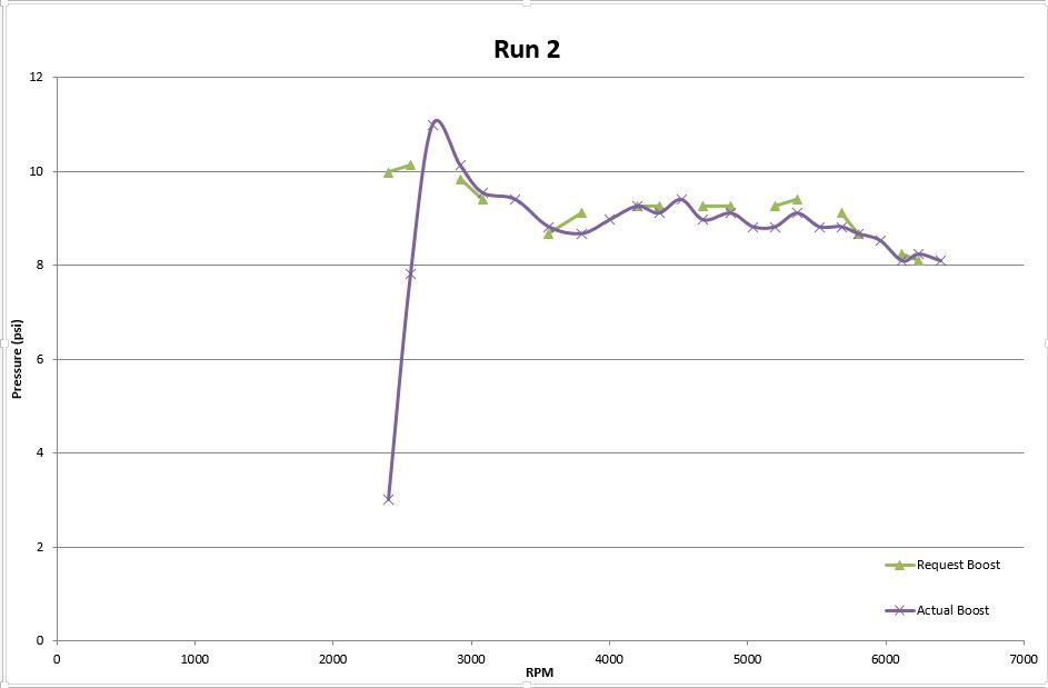

Second Run, same things again, spikes a lot lower this time.

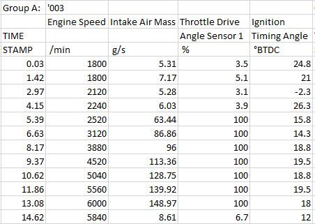

Run 3, this time I have logged the throttle parameters and the ignition retard.
The MAF figures look ok to me, using the rough divide by 0.8 trick it gives a peak of 183bhp which is close enough for stock. I have no idea what the timing angle should be, does anyone know? As for the ignition delay it doesn't do much at all which I'll take it is a good thing, it runs religiously on nothing but Shell's finest V-Power, I'll take it there would be more action here if I ran "normal" petrol?

Pressure also looks normal for stock AUQ. It reaches 1600-1700mbar, subtract 900-1000mbar (normal atmospheric pressure) and you see it reaches 600-700mbar, the normal values for a unchipped LC180.
Adam4D
Oct 2, 2011
347
Your logs are very short, did you log all 3 blocks at once?
You should ideally log 1 block at a time to keep the sampling rate higher so you get a more detailed log.
But as said looks ok for stock 180

I thought the boost maybe looked a bit up and down but I suppose thats how the N75 works it constantly gets info on what the boost is and continually makes small adjustments? I have a new N75 that I tried to cure my ills ages ago but took it off again when it didn't make any difference, I'll probably stick it back on as the existing one is now more than 11 years old.

4th would be better for seeing knock correction as the engine will under load for longer, obviously this is only for those brave enough or have a dyno to use. If you run through 3rd into 4th for as long as you can then you'll have a good idea how things are acting
