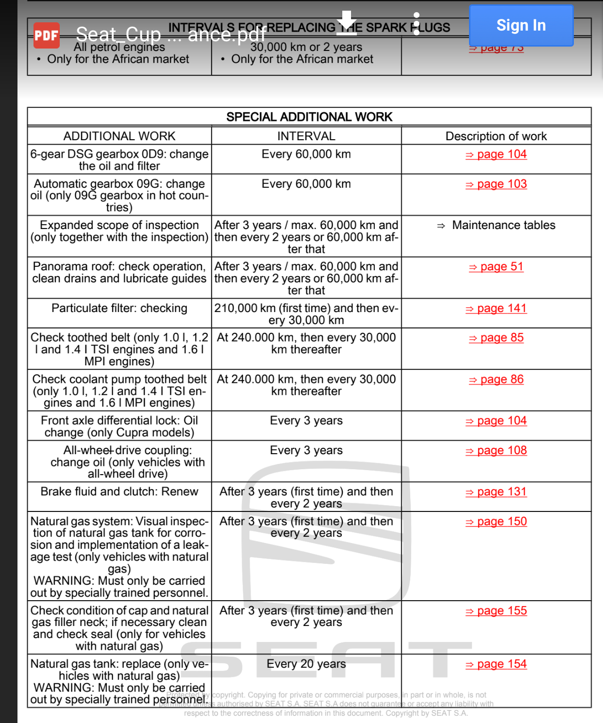

I’m a bit past 30,000 miles and have read that a VAQ Differential Service is Required.
I am looking at probably doing the DSG oil service a little earlier than the recommended 40,000 miles but am confused as I have been told by one garage that the VAQ Differential “shares” oil from the DSG.
Apparently during a VAQ service, there is a strainer to clean and a pump to check in addition to an oil change but I am trying to get a straight answer as to whether there is a requirement for two separate oil changes. or one, as other garages have not mentioned the concept of this being one closed unit.

They’re separate...DSG at 60k km, Dif at 3yrs
Probably avoid the garage that said they’re the same (though at least they knew it has a dif which is more than I can say of Lookers).

Have I not spotted a thread on this forum before about this, and the workshop instruction is to only drain and replace the diff oil, whereas removing the screen gauze and cleaning it should be getting done as it gets clogged up?
So, to anyone getting any trans fluid replaced as part of a service, maybe ask if they are removing and cleaning the screen gauze in the case of the LSD, I'm guessing that the DSG box has a filter that gets replaced every time the fluid is changed. From the picture in that other posting, wrt the LSD screen/gauze, "it does not need checking/cleaning" is not the answer you want to hear.
