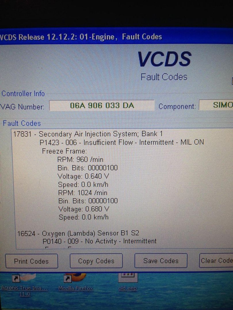

17831/P1423/005155 - Secondary Air Injection System; Bank 1: Insufficient Flow
Possible Symptoms
Malfunction Indicator Light (MIL) active
Possible Causes
Fuse for Secondary Air Injection Pump blown
Vacuum Hose(s) leaky or collapsed
Piping between Secondary Air Injection Pump and Combi (Secondary Air Injection) Valve leaking
Secondary Air Injection Solenoid(s) faulty
Combi Valve(s) faulty
Possible Solutions
Check Fuse for Secondary Air Injection Pump
Check Vacuum Hose(s)
Check Piping between Secondary Air Injection Pump and Combi (Secondary Air Injection) Valve
Check Secondary Air Injection Solenoid(s)
Check Combi Valve(s)
16524/P0140/000320 - Oxygen (Lambda) Sensor B1 S2: No Activity
Possible Symptoms
Malfunction Indicator Light (MIL) faulty
Possible Causes
Wiring/Connectors from/to Oxygen (Lambda) Sensor Bank 1 Sensor 2 faulty
Possible Solutions
Check Wiring/Connectors from/to Oxygen (Lambda) Sensor Bank 1 Sensor 2
Check Oxygen (Lambda) Sensor Bank 1 Sensor 2
Started from cold overnight standing with new pump and I couldn't hear the pump starting or working. I've checked fuses in engine bay and none are blown. Relays seem to be working. What actually tells the pump the to turn on from cold??? Maybe that's broken??
