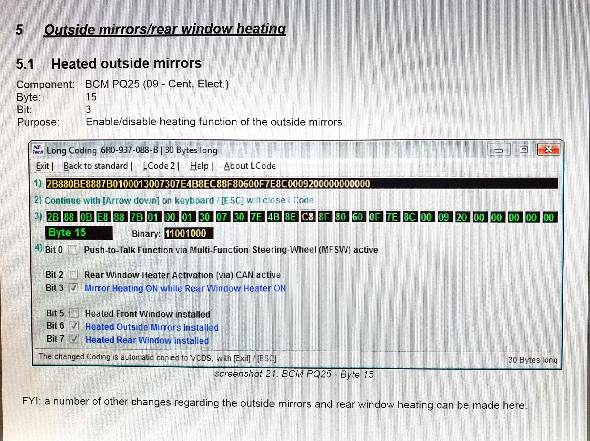

Just wondering if anyone has tried the following, see picture, I think it would be good to have the mirror heating come when turning rear window heating on. 2 VCDS Mirror heating.jpg
STG 42 > Coding > Byte 09 > Activate bit 2 ("rear_window_heater_trigger,active")
STG 52 > Coding > Byte 09 > Activate bit 2 ("rear_window_heater_trigger,active")
no guarantee

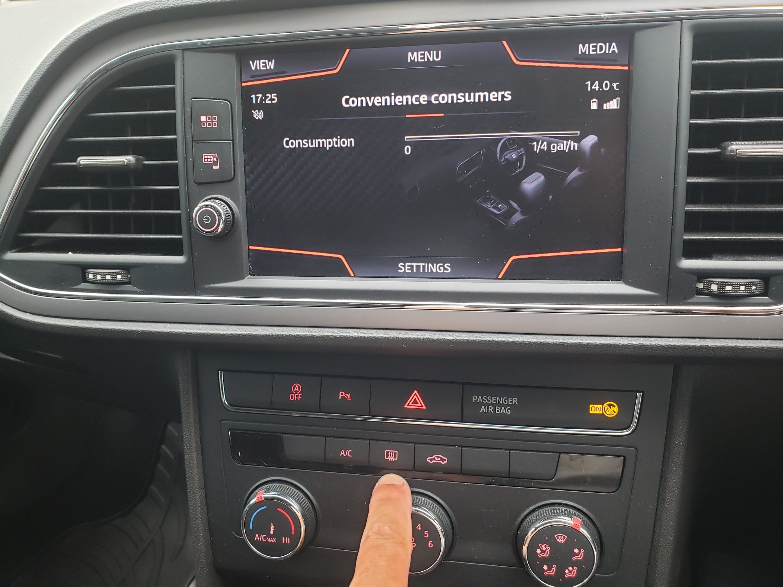

Gave it a try with heated rear screen on and the door control know on Left, Middle, Right the only way to get action appears to be using the heated mirror setting. However I dont know how long the Heated Mirrors stay on for to see if with heated rear screen on that they stay on as long as the rear screen if that makes sense. But bottom line so far made no difference.
OK had a play - firstly, the coding listed for the PQ25 module above works great on the PQ25 - tried it on the 2014 Toledo and it's working spot on.

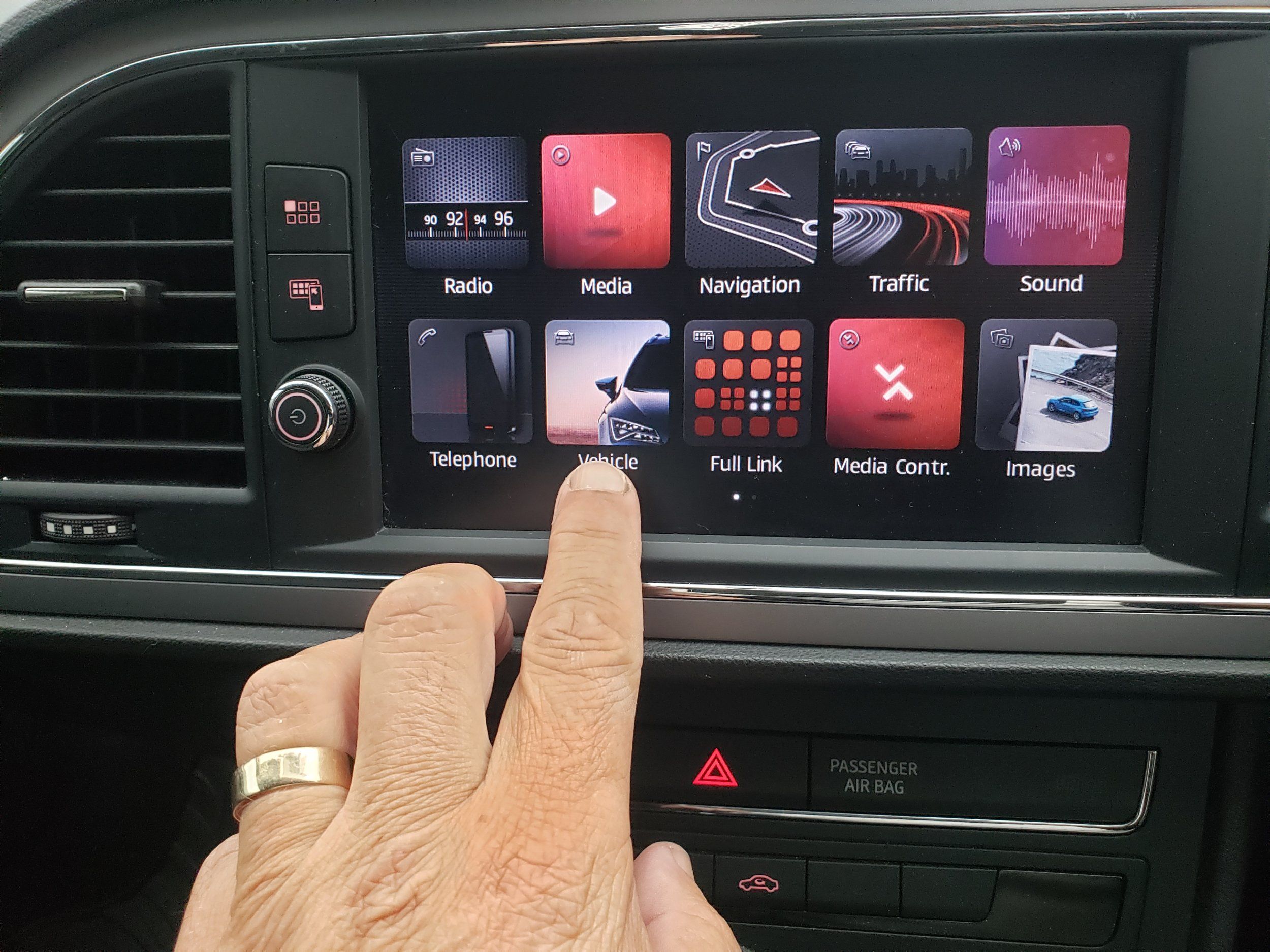

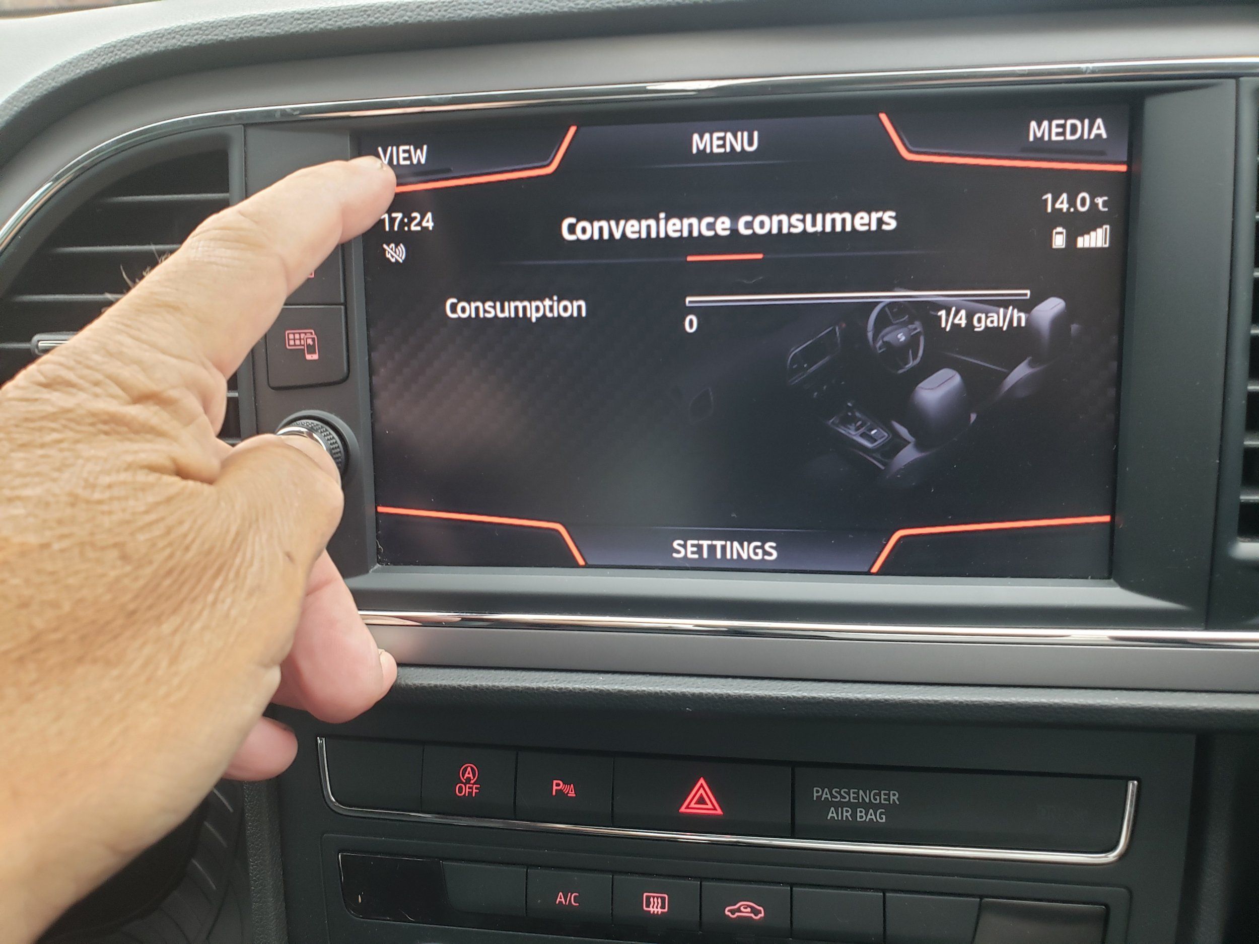

As far as the (facelift) Leon goes, it's a no go. I coded both sides as per @cairus post above, and unfortunately, it makes no difference. You can easily see if the function works as follows - on the infotainment, select Vehicle-View-Convenience Consumers. With ignition on and engine started, switch on heated rear window (it won't work with engine not running). You'll see a message on the screen saying rear window heater is on. Switch mirror heat on with the switch on the door, and you'll see another message saying mirror heat is running. But change and save the coding as described, the mirror heat message does not appear with the heated rear window message when the rear window heater is switched on, whether the mirror switch is on left, centre or right. On both modules 42 and 52, I've tried ticking bit 2 rear window heater trigger only, ticking bit 1 mirror heater single trigger only, and these two bits together as well - no joy on my 2019 model.
