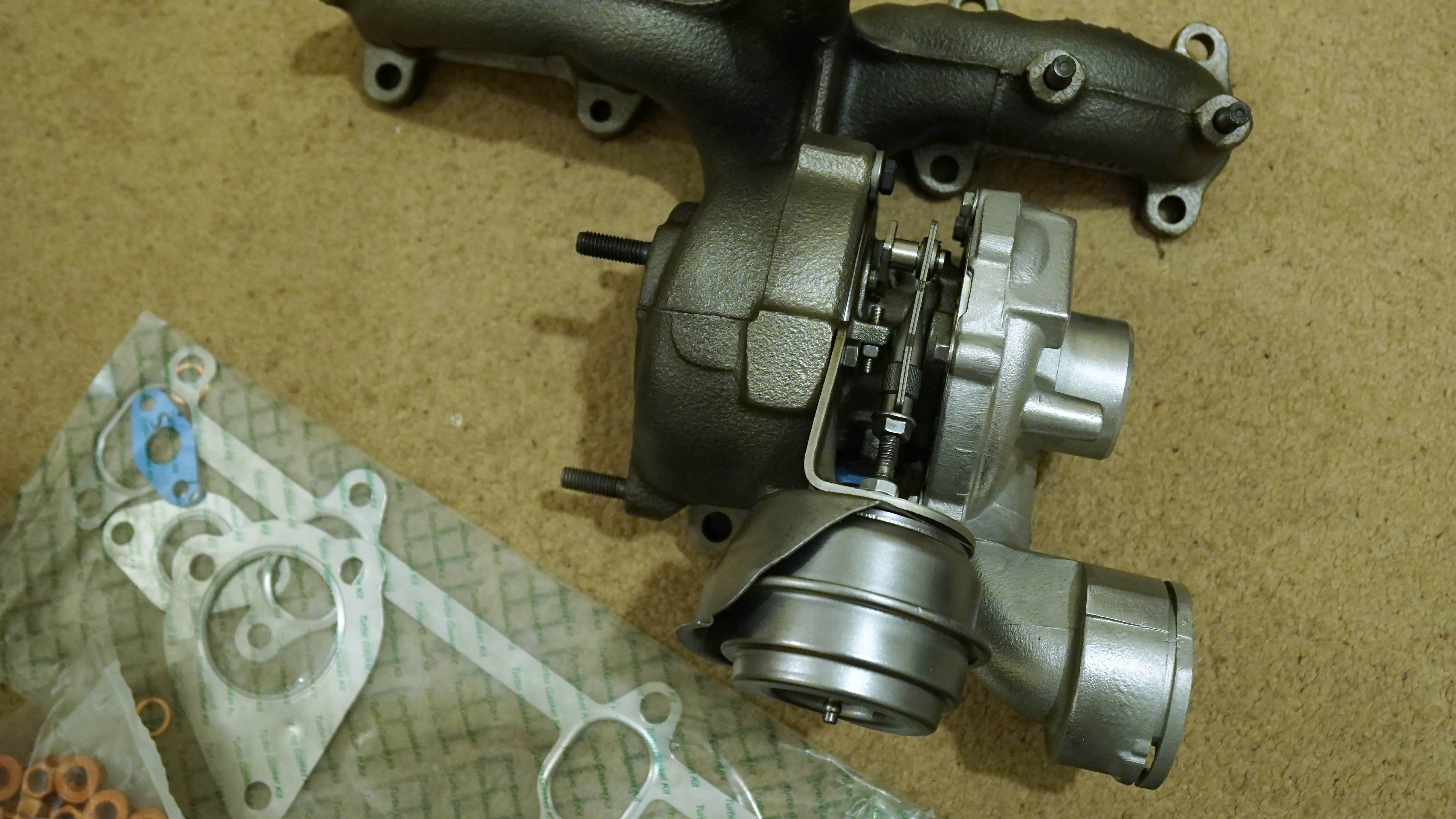

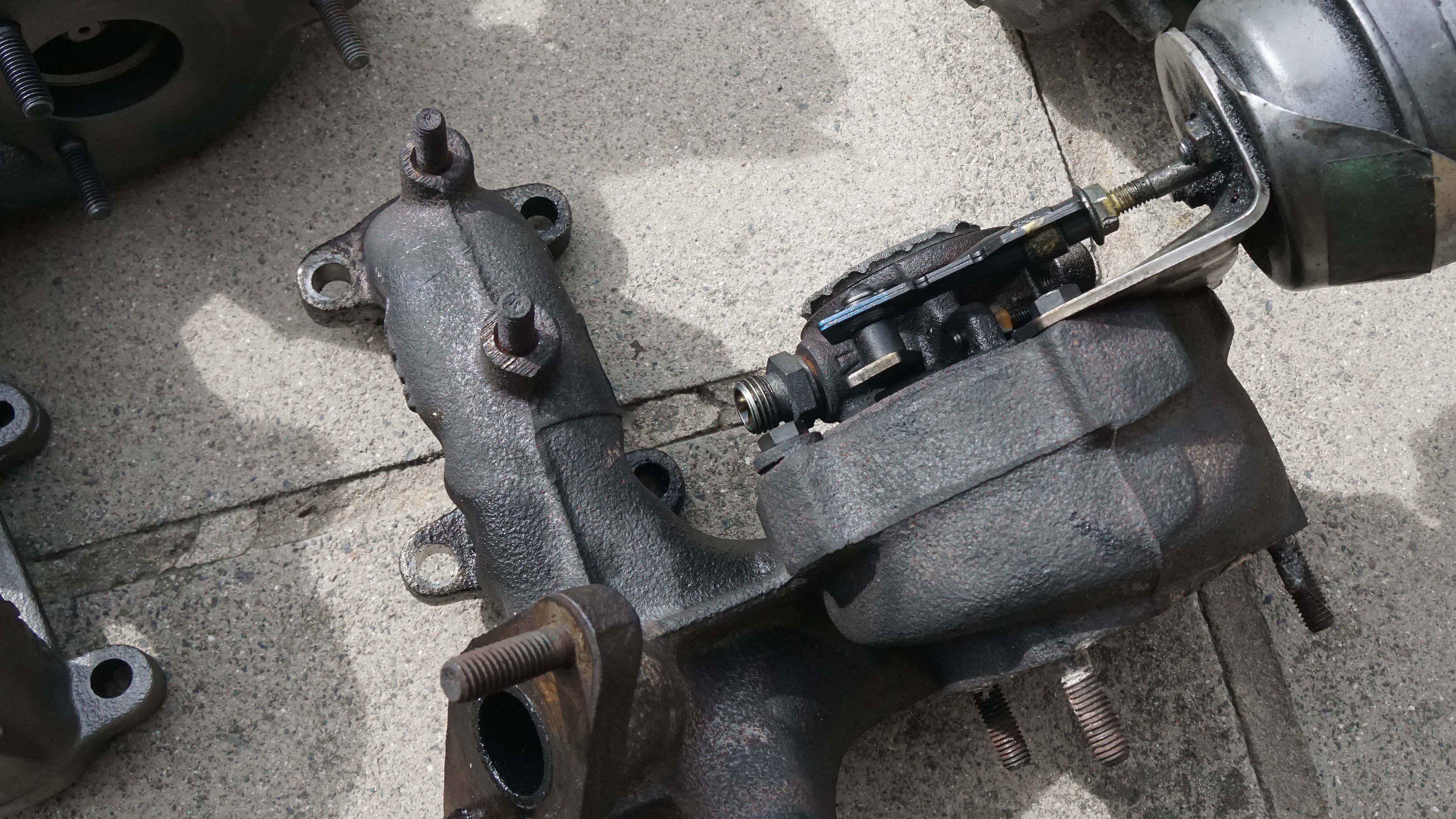

Nope I didn't :( I assumed everything would be set up already as it's a reconditioned turbo. It seems to work and boost fine.
I did notice the stopper on the new one being over twice as long and would stop the actuator rod earlier. The adjusting nut was tight and awkward to get with the actuator bracket bolt head in the way so I assumed that was set up also. See pics
