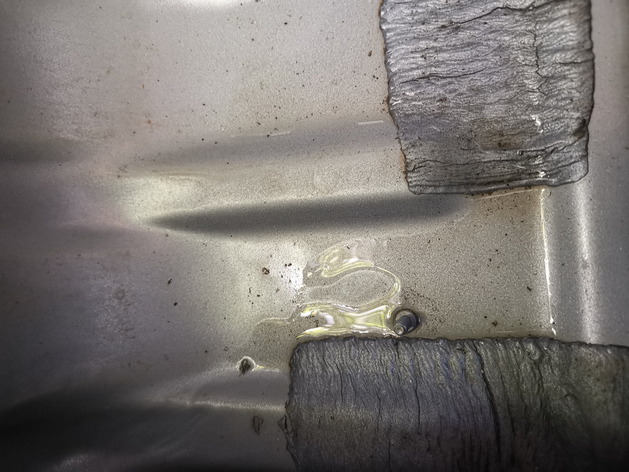

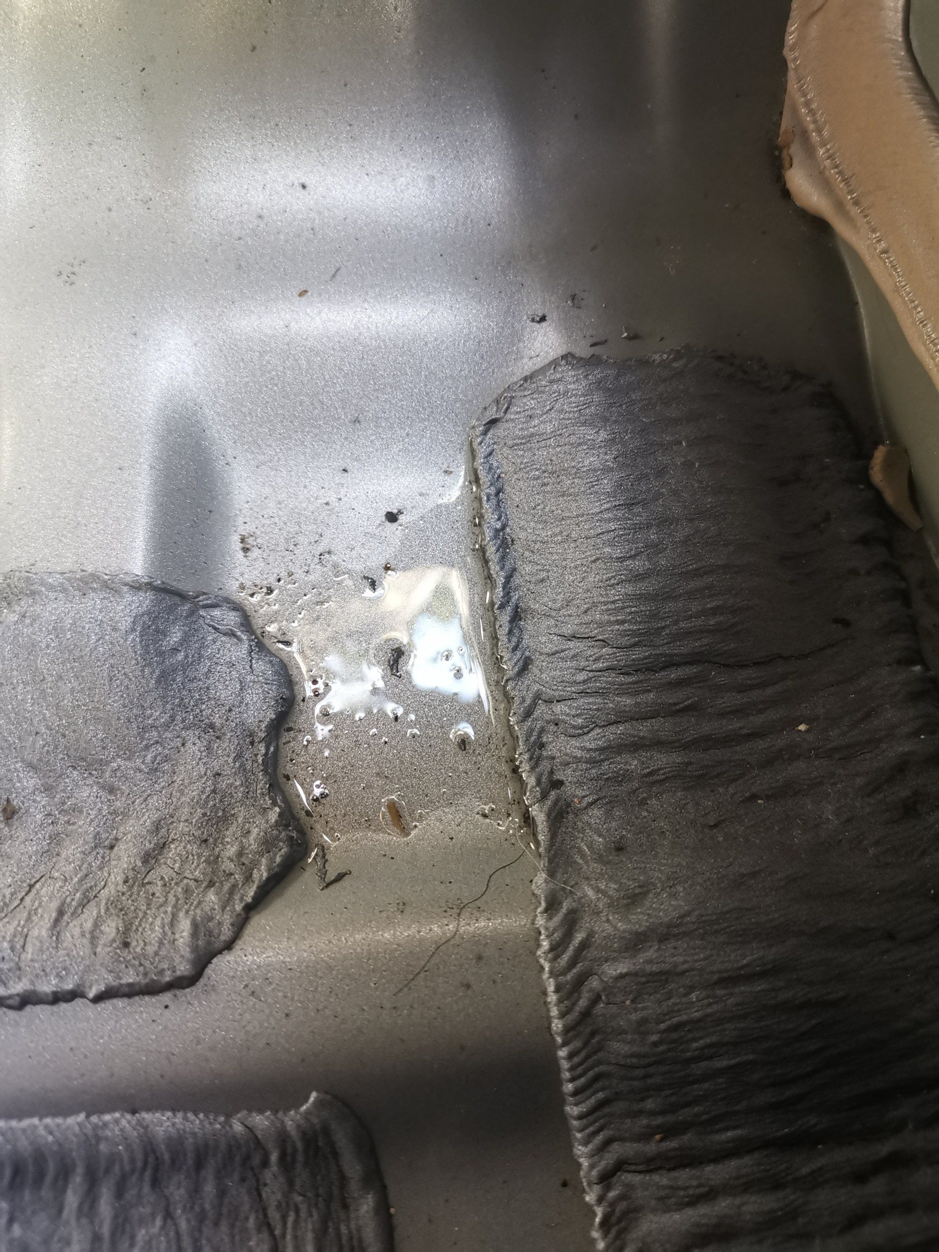

So water is getting into the boot spare wheel well as seen on photo, photo couple weeks old, dried out with towel and have since rained alot and is worse than the photo by far!

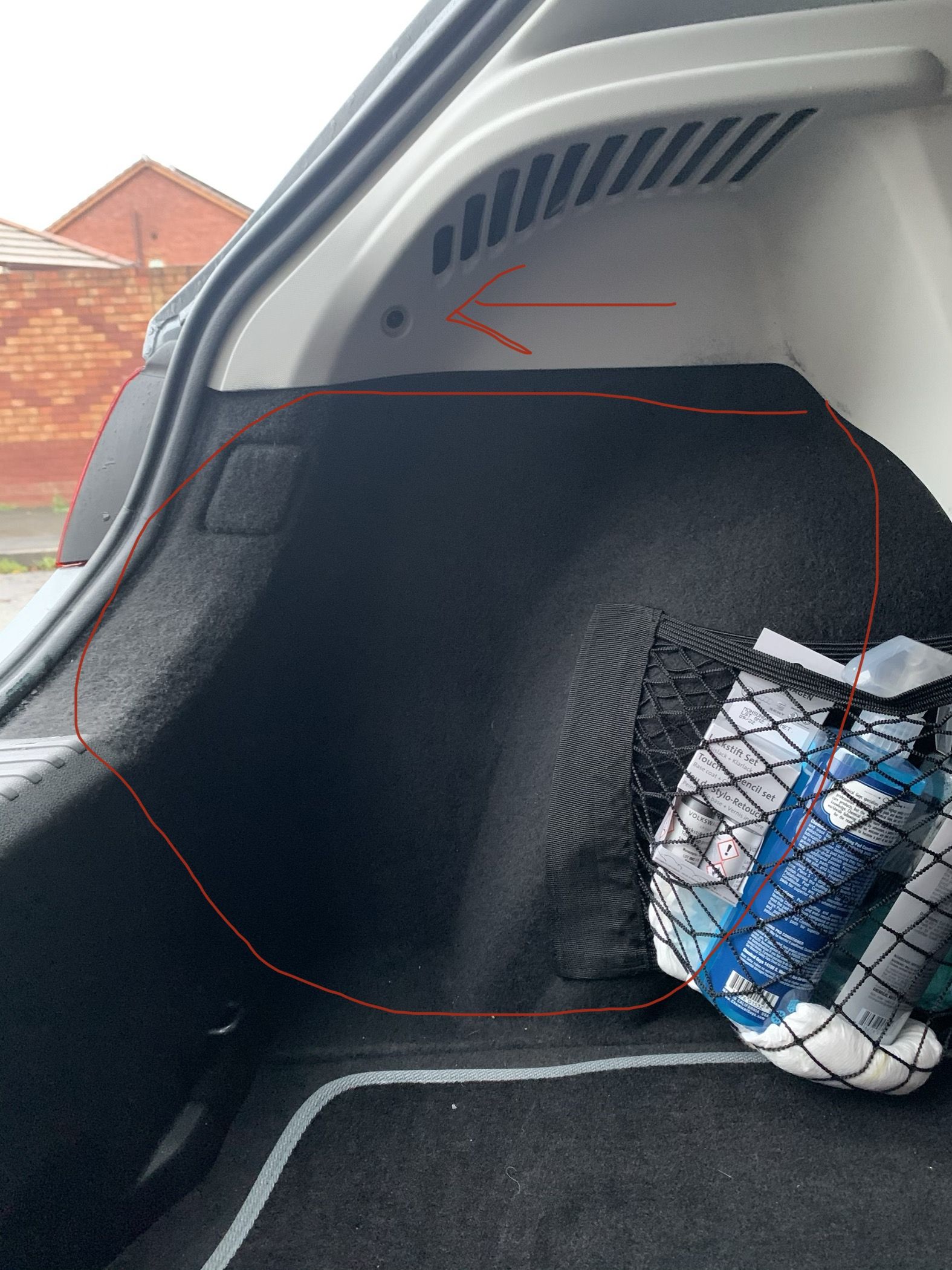

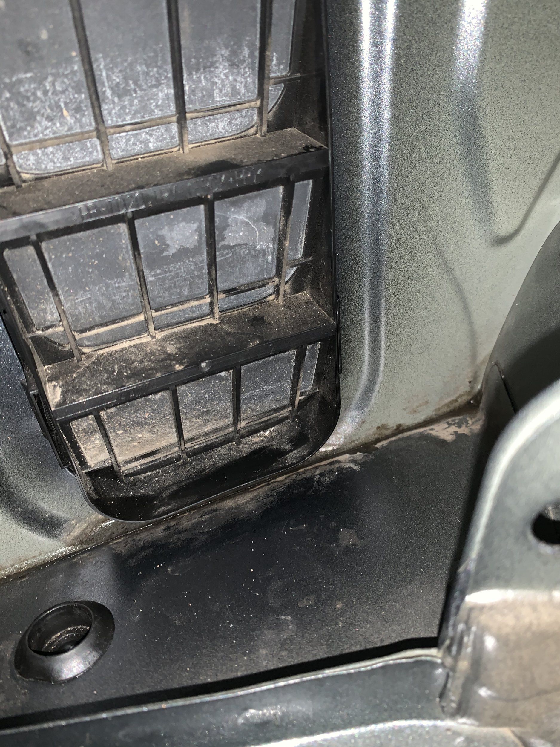

Try loosening the trim on the side panels in the boot near to the rear lights. There are cabin vents behind this, set into the bumper that are known to fail. I had the same issue and water was collecting underneath the rear passenger side light, this was spilling over into the main boot area. See the attached picture

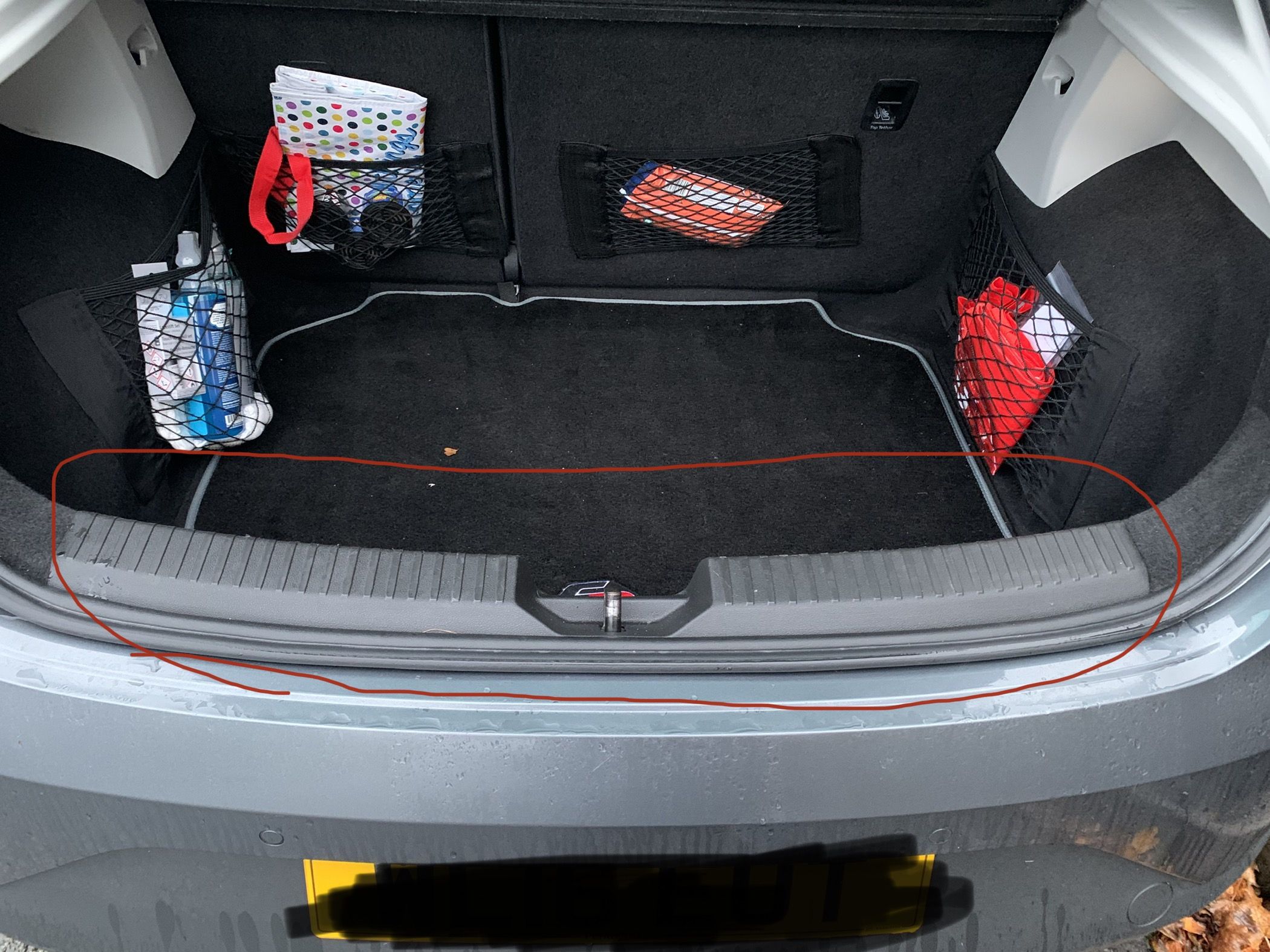

Hi mate,
to access it you first need to remove the inner boot lip cover/protecter. Take the boot floor out, and pull from the bottom of the plastic trim outwards first then upwards. Then the upper plastic trim, which the parcel shelf sits on needs popping open, I didn’t remove mine fully. It has one torx screw (see pic) then it pops out with a bit of a pull. This will give you access to remove the fabric part of the lower boot trim. It’s just below the rear light, but you’ll also be able to see if it’s the lights that’s letting in or from higher up the c pillar (welds have been know to go here!). I’ve attached a couple of pics which should help. If it is the seals on the cabin vents letting in, I believe it’s a rear bumper off job. Although my warranty did not cover water ingress, they did it on good faith. Hopefully this helps, as water ingress can be a nightmare to find and sort.

They have replaced vents in the boot as suggested, just driven home in heavy rain and it appears to have done the job! They also lubricanted the handle which seems to have worked so far! And have changed a shock which appears to have done the job with the knocking noise.
