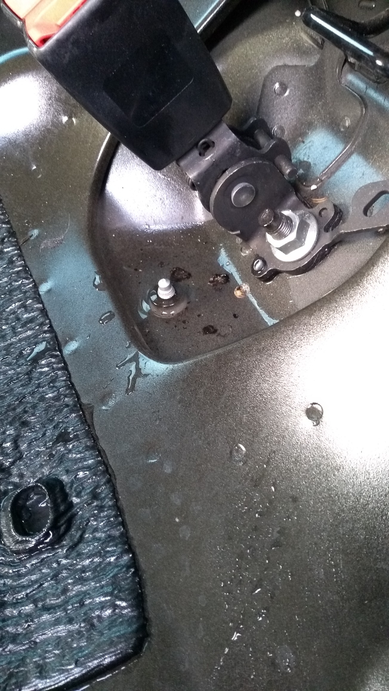

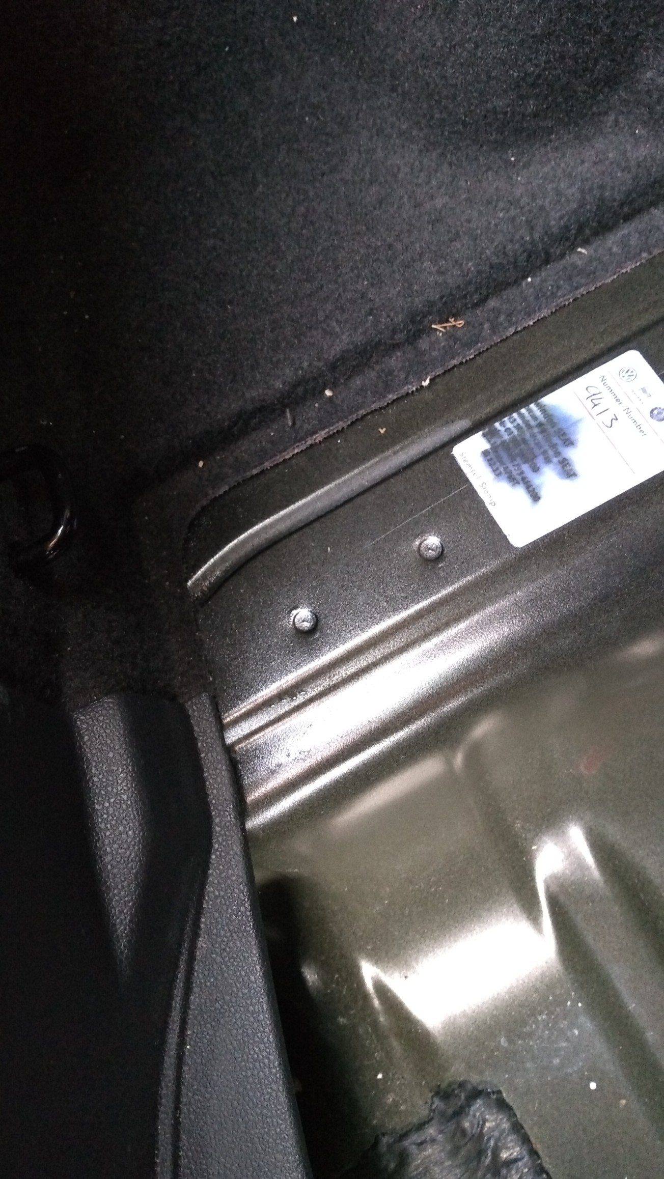

Ok I may have found the source.

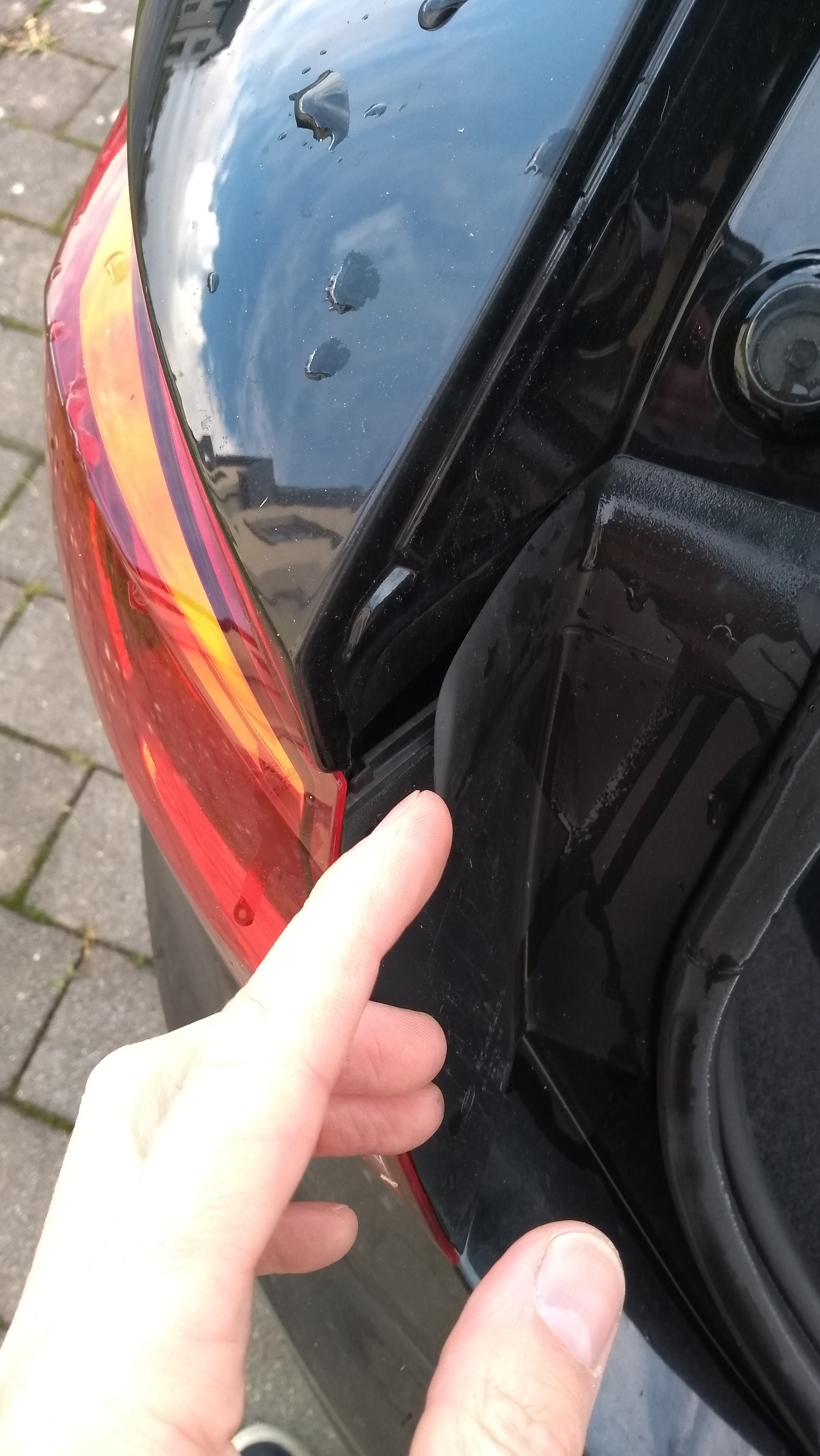

I took the seat out and there was a right puddle underneath, but nothing around the sides or floor. The main boot seal looks OK, but the plastic surround on the rear light is bent out a little, not flush with the chassis. After lifting the boot floor panel, I can see a small bit of water ingress.
I could be wrong, but it seems the water is coming through the rear light and working its way down the small channel on the boot floor and settling under the seat.
Is it really that easy for water to get inside, through the light cluster? I looked at the other side, which is flush with the chassis, but it's hardly a great looking seal. These seals or plastic surrounds around the light are totally exposed, even with the boot shut :think:
I'm gonna do a hose test this weekend, hopefully i will see exactly where it's coming in. My car is parked on a slight downward slope, so that would make sense why it's running straight down under the seat. It's lashing rain at the moment, so I'll probably have another puddle in the morning :censored:

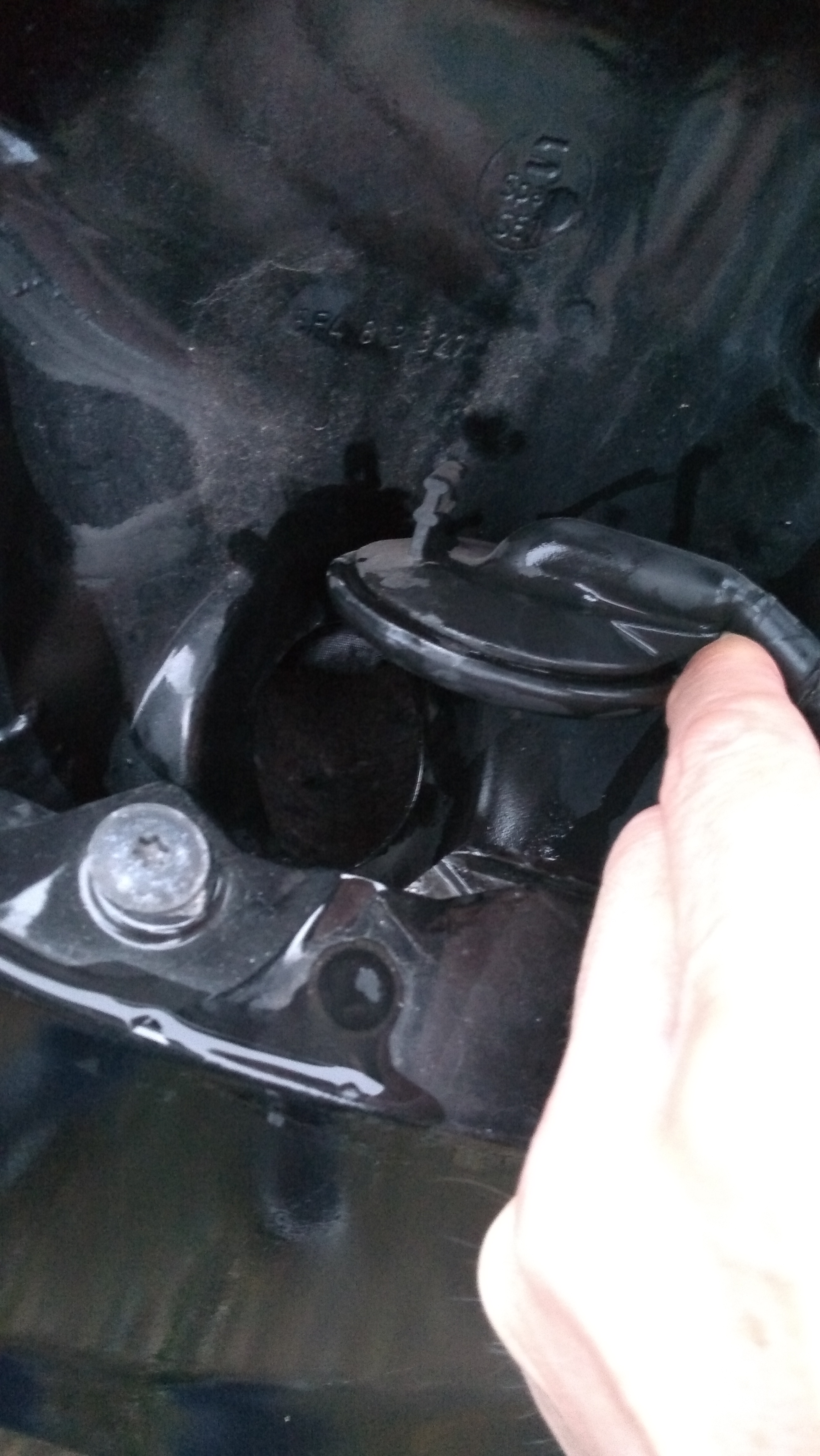

Ok I've finally found the source and it's really simple, thankfully.
For some reason the main rubber seal behind the light, was completely out of the hole. Also, there's 2 locating pins on the light, but one of the small locating grommets is missing.
