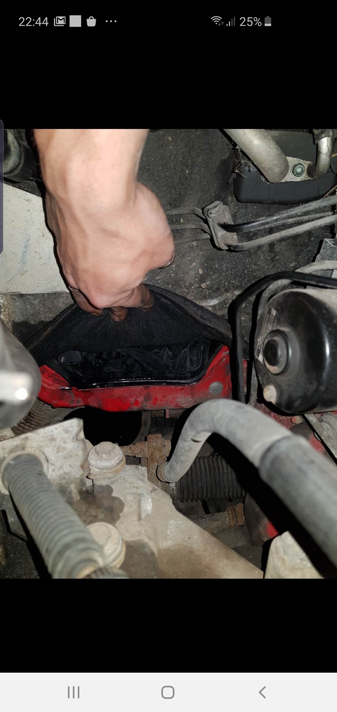

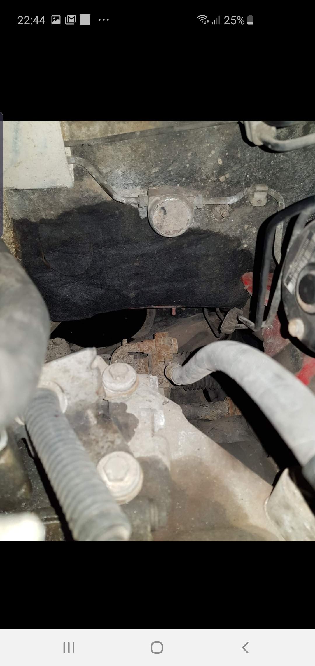

Had the problem since a got the car a couple of years ago. Last on my list of jobs. Whenever it rains there is water on the door sills. Wet carpets and the windscreen steams up overnight. I've checked the inner door seals under the door trims and they've already been done with silicone by the looks it and are completely sealed. I have noticed there is some strange window under a carpet on the bulkhead in the engine bay that's filled with water and has some kind of bung on it. Also when I jack up the car after rain. Yeah it gets jacked up a lot. Water will flow out from around the sub frame area. Any ideas? Pollen filter seal etc. Thanks.

Good idea, thanks. Any ideas what that fish tank behind the bulkhead carpet is? It seems a bit weird to have a perspex window there that's full of water :p

Never heard of a prespex panel under the carpet on the mk4 golf based cars. Maybe someone cut a hole in the bulkhead & put it there?

Look at the attachments in my first post. It's on the bulkhead, just below that weird puck shaped valve on what I'm 90% sure is the feed line from the brake reservoir to the abs pump. There are 2 pictures. One of the soaked heat shield/fire resistant carpet on the bulkhead. And one of me holding the carpet up to reveal what looks like a perspex inspection window. It has a rubber seal all the way around it and a bung about halfway up. Whatever it is it is factory. But I doubt it should be full of water.

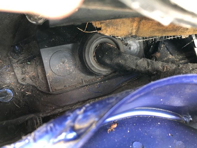

Just a question is this the wiring loom through the bulkhead that leaks?
looks like the sound proofing is perfectly angled to let water drip onto it. What is the suggested method to seal around the loom?
Thanks Darren
