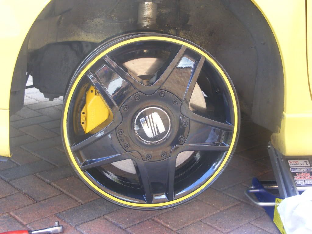

my wilwoods :)
only have 2mm clearance from the caliper face to the inside face of the rim :) , bugger to clean the calipers though
