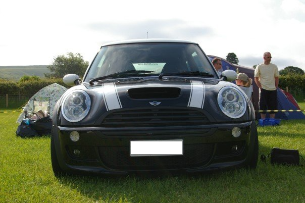

When I did my main grill in it, on the MINI, it was still going strong when I sold the car 5 years later. In fact the latest owner only just swapped it back to a standard grill to sell the car, it appears he's kept it for another MINI of his.
I don't remember sanding my grill when I did it, it was part chrome, part painted.
I plastipped the front orange reflectors on my Mazda 6 mps (they were just that - reflectors not indicators). Only had 3 coats and being at the front would have been prone to weather and grit. I also had occasional roller washes and plenty of jet washes. Good as new after 5 years. It's a very good product.
