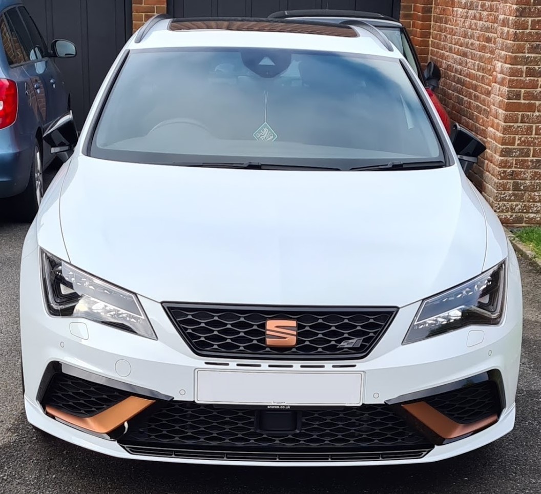

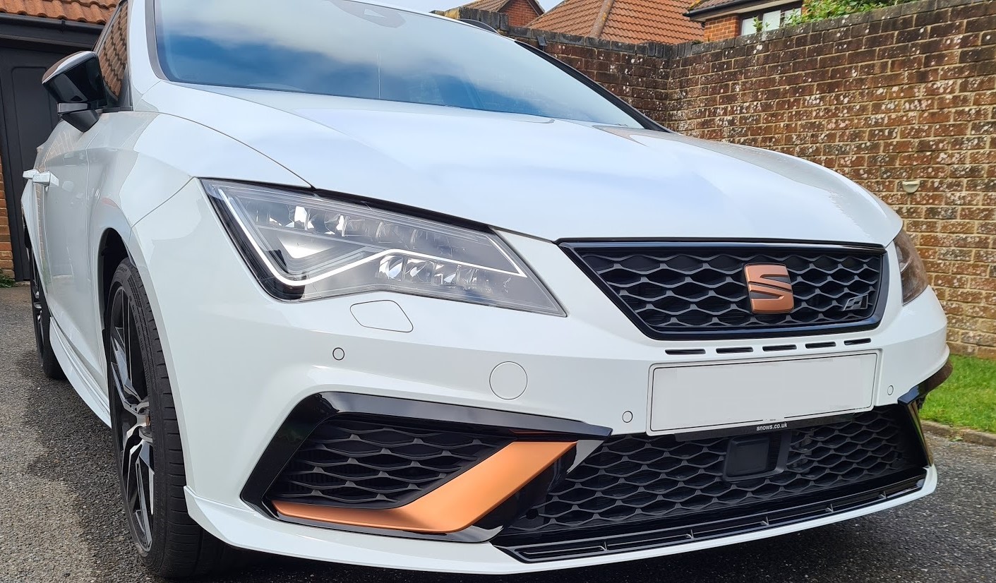

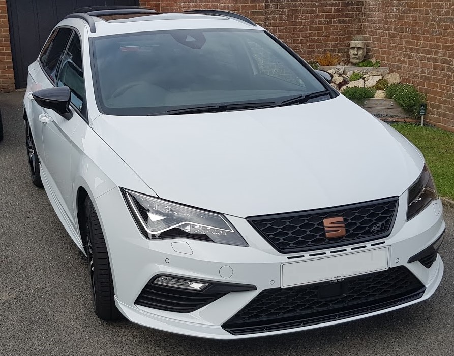

After having them sitting in a box for nearly a year, finally fitted my Cupra R intakes. Was quite a faff and I had to do a lot of trimming and filing on the bottom edge due to clashing with the SEAT aero splitter. Thanks to @Damo H for lots of photos ad comments on how his clipped in so I could get them right. Also attached a before picture.

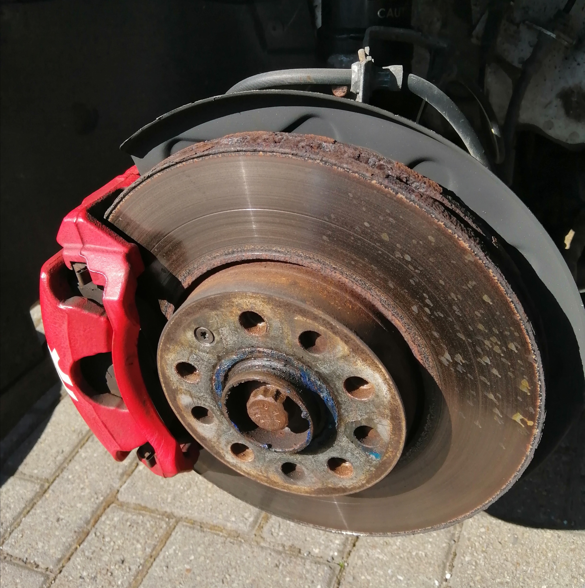

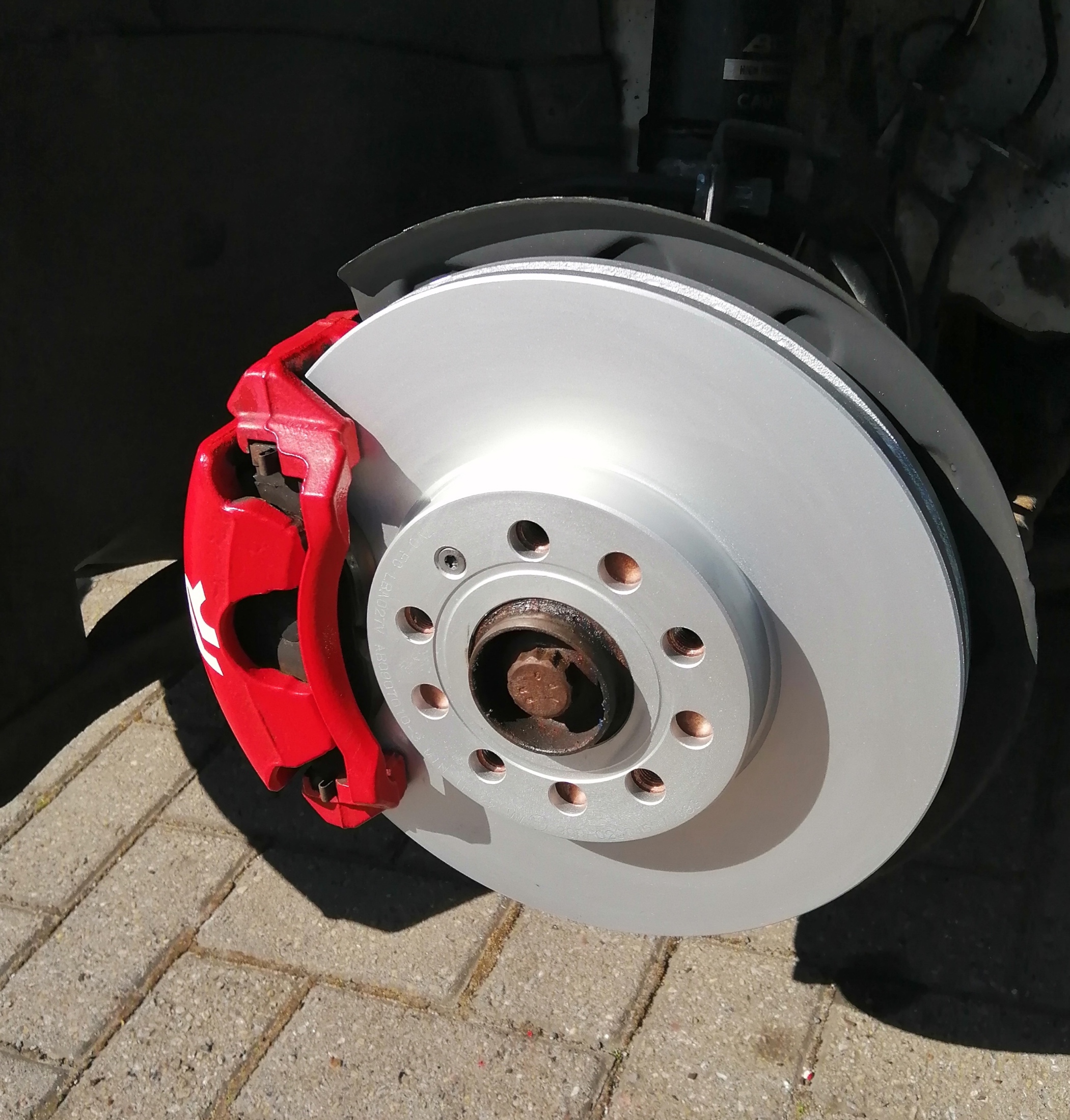

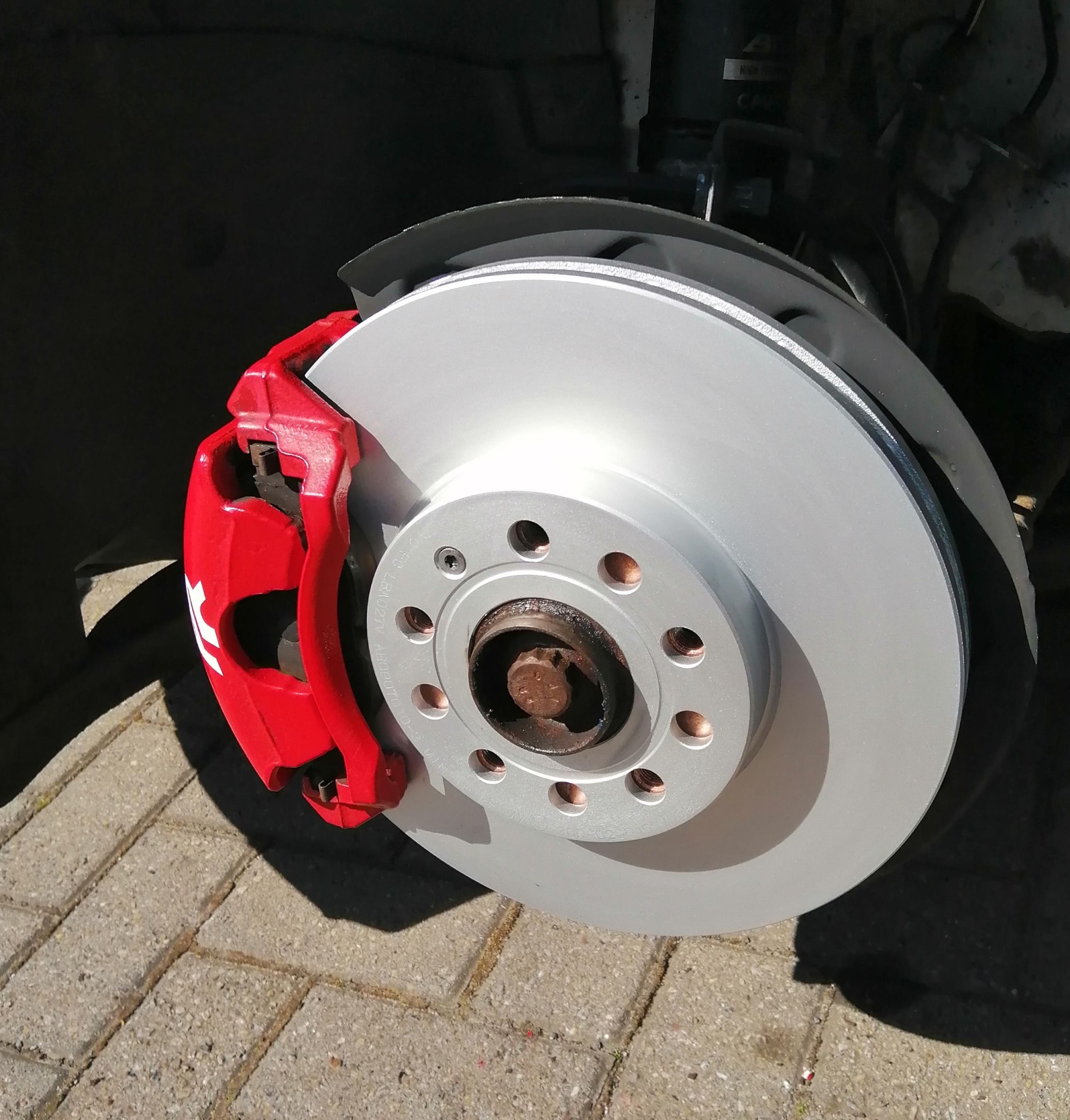

Problem being the old pads will have moulded to the shape of the old worn disc, so the rusty parts of the top and bottom will not contact the new disc causing it to go rusty again in the same places. You are also losing brake efficiency as the whole pad is not contacting the disc.
Sorry just reread this you were just going to remove the silver coating with the old pads?
