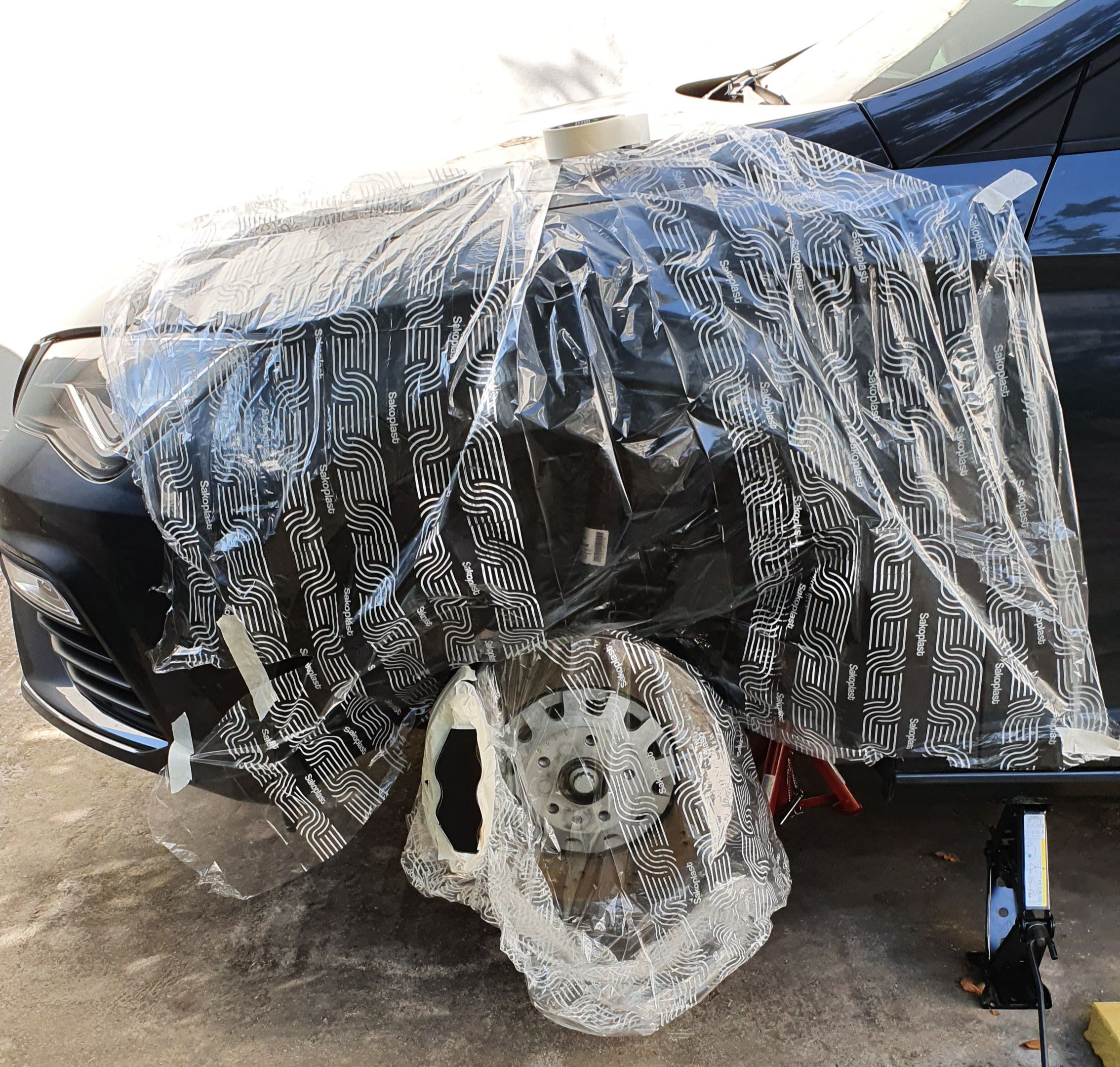

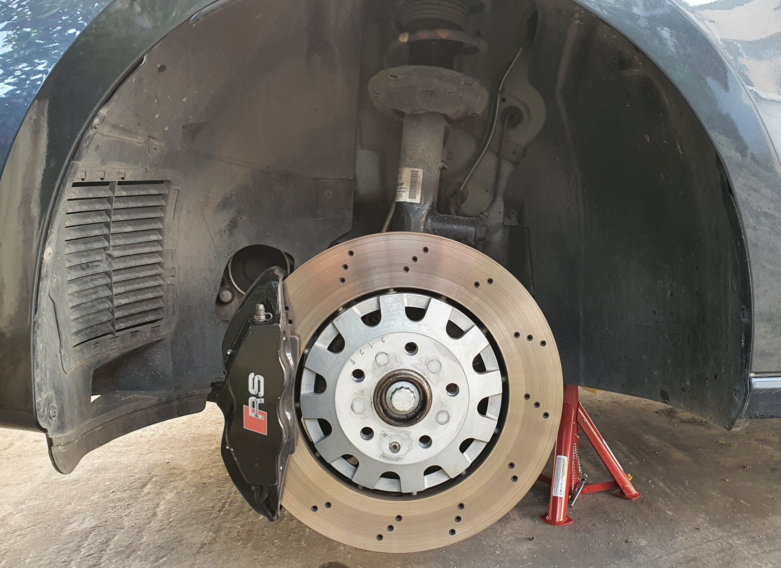

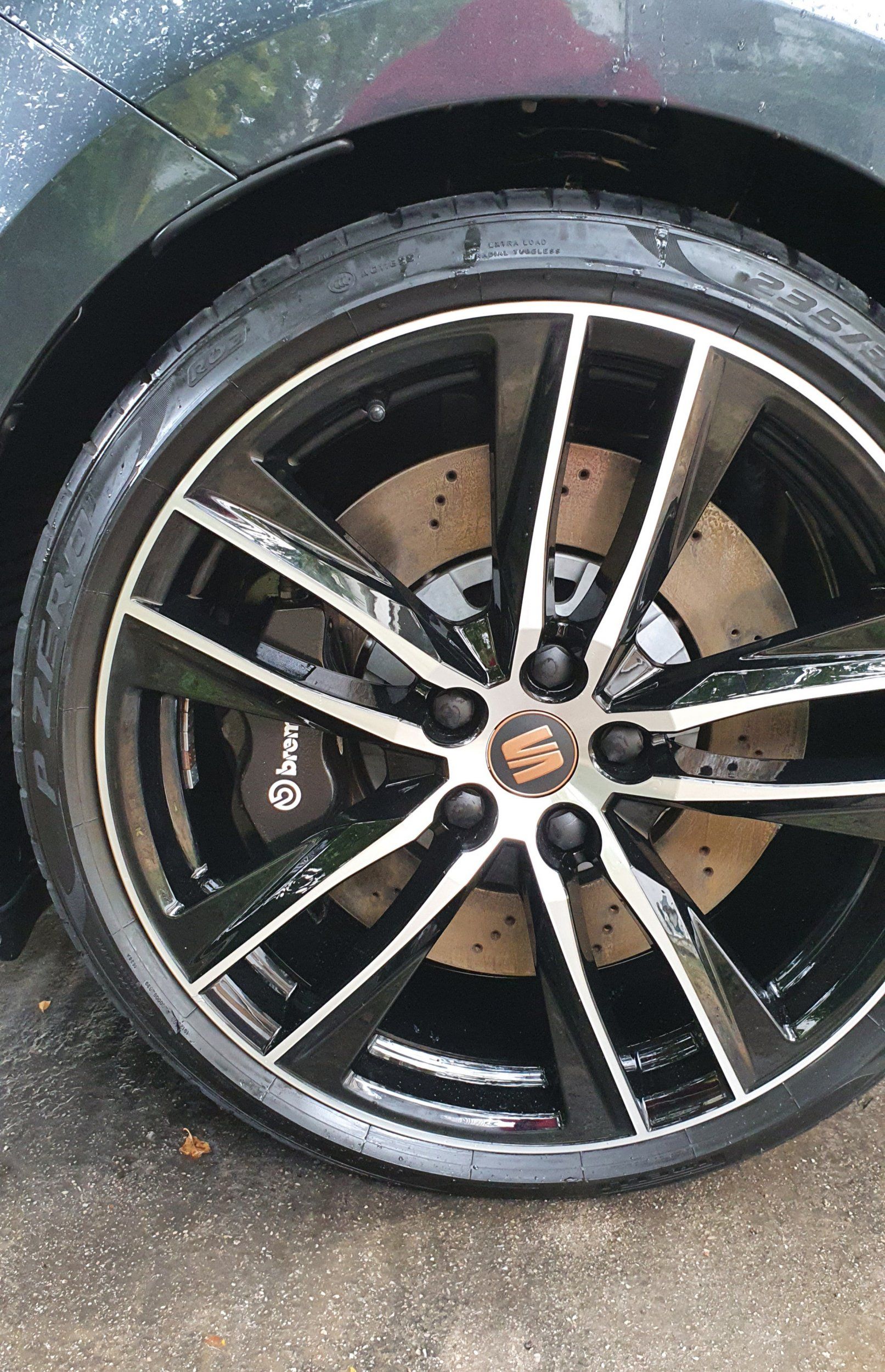

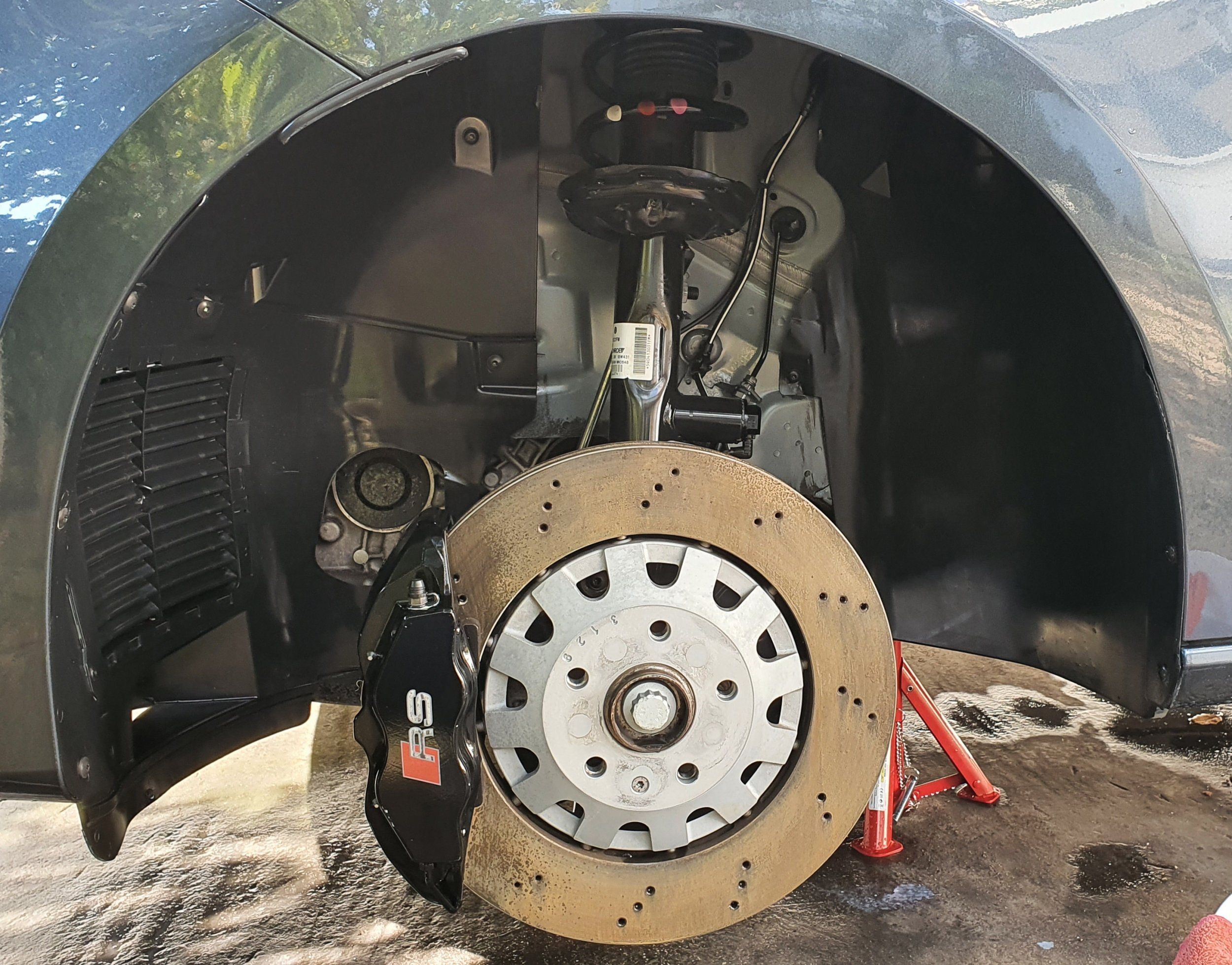

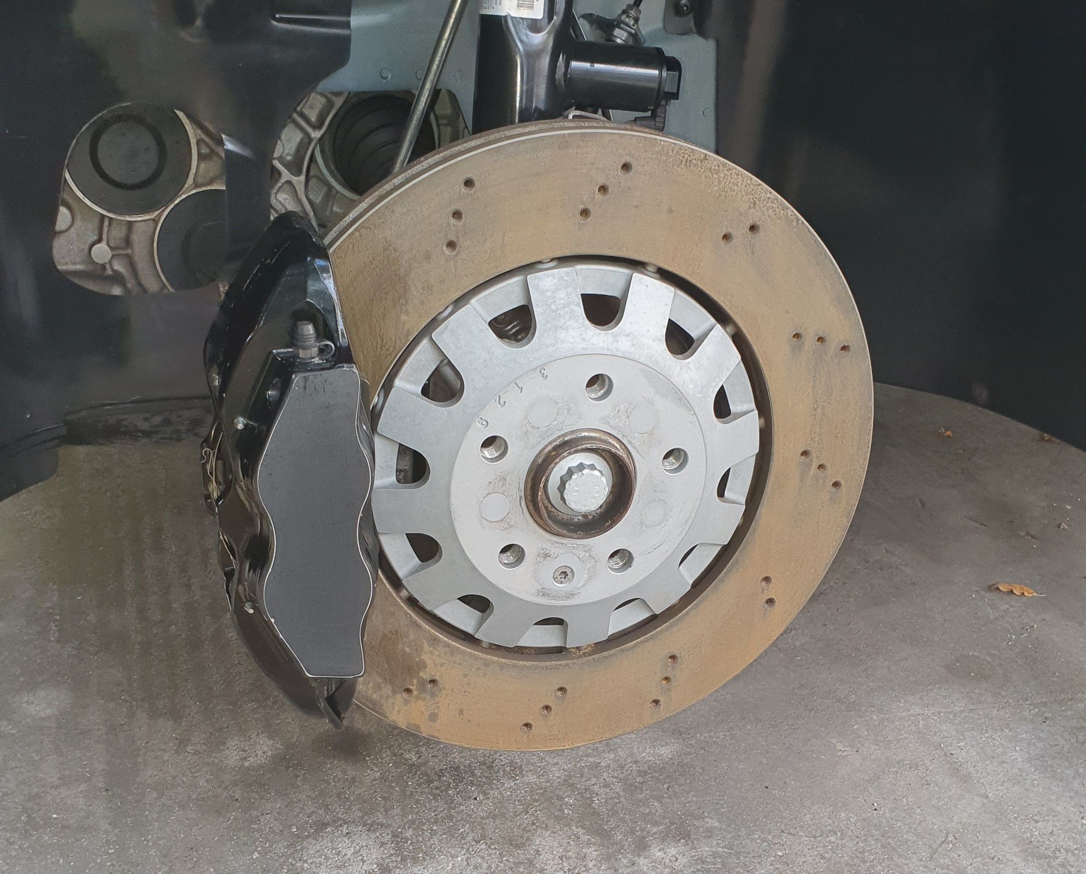

Second lockdown in Greece and plenty of time to spare on the Cupra. So I just started with a deep wheels off-detailing/paint correction/ceramic coating and since I had the wheels off I couldn't resist repainting the calipers and getting rid of the hideous RS logo which kept on messing with my ocd. Not a professional level job but pretty good for now.

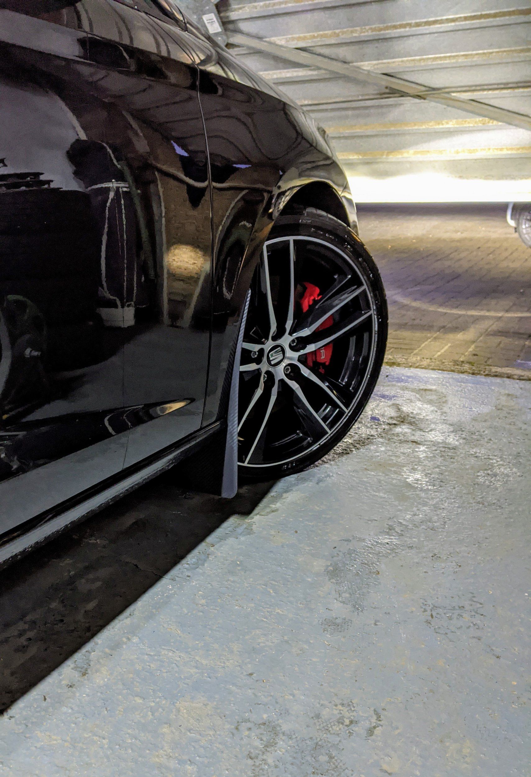

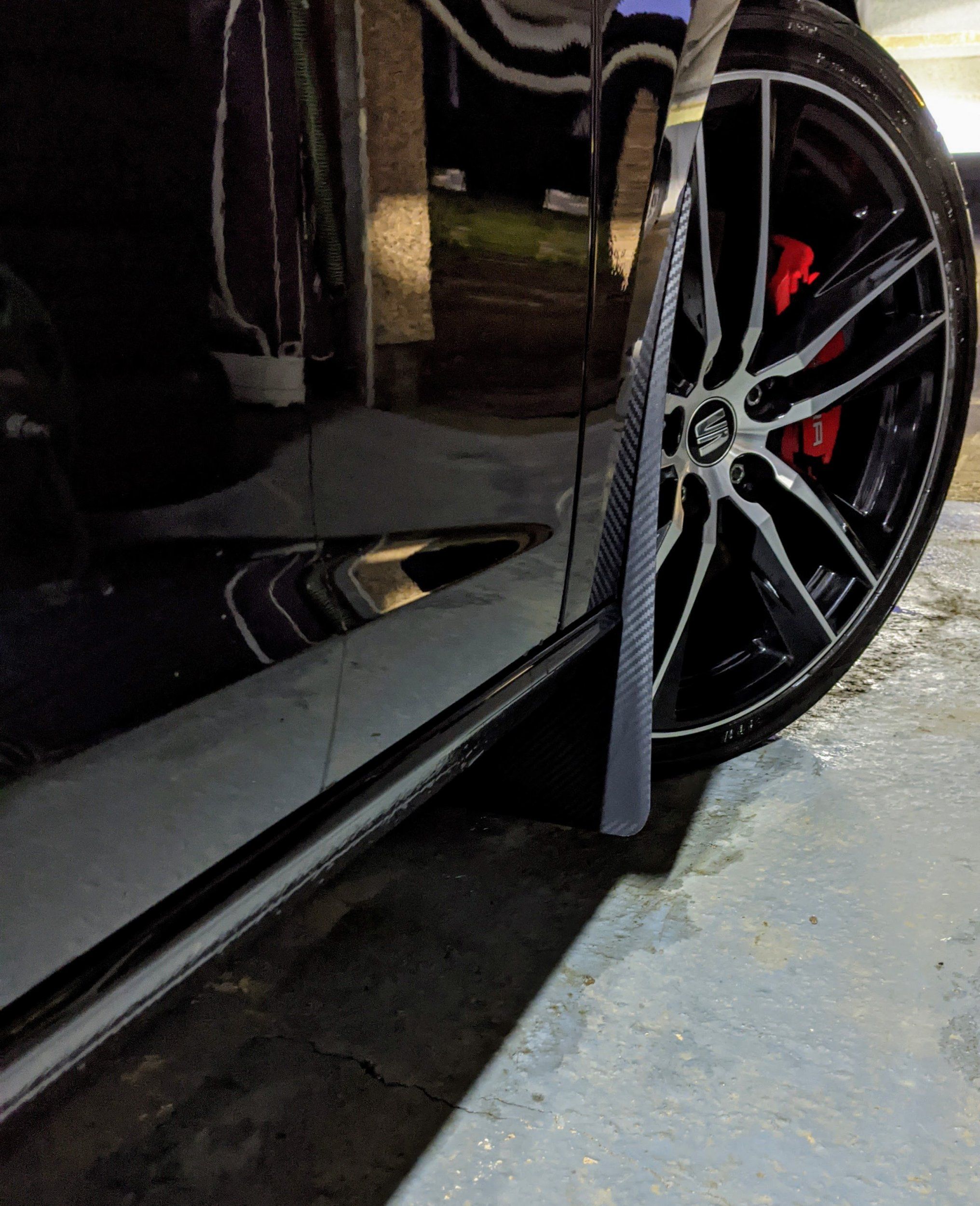

Fitted some mudflaps!
I know not everyone is a fan of them but living in Scotland where there is either grit on the roads or you're on some gravely B road it helps protect the car
Reactions: Walone
ebay...£9.39 and I'm actually very impressed.
No fittings but didn't matter as I used the screws that hold on the plastic trim in the wheel arch

No worries Rob.
When you fit them I used the two screws that are there and if you pull back the inner plastic when you have the screws out you'll see another hole at the top you can use to add an additional fixing at the top
