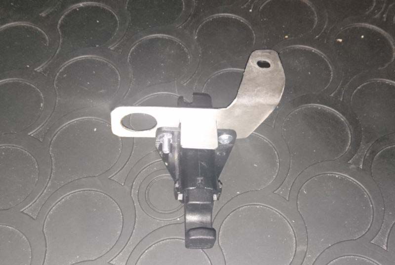

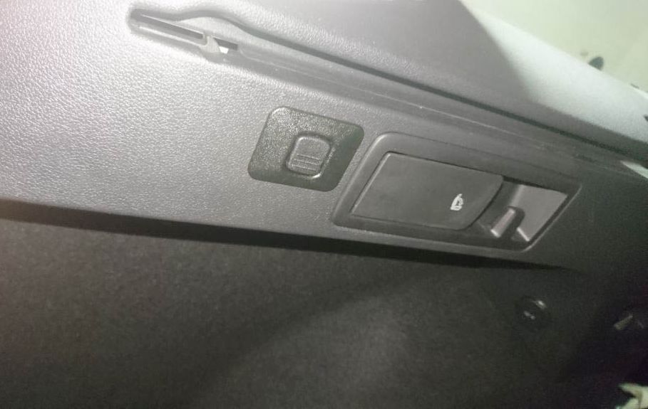

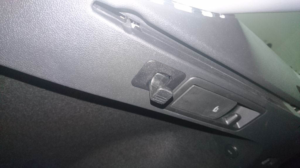

Boot floor holder
I installed Mercedes Kleiderhaken A2128100340 to hold the trunk floor in the up position intead of holding it with my head. But oh dear, that was challenge involving fabricating a stainless steel bracket from scratch, hook modifications, painfully estimating final hook position on completely removed trim to cut opening for the hook, estimating how far the hook should jut out so that the cover plate sits flush with the trunk trim AFTER the trim will snap to place - all it was just a pure guesswork. Wouldn´t do it again. But ok, at least the hook, cover plate and bracket are finally ready for installation, all should fit, but now the real problem started:
How to reliably fix the hook and bracket if I NEVER want to dissemble trunk trim again?
Should the bracket be secured to the steel car mount with the bolt and nylon locknut? Or better with automotive push pin / push clip? Will the nylon locknut fastening be permanent enough if I really don't want to discover any rattle noises in the rear after several years?
How to find the right push pin for the given thickness of joined parts?
And how to fasten the hook (which is made of ABS) and some additional (plastic) spacers to the (steel) bracket? Plastics including ABS tend to creep under the load, plus there´s a heat, plus vibrations when driving etc...
Or is it better to fix the hook with automotive push clips instead of bolt with nylon nutlock? Again, how to find the right push pin for the given thickness of joined parts? And should I use plastic spacers (they don´t rattle loudly if loosened, but plastic tends to creep with time under the load, and hook may become loose)? Or should I rather use steel washers which do not creep, but once they get loose (the hook itself is made of ABS), they will rattle? Questions, questions...
Could someone give me some hint about the best way how to fix the hook and bracket to everything hold nice and tight for years? Screws and nylon locknuts, or push pins / push clips?
I would really welcome some opinions.
Thanks.

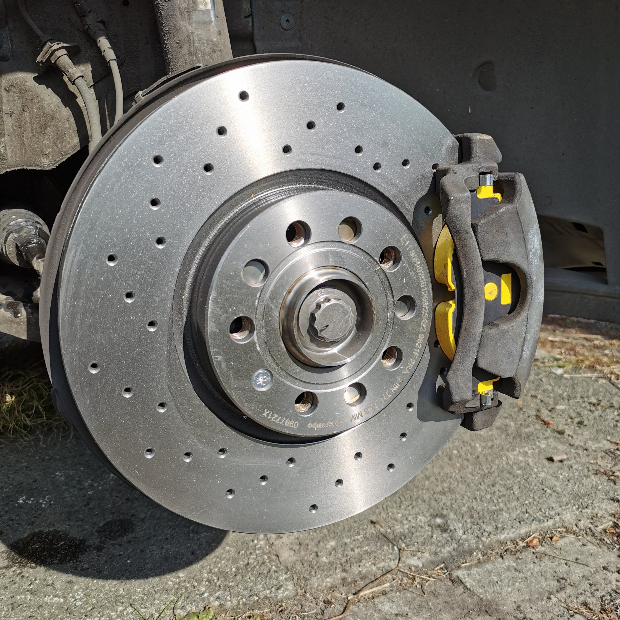

I finally got round to fitting my new discs and the Yellowstuff pads I won here:
I've just been for a 16 mile jolly up the motorway to the supermarket and back and I'm very impressed. They're not bedded in yet but they feel strong and firm with no noise at all. Very impressed!

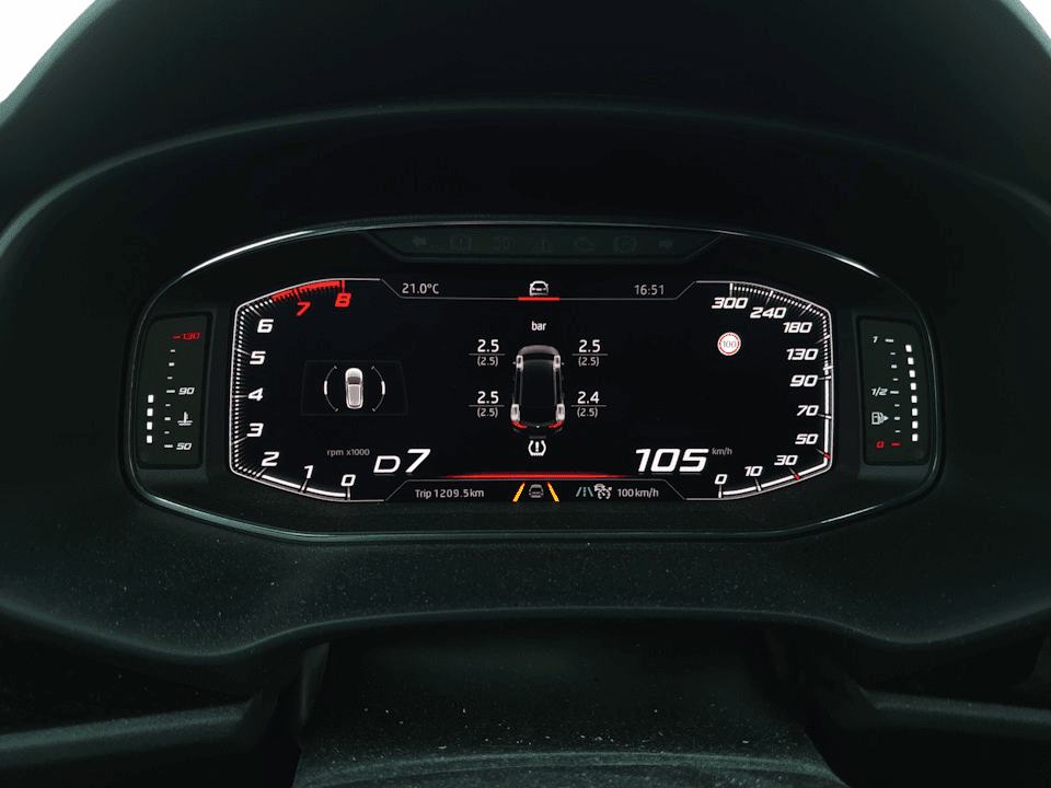

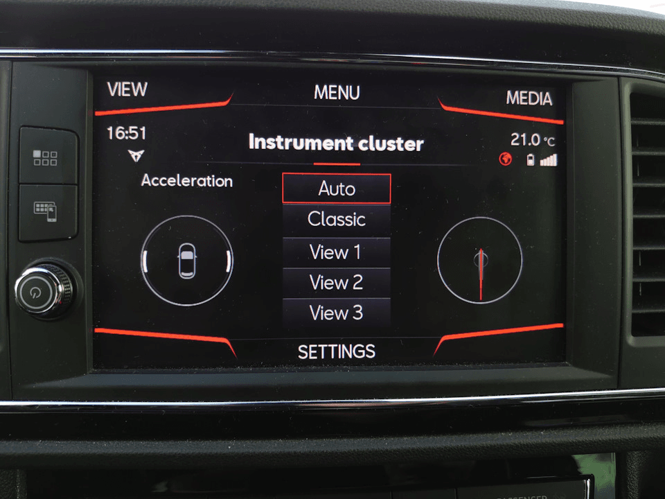

I found a fun bug that disabled the data view on the right clock, and turned it to a "partially-classic" mode:
(in case you don't recognise the user interface: I've modified my user interface to look a bit less outdated ;-) )
