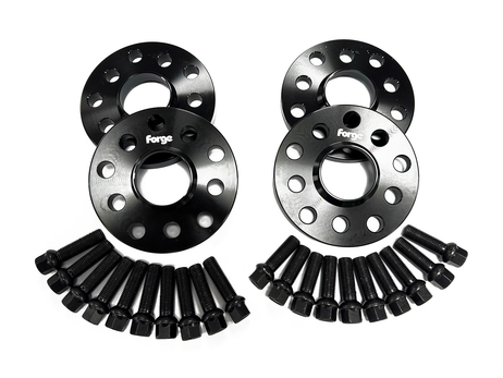

Has anyone bought or used these?
Thinking about 11mm/16mm or 13/16mm on my FR. 18" OEM wheels.

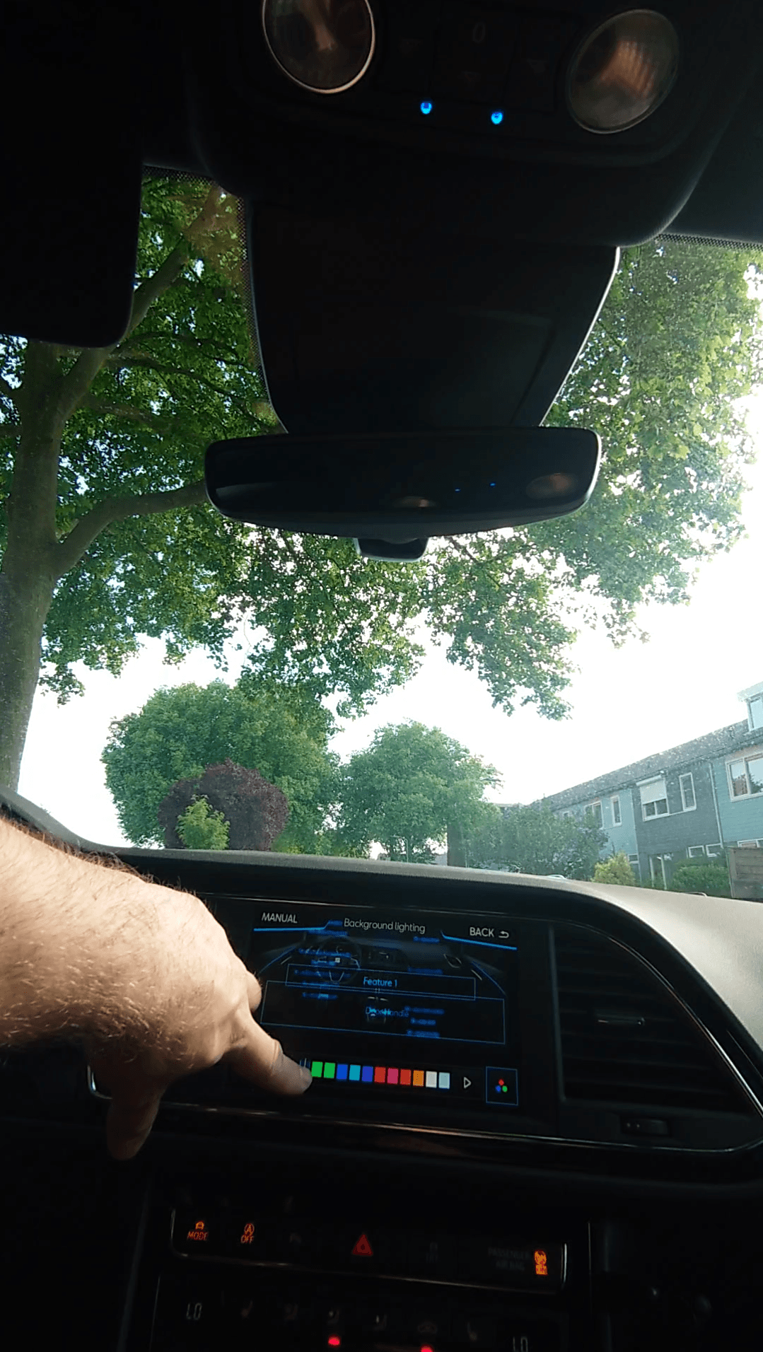

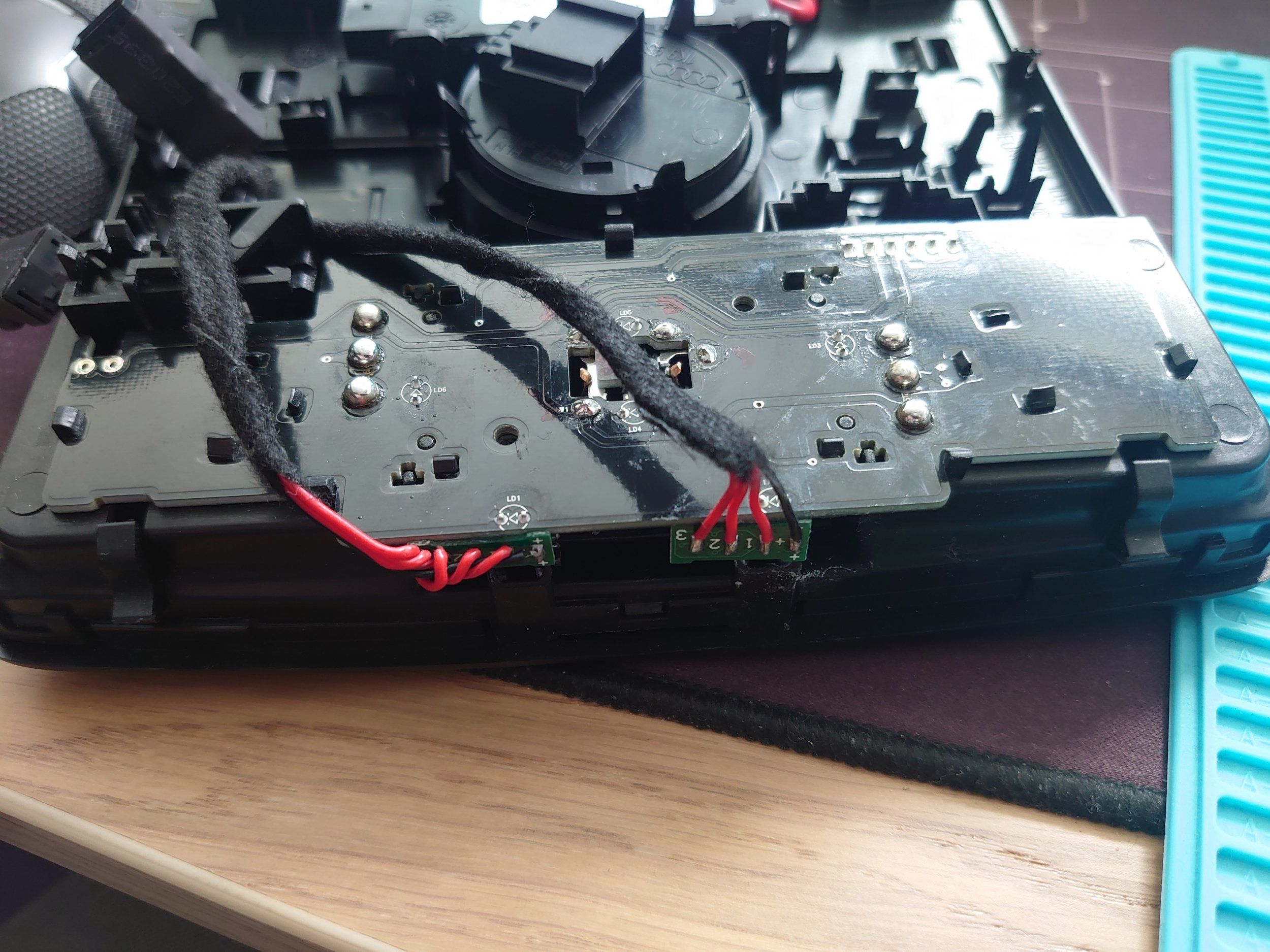

I remember a few years ago, I wanted "submarine lights" from the W8 Passat in my Scirocco. A few years later, on my Golf Mk7, I finally had them. And now on my Leon, I had them again.. but this time they collided with all the RGB ambient coloring in my car... so I had to find a way to turn the 2 red dots in the ceiling to something more colorful....
So I took 2 small RGB LEDs, and cut off the original 2 red LEDs, and put them in place like this (I lined them up a bit nicer, and glued them in place on top of the "lens" after taking this picture and put black some insulation tape on top of them to prevent any light bleeding).
And this is what it looks like during the day (it's nicer at night, but never distracing or not too tacky, in my opinion:devilish:). Here's a picture of me switching to blue. For those who've read my blog: yeah, I still need to update the color palette. (read more about that here: https://www.drive2.com/l/566377681994648900/ :ROFLMAO: ). The user interface on the screen is my own custom version, I've enabled texts for all the missing zone graphics. like door handles and "feature 1" (default images in the firmware for these two are very wide, but fully transparent). Also, the font is from Seat MIB3). I'm adding graphics for the door pockets, roof, center console/armreset area and door handles in the upcoming weeks when I find some time to do so :) )

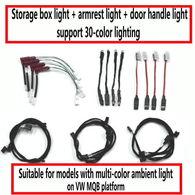

The source of these LEDs is an Aliexpress ambient lighting kit for Passat. It wasn't the cheapest, but it came with a bunch of LEDs that could be set to be controlled on multiple zones. (https://www.aliexpress.com/item/1005001387725795.html) I got this one:
The LEDs in the upper right corner are pretty cool, they are like a scaled down version of the footwell LED units. I coded my BCM so they can be controlled as a center console group, and added the units to several spots in the center console. I don't have any picture of that right now, I'll make some when I'm in the car and it's dark outside. The LEDs in the ceiling unit are the ones in the middle. note: I think the LEDs are waaaaay overpriced, but they function like OEM, and are still much cheaper than what a similar OEM set of RGB LEDs would cost. Plus they come with OEM-compatible connectors, and a harness that plugs into your existing RGB footwells.

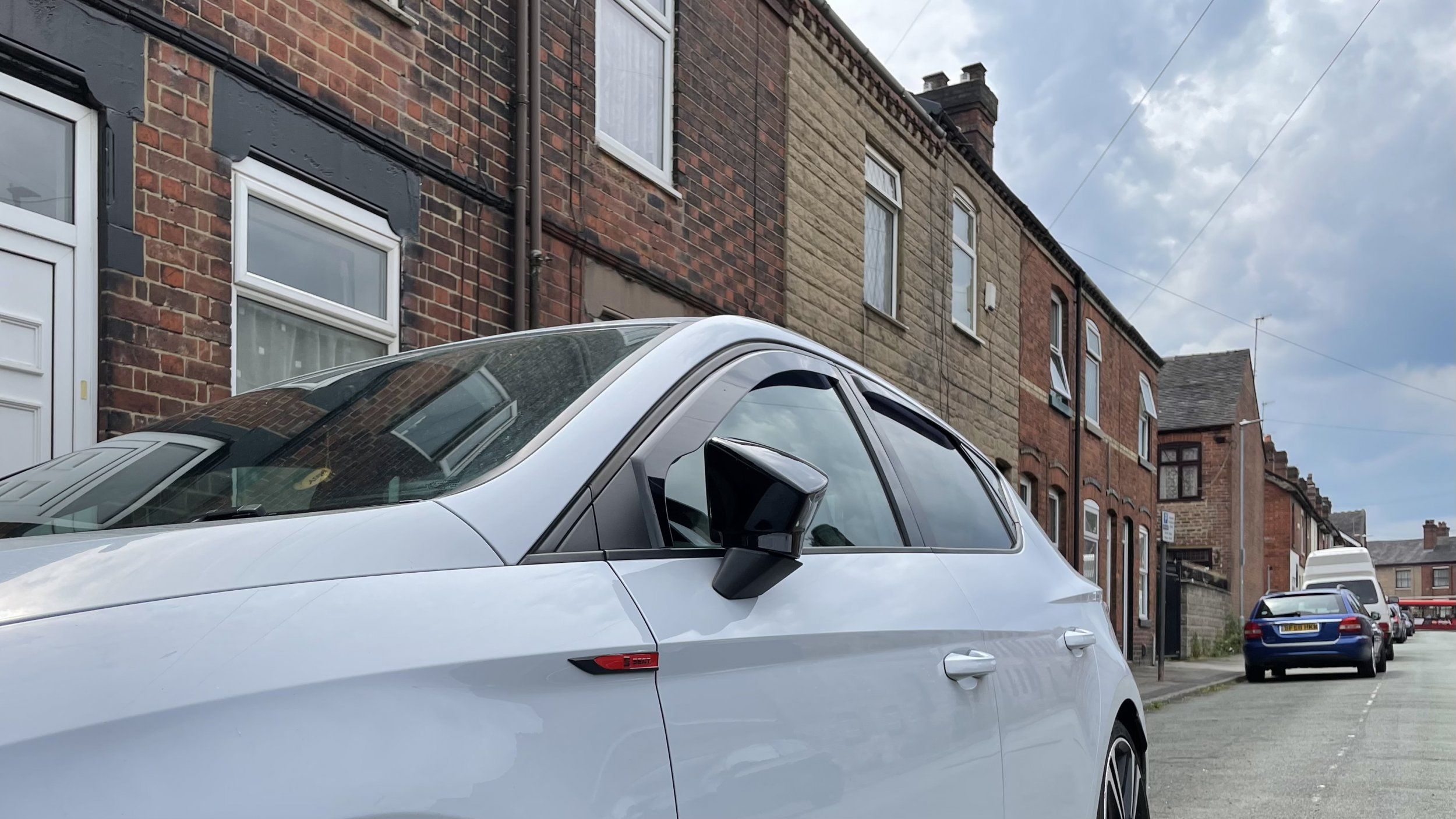

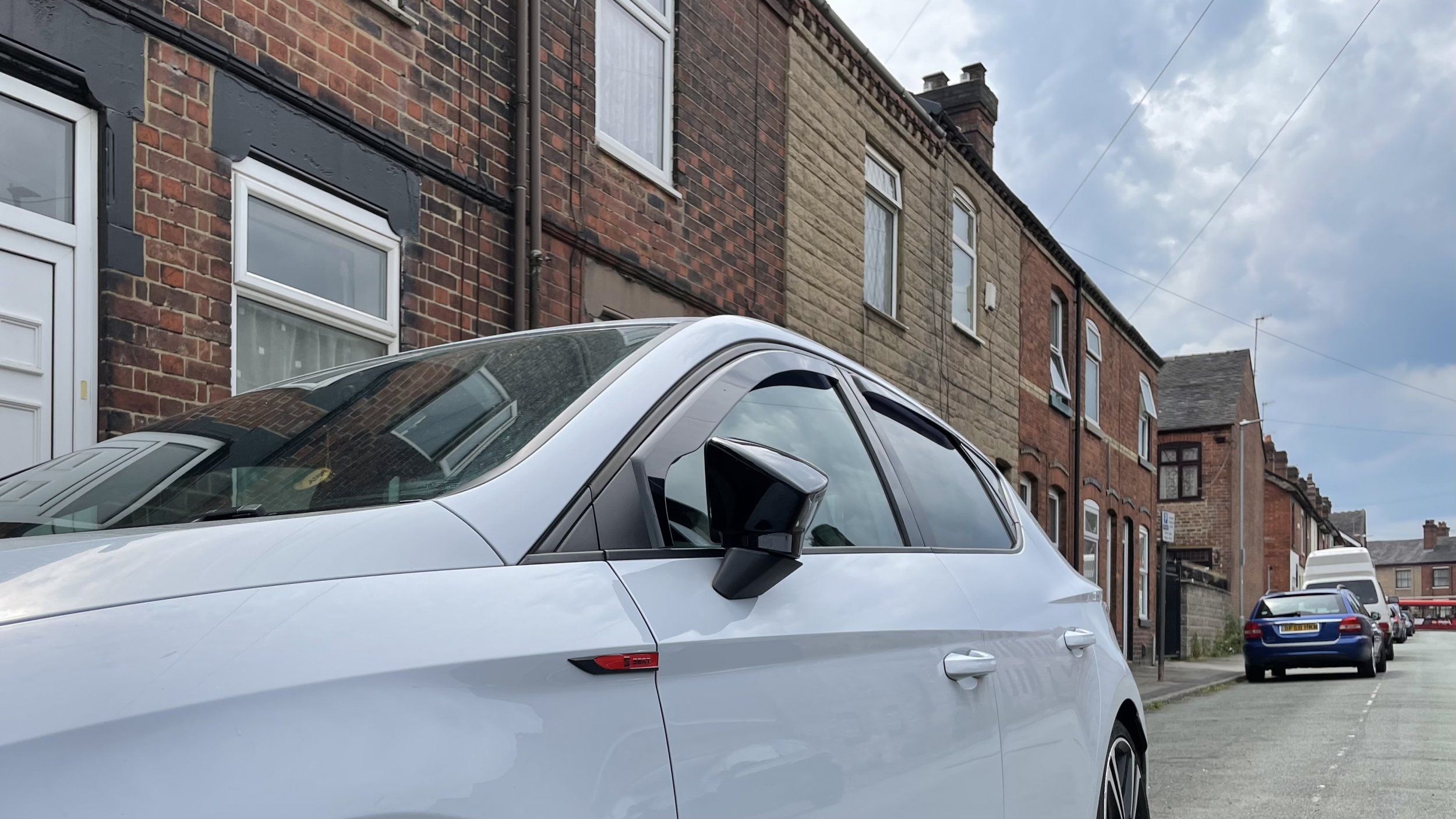

Anyone have a link to some decent wind deflectors that definitely fit the mk3 cupra? Can’t seem to find any.
I used these for my Cupra hatchback. But they do do ones for the estate too.

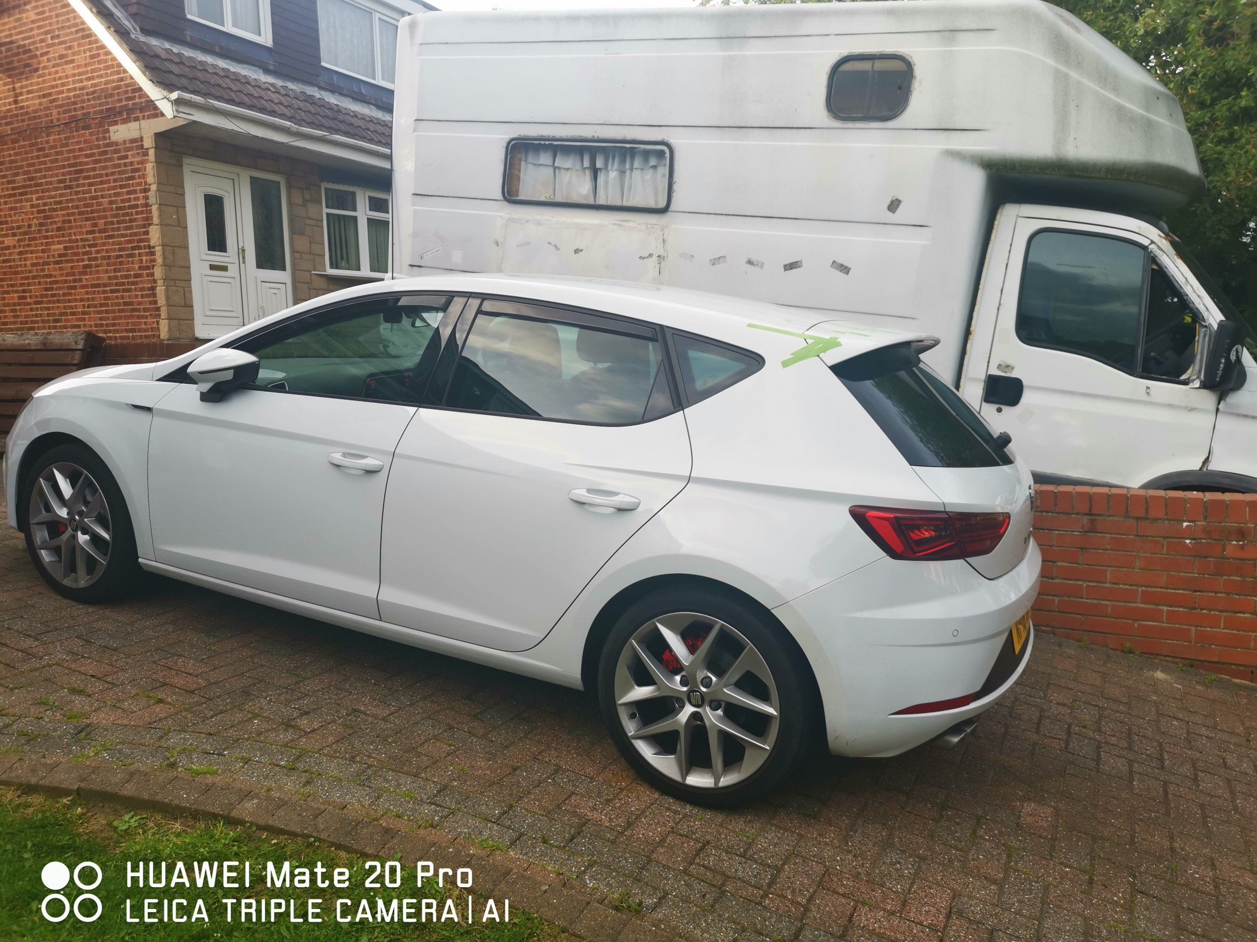

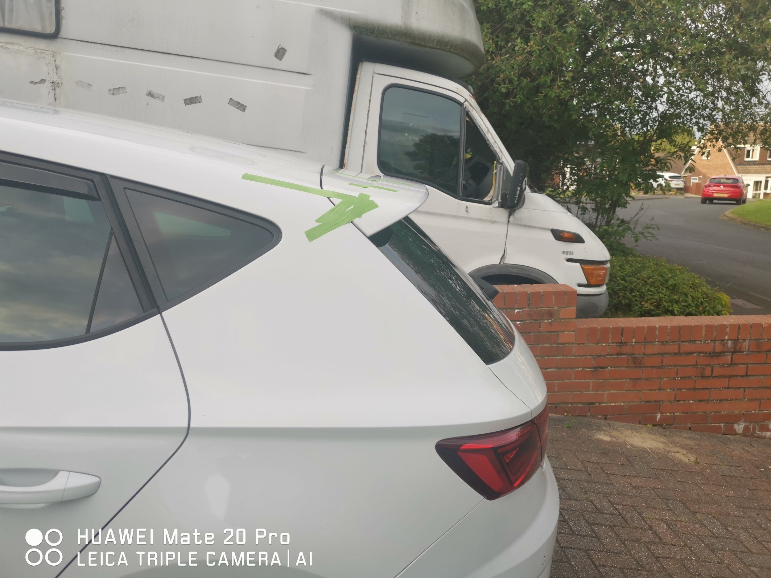

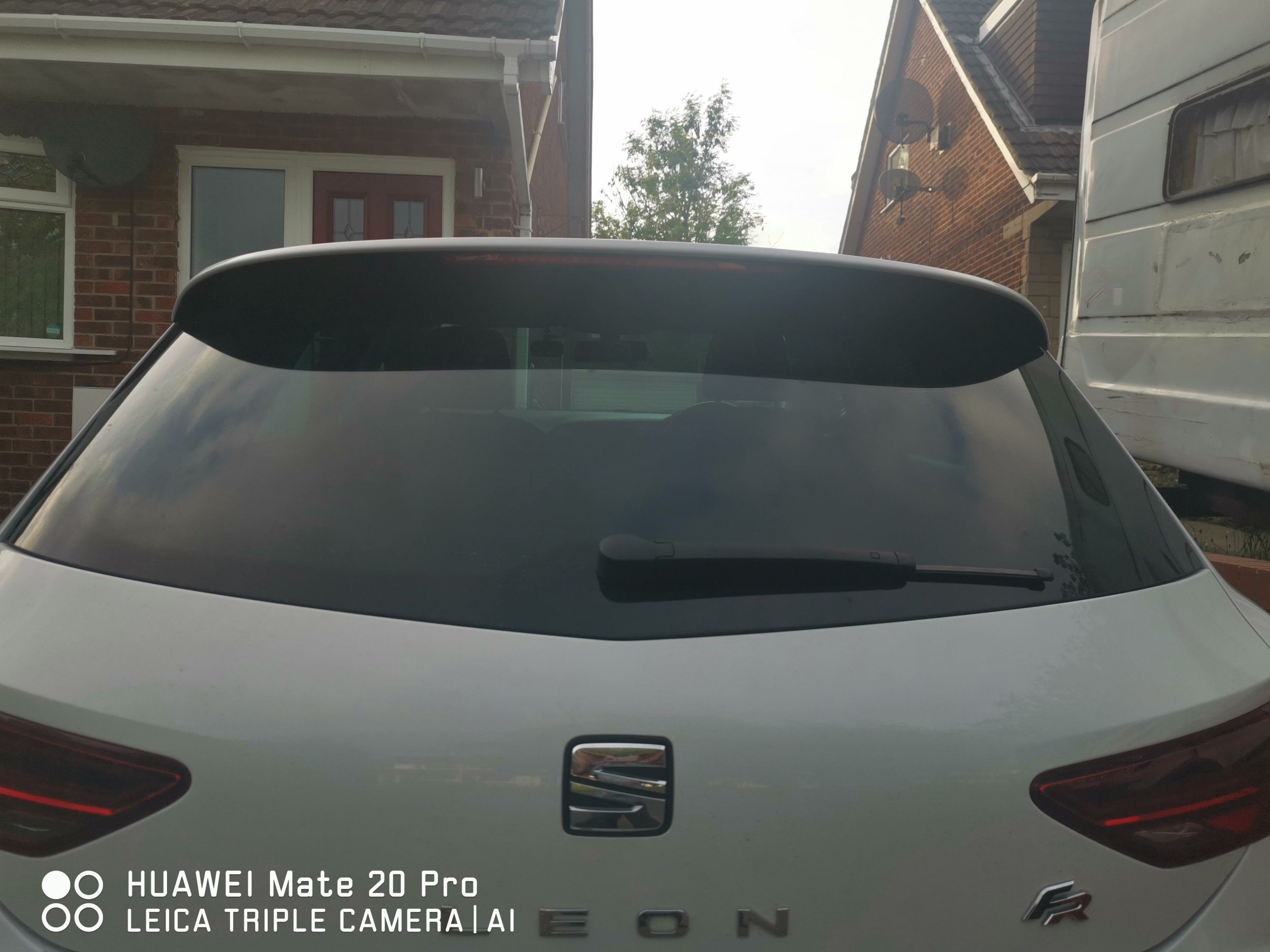

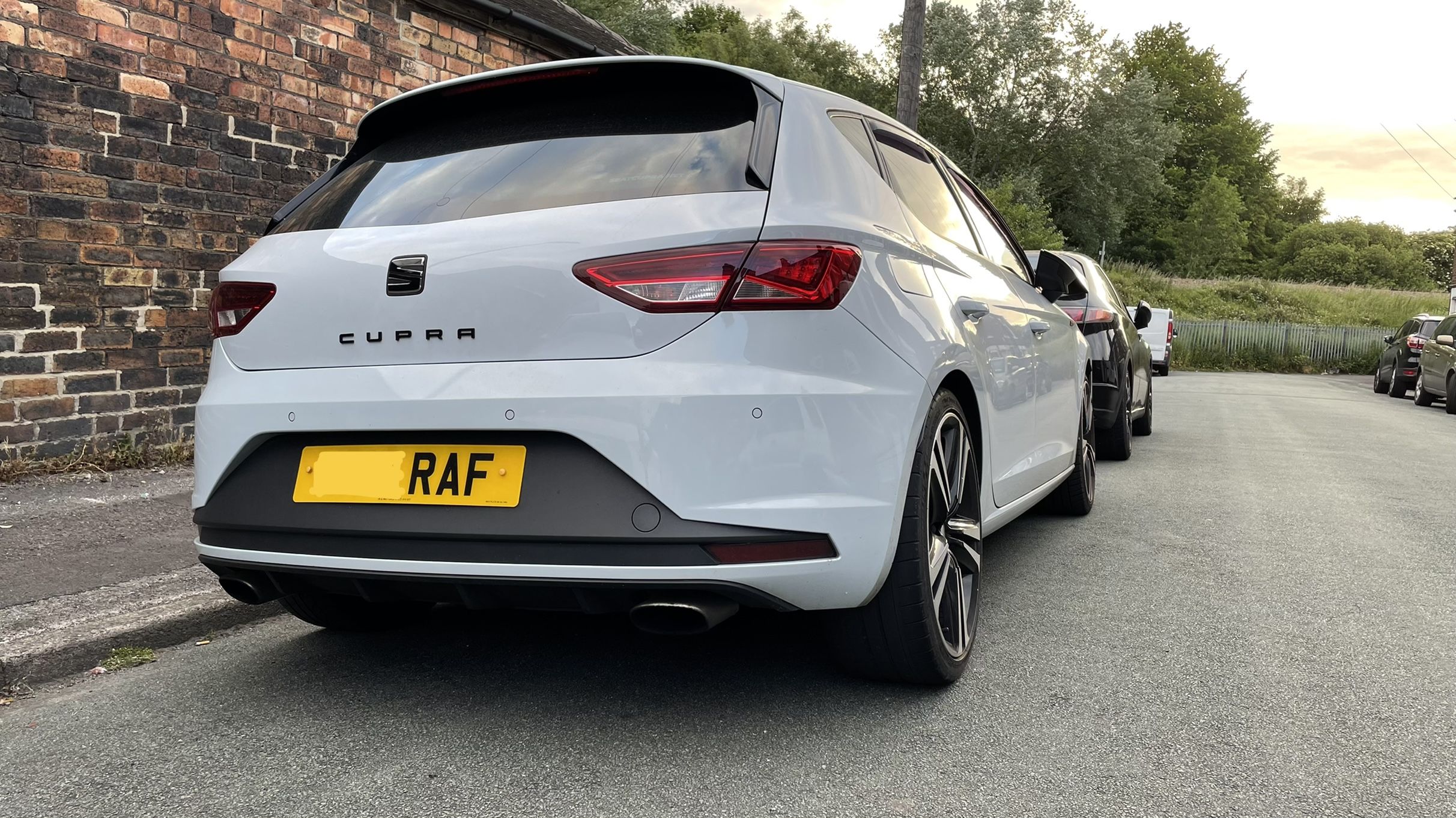

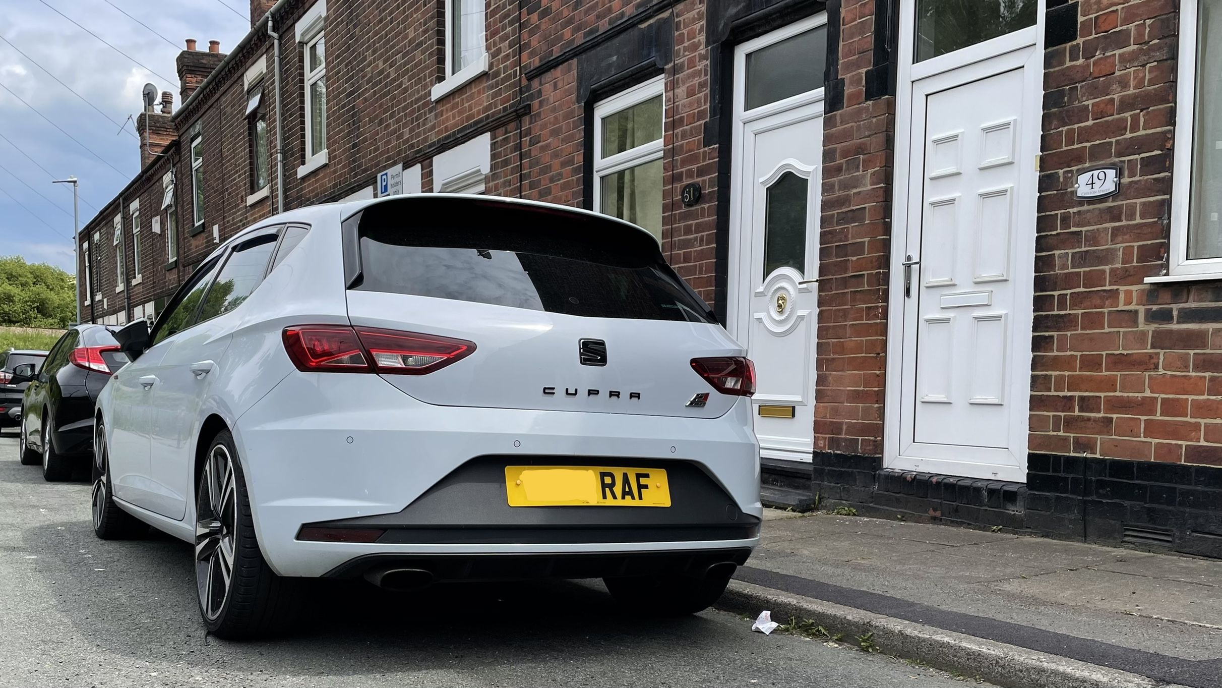

Managed to fit a cupra 5 door spoiler to my FR today, just need side wings and spoiler cap now
Reactions: DyoGoR and zeffania
Looks great nice job, i also want the side spoilers for rear window just cant bring myself to pay such a high price for plastic ?
Snap, I have some for an aero spoiler and the spoiler which I'm selling, but the cupra ones are an eye watering price for 2 bits of plastic
They must be rare as hens teeth, unless you pay £120 from seat parts. All the ones on ebay are for the aero spoiler not the cupra version

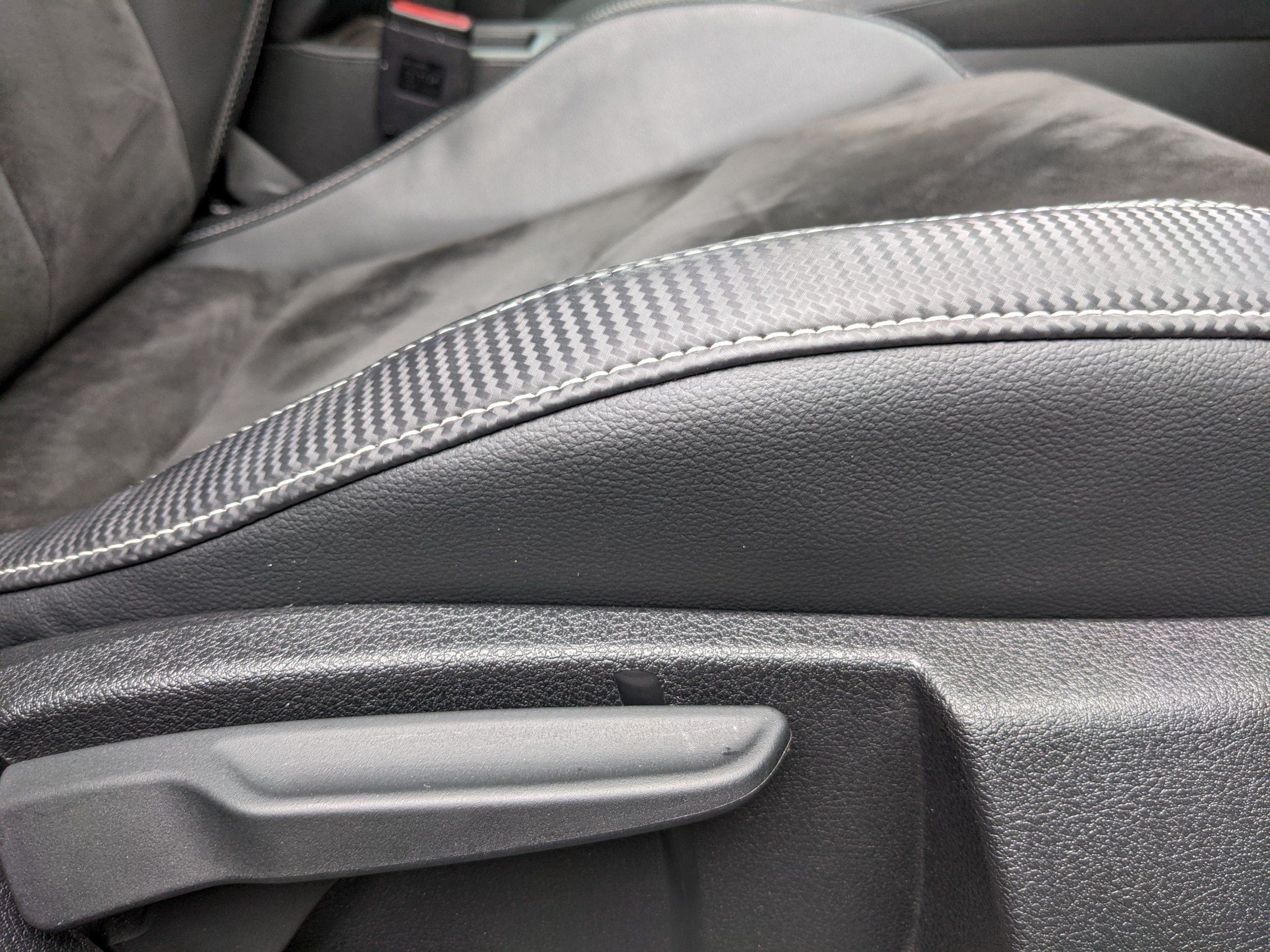

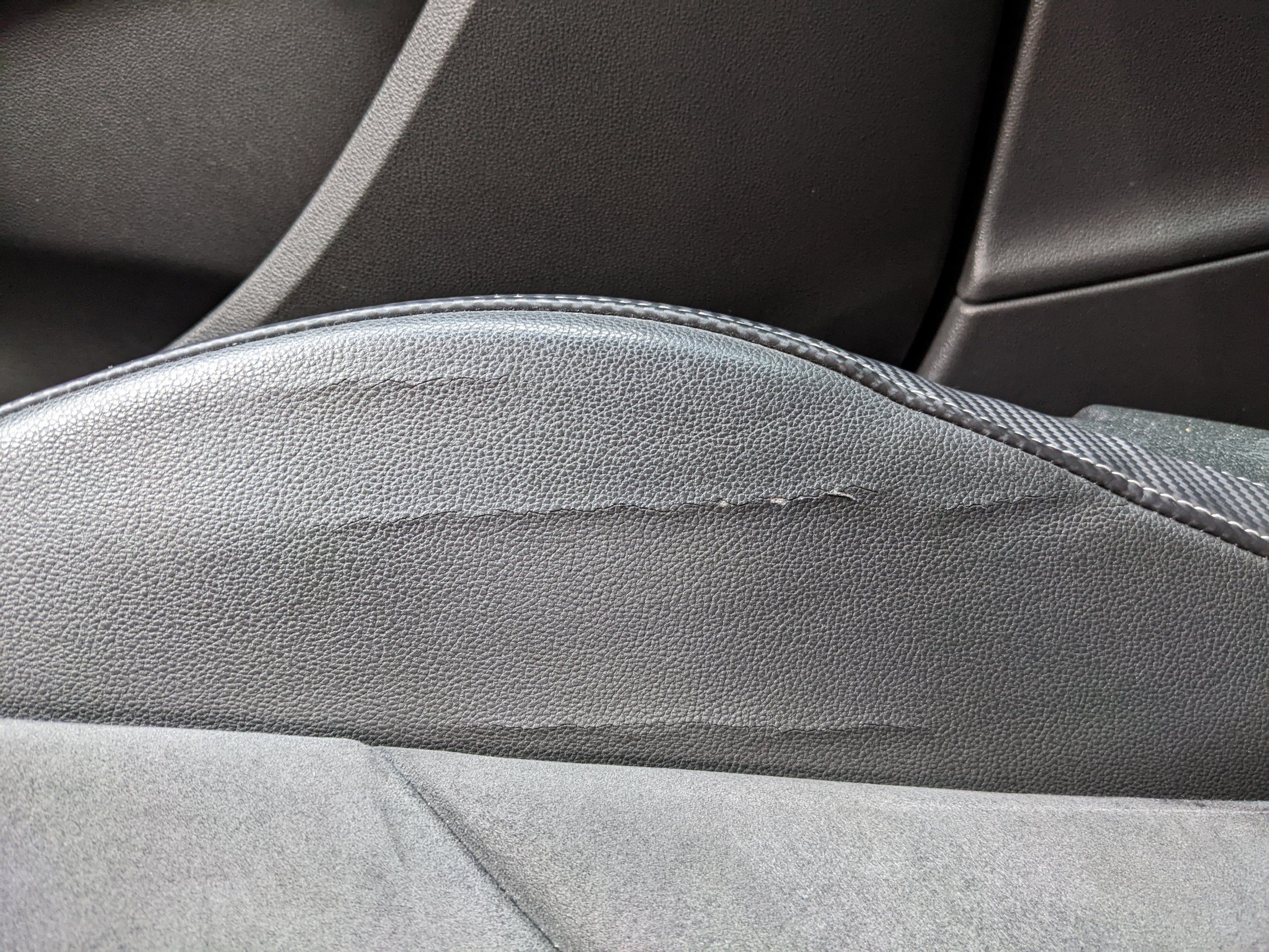

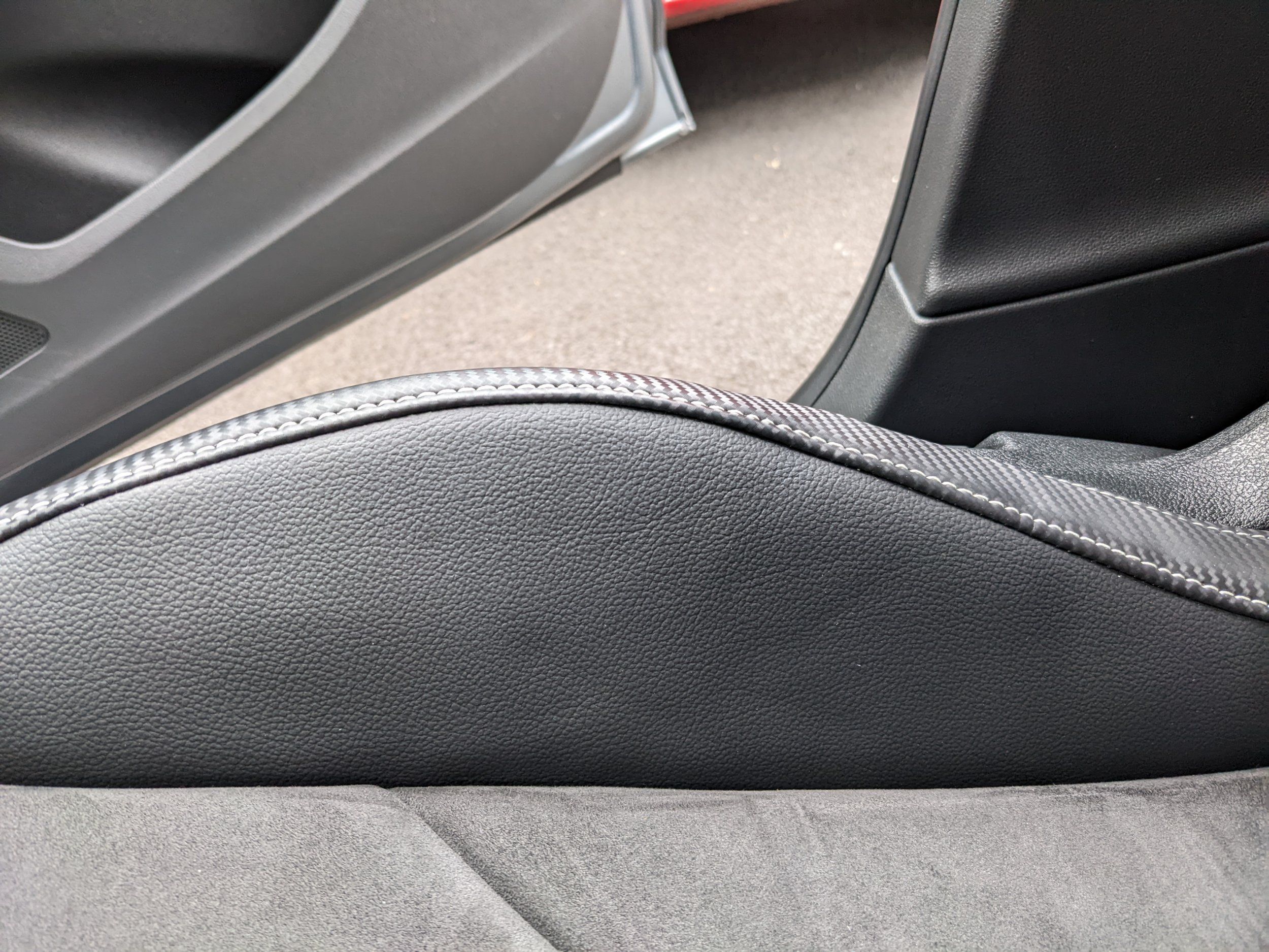

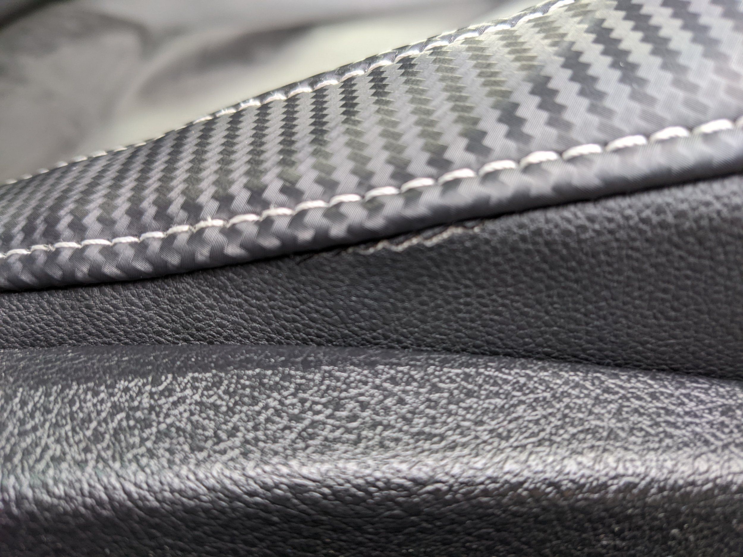

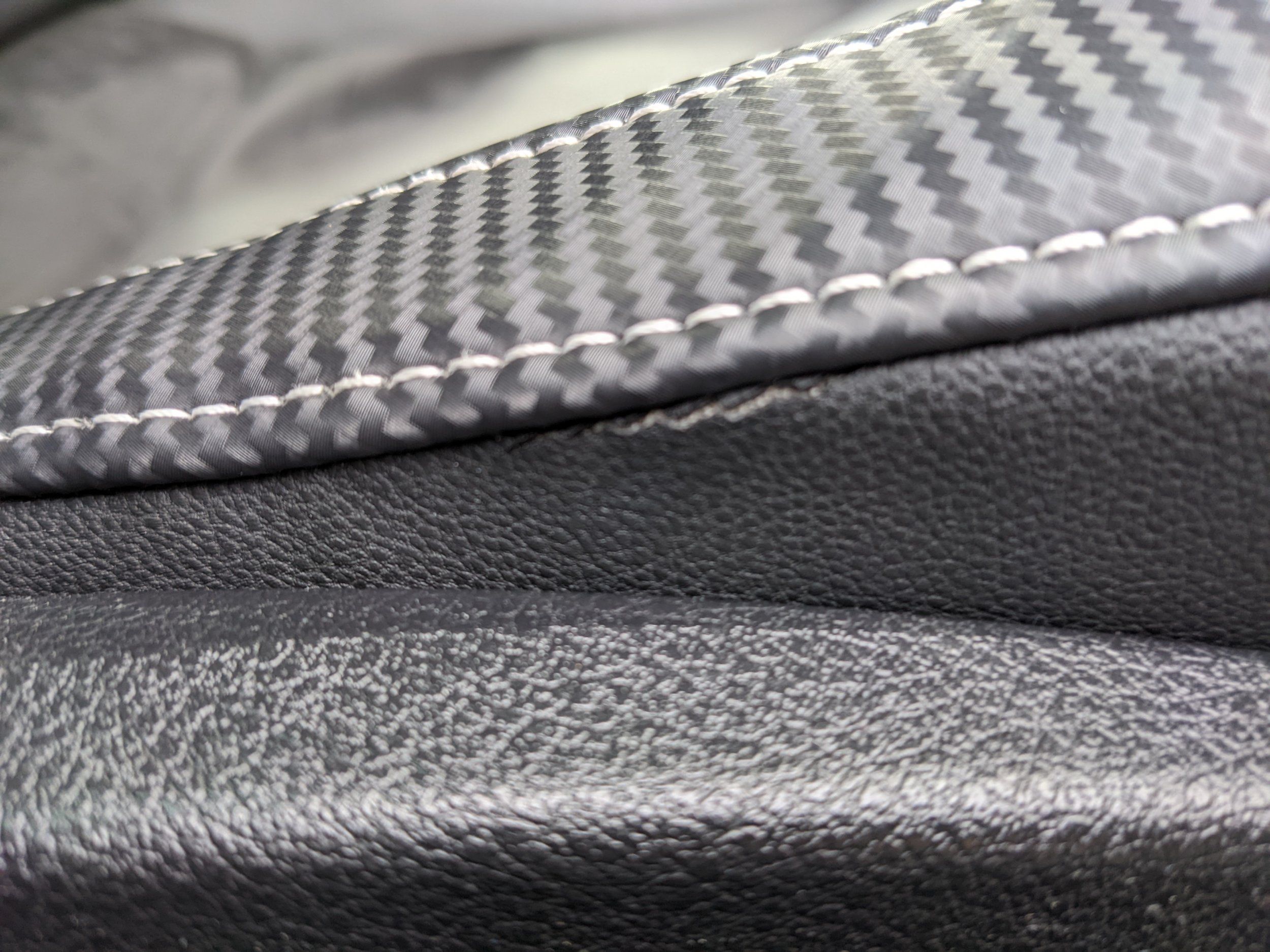

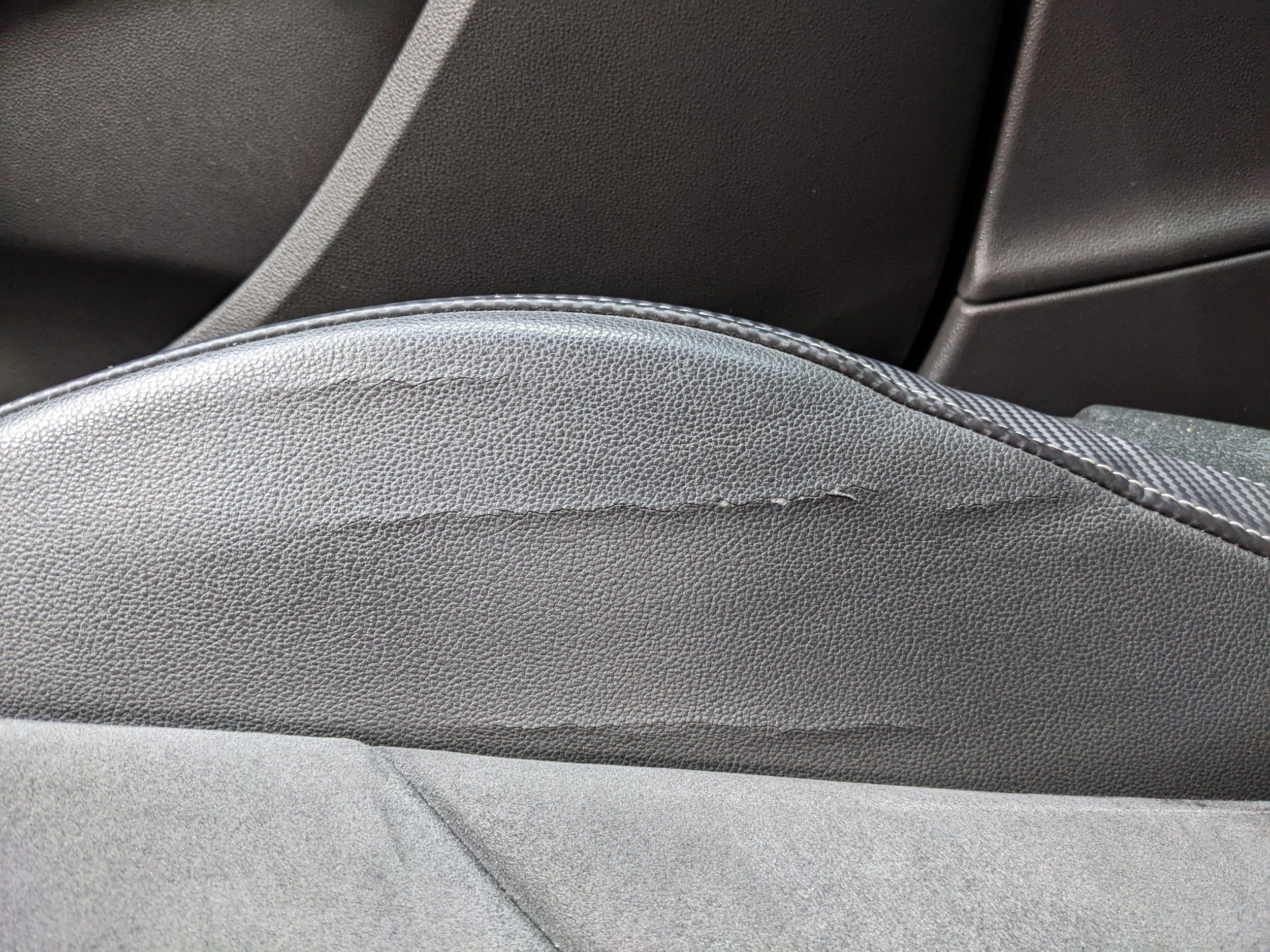

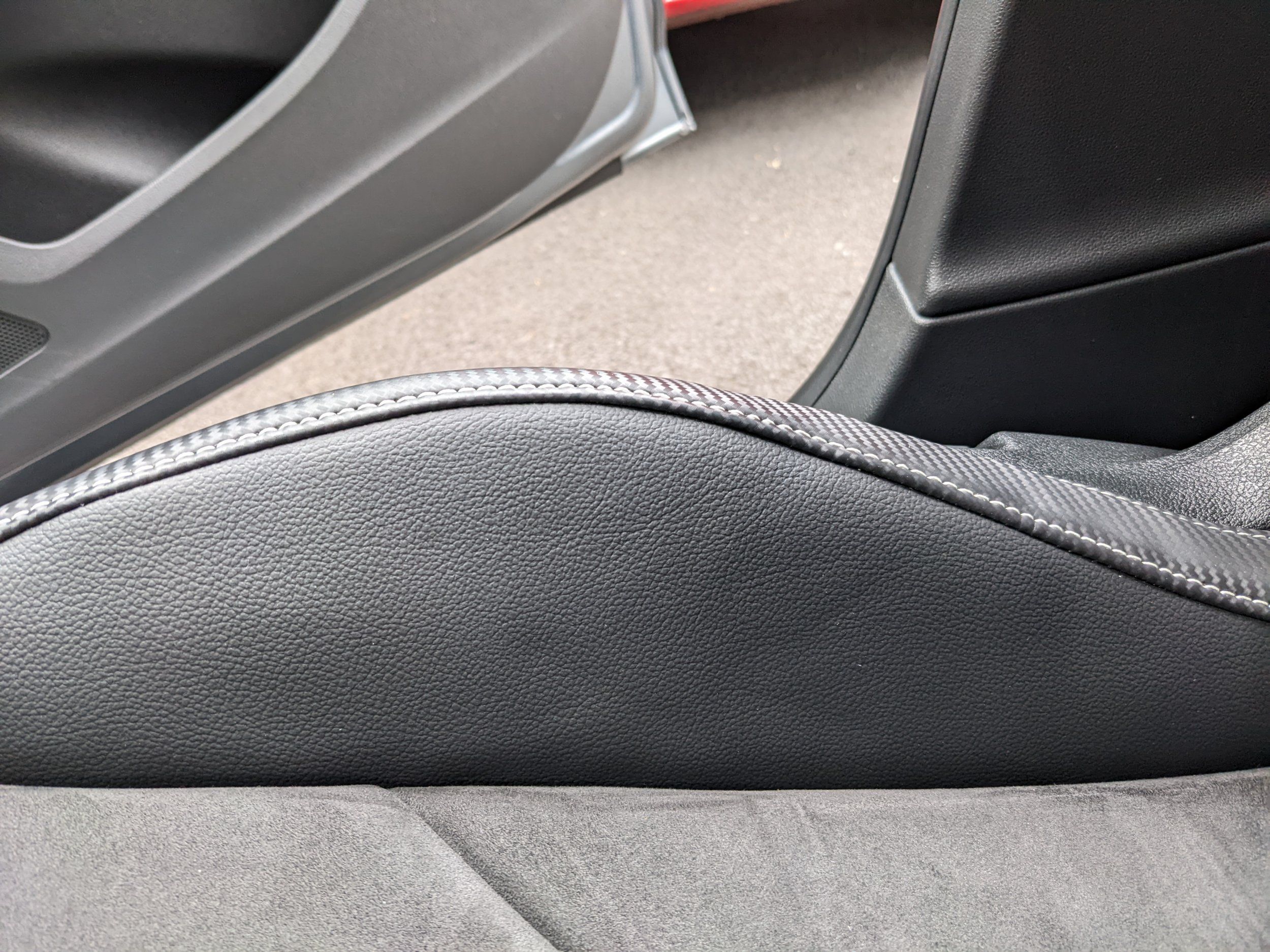

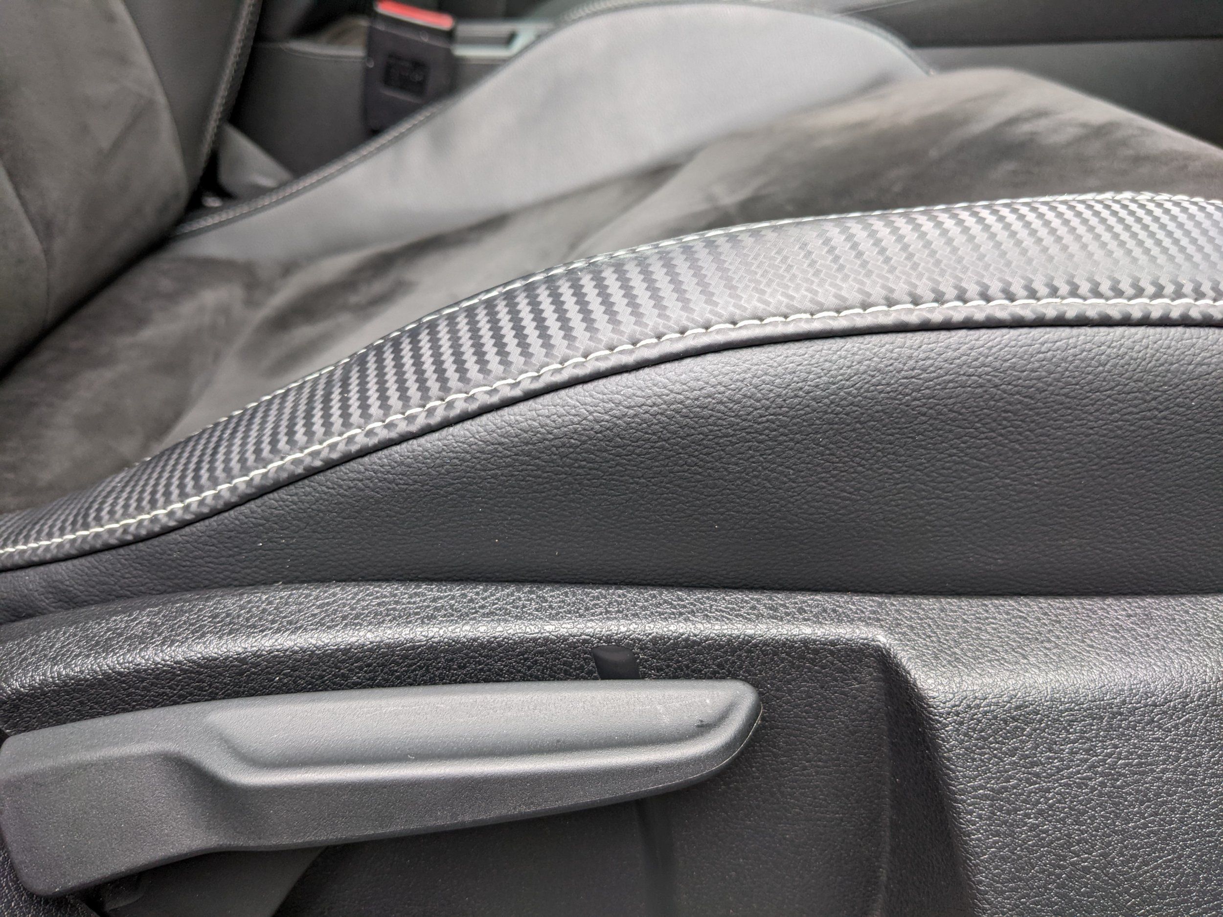

I finally got round to getting my drivers seat bolster repaired, after getting no joy via Seat Customer Services. Apparently 3year warranty does not cover the seats, they have a 6 month or 6k mile warranty. Well impressed with the result.
Before
After

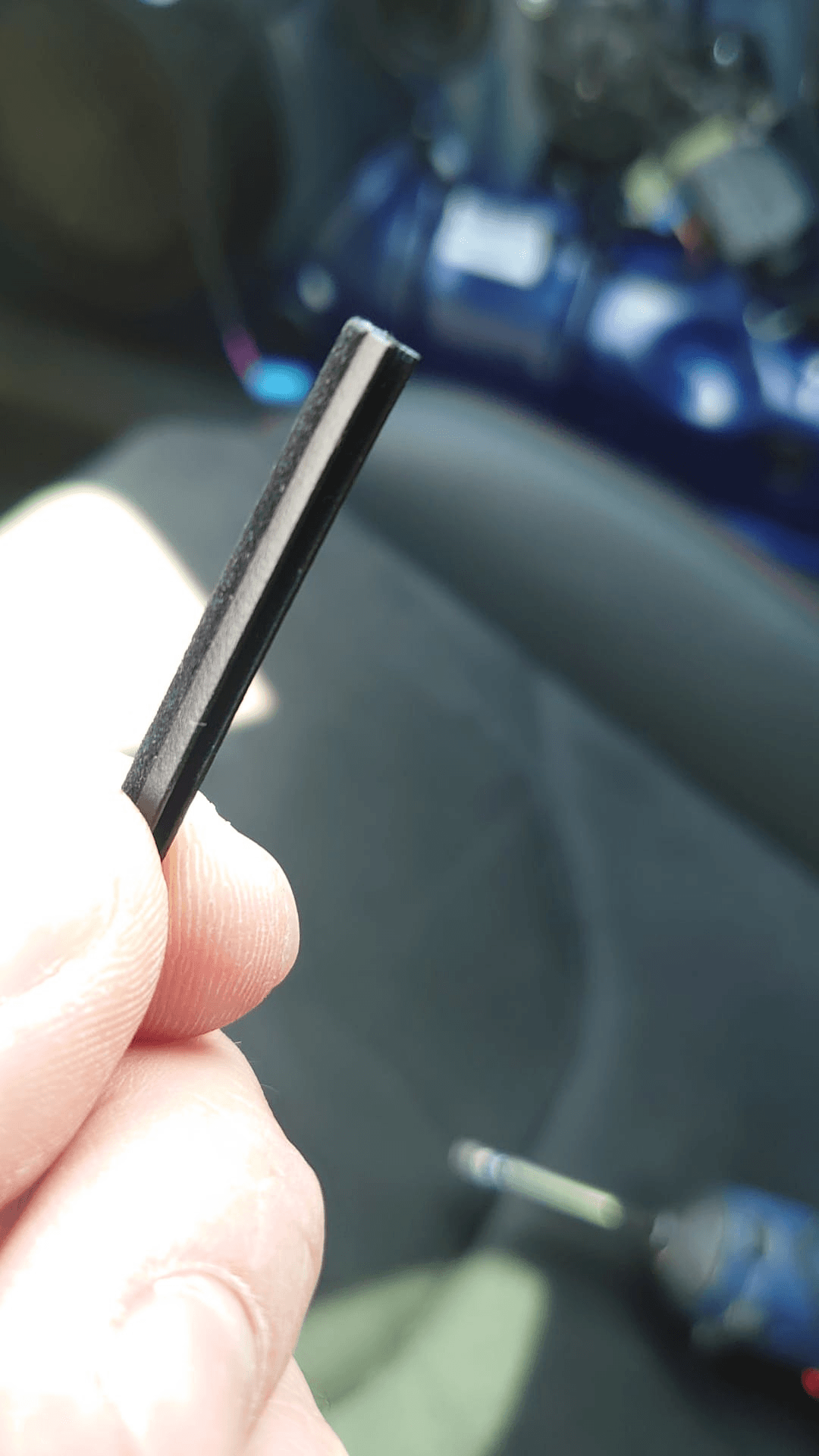

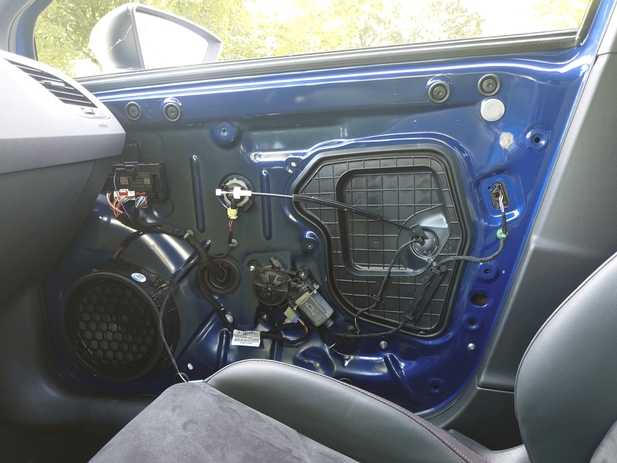

Since I had my Leon, I was hearing a slight rattle in the passenger door... Yesterday, I finally decided: enough is enough!
I pulled off the door card, (see this guide for help: https://www.seatcupra.net/forums/resources/how-to-soundproof-your-doors-mk3.7/ ).
This little bugger fell out of it:

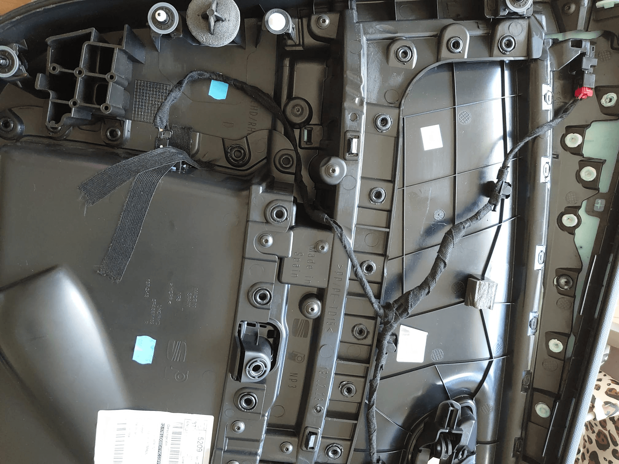

And now I'm rocking this racecar look:
And while the door card is open, I decided to add an RGB LED to the door pocket:
Next up: adding sound deadening here!
Reactions: H Rafiq and queen
Update: Rattle is gone! :cool:
Now I still need to do the other 3 doors with some insulation... and the rear seats, and the trunk area... and everywhere else :ROFLMAO:

Did you need to install extra hardware? Is it not a simple OBD-activation?
I added an additional RGB LED, from an Audi door pocket, and I routed 3 additional wires, spliced from the original RGB led wires that were already in the door. (+, GND and LIN)
