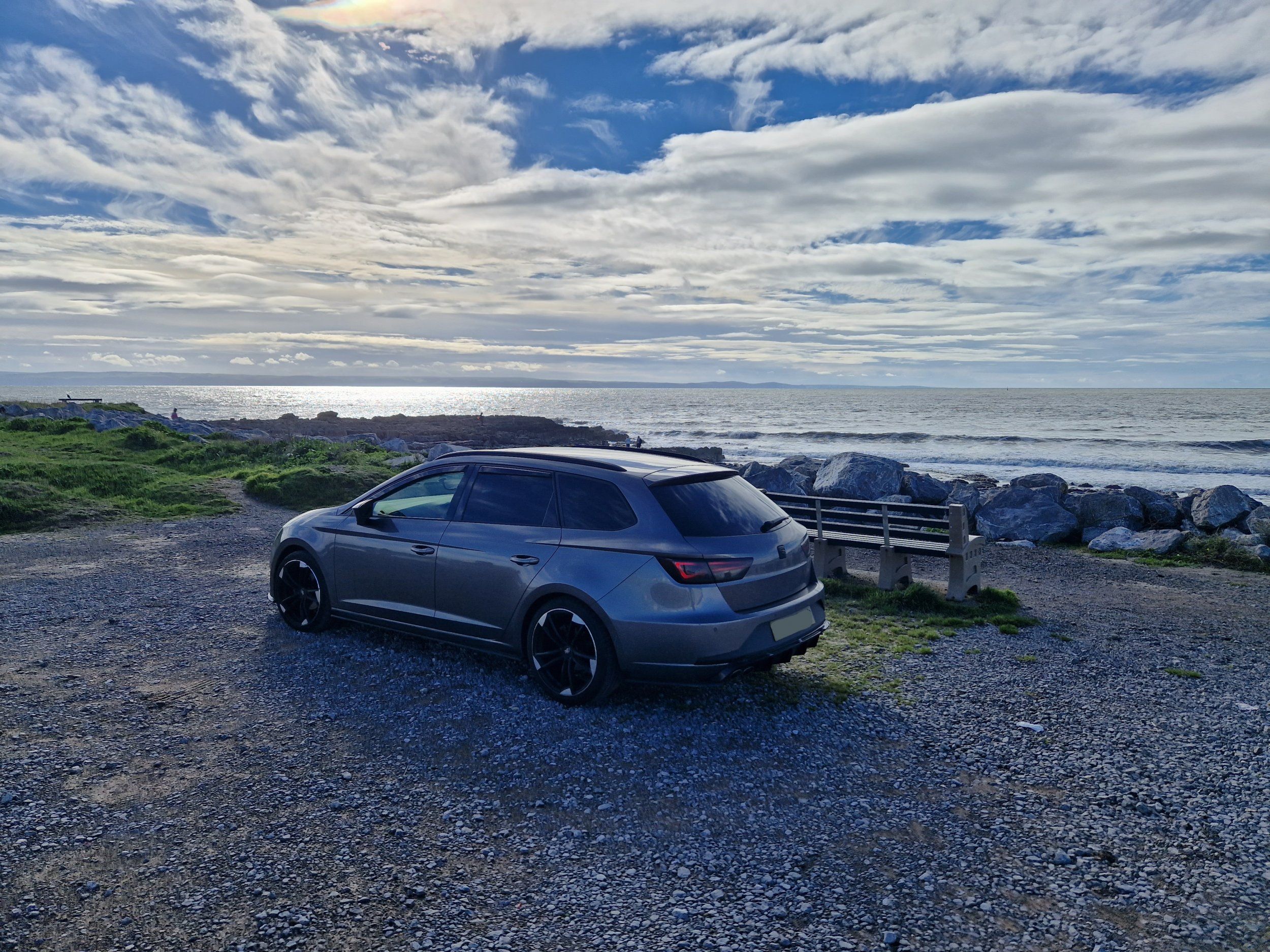

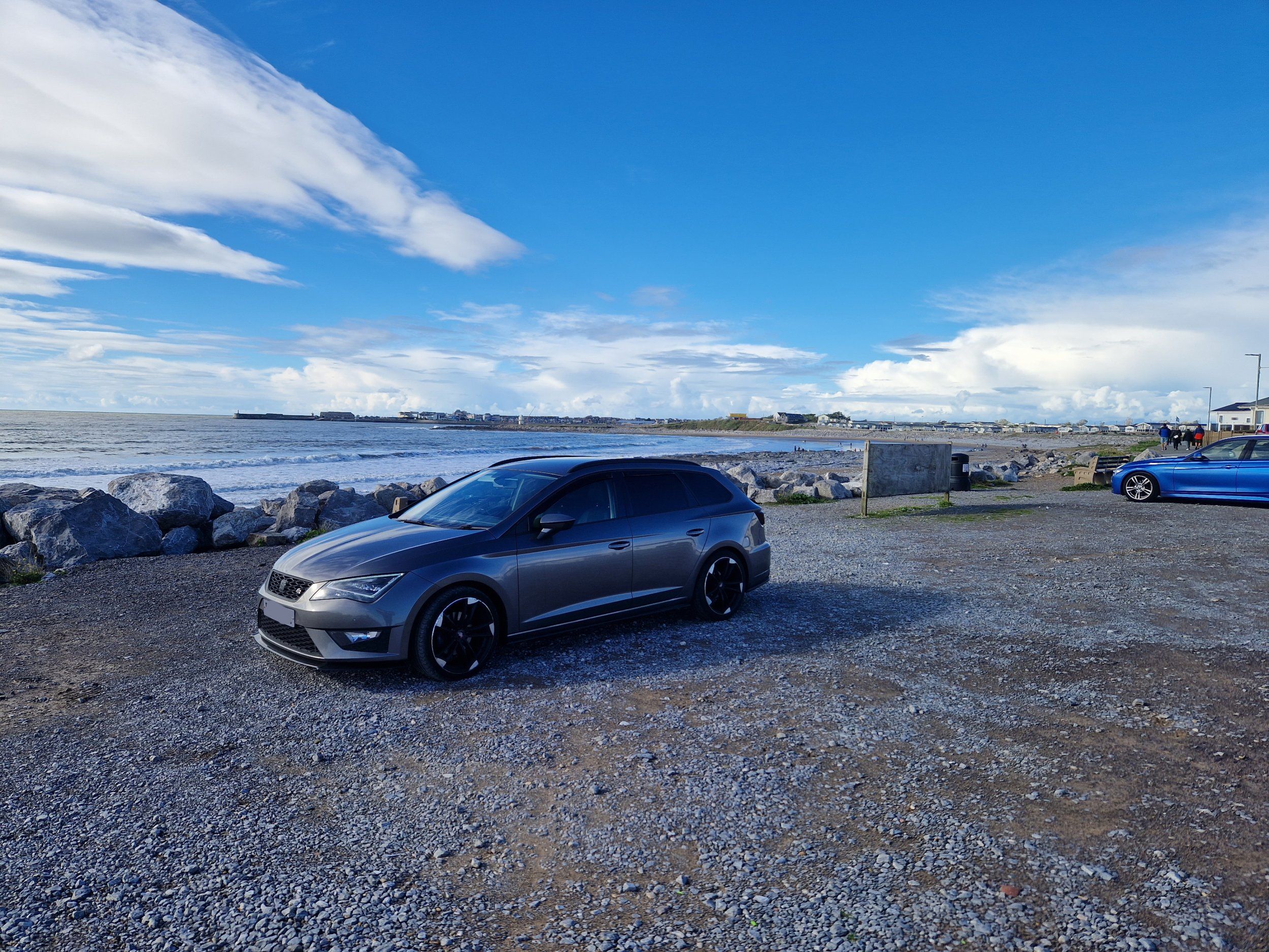

Had new ST -40mm springs, top mount bearings and drop links fitted to my FR. very pleased with how they sit and the car handles now, as it should have come out the factory in my opinion.
Do you have links for top mount bearings and drop links ?
I'd like to take a look at those.
And if you have a photo, it would be nice to see how low 40 mm springs got the car.
Cheers.
Cheers.
Hello, they are standard VAG replacement top mount bearings and I used some adjustable droplinks.
ill get some pics once its settled so you get an idea of how it sits.
Reactions: serdar_18fr
Thanks for the response.
I looked for the drop links and found something like this:
Don't know if they are any good, but from what I've read there I understand that keeping the factory fitted drop links after the lowering is not something advisable. To this date, I didn't see any aftermarket spring manufacturer ever mentioning about that. This is a valuable information for me, your post made me start looking for that, so thank you :)
Anyway, I'll be looking forward to your car's pics.
