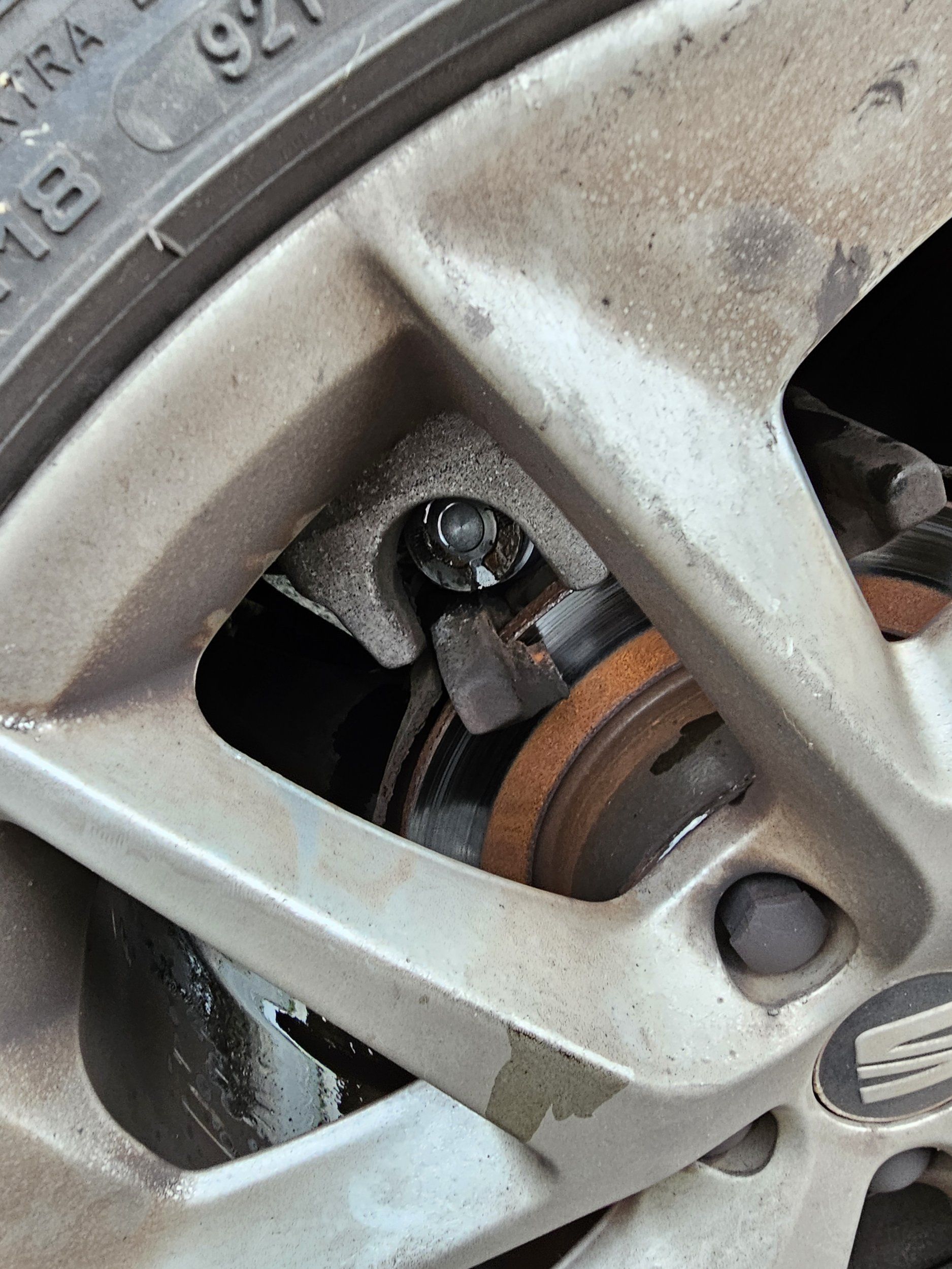

Tell them the legal limit is 1.6mm and to jog onGot mine serviced recently and was quoted £662 for discs and pads for the front. Then told I need 4 new tyres as they are 3mm ?

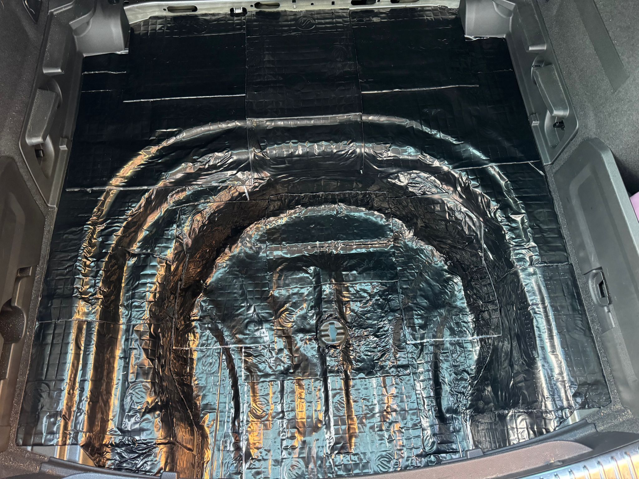

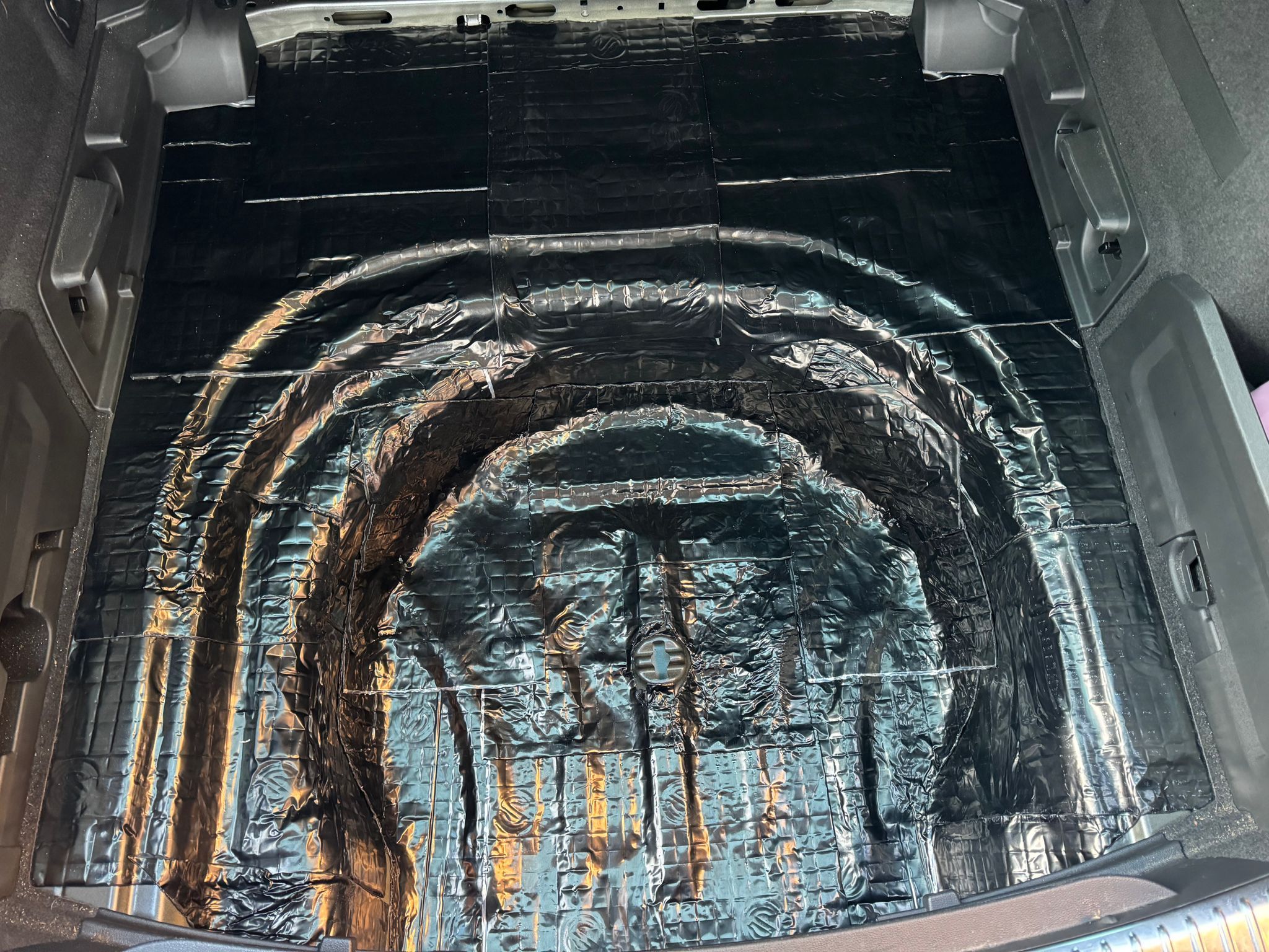

Looks good! I'm going to do this to my ST as well as it's a bit droney on the motorway with a trackslag downpipe and scorpion system. Do you have the part number for the golf estate carpet?Small quality of life update today - Silent coat black (3mm) to the entire boot floor and wheel well. Then installed the genuine VAG carpet from a VW Golf estate to complete the OEM+ look
May add some closed cell foam over the top at some point, but hoping for now this will reduce some of the road noise from the rear and the annoying vibration coming from the wheel well panel vibrating at speed (which drove me nuts at French motorway cruising speed)
5G9863544Looks good! I'm going to do this to my ST as well as it's a bit droney on the motorway with a trackslag downpipe and scorpion system. Do you have the part number for the golf estate carpet?
5G9863544B fits also for estate, but it does not cover whole floor - it's a bit too short near rear seats.Looks good! I'm going to do this to my ST as well as it's a bit droney on the motorway with a trackslag downpipe and scorpion system. Do you have the part number for the golf estate carpet?
