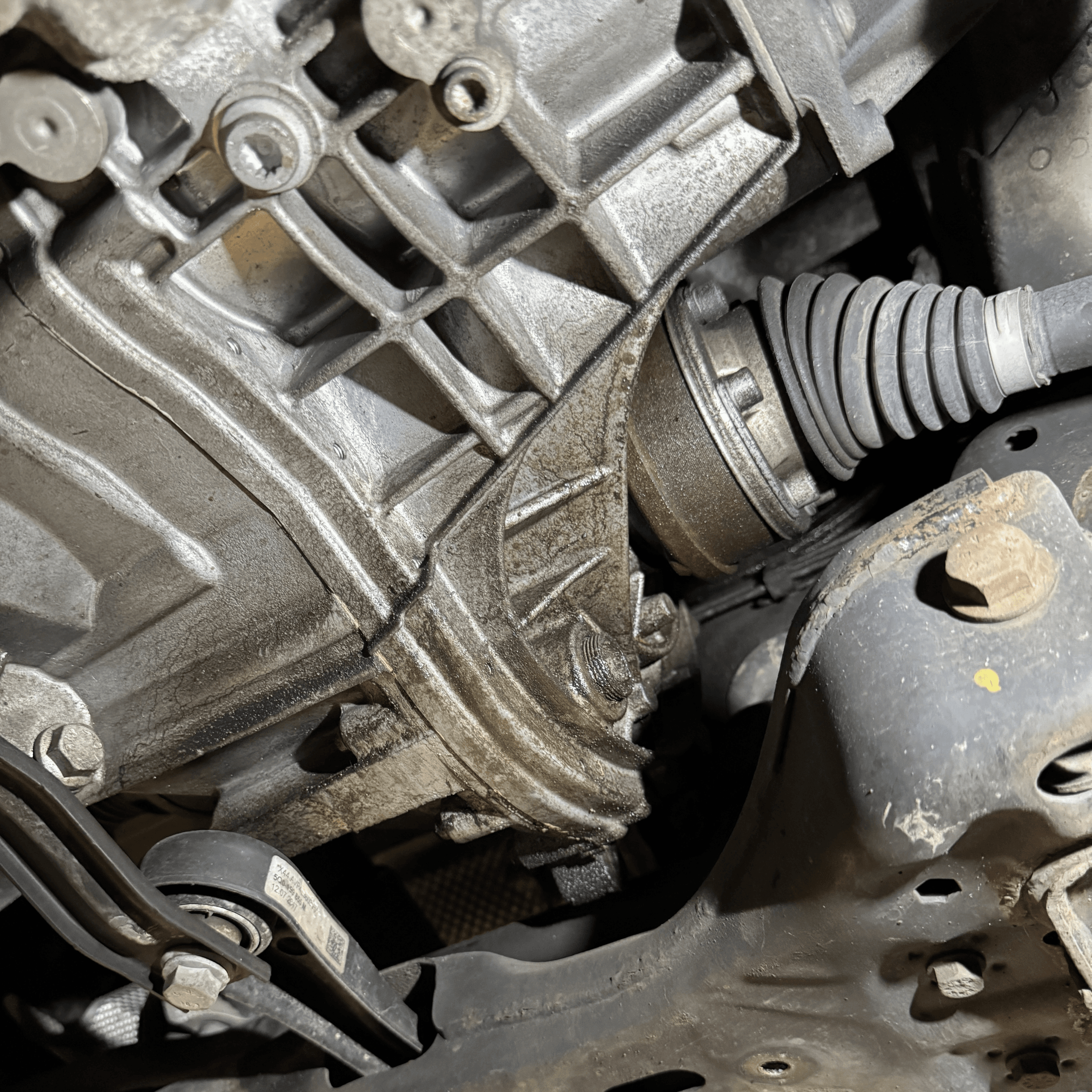

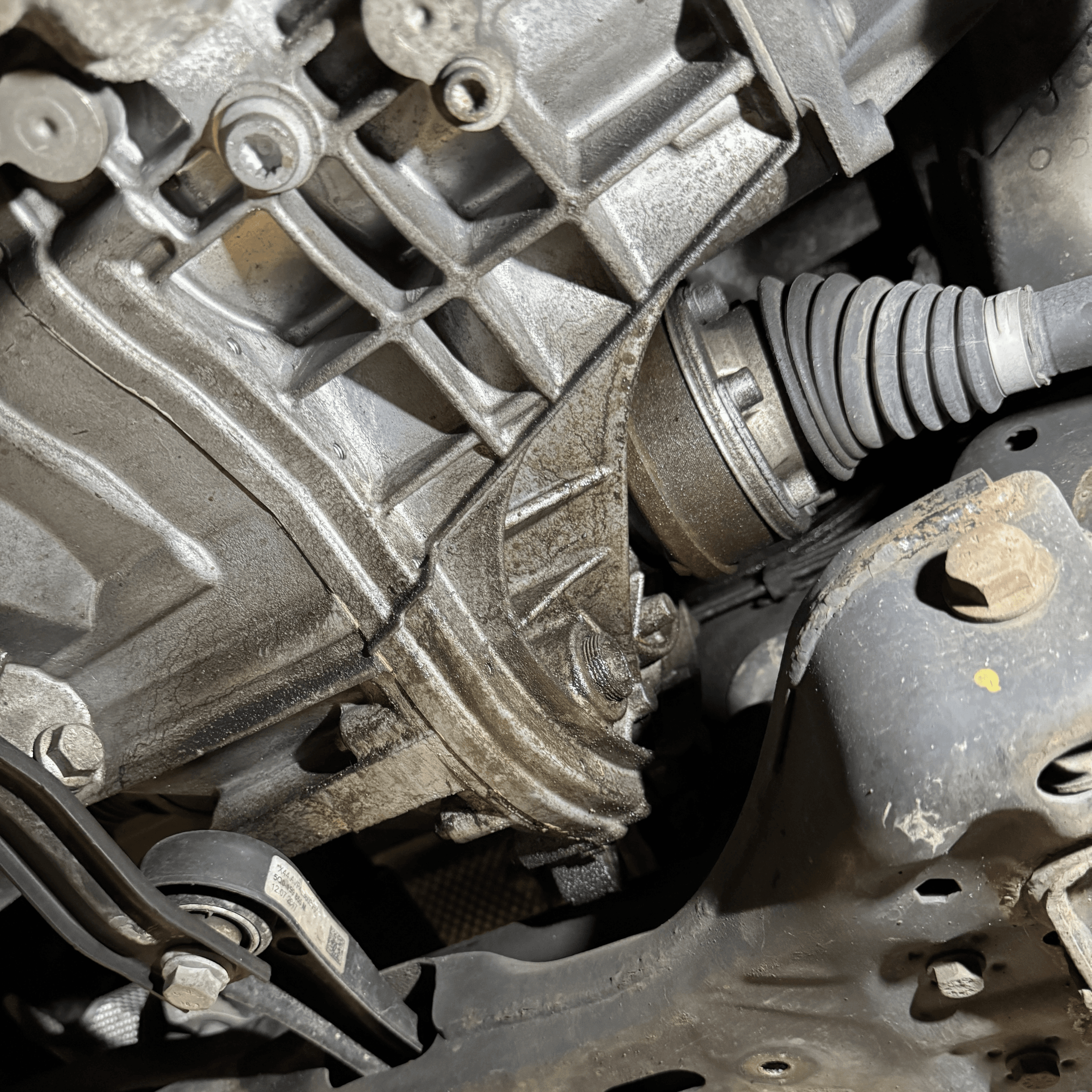

~88000km driven and car required engine oil, cabin filter and brake fluid change. During change a leak between gearbox and driveshaft was noticed. It must be some fresh malfunction, because gearbox was dry in the March this year. I will have to address this sooner rather than later.

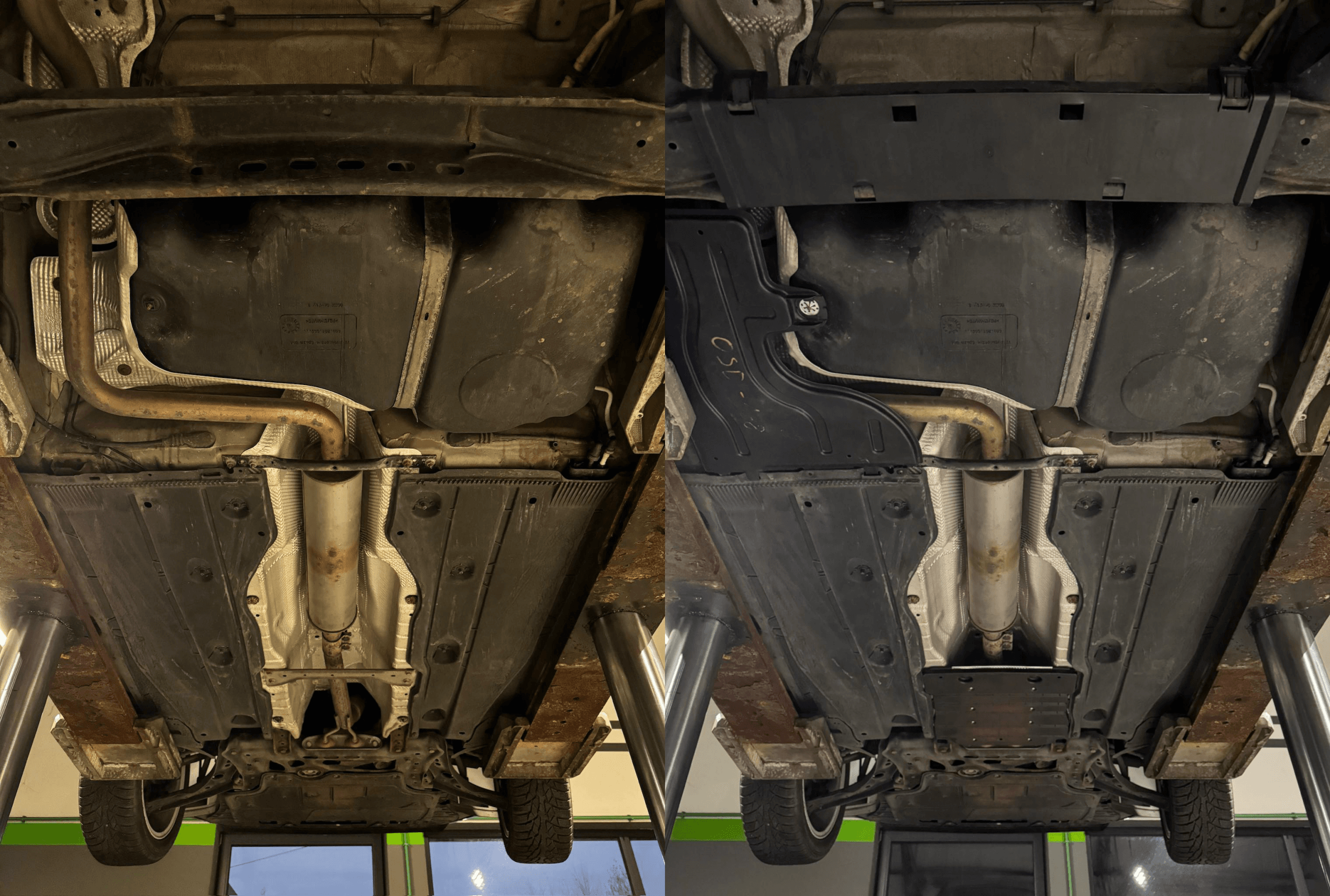

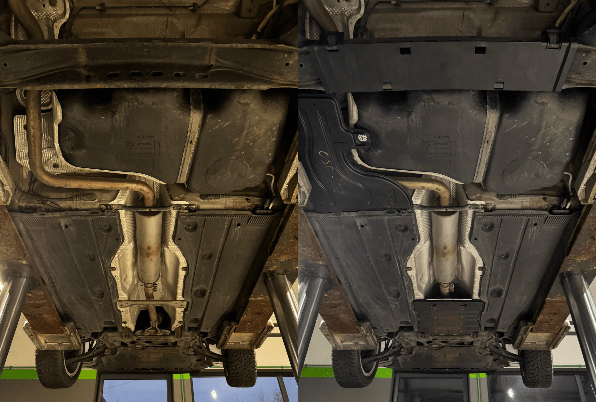

Also installed some of underside covers which should reduce fuel consumption and road noise.
It's interesting that you've fitted the under-aero as I am planning on the same next week....
Did you fit 5Q0 825 229 C front and 5Q0 825 206 K rear?

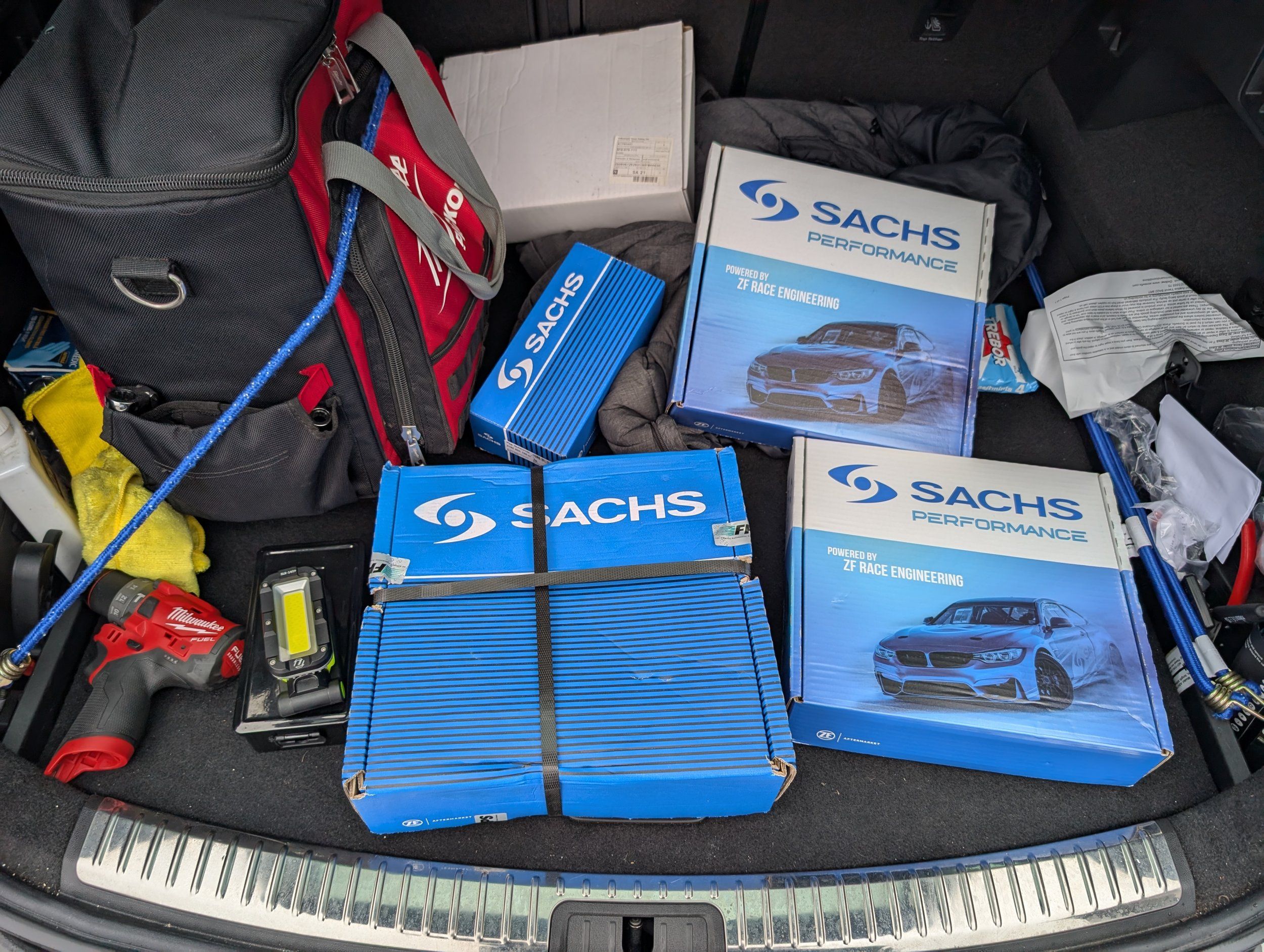

Getting this lot fitted today... Sachs Race Engineering organic clutch and new flywheel... Plus maybe front mudflaps and Audi A3 jacking points if there is time...

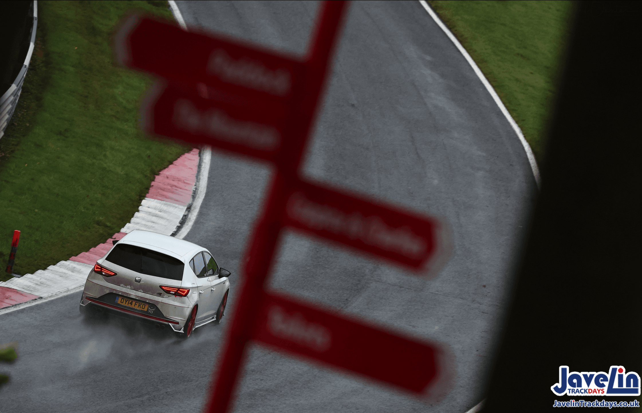

Great day on the track today, Had a great time with a proper MINI (British Leyland not BMW) who was running a 1360cc engine so had tons of power. Noticed that he and I were enjoying the very wet afternoon but the rear wheel cars were having trouble from stopping the back stepping out and we had a great run of 10 laps both pushing our motors and lots of grins when we came off the track.
Morning was very damp to start with and we had a red flag on the sighting lap where somebody had come off the track on the first lap.
Got another day booked for the weekend which looks like another mixed bag of weather so looking forward to doing the same again.
Reactions: Craig.
Another great day out on the track, lots of rain and wind made it a very exciting day had a few 90 / 180 degree spins in front of me along with one guy who just could not stop and kept going straight instead of turning sharp right.
They had to close down early (2-30) as the rain got very heavy and to many cars were spinning off but generally allowing for the weather the marshals did a great job in keeping the track open but safe for every body

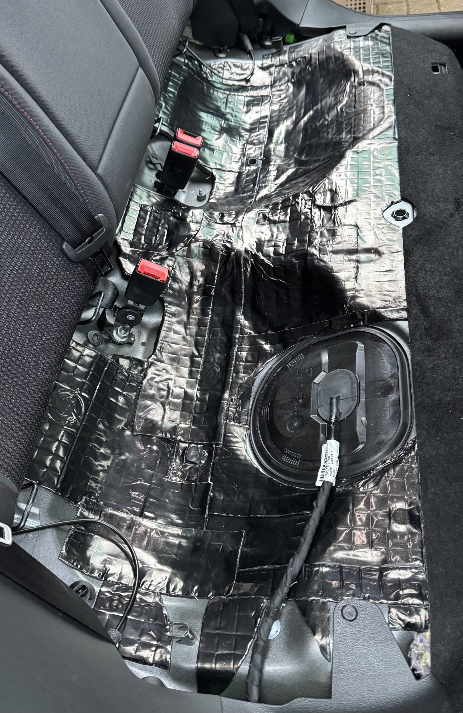

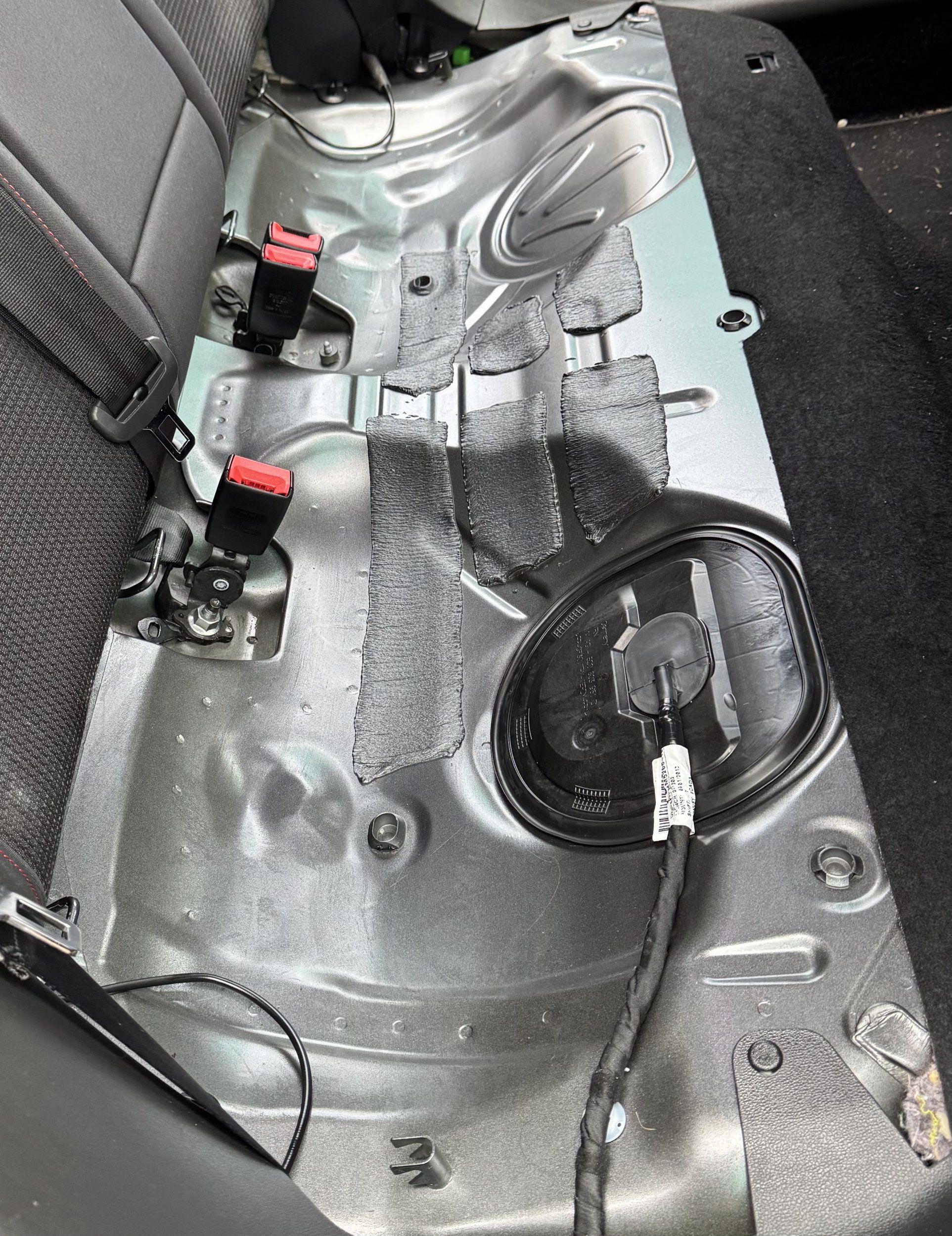

It’s an absolute pig of a job to do when it’s 1*c outside - and needed a healthy application of hairdryer as the cold butyl did not want to mould to all the bumps and curves! I’ll probably fill some more of the gaps if I have any left after I do the boot wheel well in preparation for Seat Sound

How do you remove the rear bench? Is it pretty straight forward? Has it made a big difference?
It’s literally a 2 minute job. Pull the iso fix plastic surrounds/covers up and slightly backwards to release them. Then a sharp tug on the front corner of each end of the bench - it then just lifts out easily!
Has definitely made a difference, as I can’t hear fuel sloshing around in the tank any more. And the kids have reported the back seems quieter (and I didn’t tell them I’d changed anything, so blind test). Not night and day, but for the sake of a few hours I think it was worth it
Reactions: nd-photo.nl
I did this not to long ago. Protip, I made a "flap" for covering the fuel pump cover
I cheated - and rather than a flap I stuck that section to the underneath of the bench instead! Just cut it to fit and laid it on upside down, then put the bench back and sat my fat posterior on it to stick it in place!
