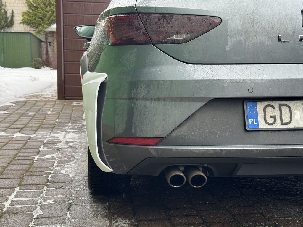

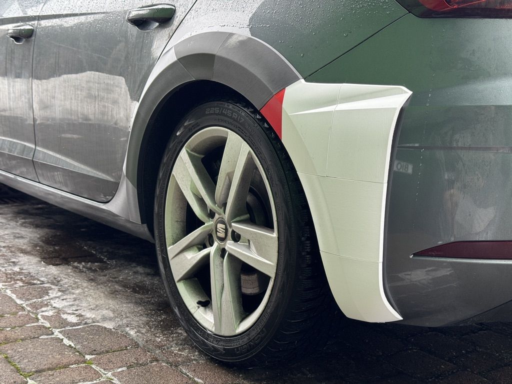

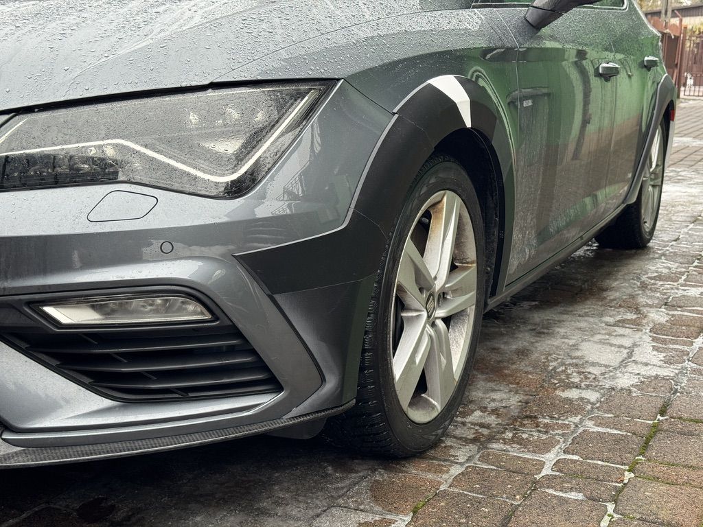

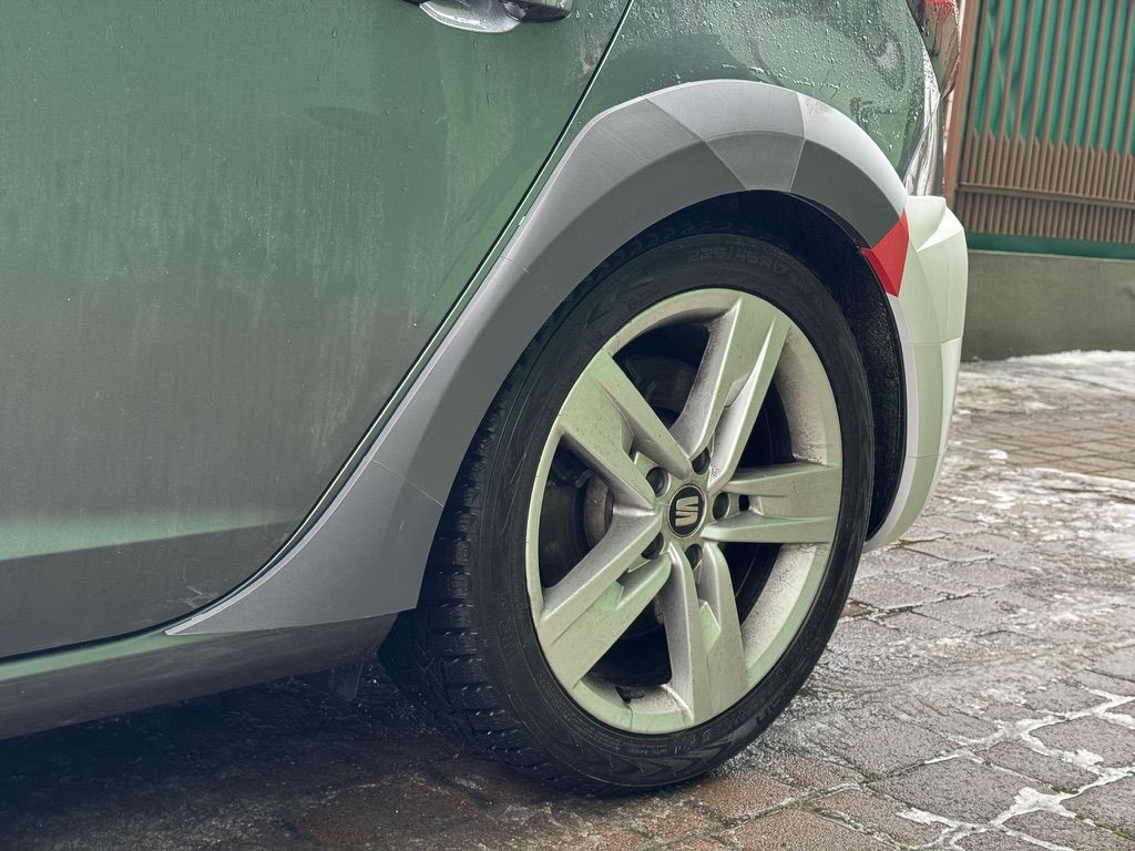

I was watching Mischa yesterday and then....
The only difference is that car on that video have OEM ones and mine is 3D printed ;) also mine will be ~5mm wider.
One side completed, ignore alignment and colors

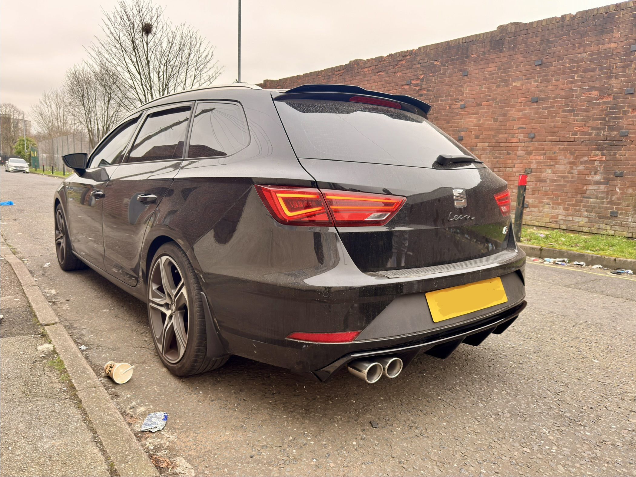

11 year mark MOT Passed just needed rear drop links replaced and Cat warmed up.
Garage owner enjoyed taking her out to warm the cat up and called me to ask to take the car away before he lost his license :)

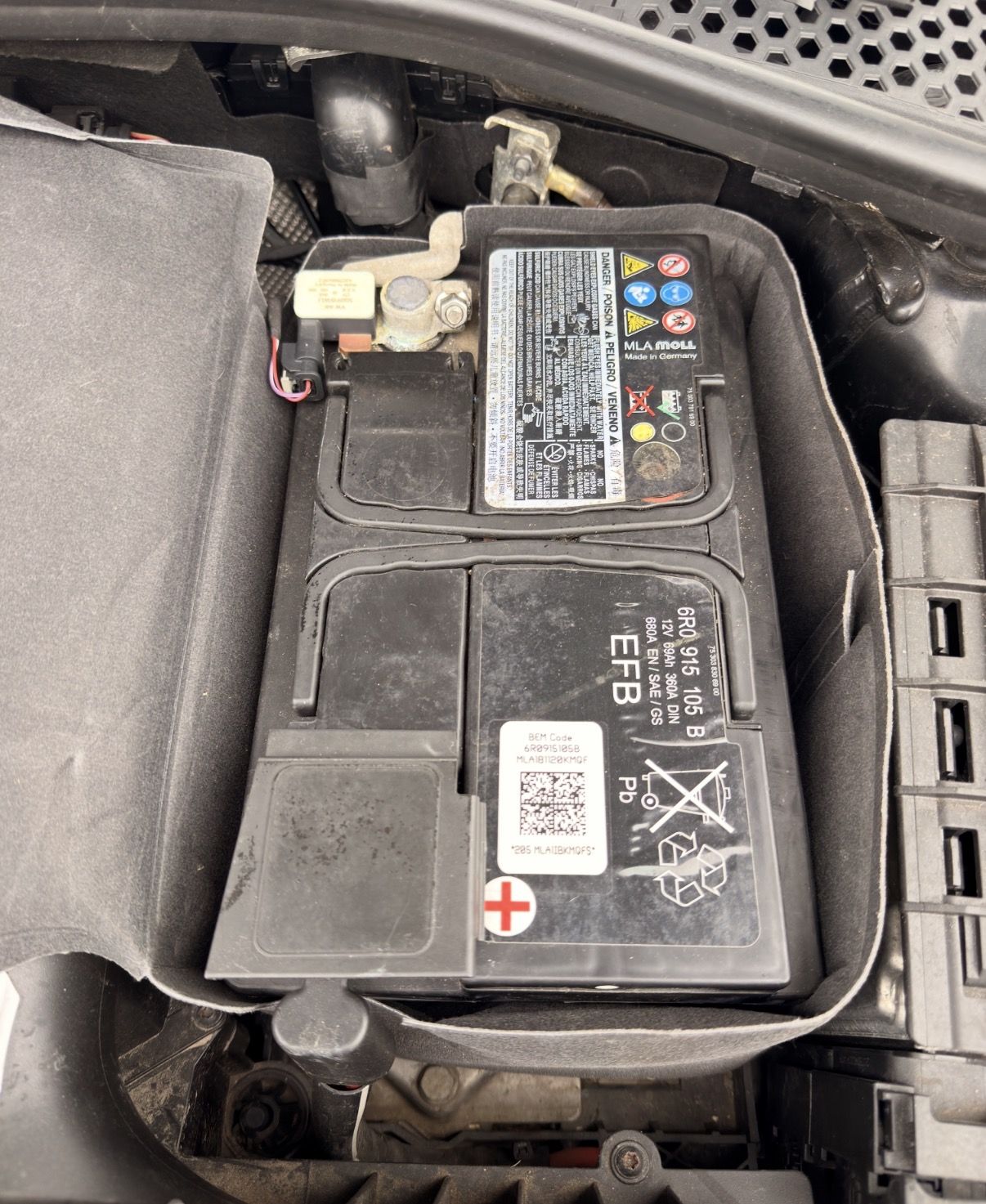

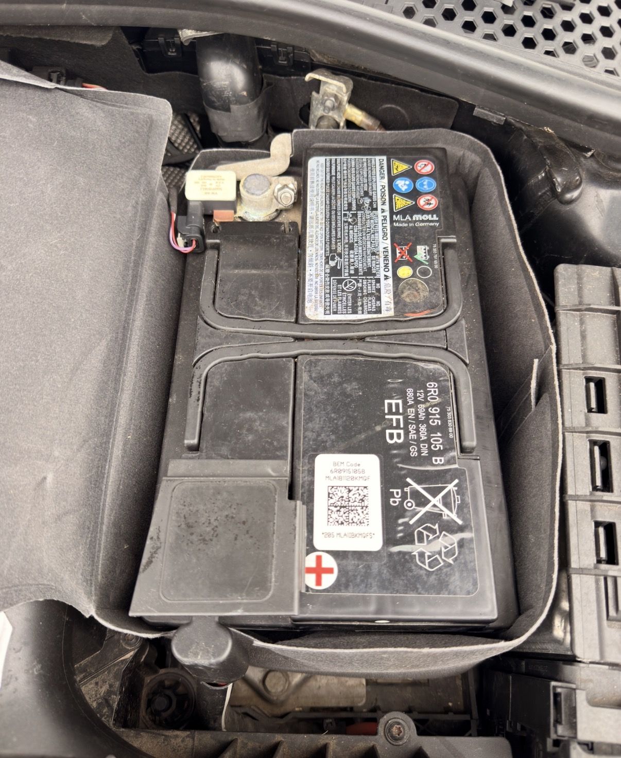

So my car decided to not start today, no previous warnings or anything, drove fine yesterday.
Was worried i left something on but apparently it all switches off once locked?
Anyway I've ordered a new battery as the original is a moll efb 69ah, new one i ordered from tayna, bosch agm 70ah 760cca.
The AA came out and checked that the battery was charging just old.
Hopefully the new one works without issues.
Fingers crossed that sorts it.
Reactions: Mo_86
Don't forget to do the battery coding in VCDS as you are changing battery capacity & type (EFB > AGM). Its not mandatory, but highly advisable to get the most out of your new battery (y)
Yes i will do thanks, it may not be done for a few days but that should be ok right?
I see you have the 72ah maybe i should have gotten that rather than the 70ah.
Reactions: nd-photo.nl
Few days is no issue. Its to make sure that the battery charging system makes the best use of the battery. I doubt the 2Ah will make much of a difference in real life :happy:
I just bought the brand for which I have good experiences with
