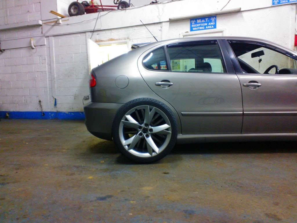

I've just put 19's on my lcr, 8.5j et 35 with 225/35/19 on with a slight stretch, car is already lowered 40mm, needs lowering more, still need to sort spaces out as currently 15 on front none on back, looking to put 10 on front and 15 on back..
they will be 5x112 pcd so you would need a 20mm adapter minimum so that would drop the et to 12! you'll either have to run a fair bit of stretch or camber to make sure they fit in the arch, will be a lot of poke.
im running an overall et of 25 on a 9j wheel and it pokes by about 5mm on the rear, i actually want to fit a 15mm spacer but im all about that stance/dub crap haha
